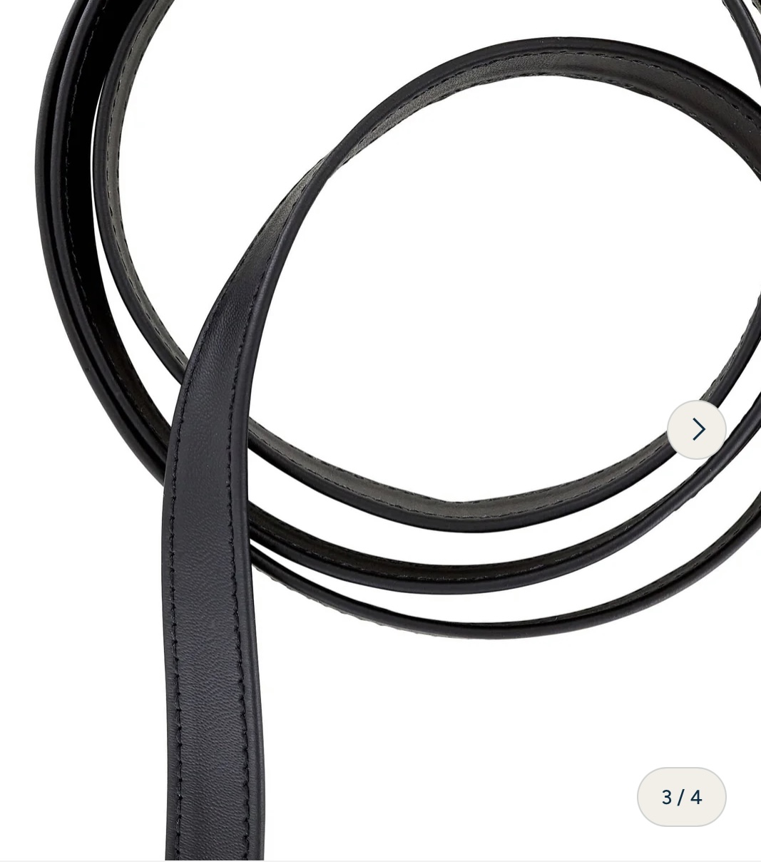

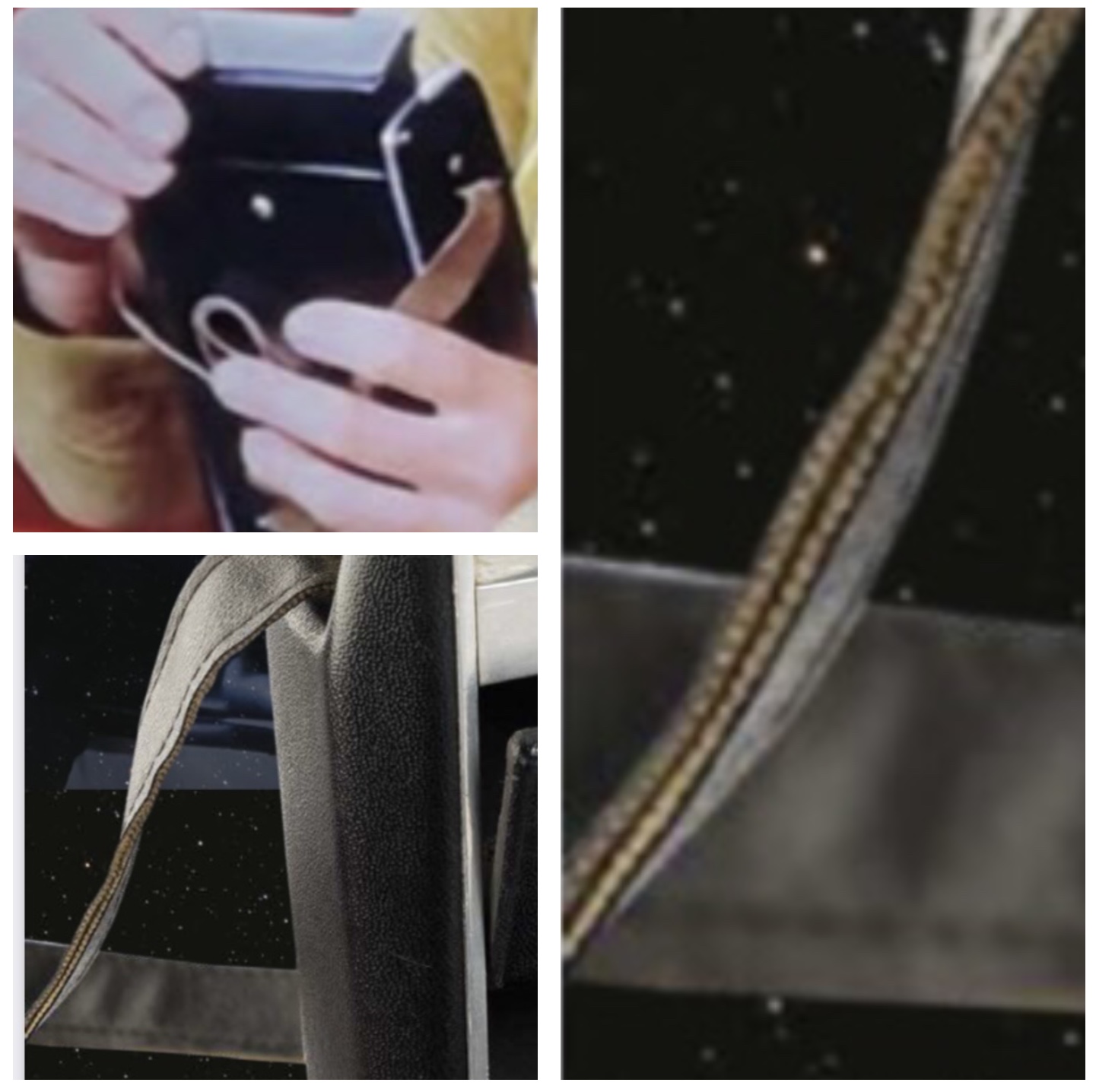

Another example …..top left pic is real leather. Other two pics are man made fake leather sandwiched and sewn to a cloth material backing or so it appears.
What material would you be making them out from?
Personally I would go with (and have gone with) real leather. It's inexpensive to purchase and I find it more durable, especially since the faux one that the trike came with started cracking and splitting on me in no time at all.
There are different types obviously. The one I have on now is a softer leather that will roll up nicely while still being very strong and is one side finished other side nubuck. I have another piece that is more rigid and more finished both sides. Going to see about getting them stitched later today.

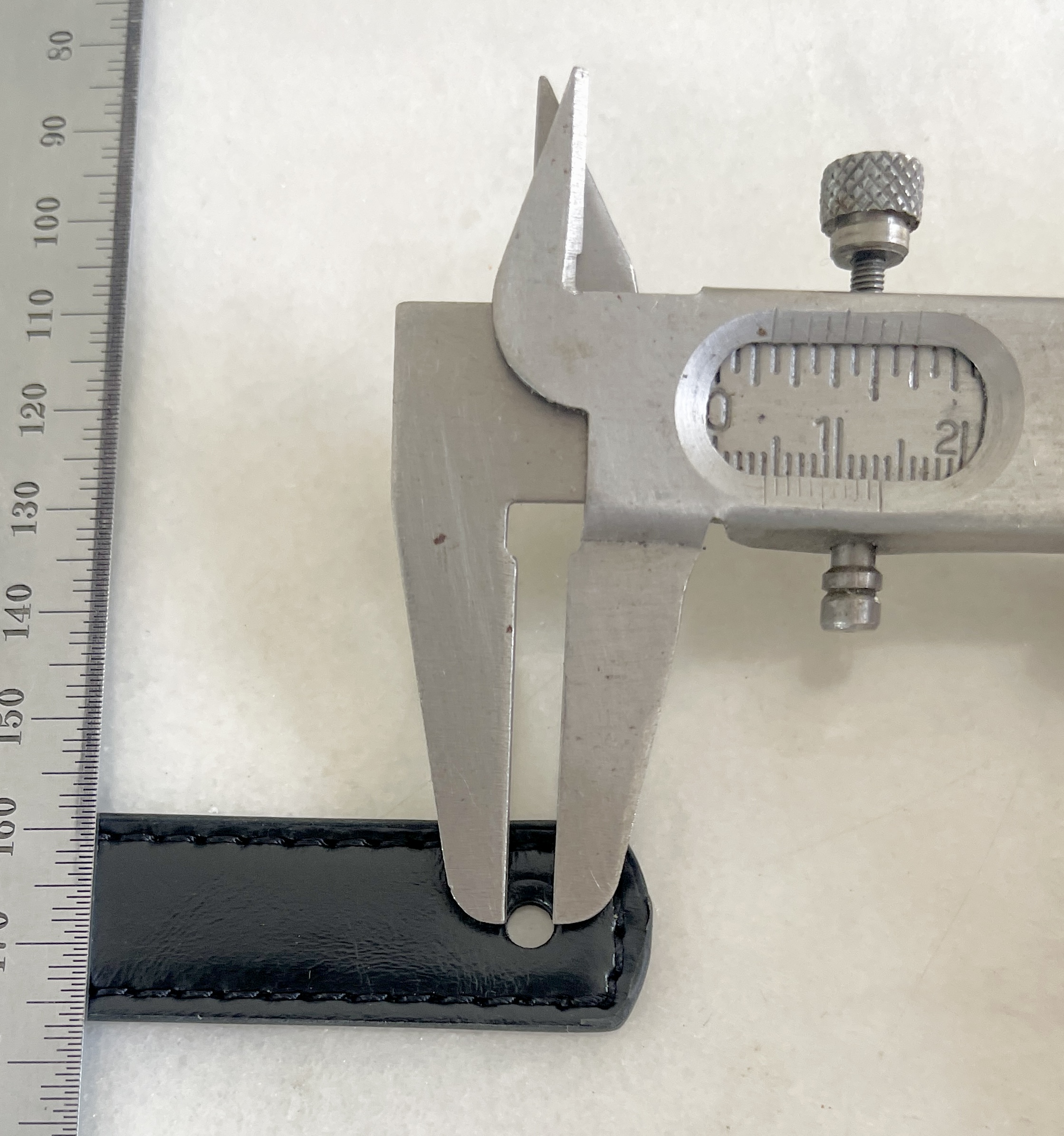

This is from the TWC Tricorder Update #9
We’re not sure of the provenance of the strap currently fitted to the tricorder we studied in Los Angeles. What we can say, though, is that that particular strap was 19 mm wide, about 1.5 mm thick, and had a visible length of 1350 mm. It was stitched along both edges and was folded over but otherwise unfinished, so it had one neat edge and one raw edge which showed the back of the leatherette.
Our leatherette strap matches the critical dimensions quite closely at 1350 x 19 mm but is a little bit thicker at 2.4 mm. It has stitching down both sides, but for neatness is finished on both edges.

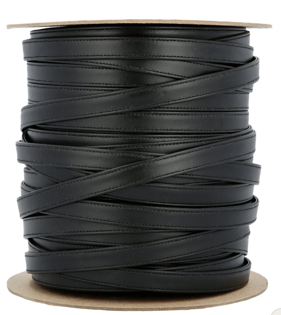

This was posted on FB. I removed my strap for measuring and ordered 5 feet of this leather. They don’t specify the thickness so we’ll see.
LINK: Weaver Leather Supply
View attachment 1948533View attachment 1948534View attachment 1948535

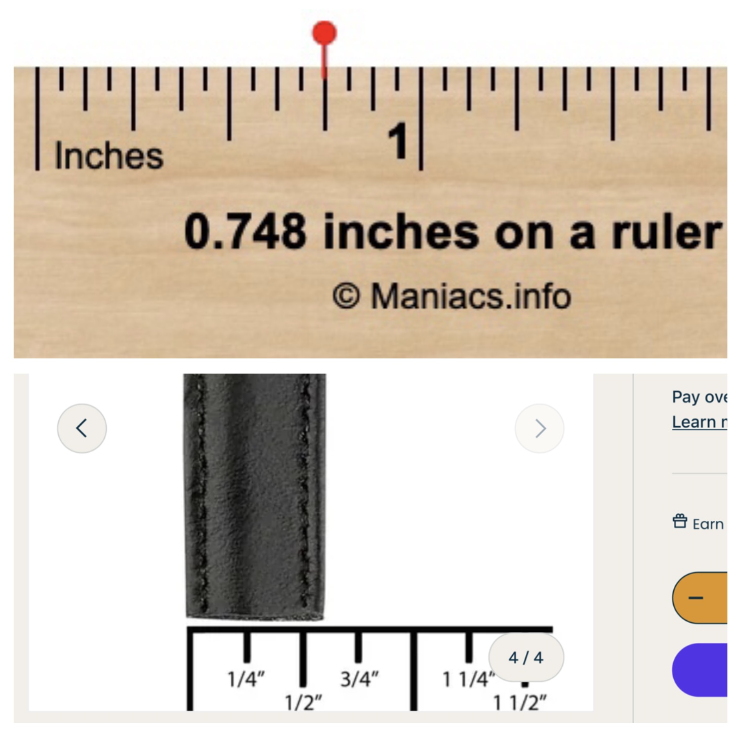

If TWC measured a width of 19mm (.748 inches)….that’s closer to 3/4” versus 5/8” per your link…..imo.
Nice strap though…certainly seems to fit the TWC post “It was stitched along both edges and was folded over but otherwise unfinished, so it had one neat edge and one raw edge which showed the back of the leatherette.”
EDIT: Here’s the link 19mm~3/4” black stitched strapping from the same company (not cheap). You’ll have to contact them for thickness info which is not shown…since thickness could be an issue.

I had already taken my strap off when there was the recent question about the dimensions. I quoted the TWC Update #9. I examined my actual TWC strap and there is a difference in the actual strap and the early TWC Update post. The Post #9 indicated the strap "would be" 2.4 mm - my actual strap is 2.1 mm. I would recommend any replacement strap be ~2 mm thick in order to fit through the side panel. Also to be precise, the actual strap is not folded like the strap which was scanned. The flexible nature of actual strap material makes measurement of the stitch length a little variable. My approach was to measure the length of 10 stitches at various point along the strap and divide and average. This provided me with a standard stitch length of 4 mm. which most sewing machines can produce. If your machine uses "stitches per inch", this would be 6 stitches per inch.

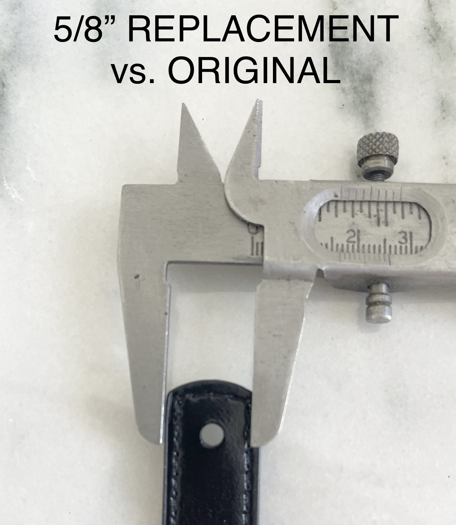

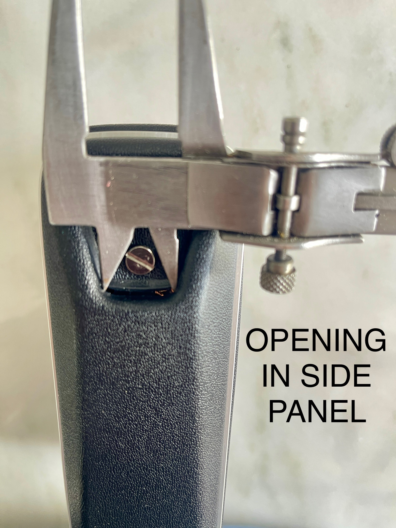

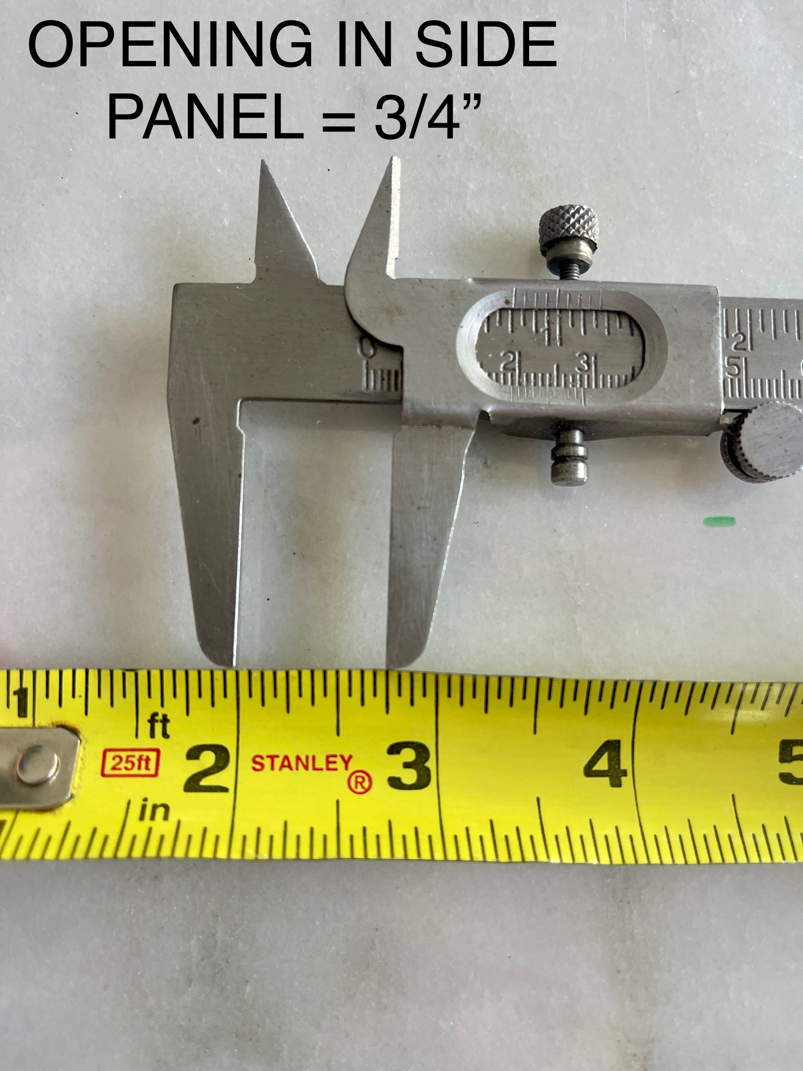

Here are some dimensions of the side panel opening and the 5/8” replacement strap (ordered) vs. the original strap. I might have ordered the 3/4” if I had noticed they offered that width. We’ll see how the 5/8” looks. The difference will probably be unnoticeable. The 3/4” might be tight getting it into the side panel opening.

One more measurement, 4mm hole in the end of the strap.
View attachment 1948560View attachment 1948561View attachment 1948562
You've ordered a 16mm so providing your leather isn't too thick it will feed through. I prefer the 19mm as it just looks a better fit to me personally. Yes it is a bit tighter getting in but as I've already shown it does fit.
