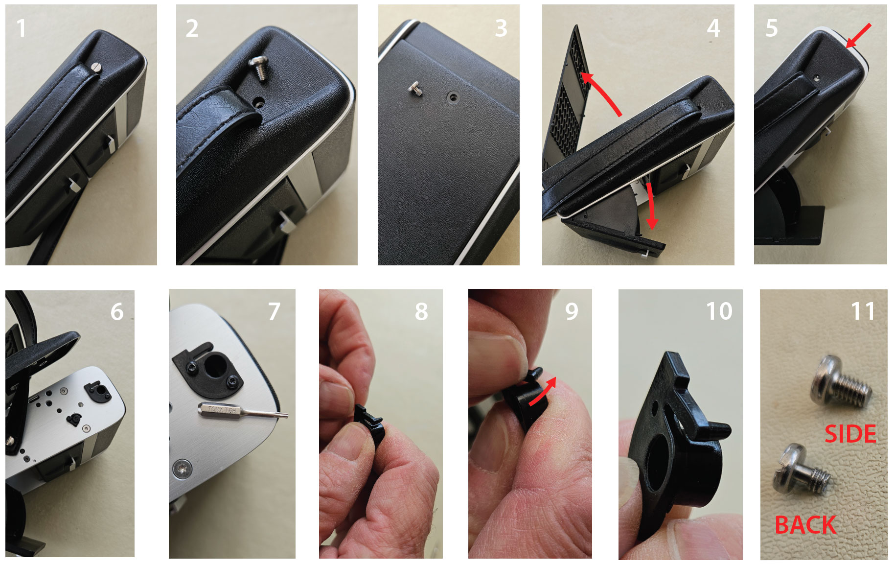

For those that want the hood detects to be stiffer, Chris Barnardo has posted instructions to accomplish this on the Tricorder blog. These will also be added to the on-line manual.
Chris Barnardo
July 9, 2025 at 7:41 am
Here is a quick explanation on how to increase the detent strength, but the first part describes and shows how to remove the straps. I will add this to the Tricorder online instruction manual. If you follow these instructions, taking off the side panels to adjust or replace the strap is not destructive and was part of the design intent.
1. Unscrew the single side screw that hows the panel in place
2. Unscrew the screw that holds the back door closed
3. Open both the front and back doors. This is important as there are features on the doors that lock the side panel in place
4. with the front and back doors open, slide the side panel down a few millimetres
5. it should easily lift off. You do not have to unthread the strap, just lift the panel to one side to reveal the hood hinge axle and detent mechanism
6. Unscrew hood locating axle and detent mechanism using a T6 torx screw bit
7. Hold the mechanism between thumb and forefinger or with a pair of pliers

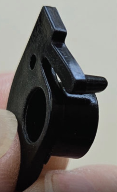

8. Bend the detent spring away from the front face. You can be quite brutal with this as we have never managed to break one
9. Bend it enough to make sure that it stays bent after you let go of it, basically you have plastically deformed it
10. Put the detent mechanism back and secure with the screws and then the reassembly is the reverse… be careful to make sure that a) you use the correct screws for the correct parts and be careful to remember that the front and back doors must be open when you slide the panel back in.
Check that the detent is stiffer and then if you want it even stiffer do the same to the other side.
I will be curious to see what results anyone has with this procedure.
Chris Barnardo

Btw Who’s to say that bending (deforming) won’t unbend (reform) back to its original moulded form over time.

Hand bending may not cut it…as a permanent fix.
