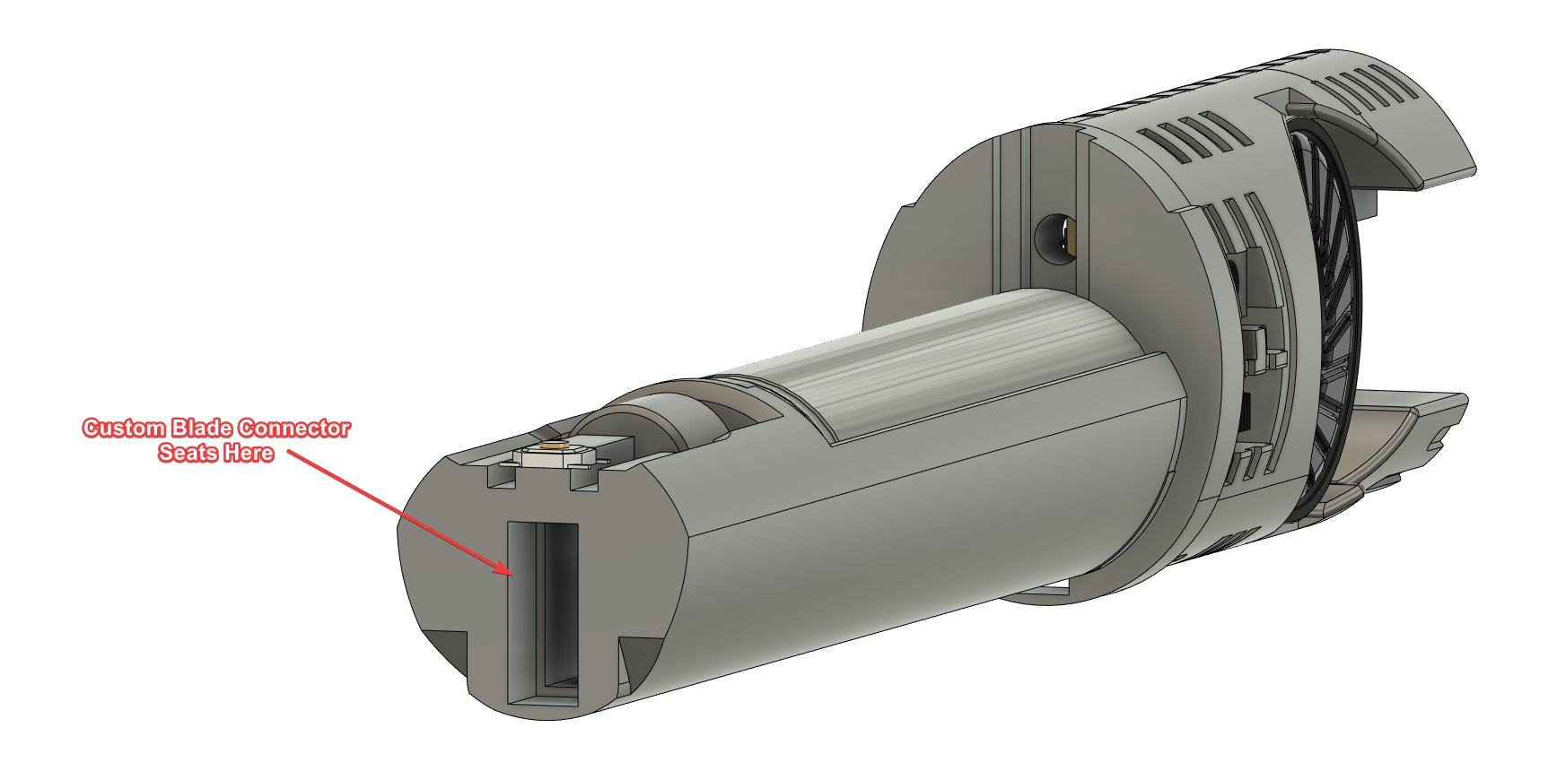

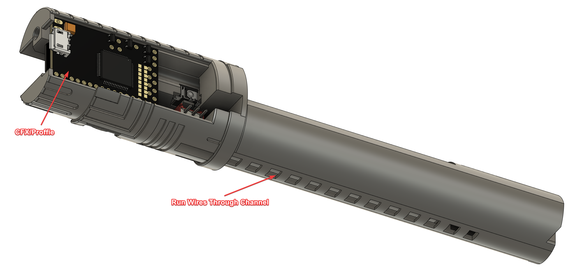

Some photo reference for people doing their own installs

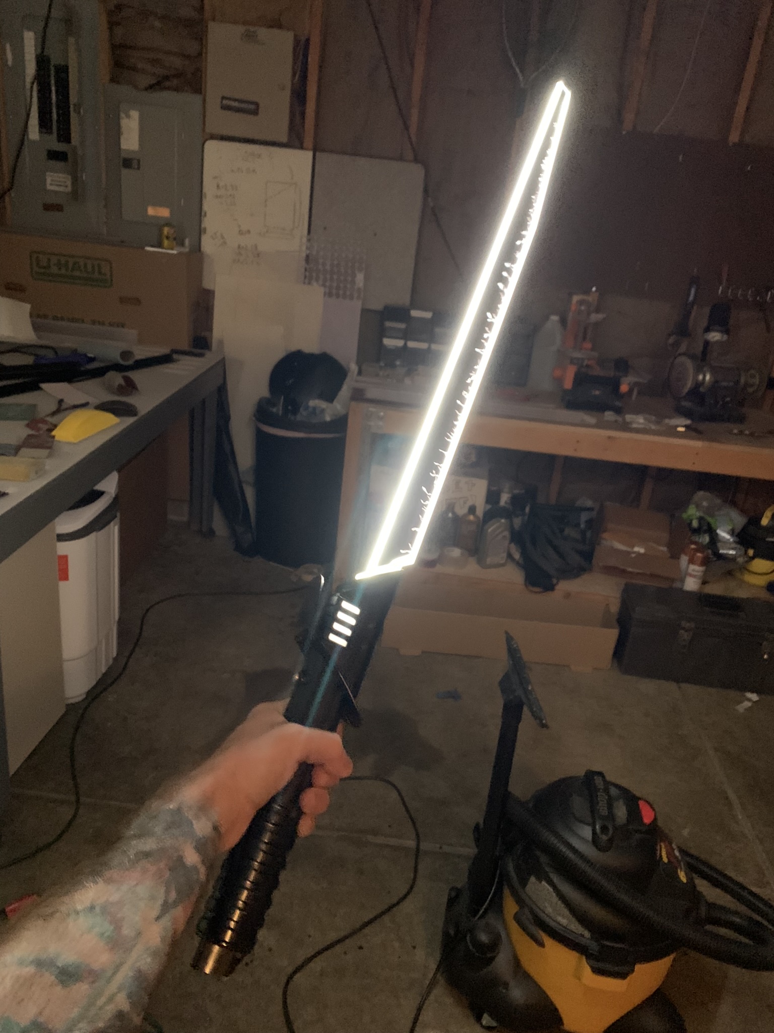

Hi y’all.
My current fully installed setup is up for sale.
Installed with CFX and comes with blade.
If you missed out on this run and would like to get the whole thing no fuss. Send me a DM.
This is the prototype and is weathered.

Hey there, I don’t have all the details but I can help you with some of this.
shadowfoil has attached a picture above with parts and where they go. On that it shows where the 16650 battery goes. Due to the size limitation of the inside of the hilt, we opted for a 16650 so that the chassis is stringer around the battery. Once blades are shipped the blade connection should be as straight forward as installing the pcb into the top of the hilt. It’s just a normal 1” blade pcb squeezed into a small rectangle.
As for blade timeline I have no info. I’m sure once The Saber Trade has a definitive timeline he will share it. He seems very busy at the moment, and I don’t mind waiting for the best darksaber blade on the market.:)
Hope this is of help!

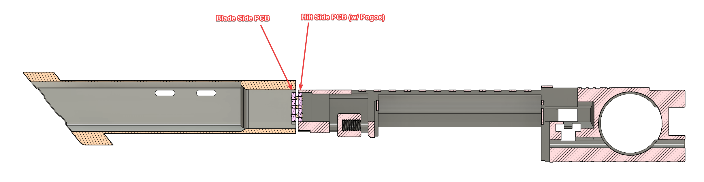

Here is a cross section to show how the blade/chassis mate up
The chassis is designed with SLS Nylon printing in mind, but tolerances on resin should be similar, just more fragile. FDM is possible but may require some post processing. The chassis only accepts a 16650 battery as there was limited space inside and 18650 would not clear the hilt inner diameter with room for wires around it.

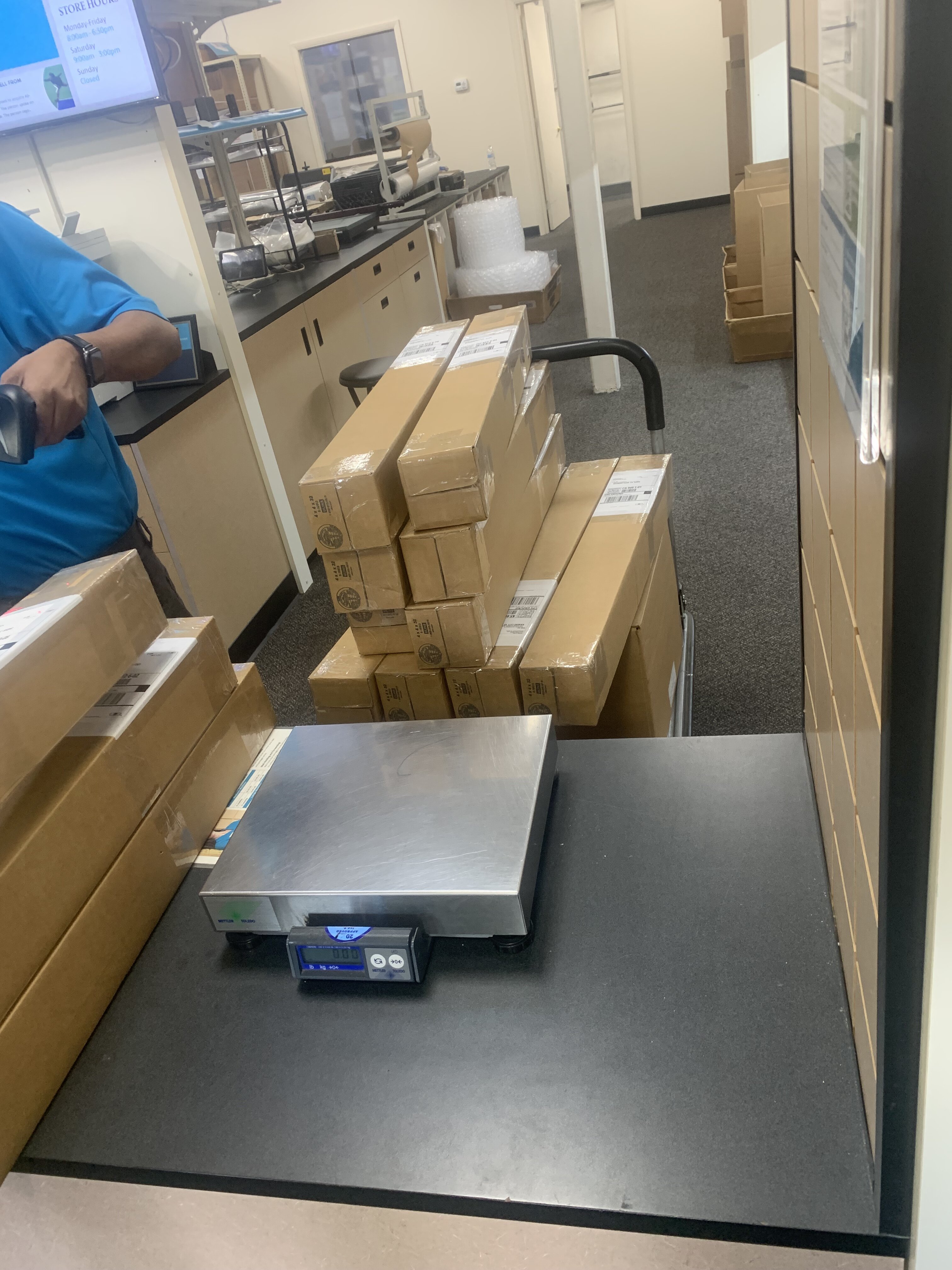

But yes unfortunately the shipping for the handmade blades for this run underwent a significant delay. Long story short-ish. The shipping of the blades was all supposed to happen during the week before we had to pack up the whole house, shop and family and move across town (at the beginning of July).
At that exact same time, I come down with bad bout of Covid and was out of commission for almost 2 weeks, the recovery was agonizingly slow and I hate to say it, I just didn’t have the energy to hardly get out of bed during this critical moment, it sucked and this caused a domino effect of issues. I had to pack up everything and wait until after the move, whats more, at the exact same time our parents house catches fire from a random stray Firework leaving them homeless and in desperate need of family support. During this tragic time their well being took priority. This wasn’t the end of our troubles, our new home and my workshop ended up being infested and needing bombed. We were effectively displaced for weeks while treatments were conducted. After a good deal of effort we are successfully settled in for the most part and the shop is up and running at full speed.
Again I greatly apologize for not updating the forum in a timely manner, I honestly just slacked off and felt like my other updates on my official pages would be enough but I realize I need to treat this forum as it’s own entity. . That was my fault, but what’s more, it was my fault in furthering the delay AFTER getting the move. The simple fact is that the return address was now different and it was too late to refund over $300 worth of shipping labels. To put it plainly I’m eating the loss and shipping labels are being totally reprinter on my own dollar. This would explain the “bogus” initial tracking label. It’s been voided by the post office.
I’m sure many of you have already seen a new shipping update for the original invoice, this UPS tracking number is your new number, please disregard the old one. As of last month more than half of the blades have been tested, packed and sent out. If you haven’t gotten one yet, it’s coming, I honesty just have to wait for next pay cycle to get the rest out.. oops :(

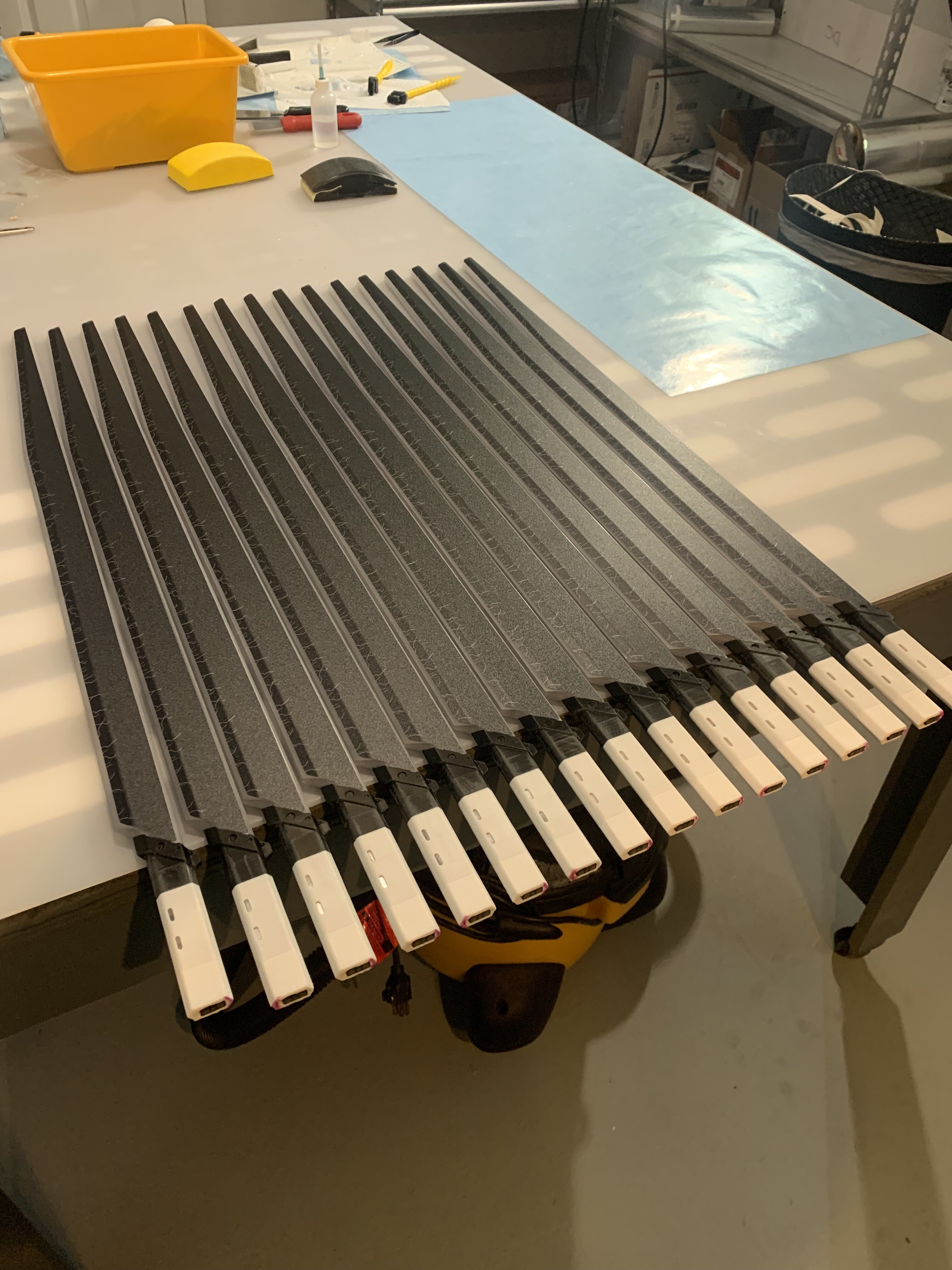

PS: BLADES ARE MARKED WITH PINK INK TO INDICATE WHICH SIDE IS THE POSITIVE. MIDDLE WILL BE DATA AND REMAINDER WILL BE GROUND. JUST NEED TO MAKE SURE THE HILT SIDE PCB IS WIRED UP WITH THE SAME ADJACENT FACING CONTACTS.
LED STRIP ONLY GOES IN ONE WAY, FACING ONE DIRECTION, IF REMOVING LED STRIP PLEASE USE CAUTION.
CAREFULLY PRY OUT PCB WITH A HEX KEY, BEING MINDFUL TO BE DELICATE. THE MAIN POWER LEAD WIRES ARE THICK AND SOLDERED PERPENDICULAR TO THE CONTACT PADS AND COULD BREAK OFF IF YOU ARE TOO ROUGH. MIND YOU SHOULD NOT NEED TO REMOVE THE STRIP FOR ANY REASON OTHER THAN TO REFURBISH OR REPLACE A DAMAGED STRIP.
DO NOT STORE BLADES IN DIRECT SUNLIGHT OR A HOT CAR FOR AN EXTENDED PERIOD OF TIME. EXTREME TEMPS MAY CAUSE WARPING!
BLADES COME INSTALLED WITH
RGBW SK6812 LED STRIP, THESE SPECIAL STRIPS WITH THEIR INDEPENDENT WHITE DIODE CAN ONLY BE RAN PROPERLY BY CHANGING CHANNELS TO “4” ON CFX AND INCLUDING THE 4th COLOR CODE.
ON PROFFIE RGB LABEL SIMPLY NEEDS TO BE CHANGED TO RGBW AND IT’LL WORK.
AND FINALLY, ONCE AGAIN, THESE BLADES ARE LIGHTWEIGHT AND FLEXIBLE, A JOY TO SPIN AROUND. BUT THESE STEMS ARE SIMPLY 3D PRINTED PLA+ WITH THIN WALLS AND THE BLADE IS NOT INDESTRUCTIBLE. PLEASE NO DUELING OR HARD CONTACT! NOT ONLY CAN YOU DAMAGED YOUR BLADE BUT THEY ARE ALSO BONE SHATTERING PAINFUL IF STRUCK BY THE EDGE.
IN THE EVENT OF DAMAGE, BLADES CAN BE SENT IN AND REFURBISHED OR OUTRIGHT REPLACED FOR A FEE. THE HEAVY DUTY DECALS CAN ALSO BE STRIPED AND REPLACED WITH A FRESH SET IN THE EVENT OF DAMAGE.
