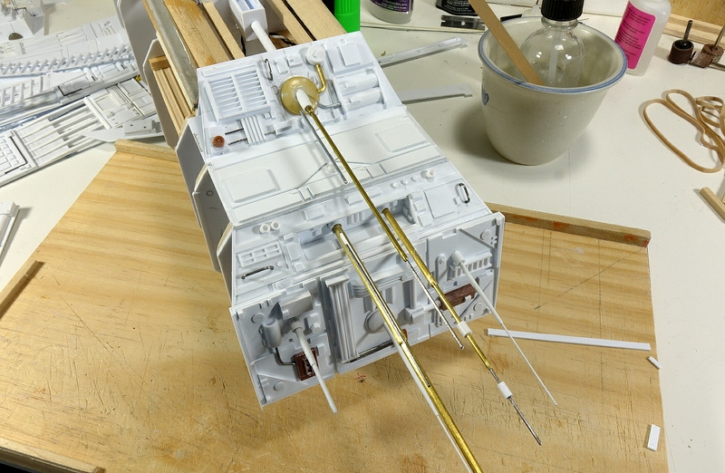

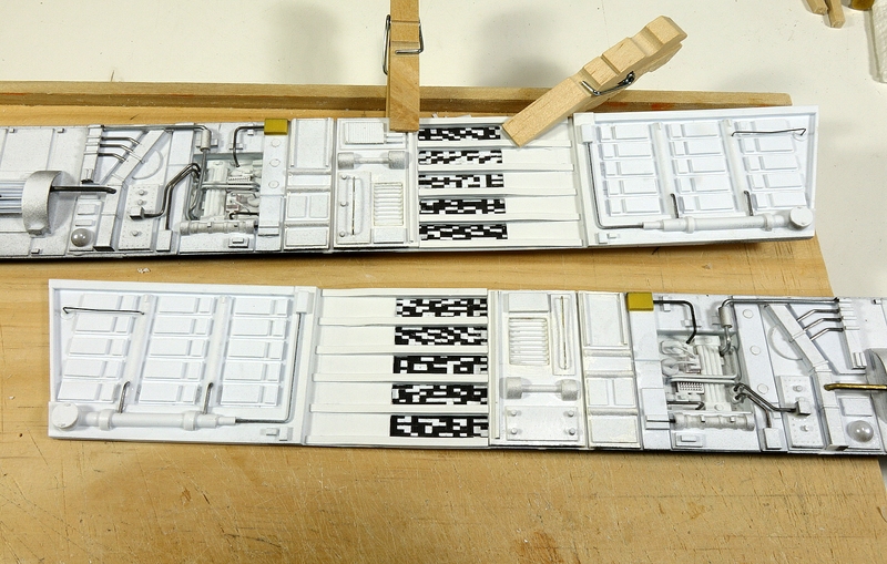

Began assembling the bow (or front "third") of the ship. There are a total of 15 individual sections/plates.
First, I glued the individual sections which contain the antennas. I slid them in, keeping them un-glued,
to align the pieces and ensure that they are easily removable.

I finally was able to mount the "window mask strips" behind their plates..

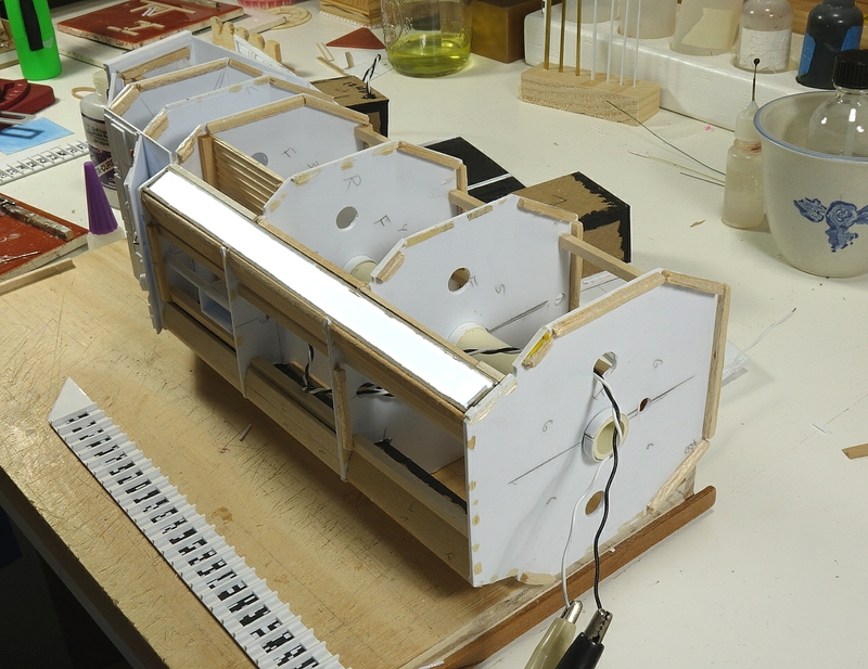

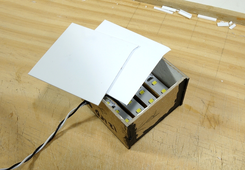

Each light box will have 2 separate pieces of .030" (.75mm) styrene as diffusers, which also dim down the brightness...
and even gave it a slightly blue tint. Exactly what I was trying to achieve.

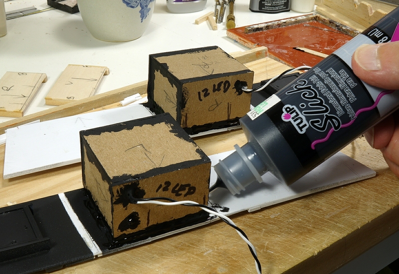

Mounted the boxes behind the windows, using black "Tulip" paint as light sealer/blocker.

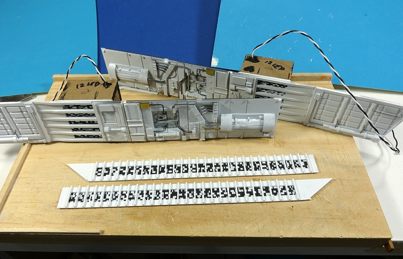

Lighted sections are ready for mounting....
The long narrow strips of light boxes at the "belly" also received the 2 sheets of .030" (.75mm) styrene treatment,
Checking brightness here....

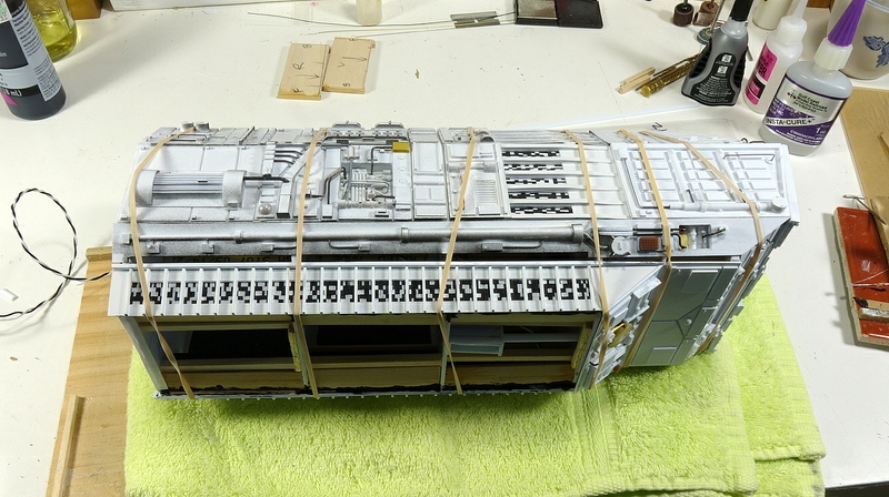

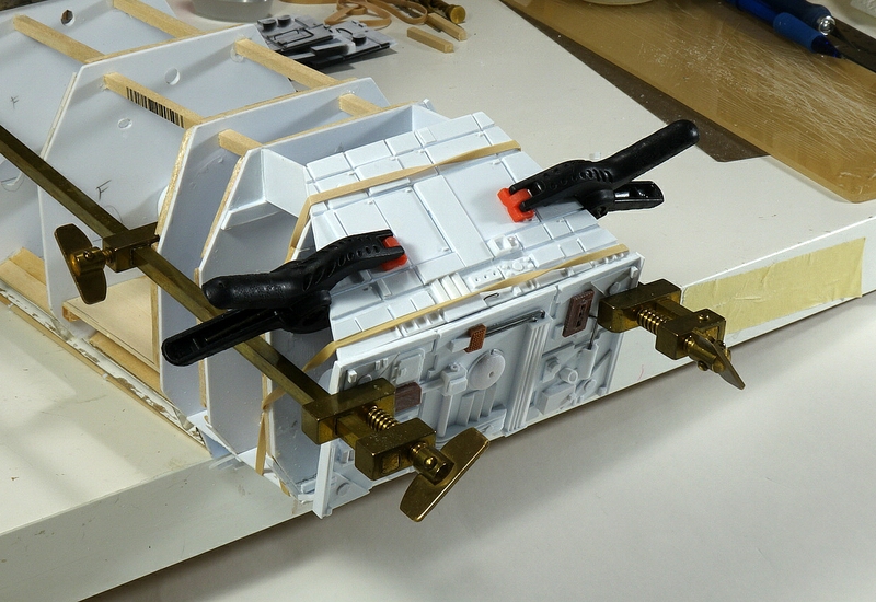

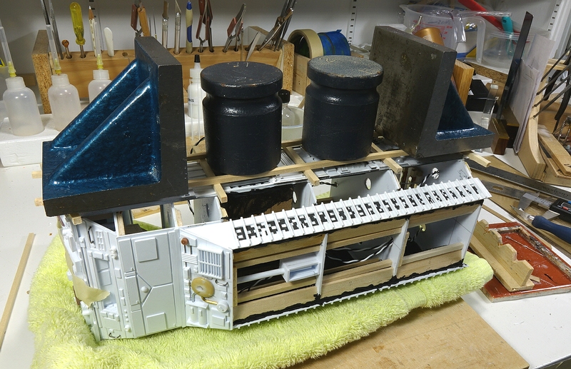

Glued down the windows, and then proceeded to attach the sides..

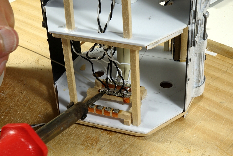

Now that all lights are installed for this area, was able to solder their wires in place. I use copper tape for voltage busses.
Also allowed for any additional resistors that may be needed to balance brightness later on.

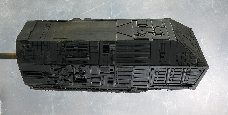

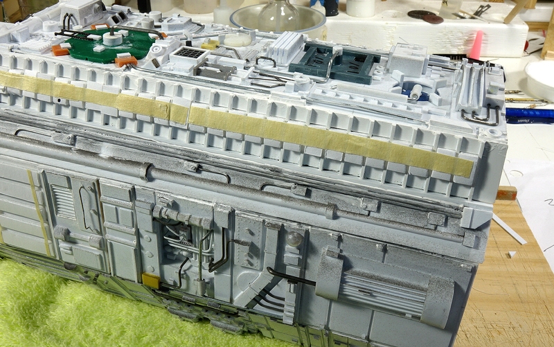

Last sections were glued on.....
Thinned "Perfect Putty" was applied to the seams and other areas with a syringe. In preparation for painting, I made
small foam core inserts to friction fit into all my window openings, then some masking tape to hold them in place.

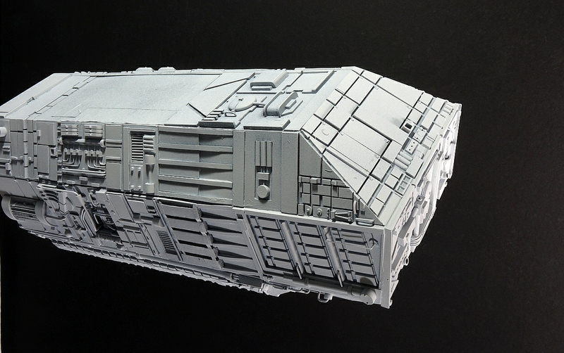

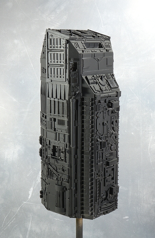

After some light leak tests and fixes, primed with flat black first.

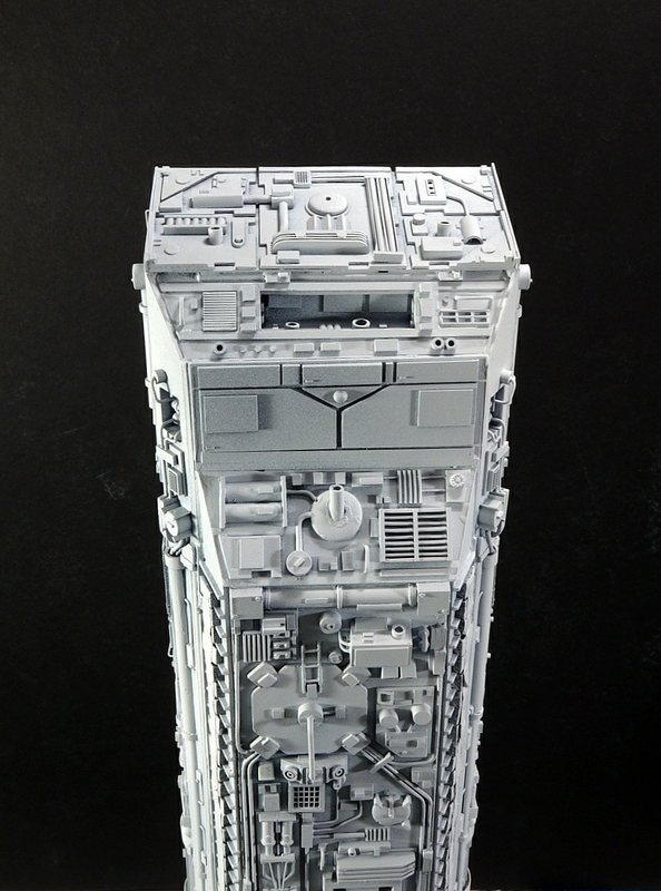

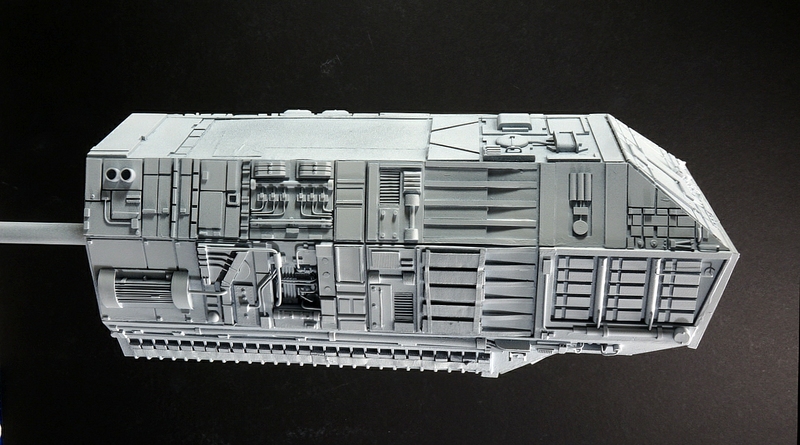

After the black primer dried, a flat white was applied..
Till next time...A LOT more to go....midship is next..
