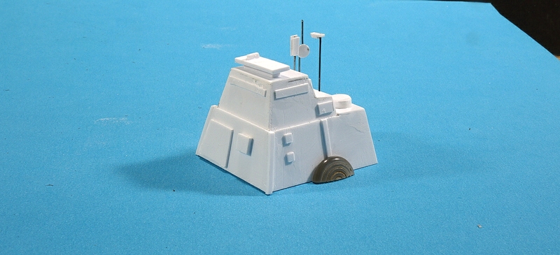

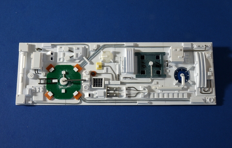

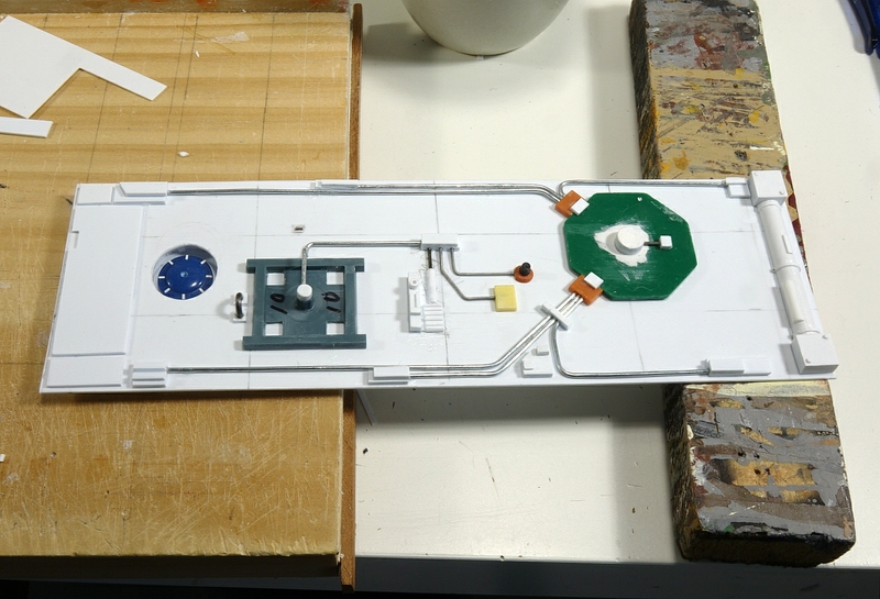

Worked on the bottom plate of the bow. The large green octagon is a 1960's vintage clothing button, and so is the
round blue dome in the recessed area. The large faded green square is the center of a kit sprue tree.
Filled it up with details, perhaps a bit too much......Once I get into the "zone" the time flies by quickly, and much gets done.

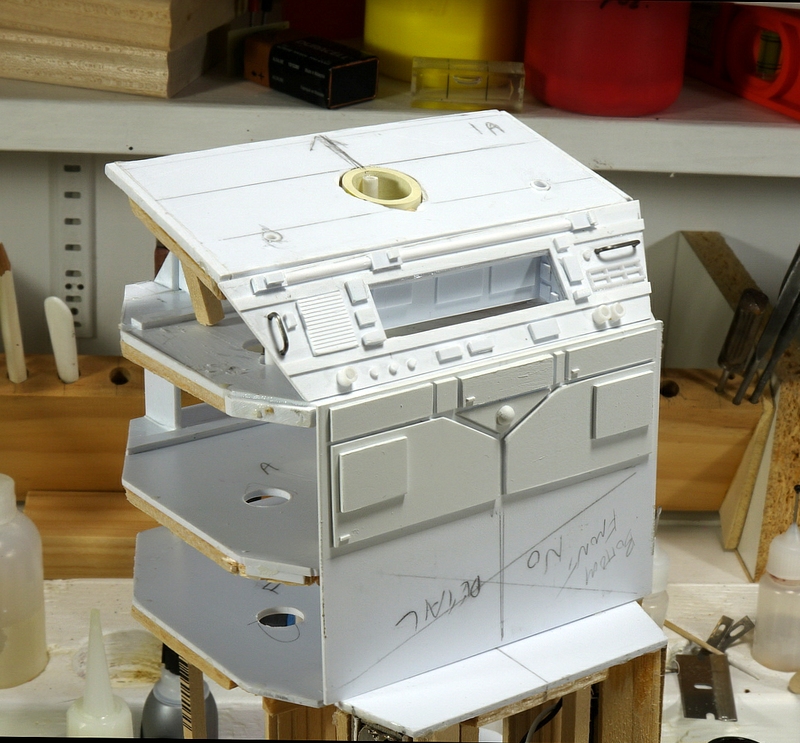

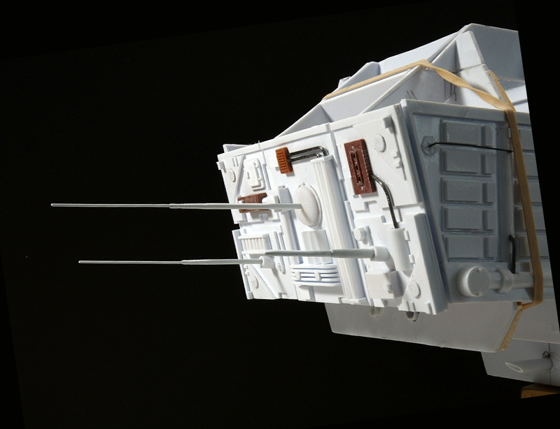

Moved over to the nose, which has two different sloping angles. Building these out to accept upcoming antennas.

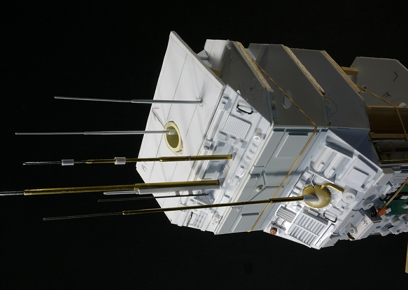

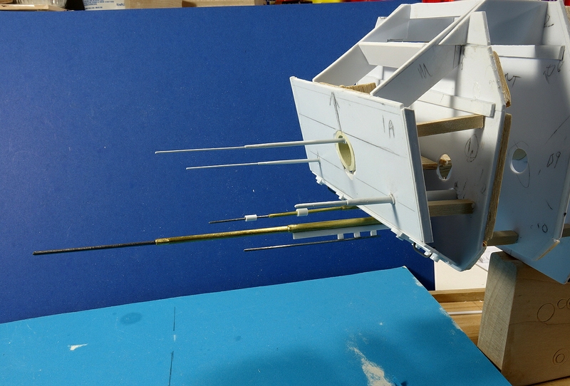

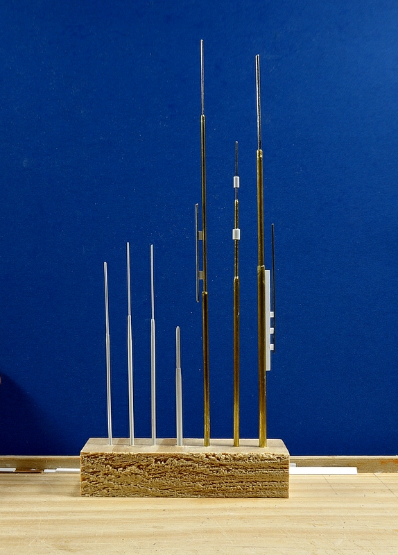

The antennas are K&S brass telescoping tubing, combined with florist wire. A few got primed,
the rest will get their chance later. I'm not sure why, but I really enjoy making these.
All antennas are supported inside the ship hull by styrene hollow tubing. The antennas are made much longer
at the base than will be seen, so they just slide in and stay in place on their own.
They will remain removable and not be glued....
Antenna area now complete. Front face plating next....
The front plate received less detailing...and is now complete.

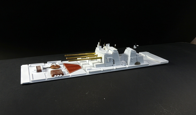

The guns on the ship are small, and I mostly followed the design from the concept art.

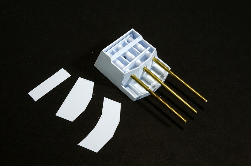

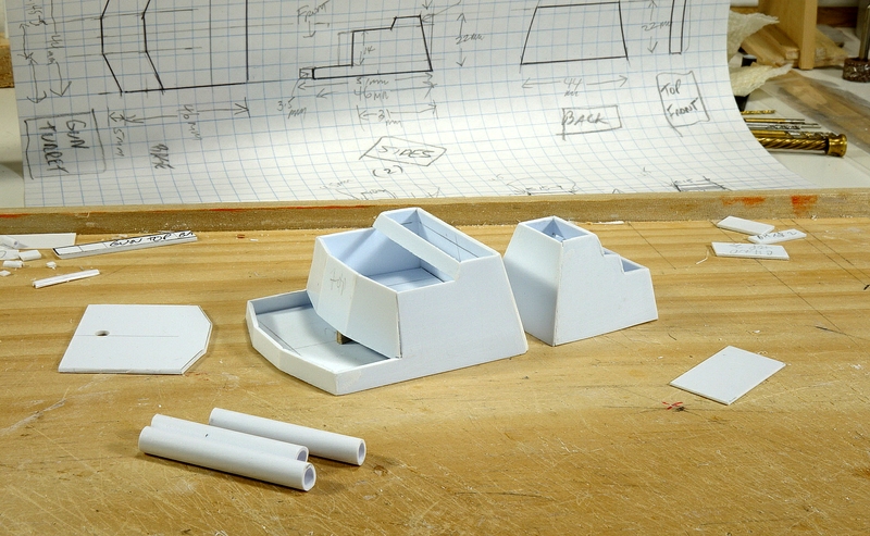

Based on the frustum of a pyramid, this familiar shape is widely used in the Star Wars universe. I drew up the
individual wall shapes on paper, and taped those to .04" (1mm) styrene. Cut them out and began assembly.

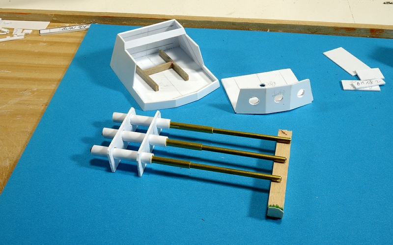

The interior will support 3 short guns I made of two sizes of brass. I built this support frame with styrene tubes,
firmly fitting the outer diameter of the widest section of brass.
The triple gun support assembly slides into place, here checking for fit.

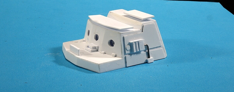

Starting to detail the main structure....

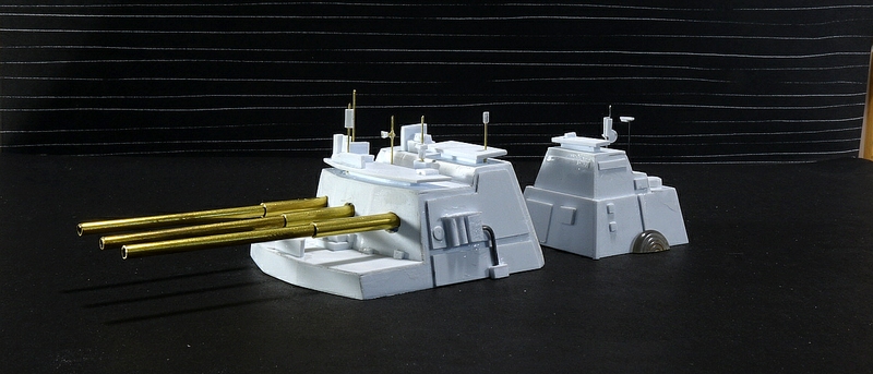

The 2nd structure receives its details...antennas were made from .02" (.5mm) florist wire or .016" (.40mm) brass.
Complete and ready for primer.
A simple base plate was added..
