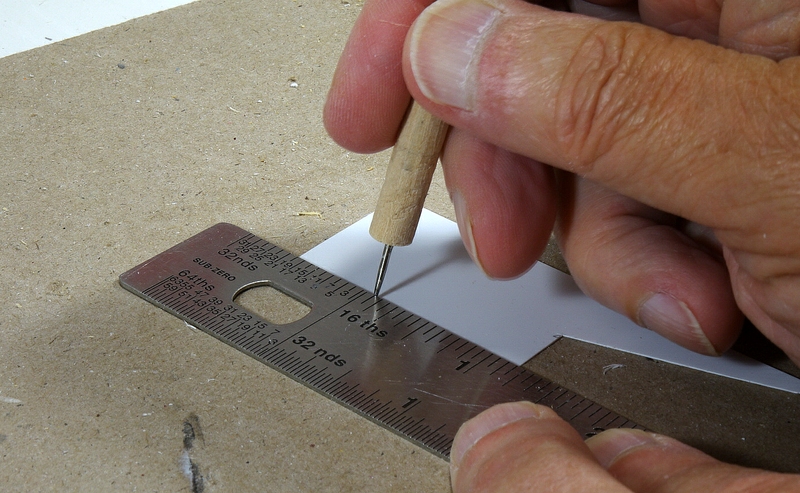

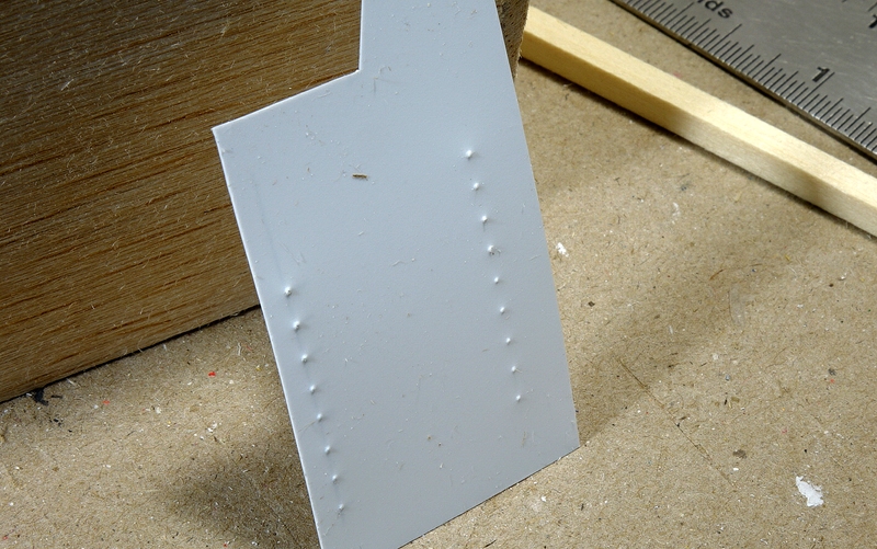

Cosmic again-- I make rivets this way- use a sewing needle or pin.... mount it in a handle of sort, and push lightly into very thin (.010" or .25mm)
sheet of styrene....use a ruler to keep them aligned and equidistant. Turn sheet over, apply to area. Done.
That a cool idea! I will definitely put that one in the back of my noggin for future use. Thank you for your reply!!

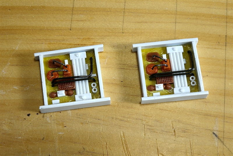

Continuing detailing the upper and middle sides of the bow. These two "boxes" will be recessed below the regular level as equipment pits.
These are about 1"(25mm) square. Colorful pieces harvested from elsewhere.
Boxes (now primed in white) in place and associated hardware was built up around....

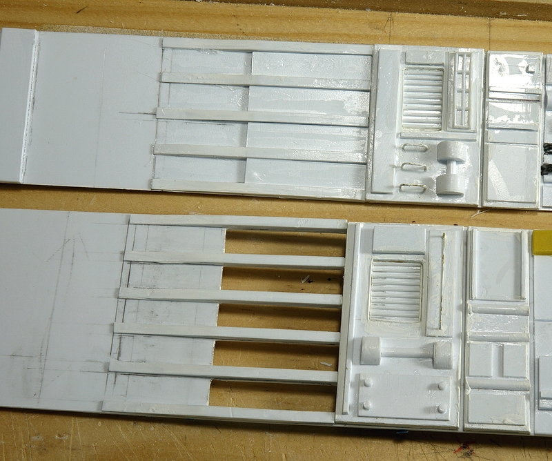

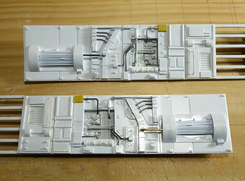

This "6-channel" contraption and related piping is approximately center of the length....the "shine" is just Weld-On 3 residue.

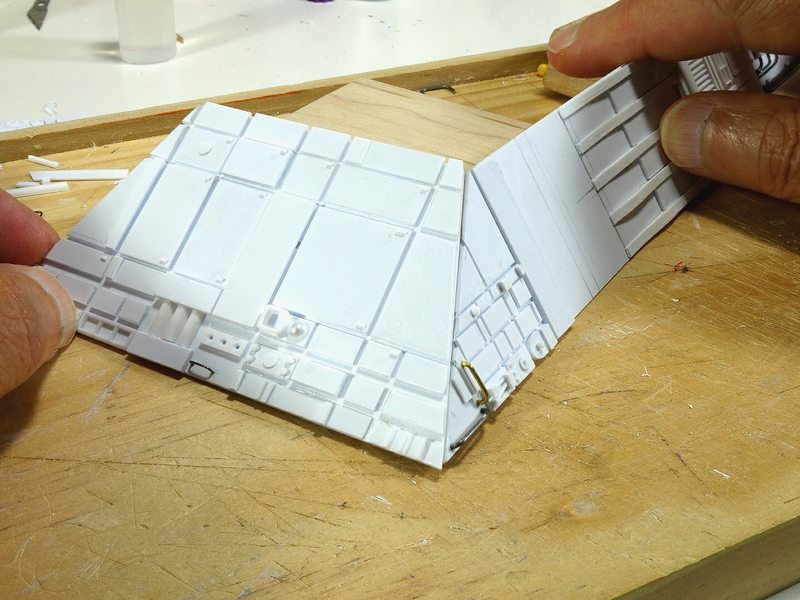

Similar to the concept art, I treated the window cavities with a sloping trim...
I began a less complex upper nose section.

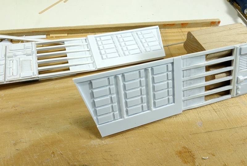

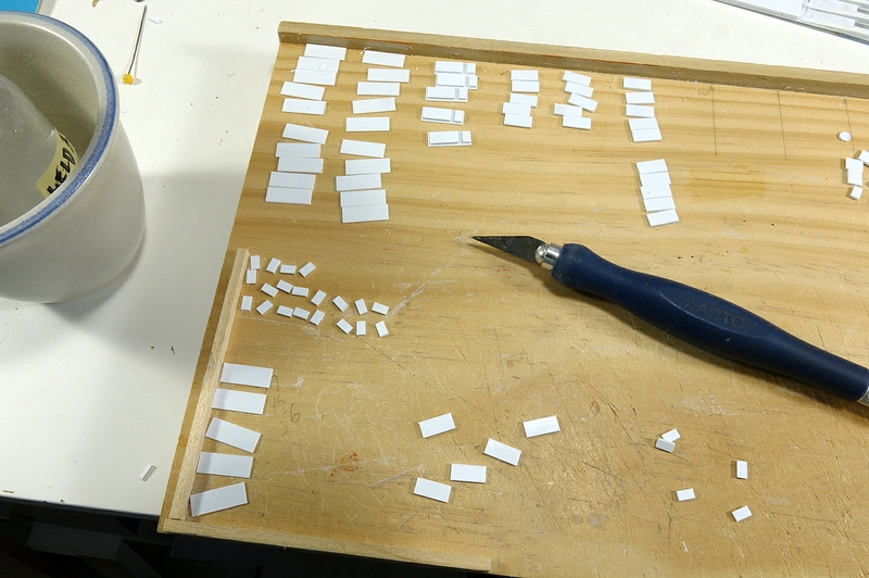

I made 30 (15 for each side) "environmental/life support" monitors. Pieces are cut out.

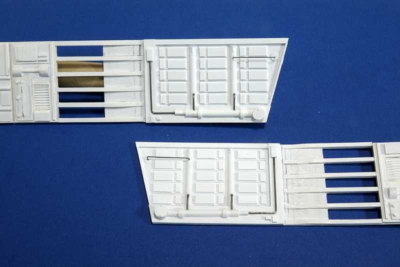

Assembled & glued in place.
Complete, with some additional piping..
