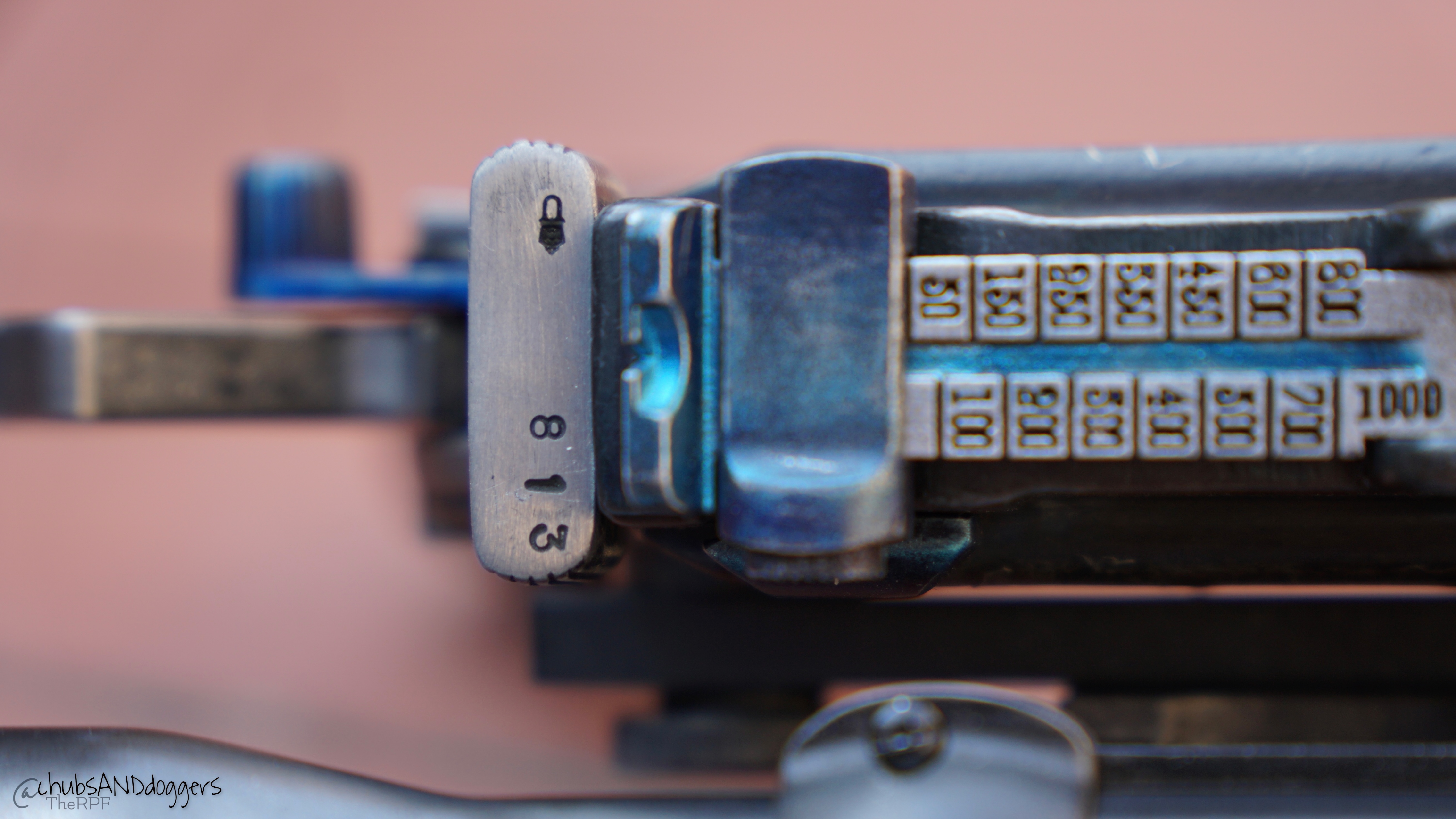

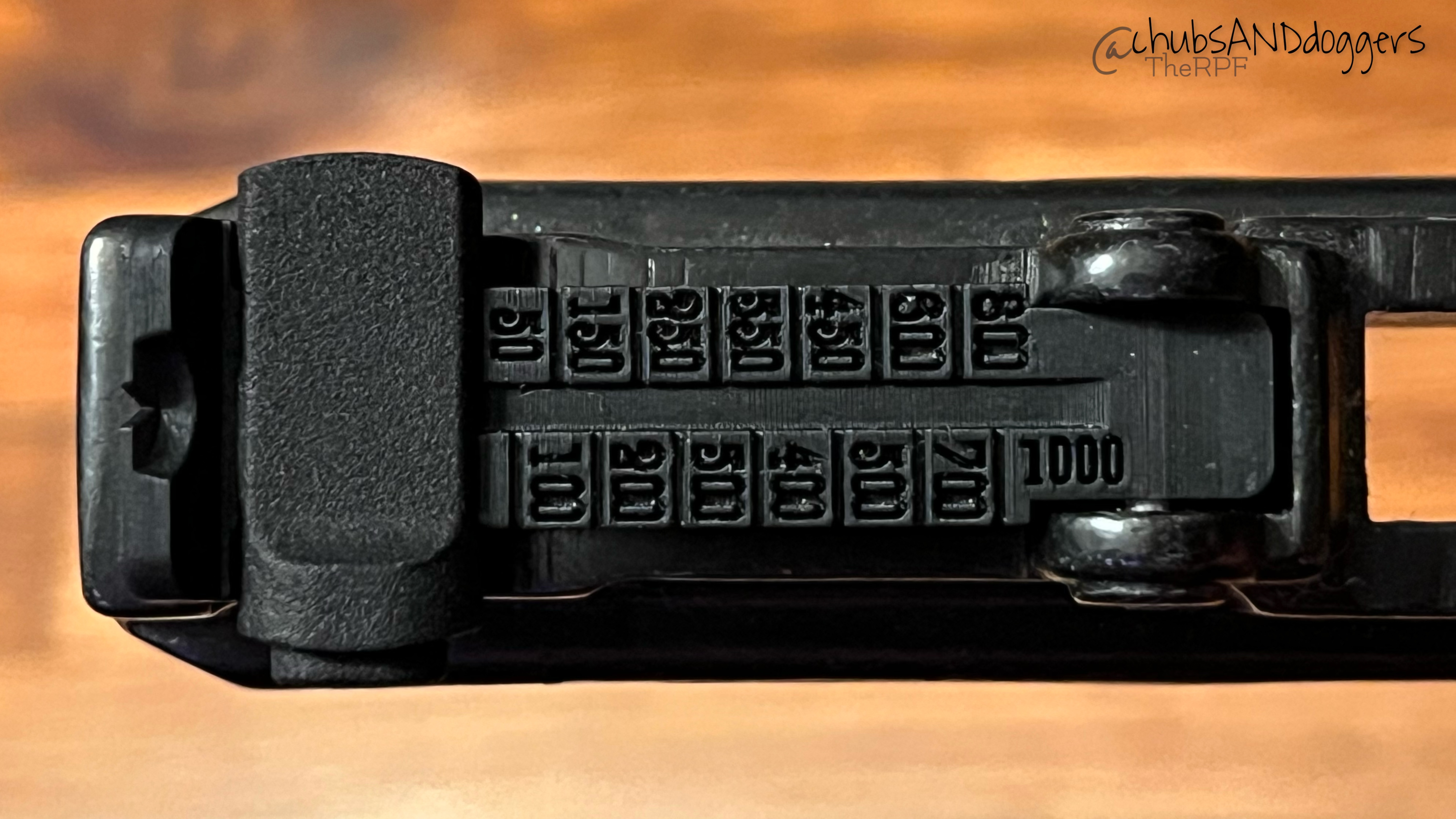

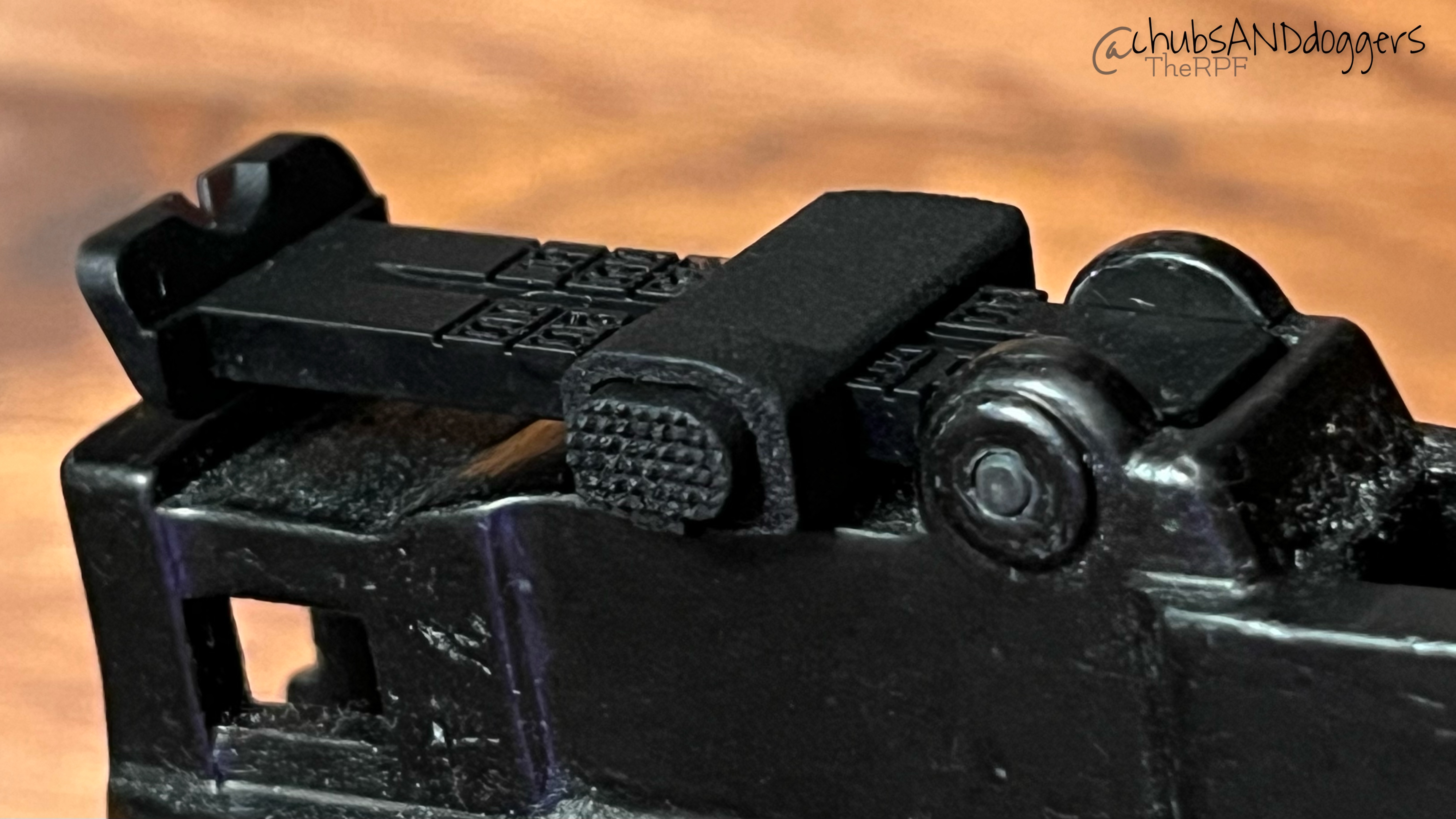

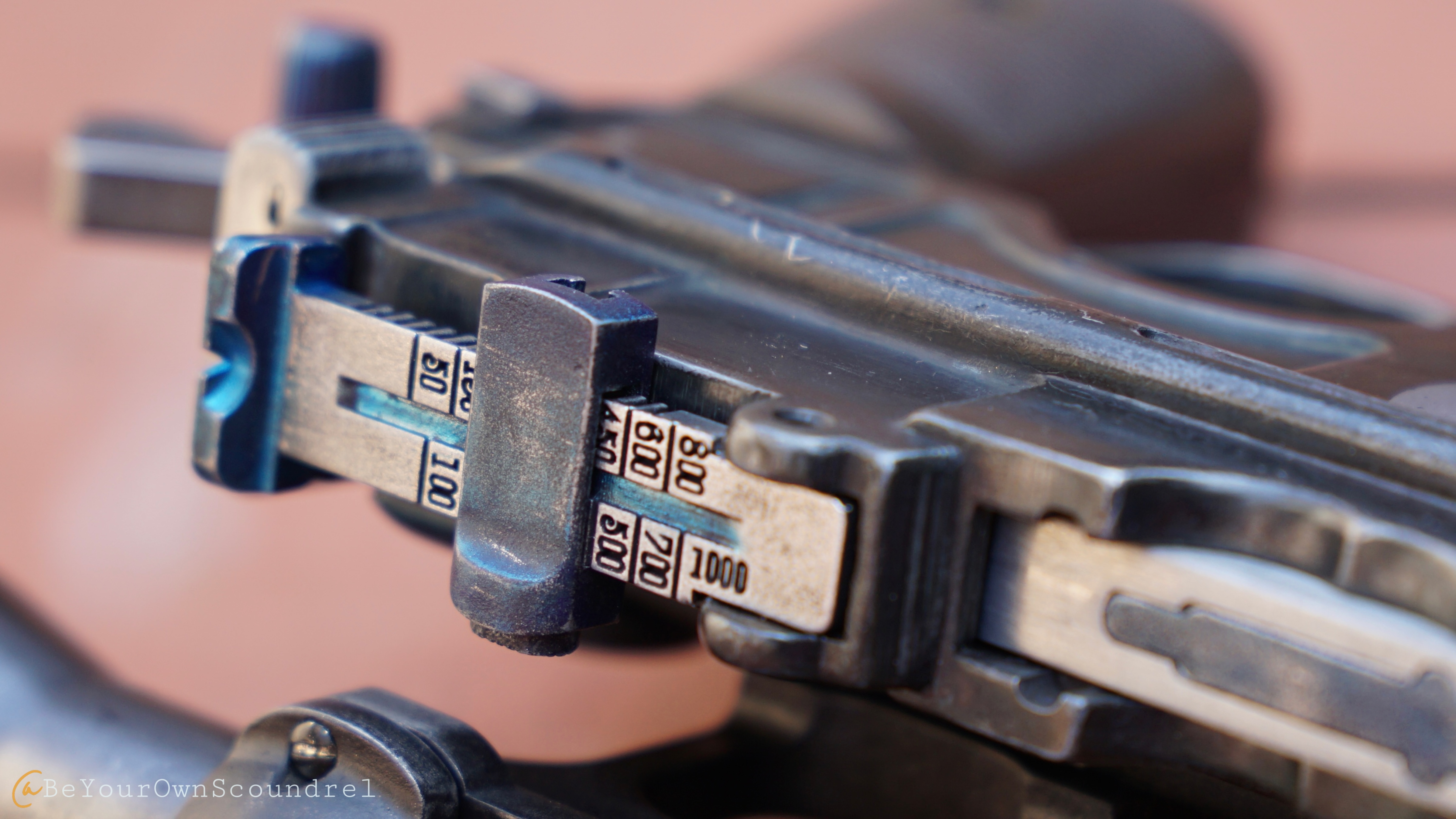

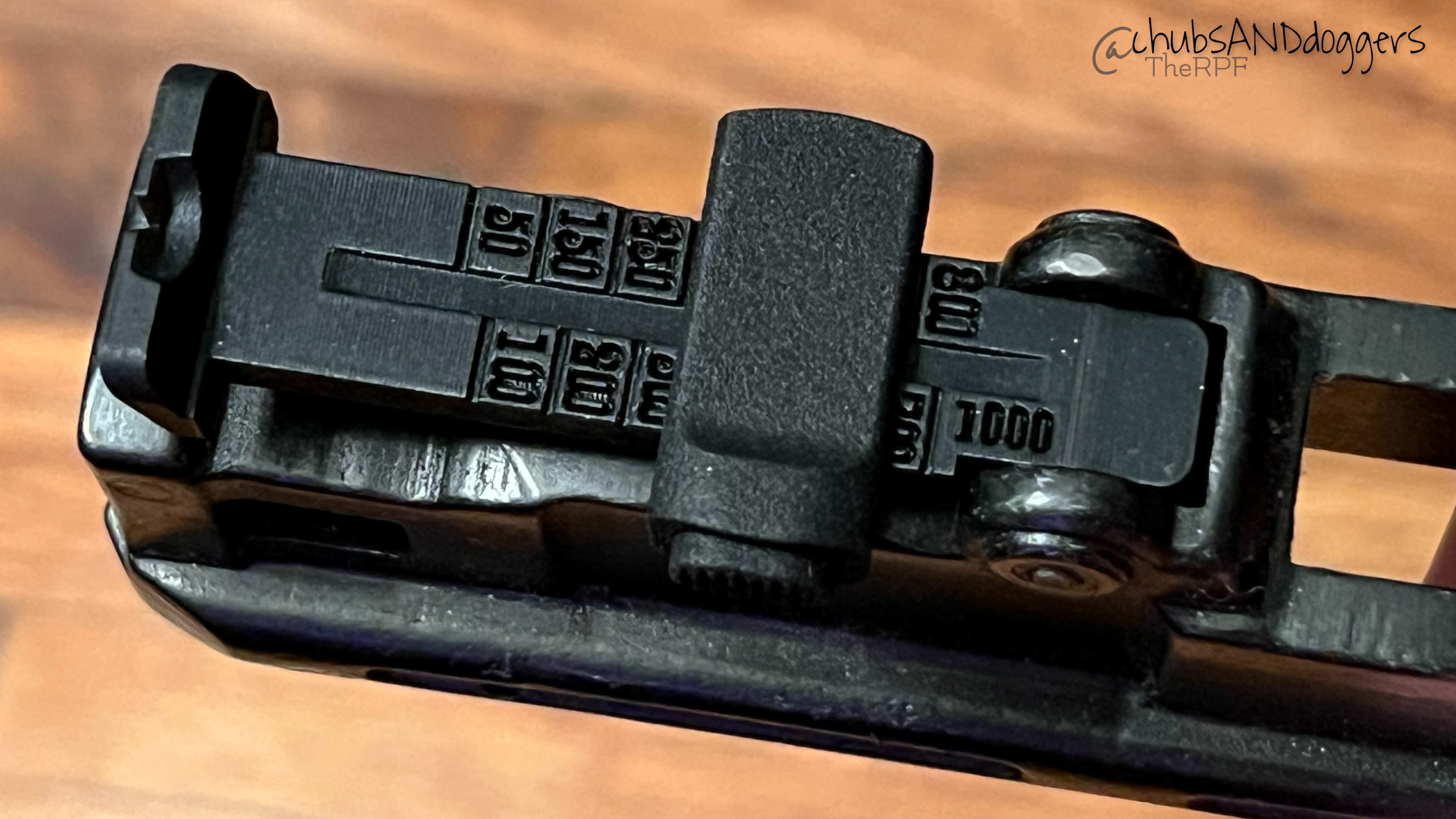

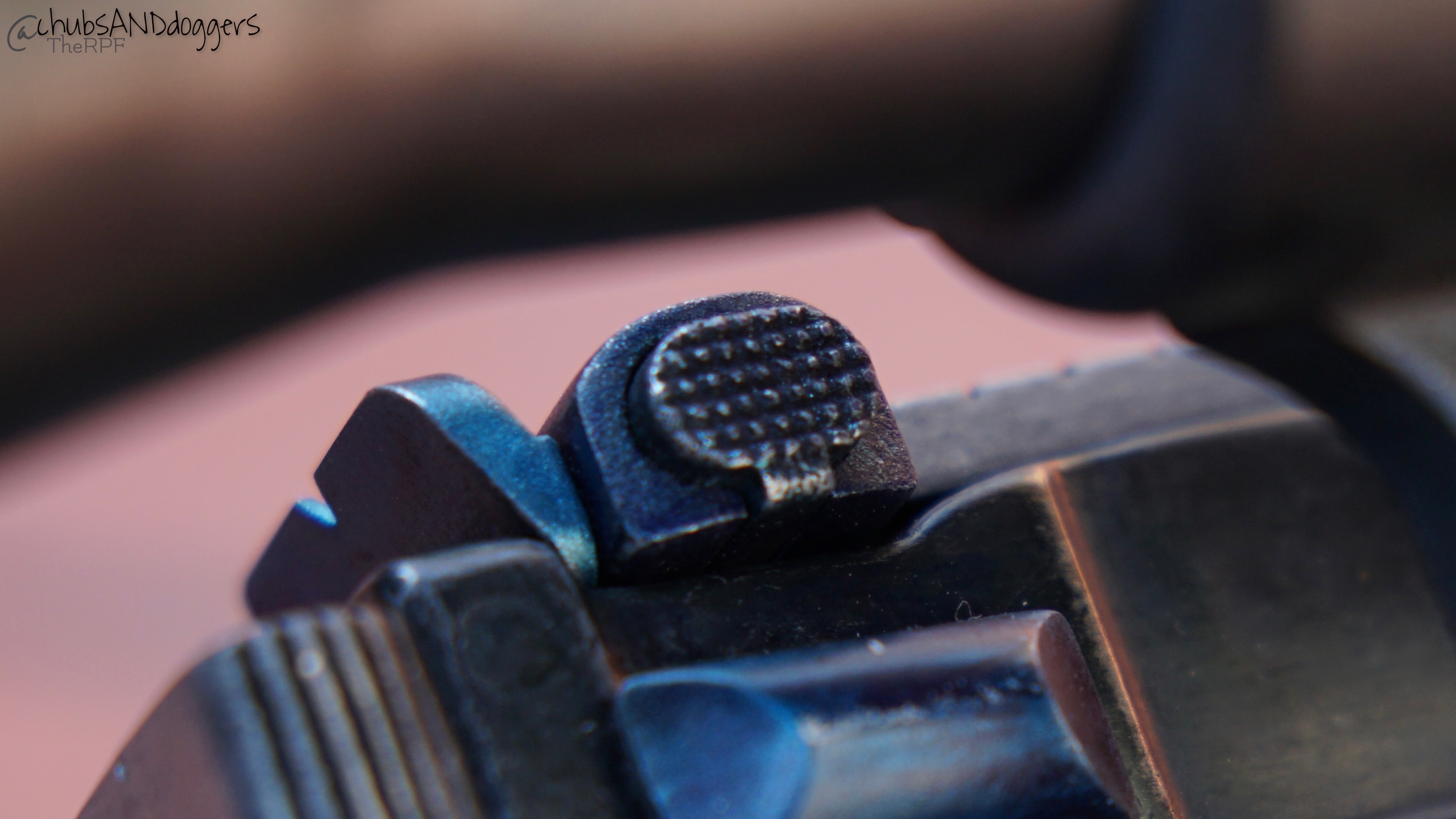

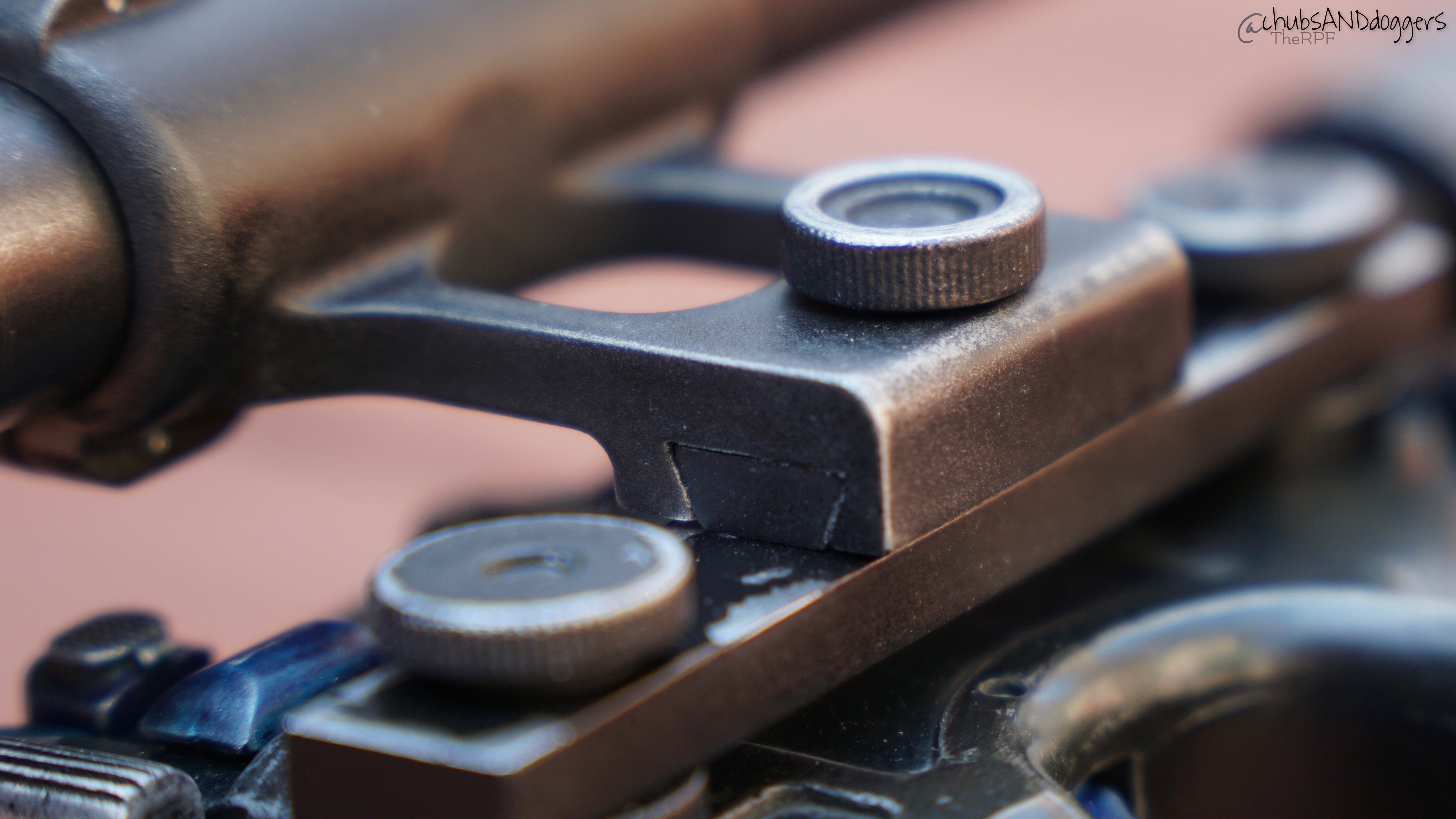

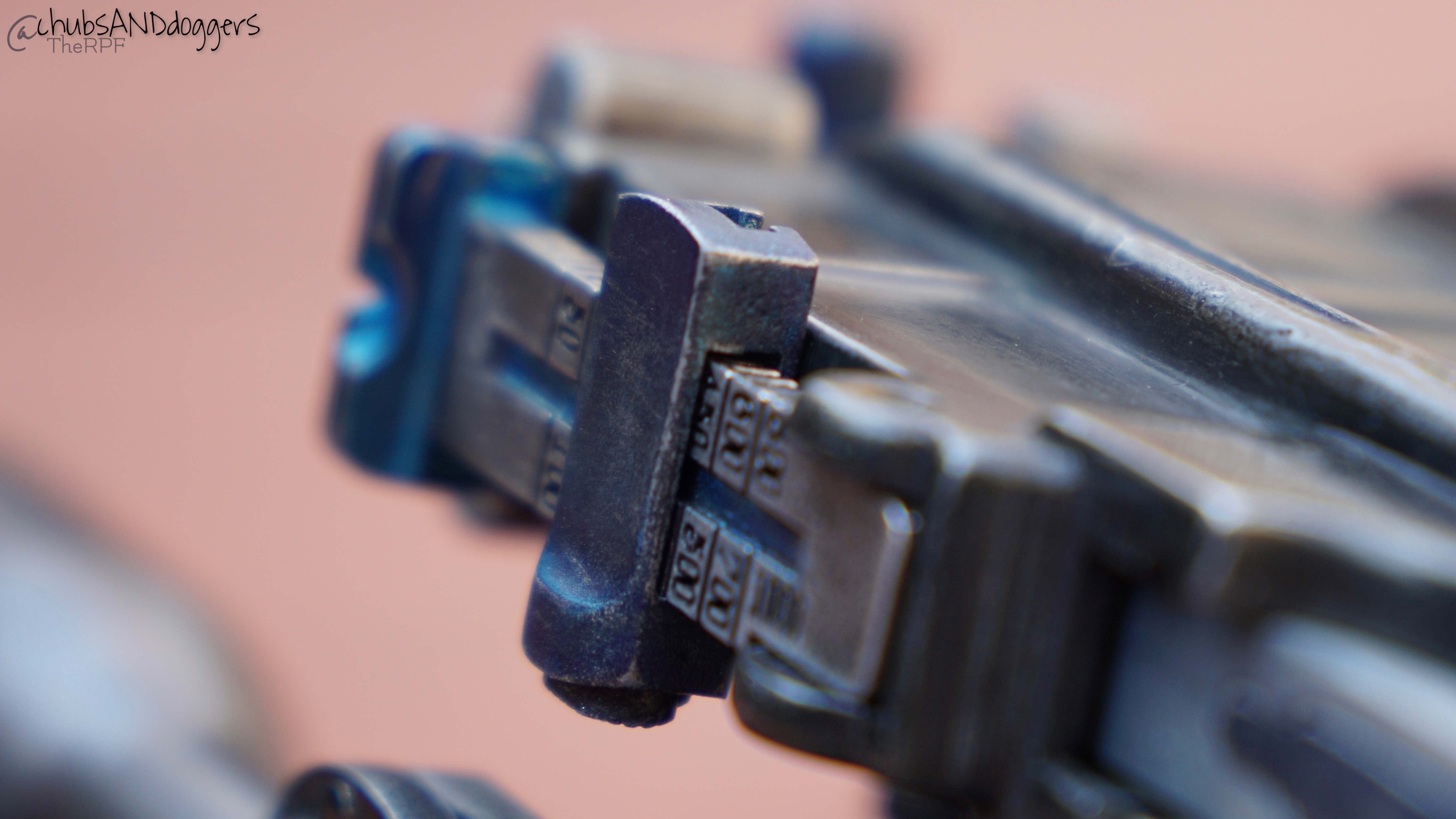

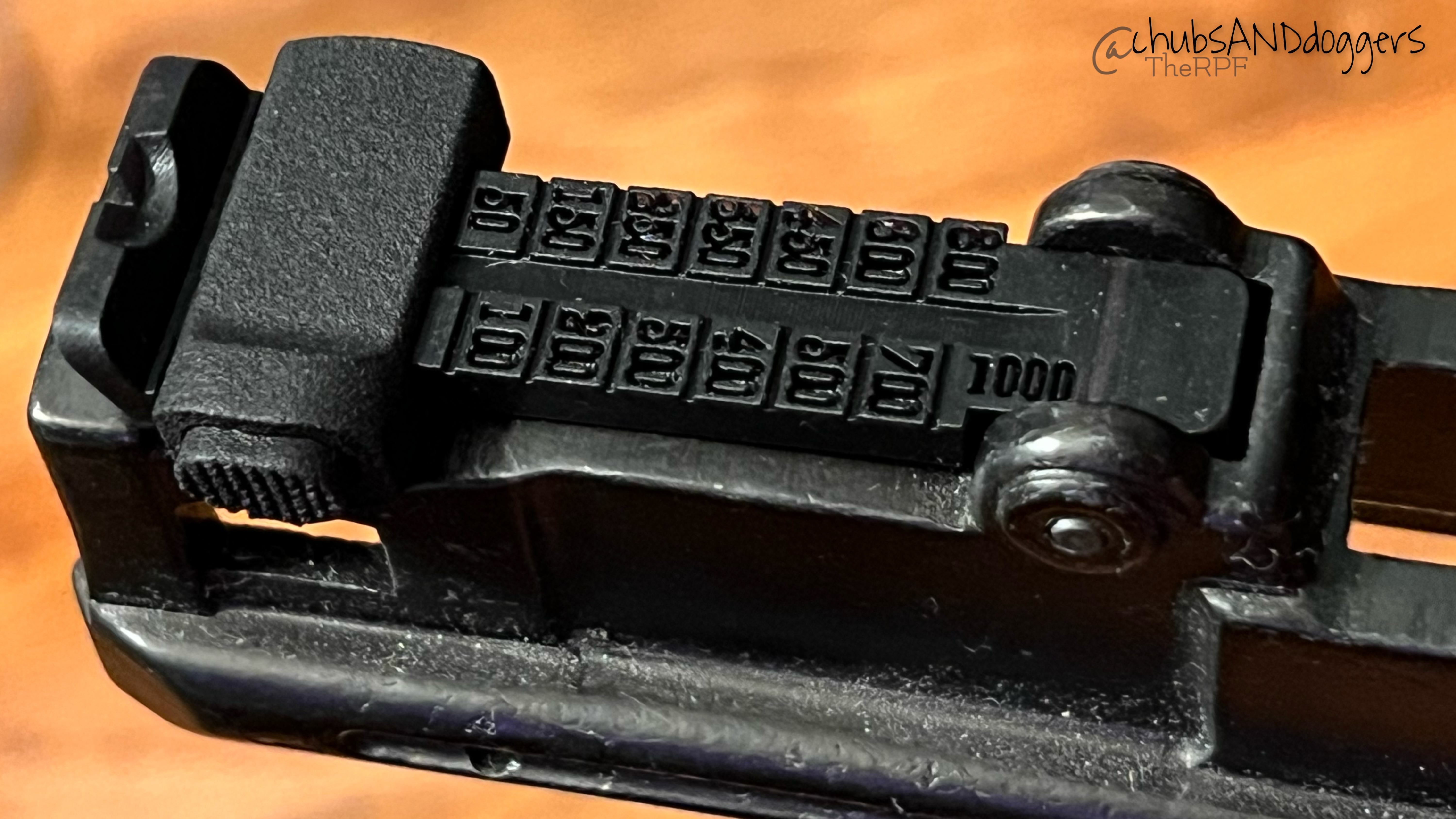

Recently created an accurate Sight and Slide substitute for the Denix. This is the c96 version but I‘ve also have created the MGC version as well. Works really nicely and another subtle improvement towards the Denix..

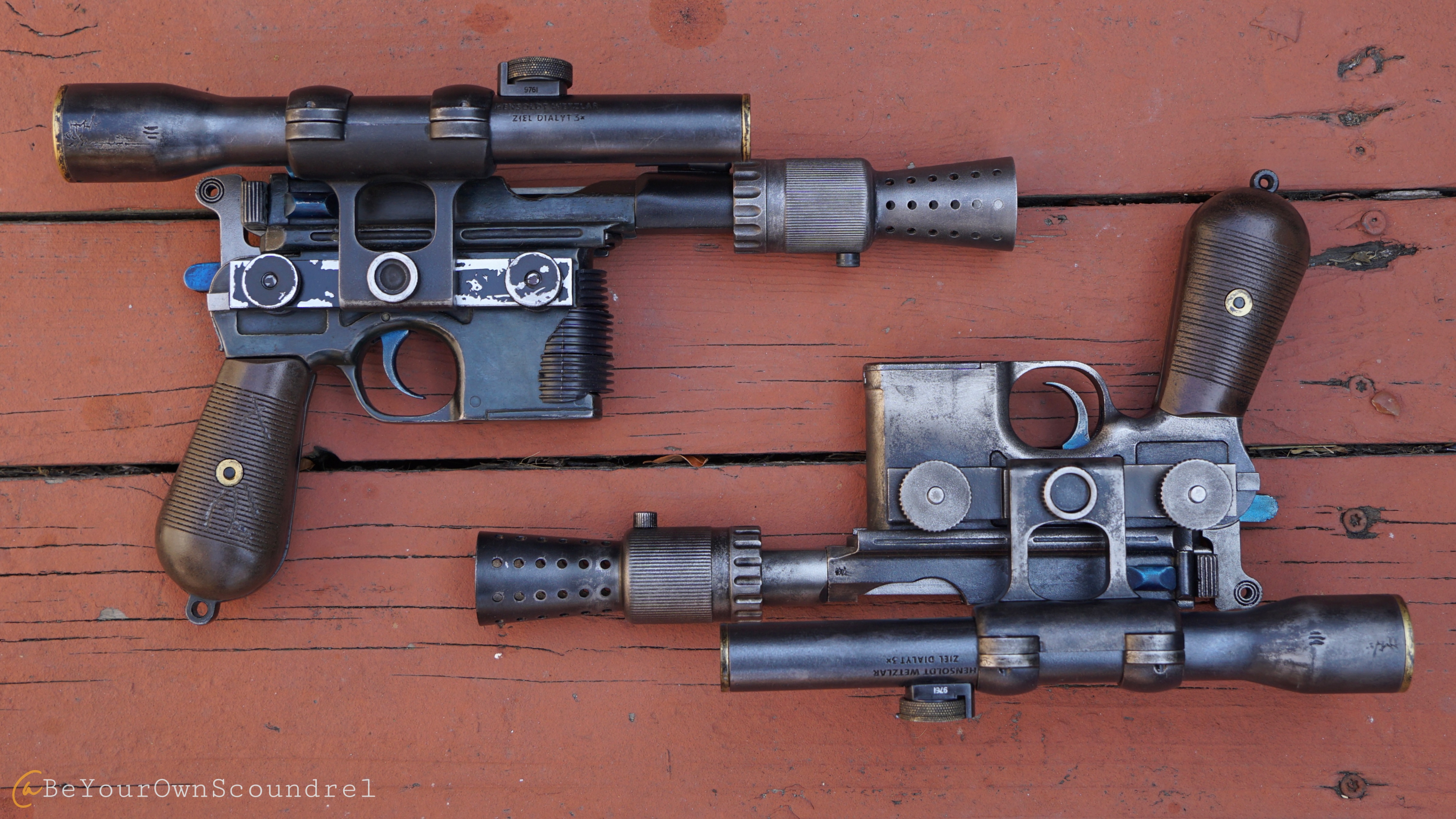

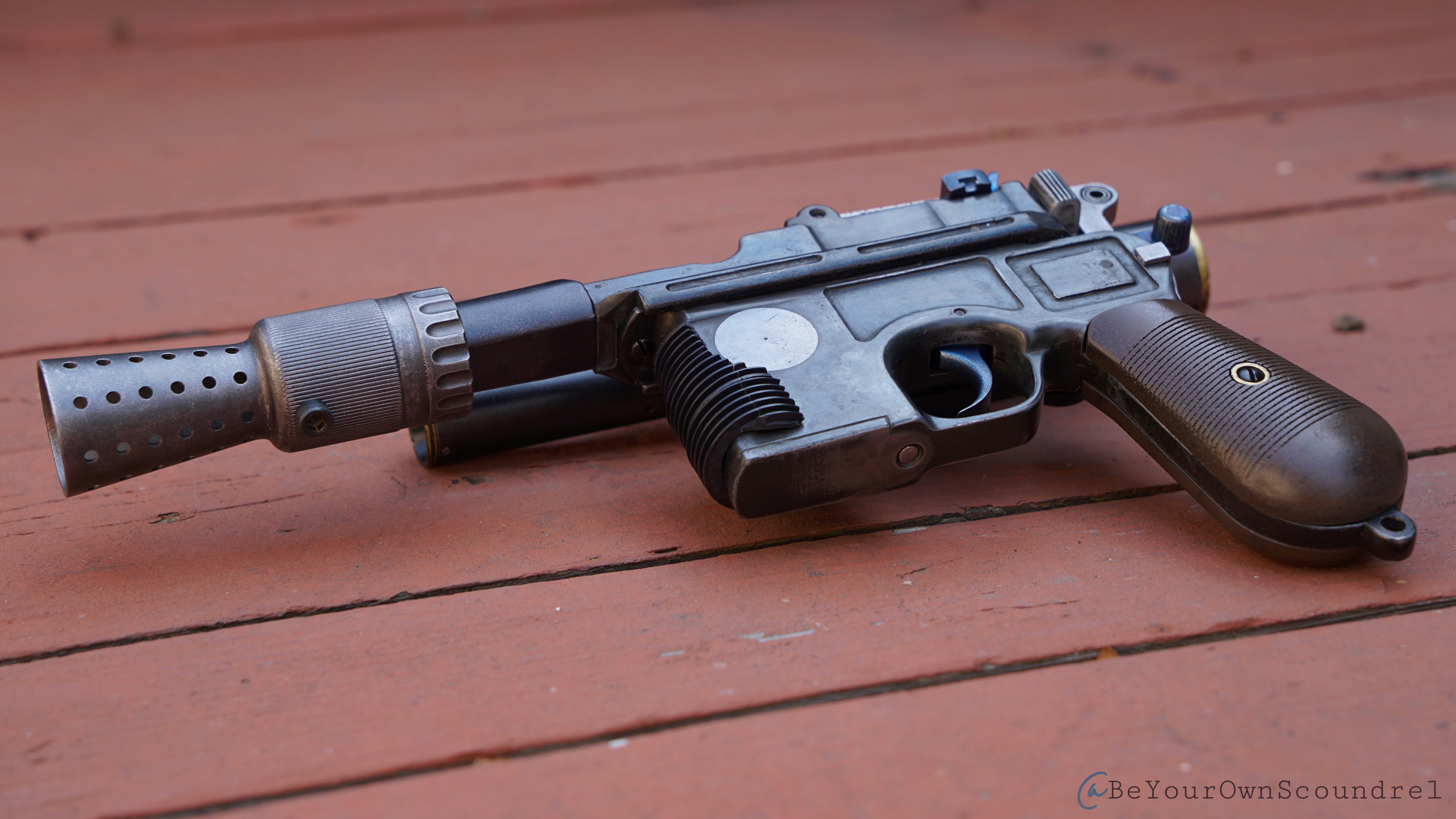

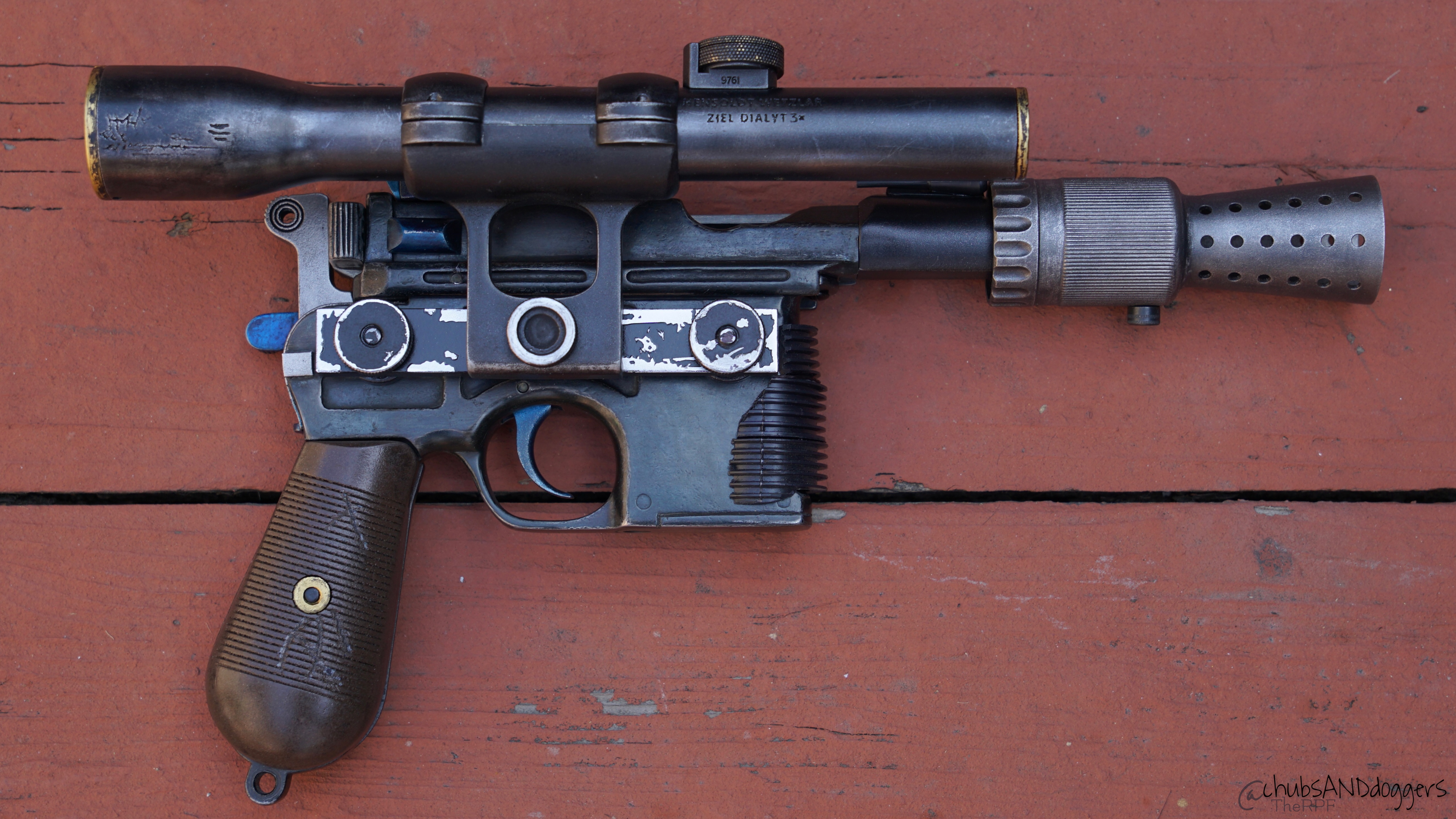

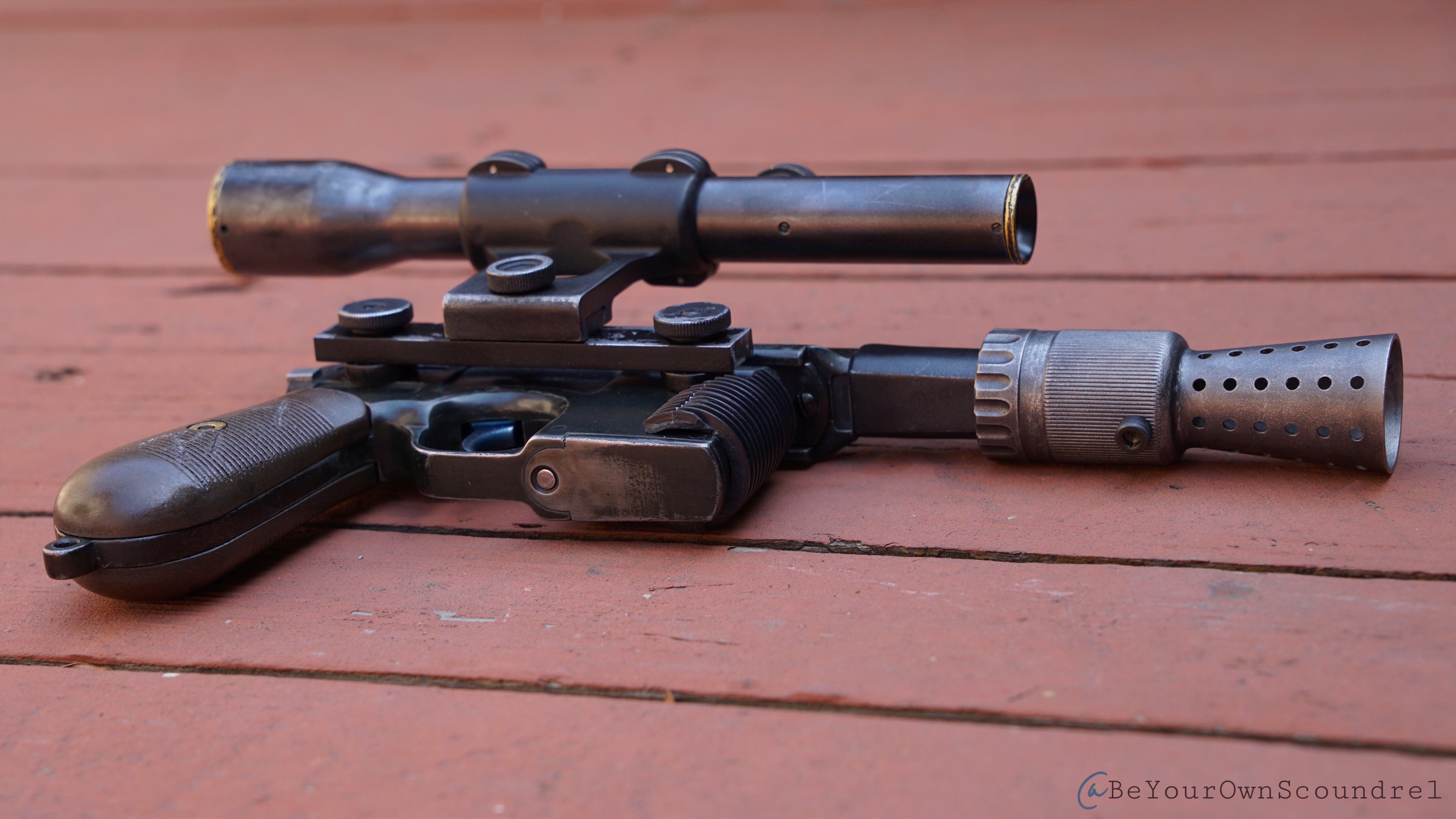

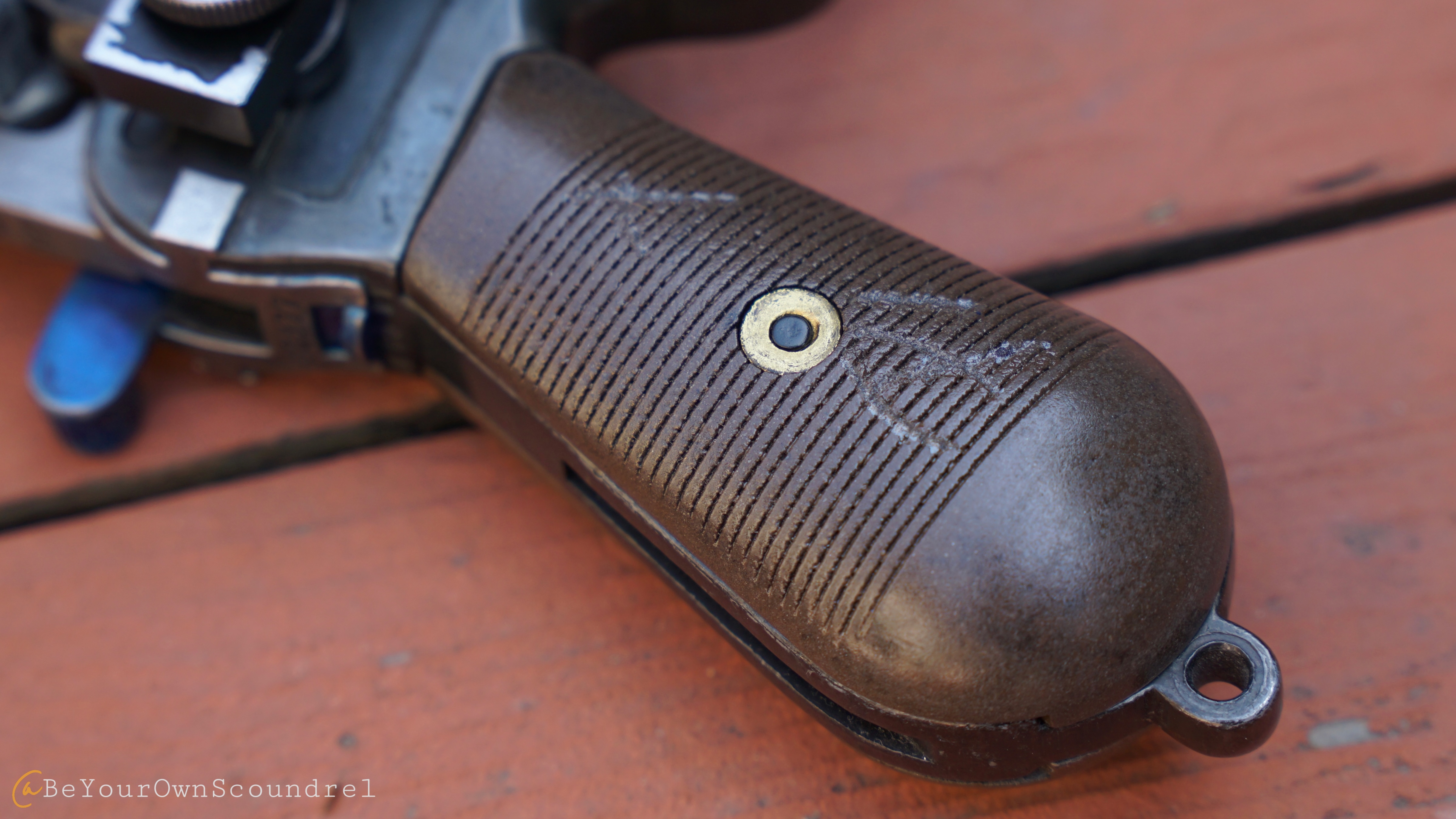

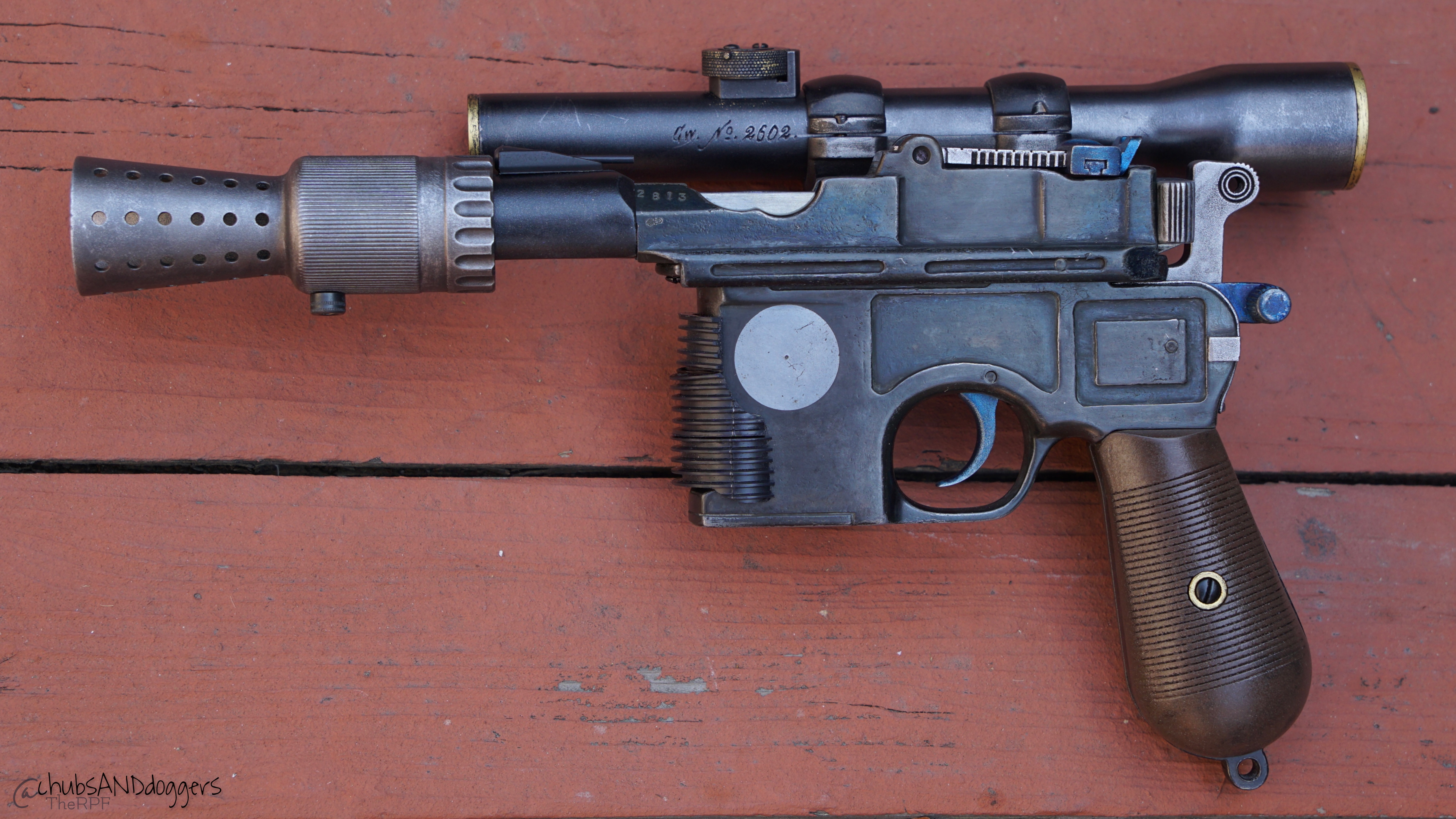

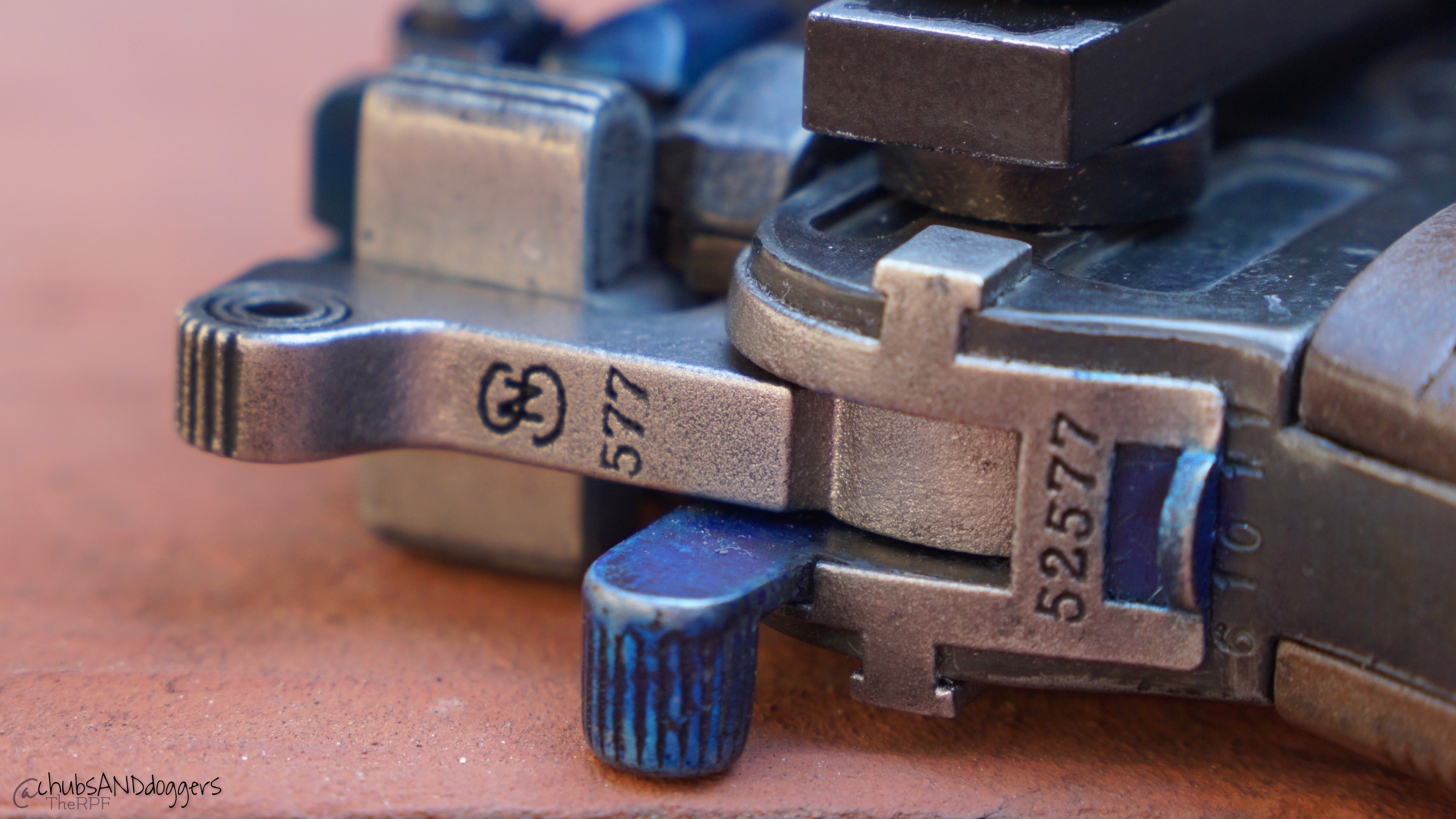

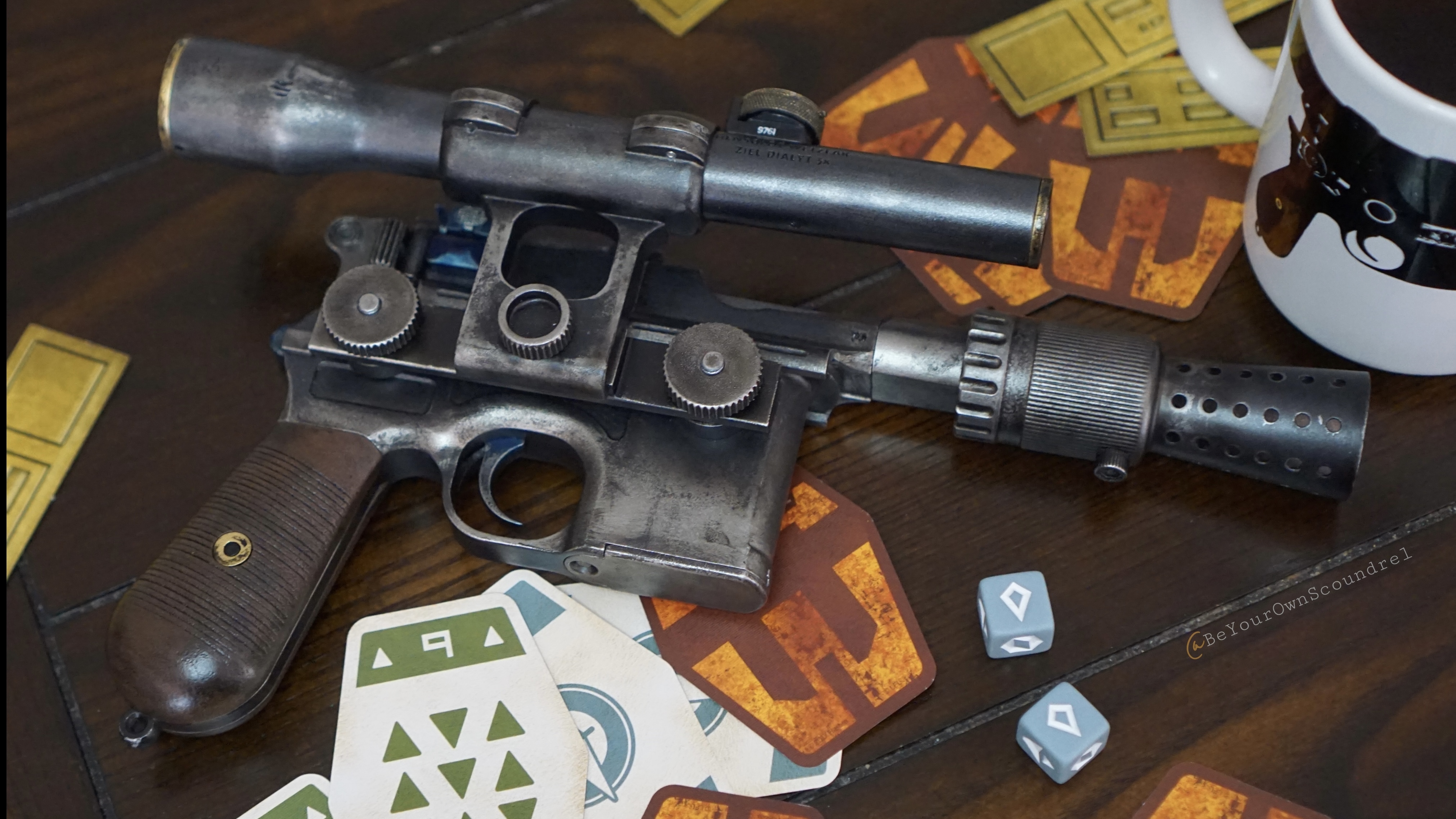

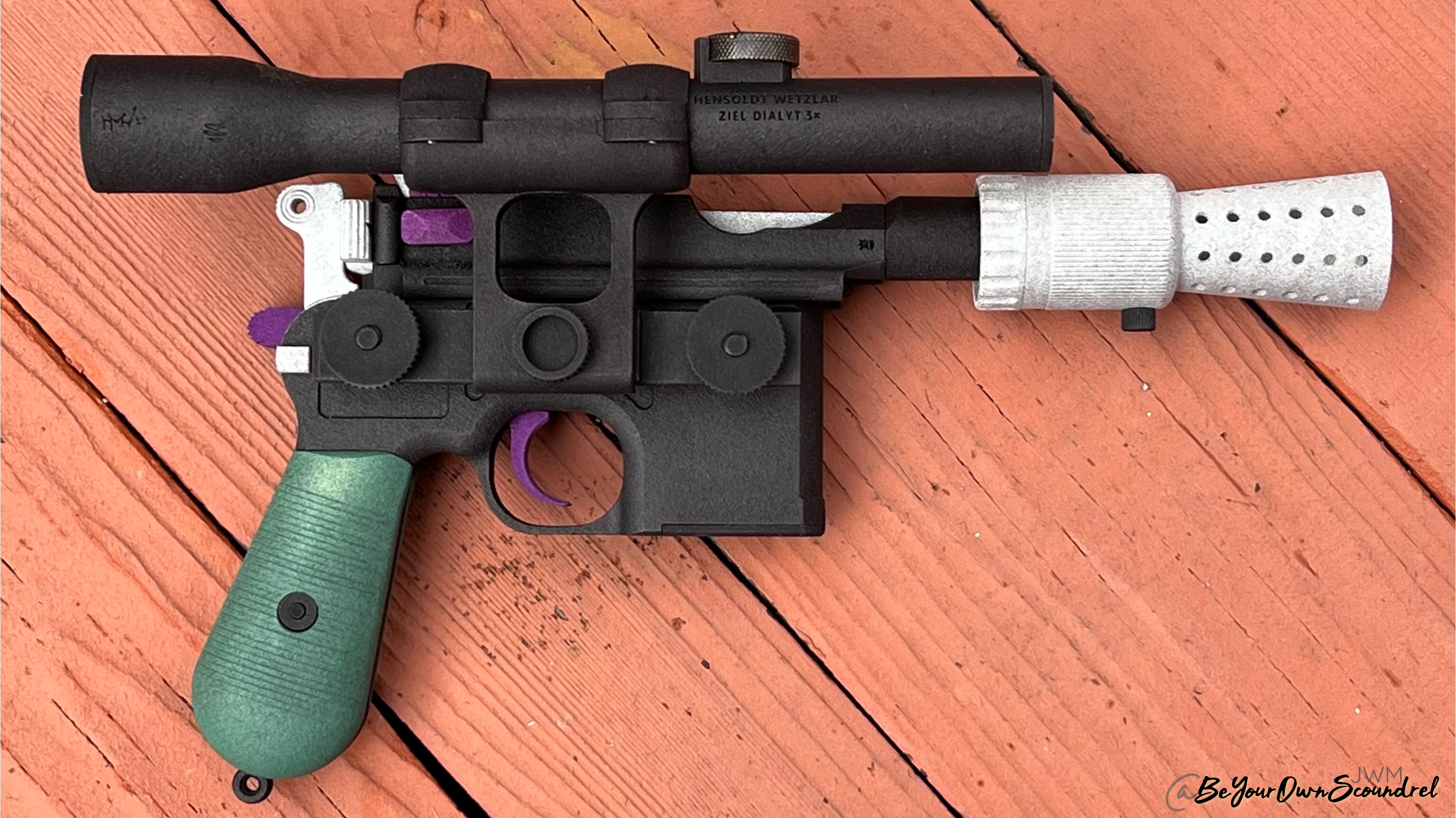

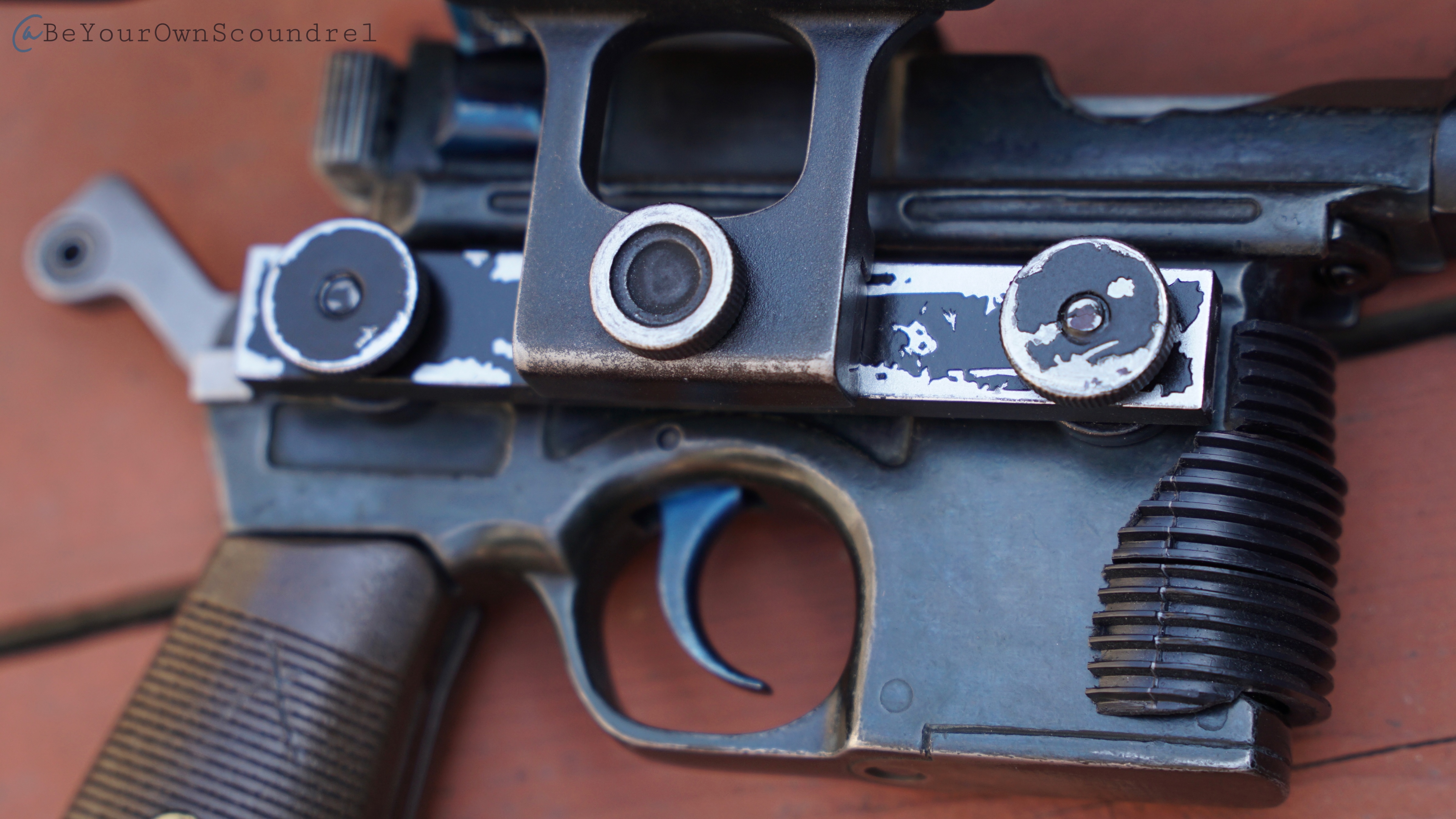

Here’s a before and after pic of the PS/RIA Bapty constructed DL-44 I recreated finally finished up. I designed it last summer but only had it printed towards the end of ’22. Commission builds keep me from painting it but recently made it a priority to finish this one for myself. All controversy aside its kind of fun to think that at this moment there is only two like this in our galaxy.. the actually prop that went to auction and this here recreation,

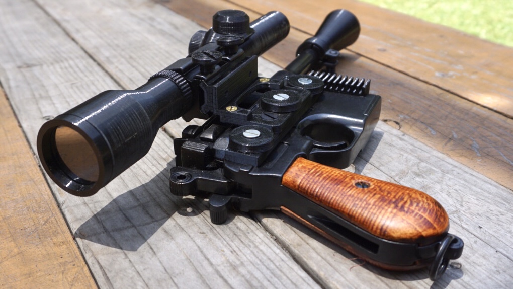

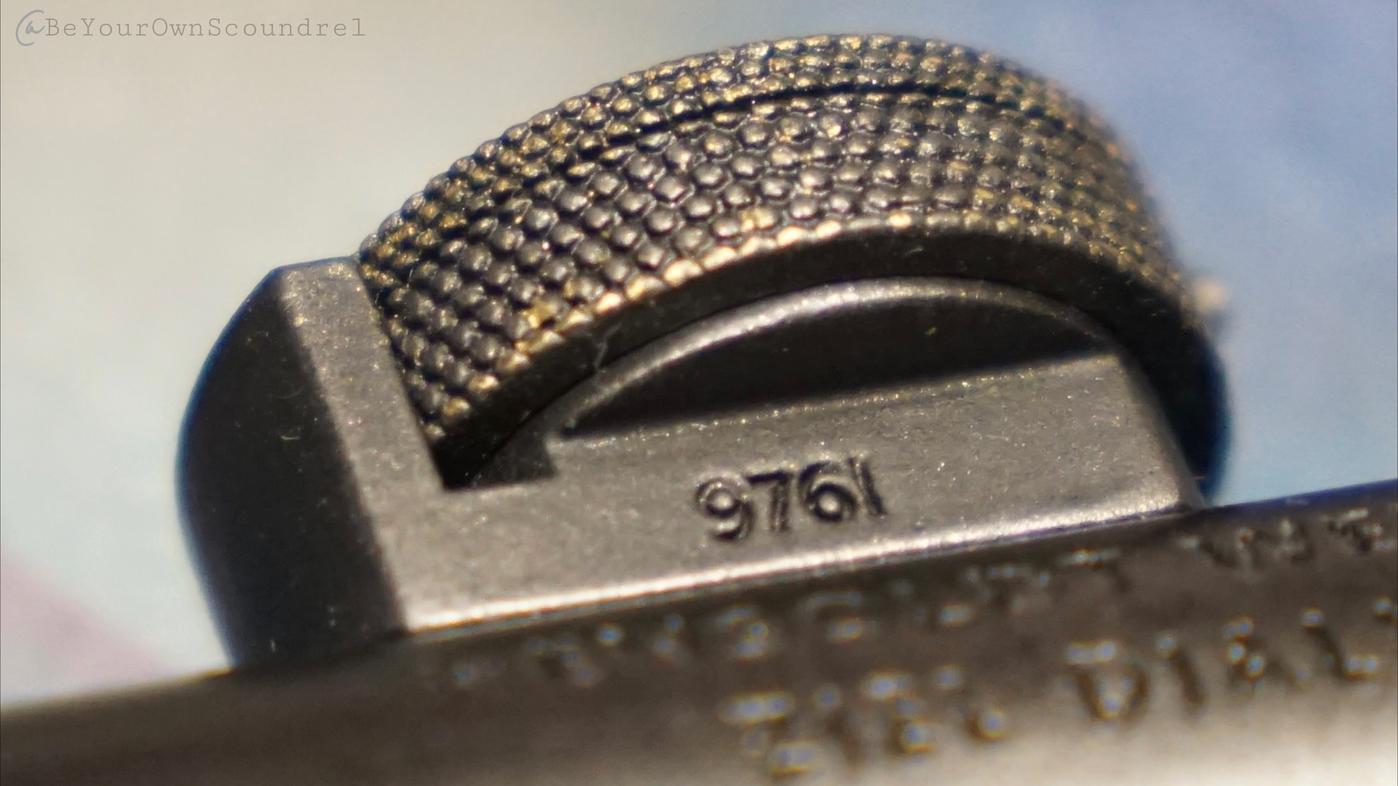

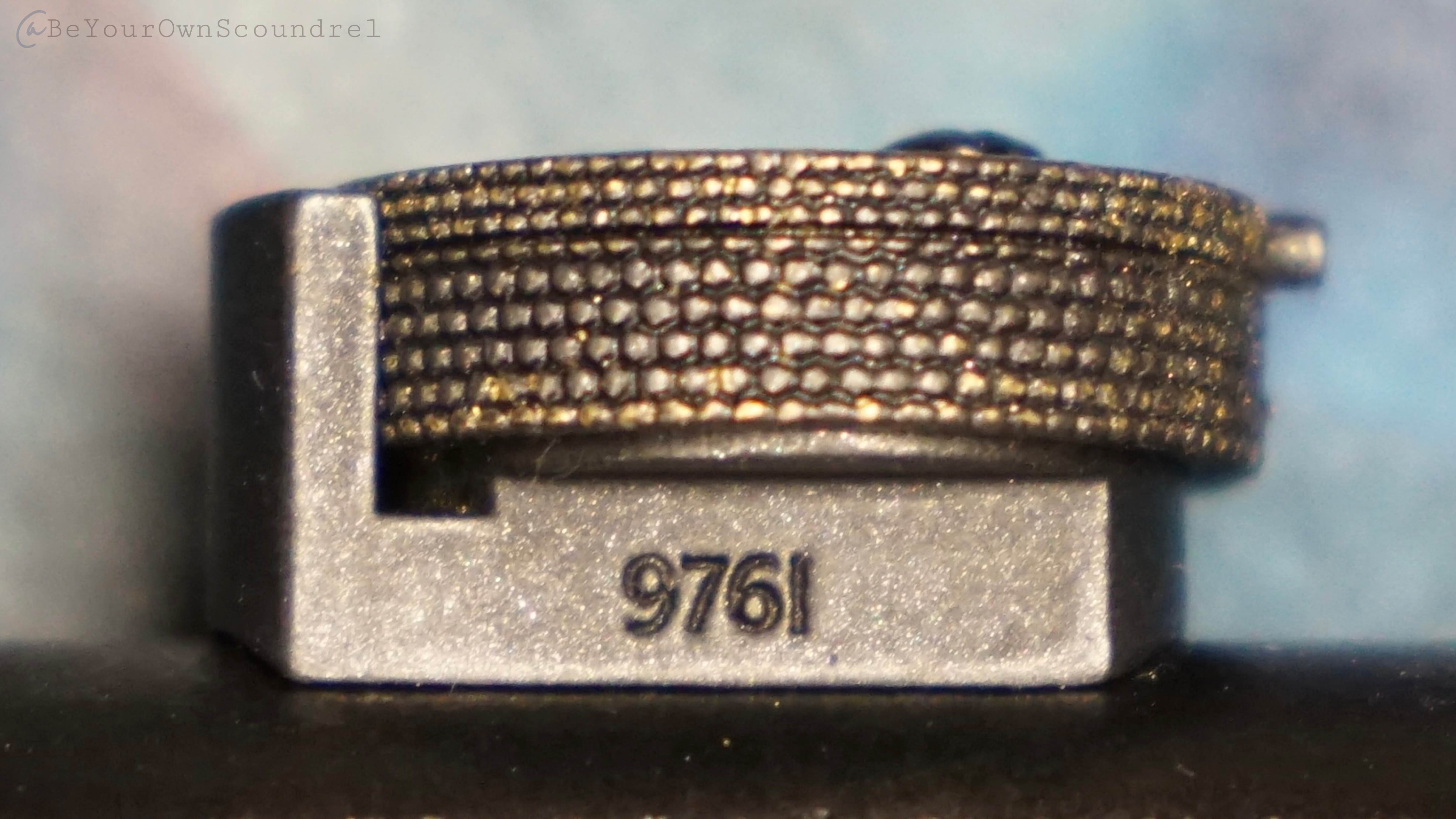

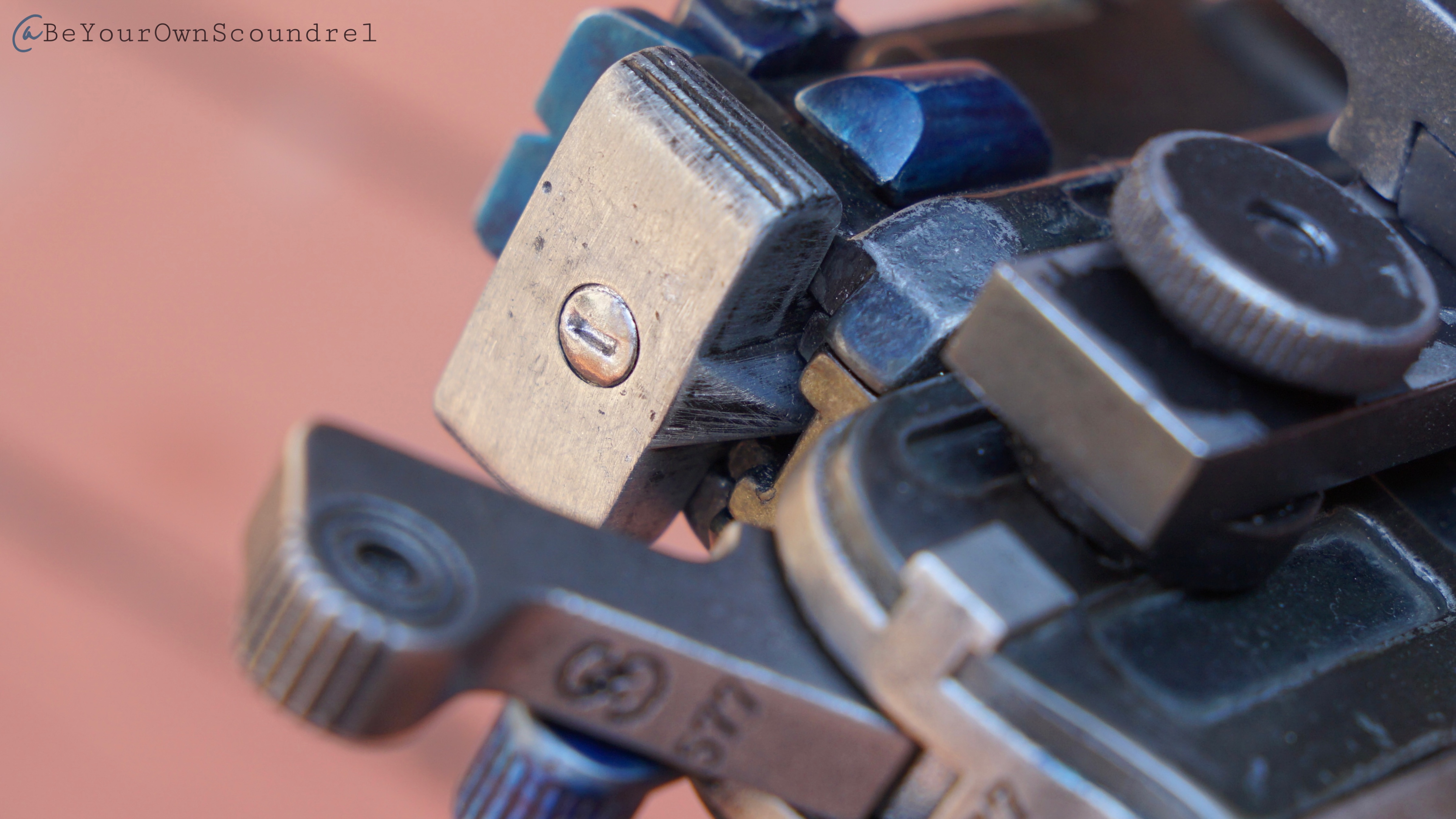

I forgot to take off the “Carson lump” when remodeling my ANH Hero into this blaster so it’s got a blunder but again this one is mine so I can live with for the time being. Ive already fixed the file and eventually will reorder the top receiver but maybe not. For this build im not to bent out of shape over it honestly. All parts were created in Solidworks and then printed on a MJF printer. With the exception of the scope wheel which is resin so as to capture the specific detals. I also recently got an airbrush and using it on this blaster. Still a long ways from figuring out how to use it correctly butt it is nice to be able to hit small parts that would be impossible with a spray can..

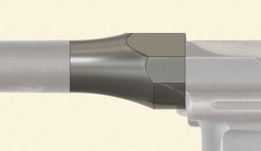

Sorry guys for interupting you. I got here accidently looking for some technical drawing of c96, which I am modeling for personal project. You guys discussed here earlier a pretty nice model of c96. I read all the pages at this thread, it was interesting reading, but I didnt´t find all the answers, for what I was looking for. One really nice help was for me a handle, for what I found here some advice. I was strugling with it a few days to get it to some normal shape, and your content was helpful. Now I only have some troubles to remodel a barrel shape. It is propably mix of bad dimensions of breechblock and outer barrel diameter. I am pretty close to it, I will pin a image of it too here. But is it somewhere possible to download a model of c96 you remodeled earlier? Because I found only thingiverse page with some models for blaster. I don´t have any replica of original gun near me, so all dimensions are made from images. If I got a model of it, I would like to check them (these dimensions of course) and find where I do a mistake.
I dont have a model to share sorry. But you can definitely recreate a lot of this stuff from pictures alone. Its not impossible just dont get hunkered down by trying to be “exact”.. close does count. Besides once you start shaving away, you will find what you are looking for! Good luck to ya sir! Maybe start a build/design thread where we can see your progress and receive feedback along the way? Food for though.. cheers!

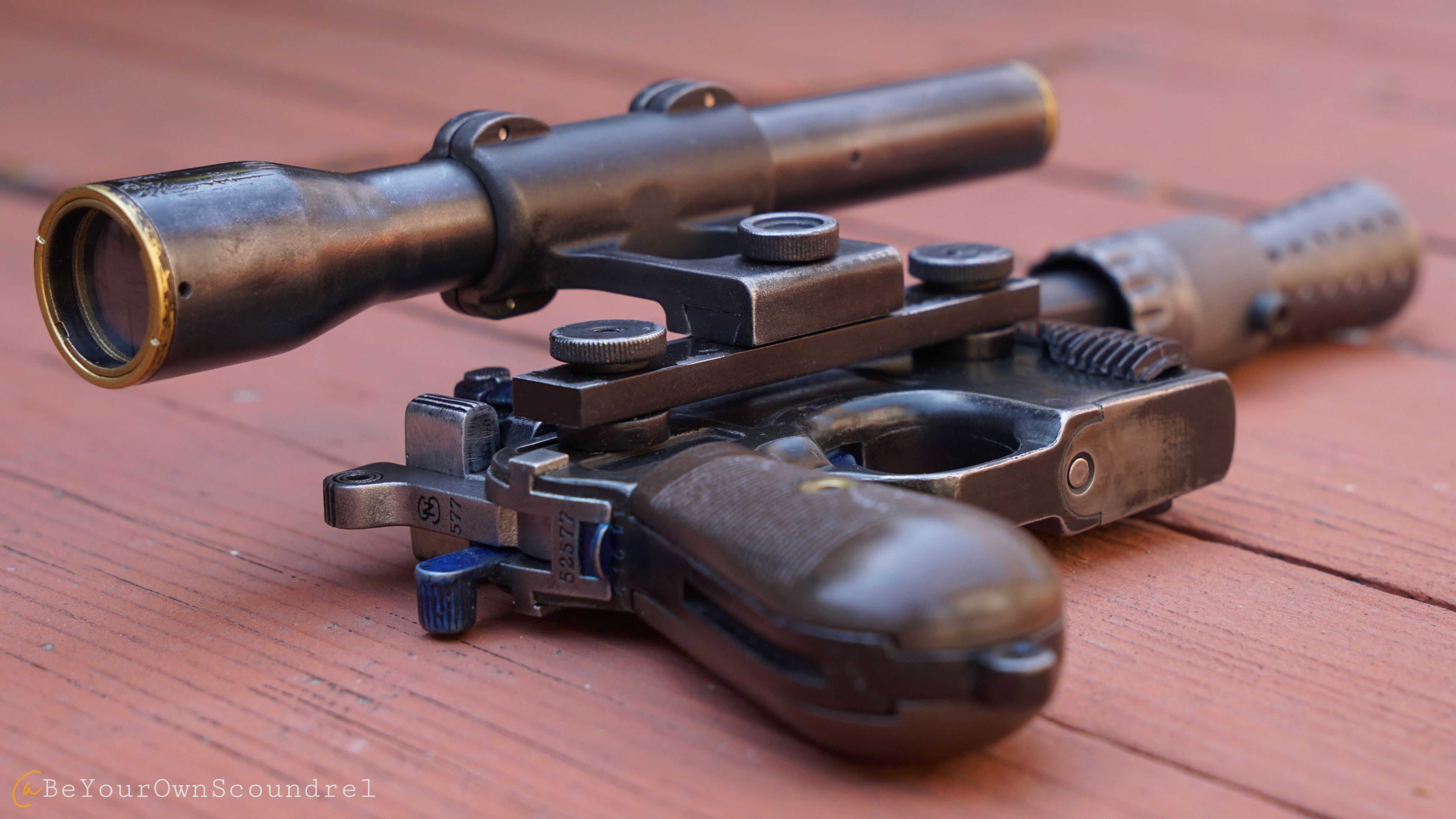

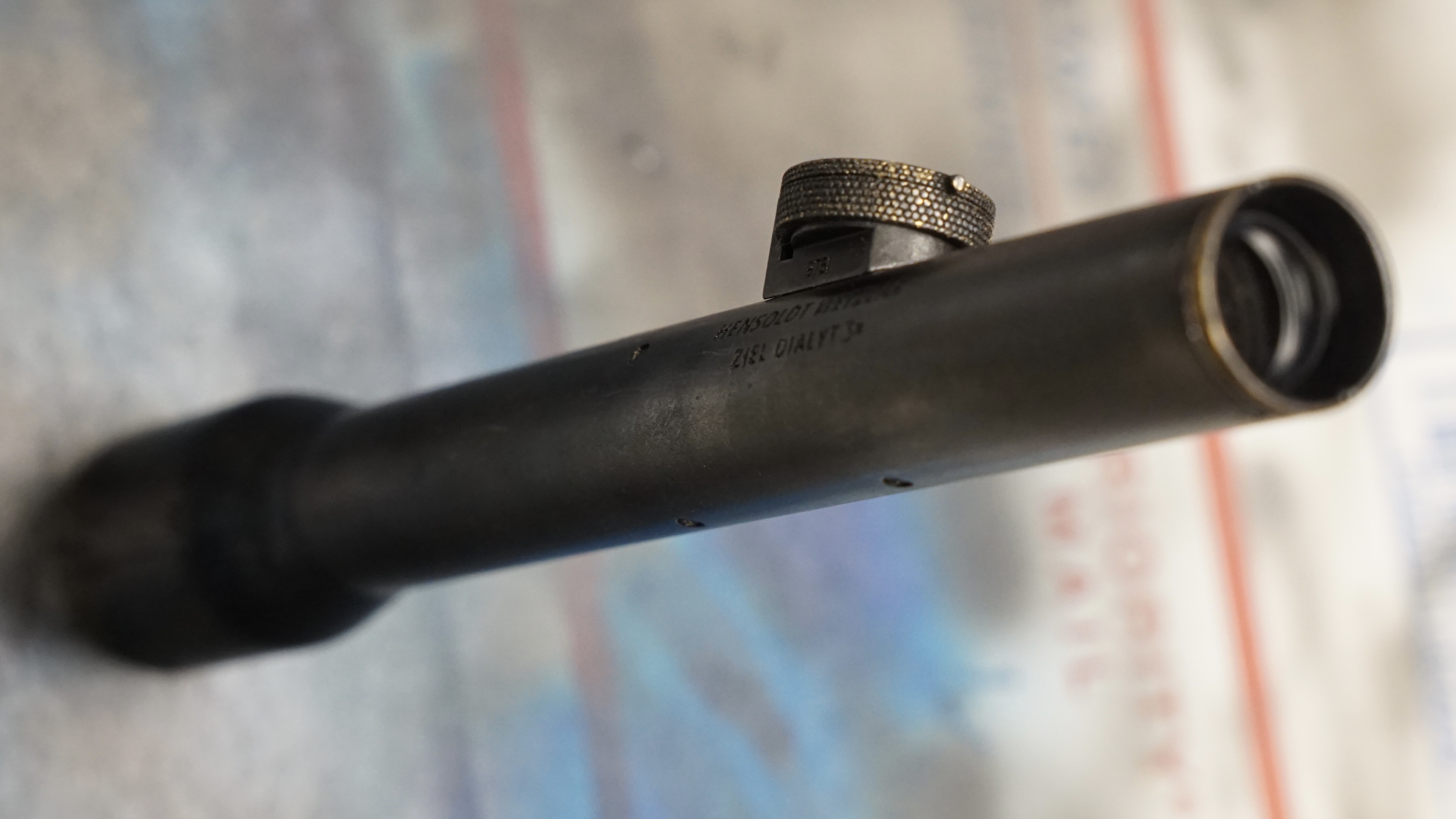

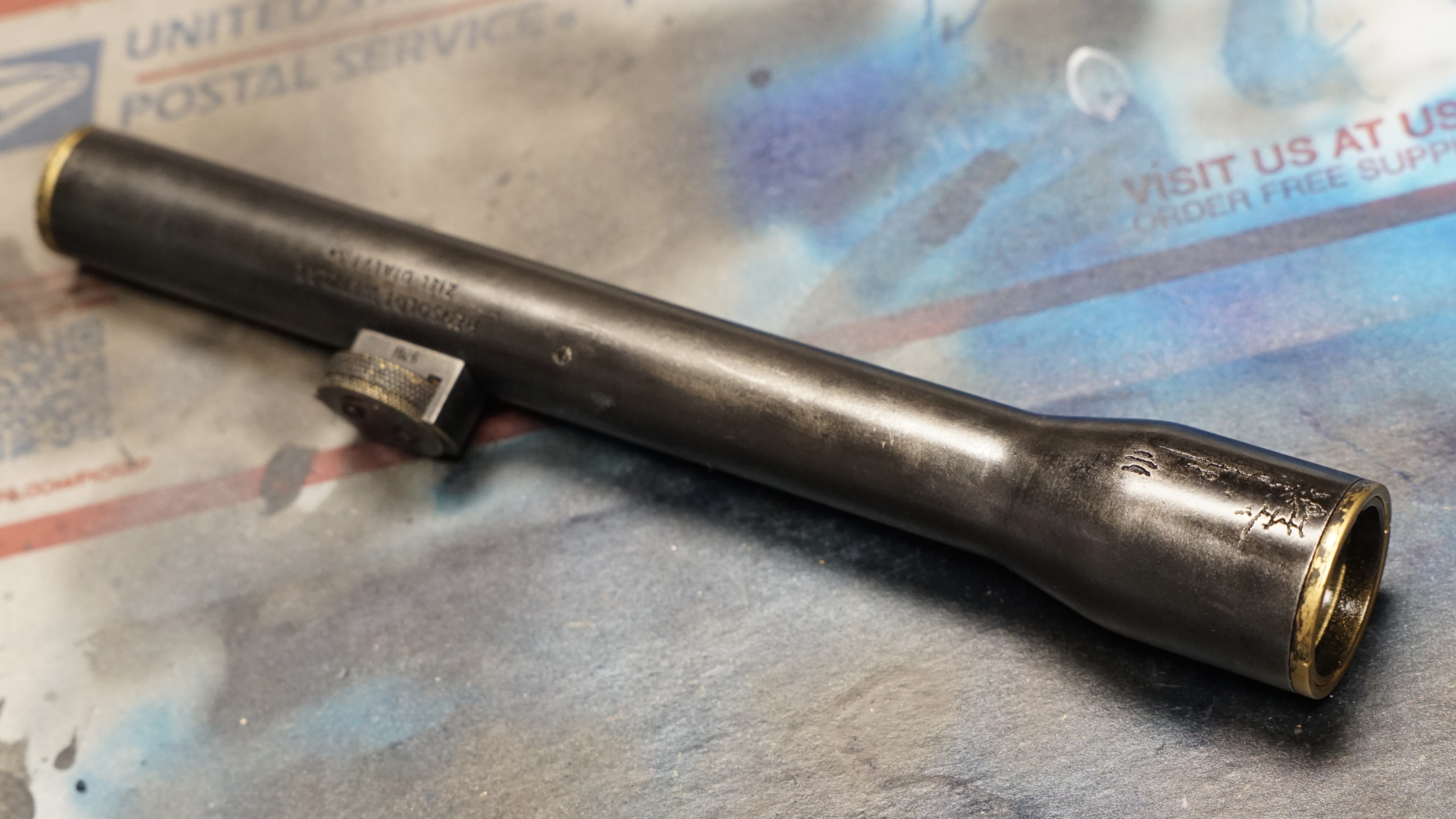

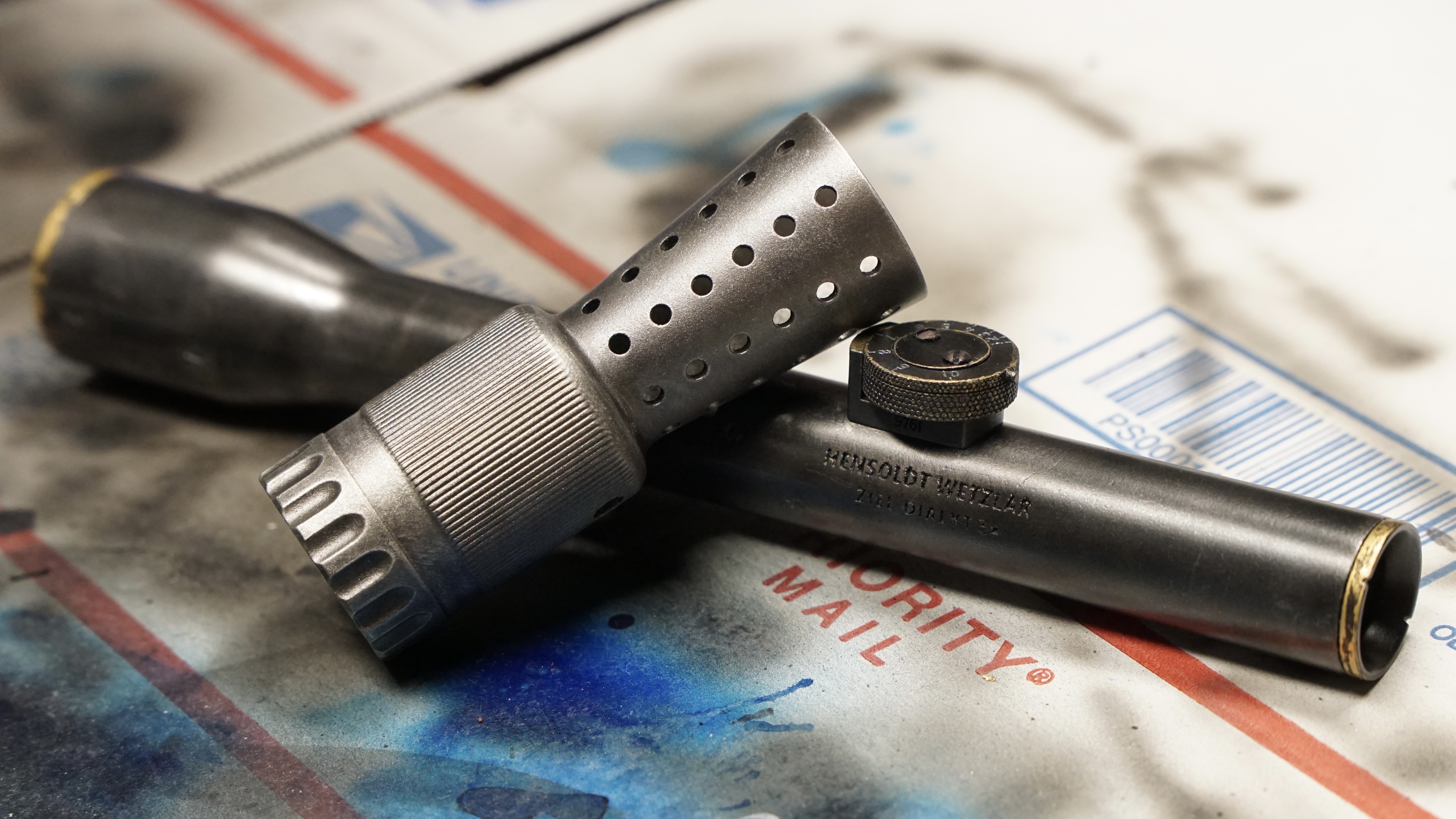

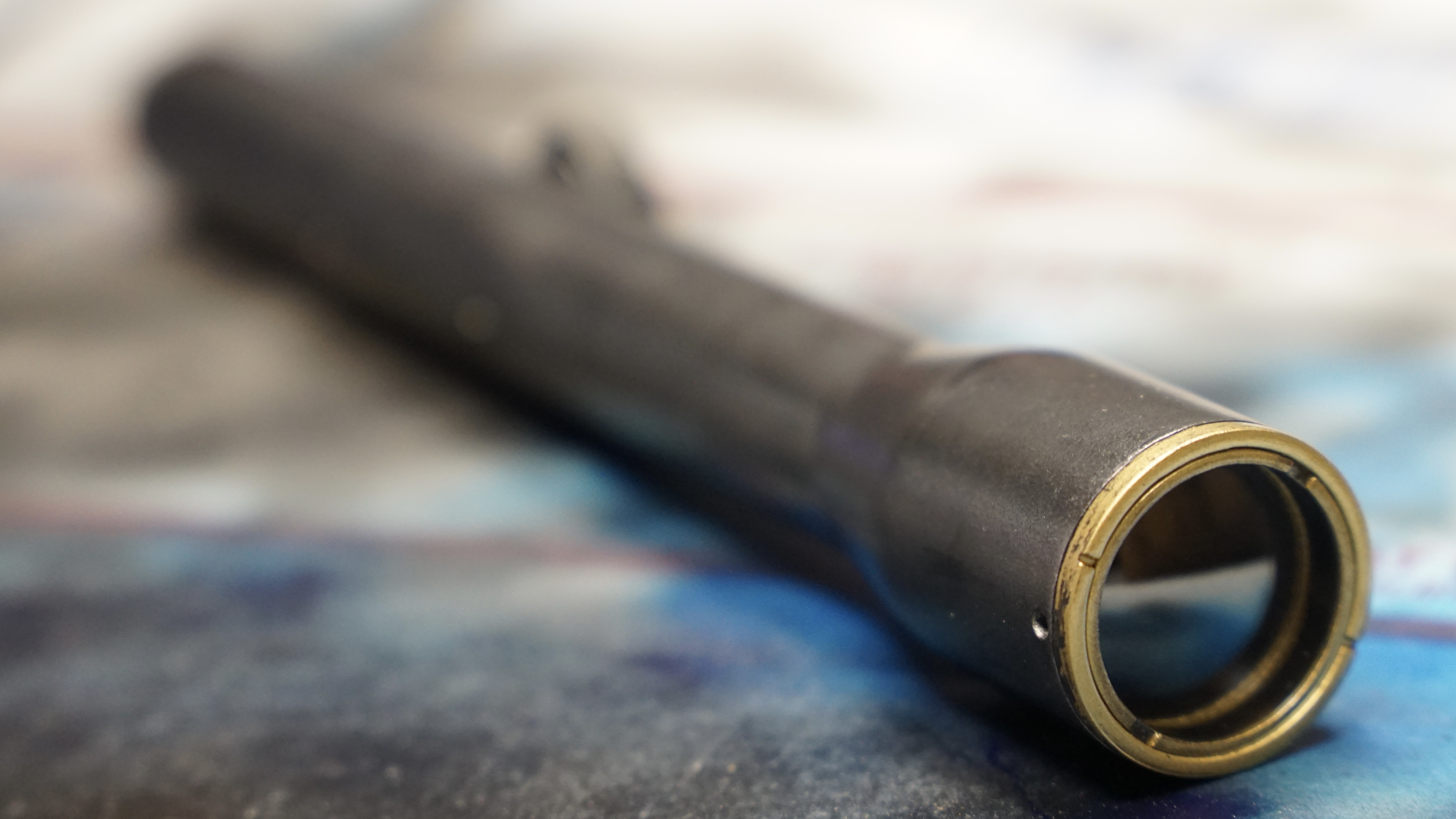

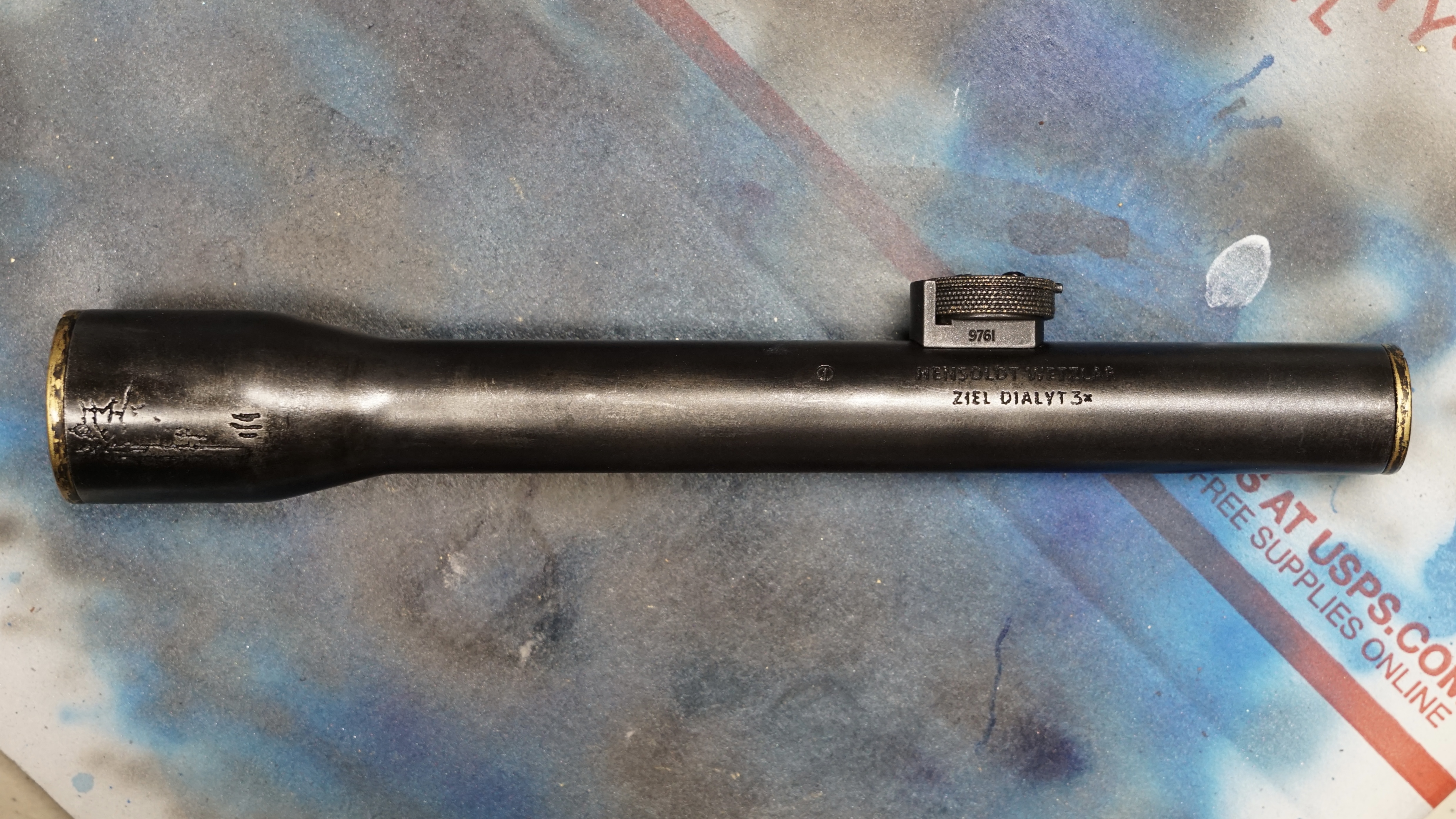

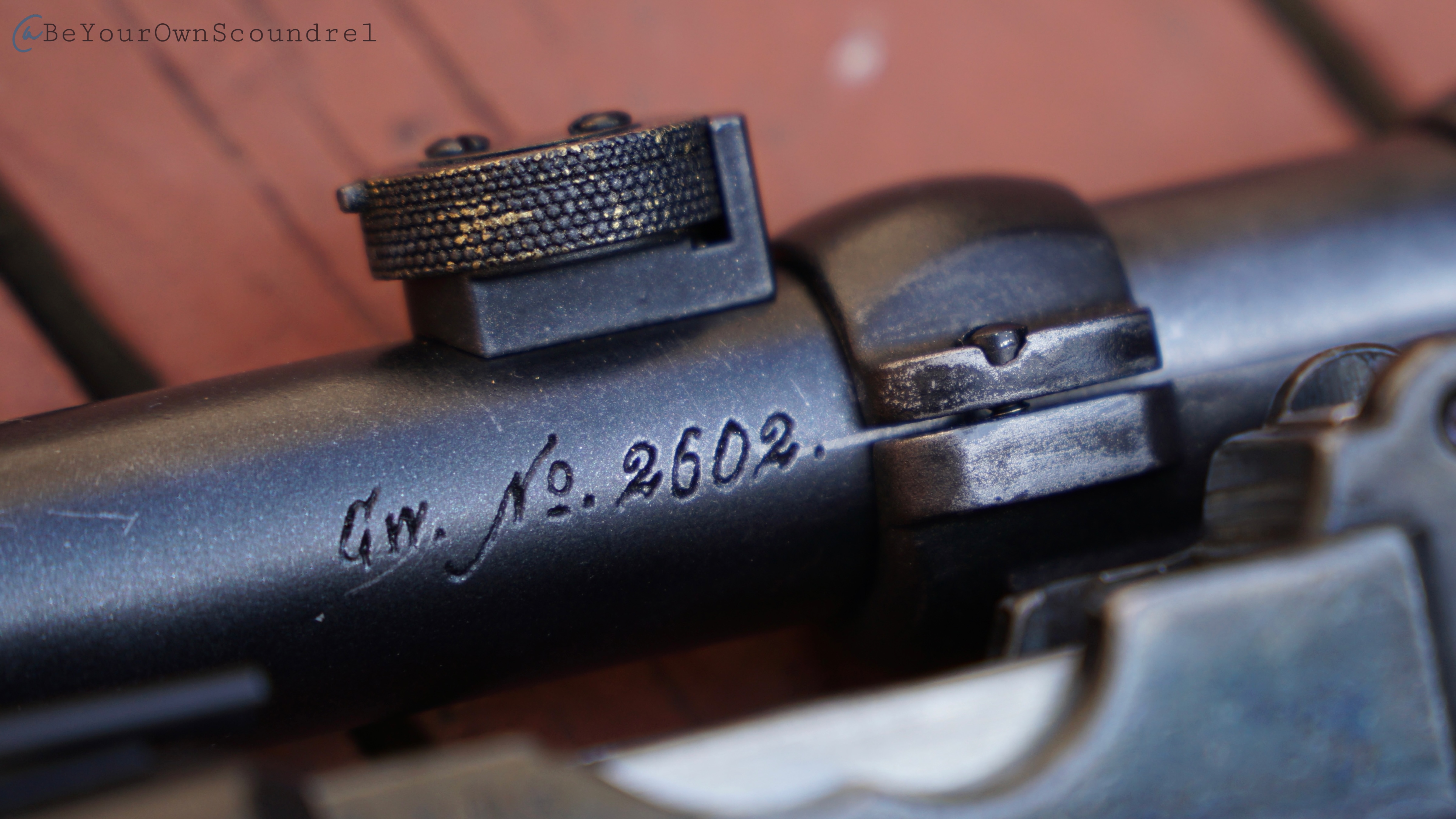

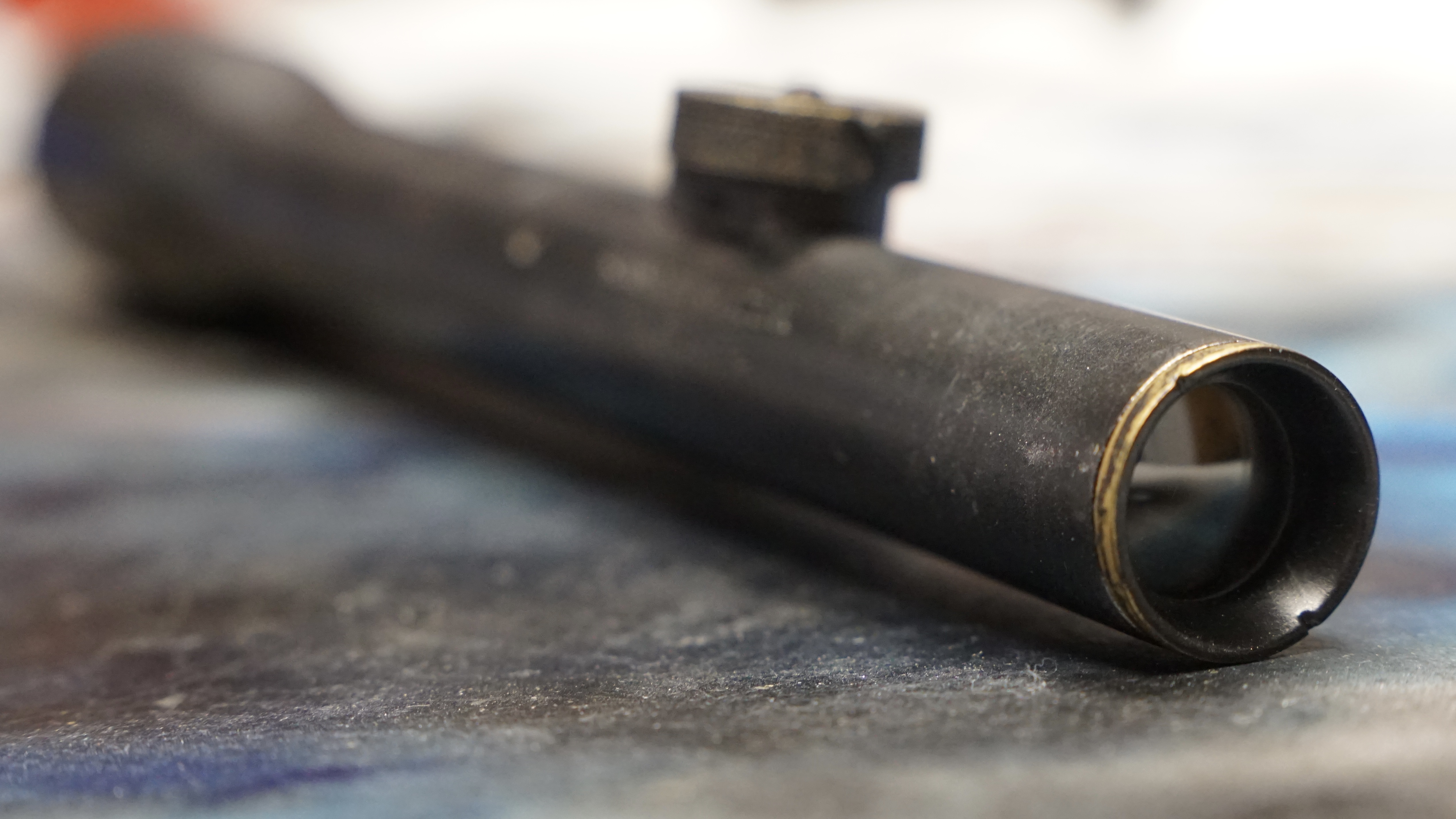

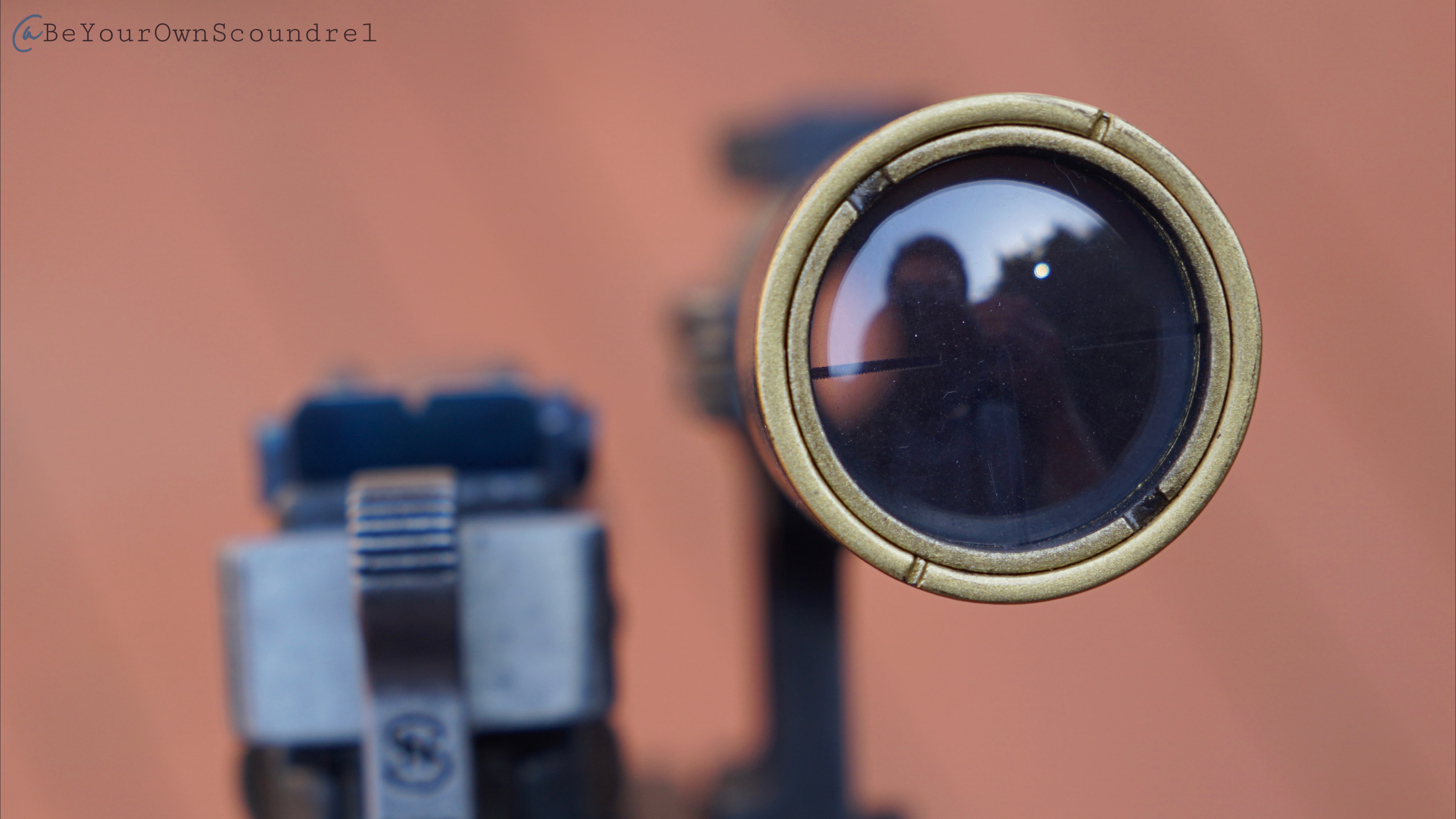

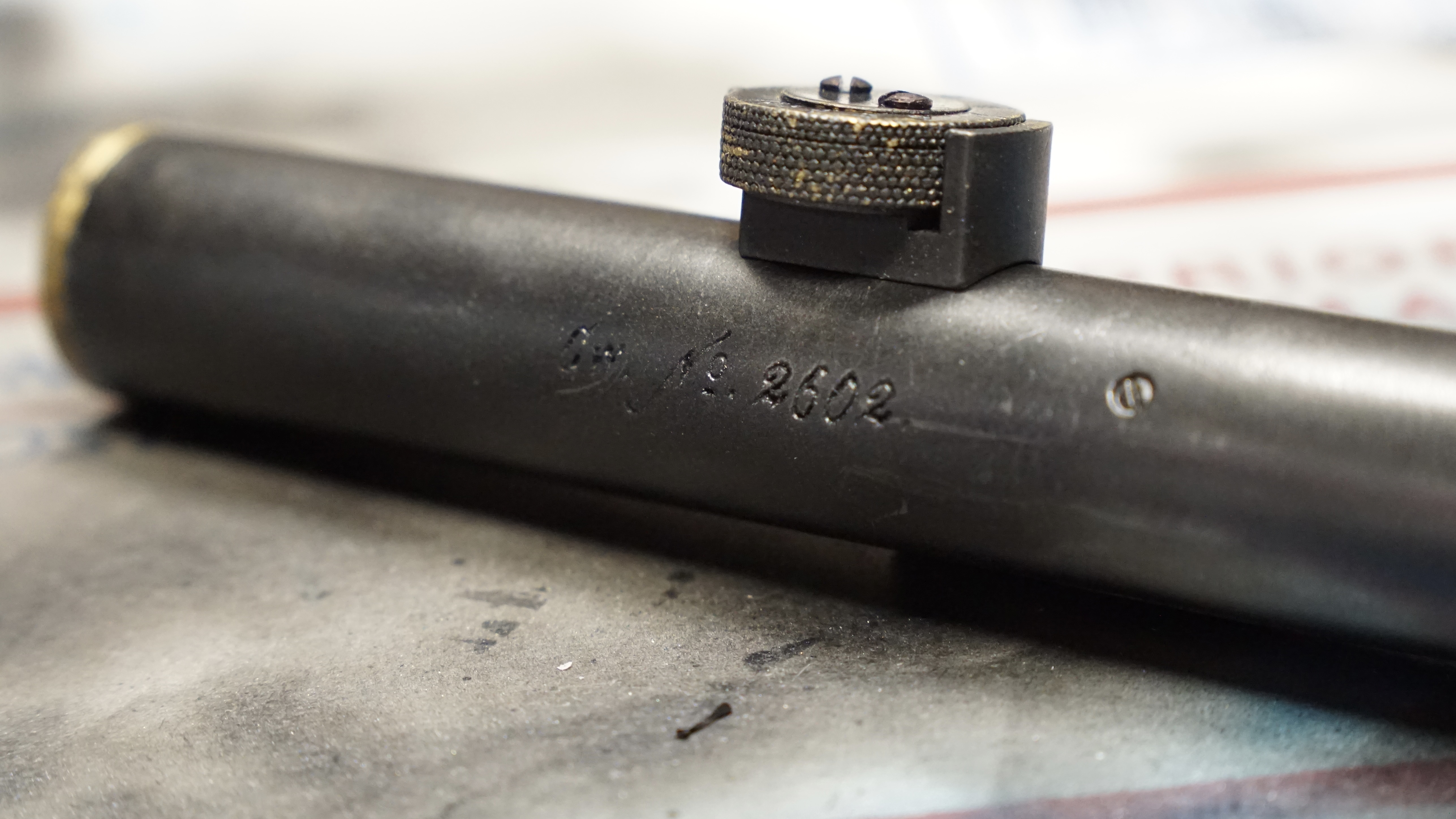

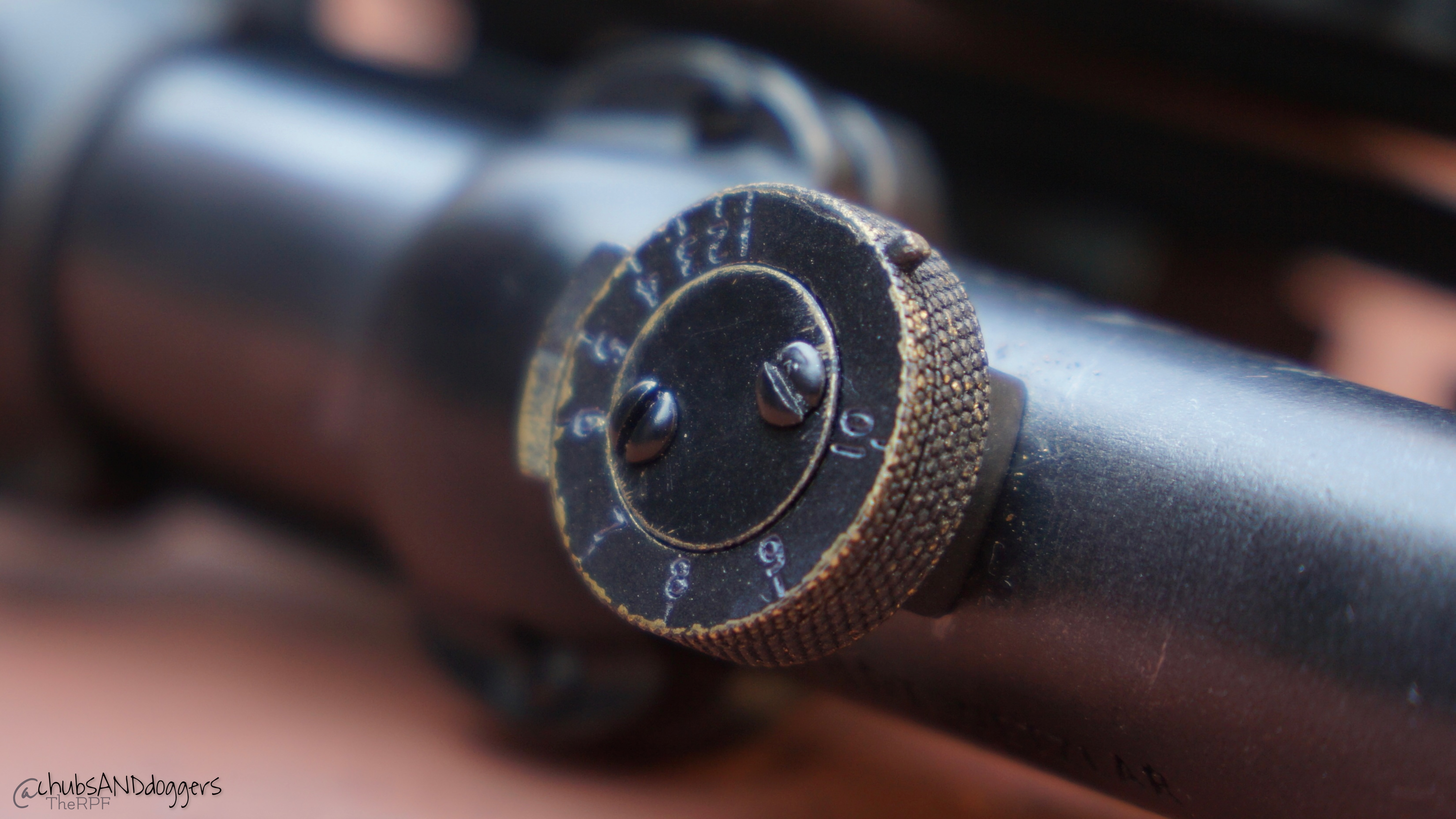

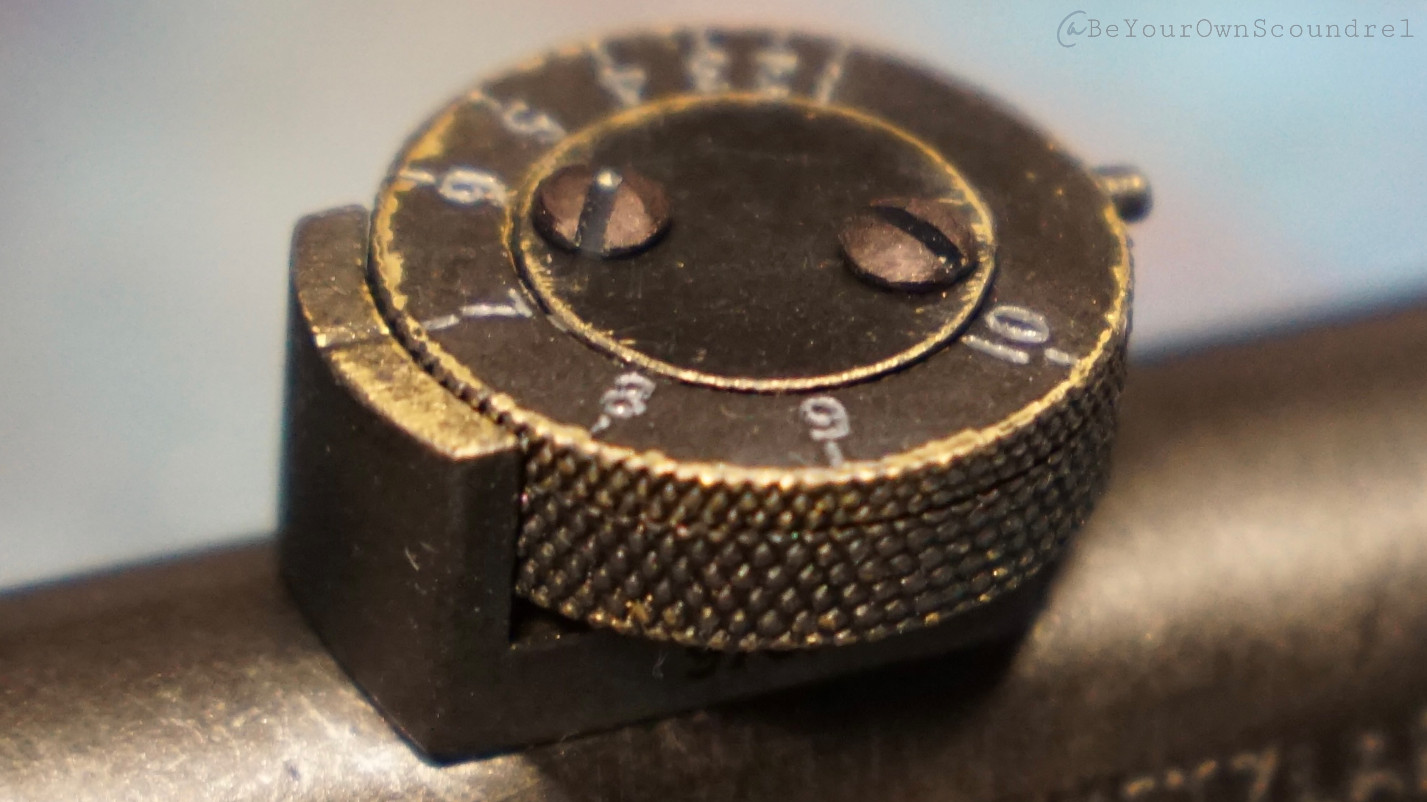

Here is a Hensoldt scope i’ve been working on. Recently invested in an airbrush and it works wonders. This is only the 2nd time I’ve used it and a long way from getting the hang of it but I already like what I’m seeing. Great tool for weathering to say the least..
Also everything pictured was designed up and 3d printed using MJF (resin/scope wheel & base) including all the screws. It had to be simply because I couldn't find screws small enough so why not design them as well was the thinking. We live in some good times!
That paint job is freakin' outstanding! Any tips or a brief tutorial? WOW!
Sorry to be just responding to this now. Nothing crazy honestly. After priming and sanding I use a “steal” spray paint all over, then rub some matte black acrylic paint in different area and finish with the airbrush. Lightly sand (800) away areas and then re-add some airbrushing as needed. It’s not simply as basic as that and it’s also time consuming as you need to let the paint full dry but honestly that’s pretty much it.
The most important part I think (outside the actual CAD work obviously) is the priming and sanding to get that smooth base. These MJF prints are not cheap but they do sand smooth pretty quickly without losing much (if any) detail at all which is nice.

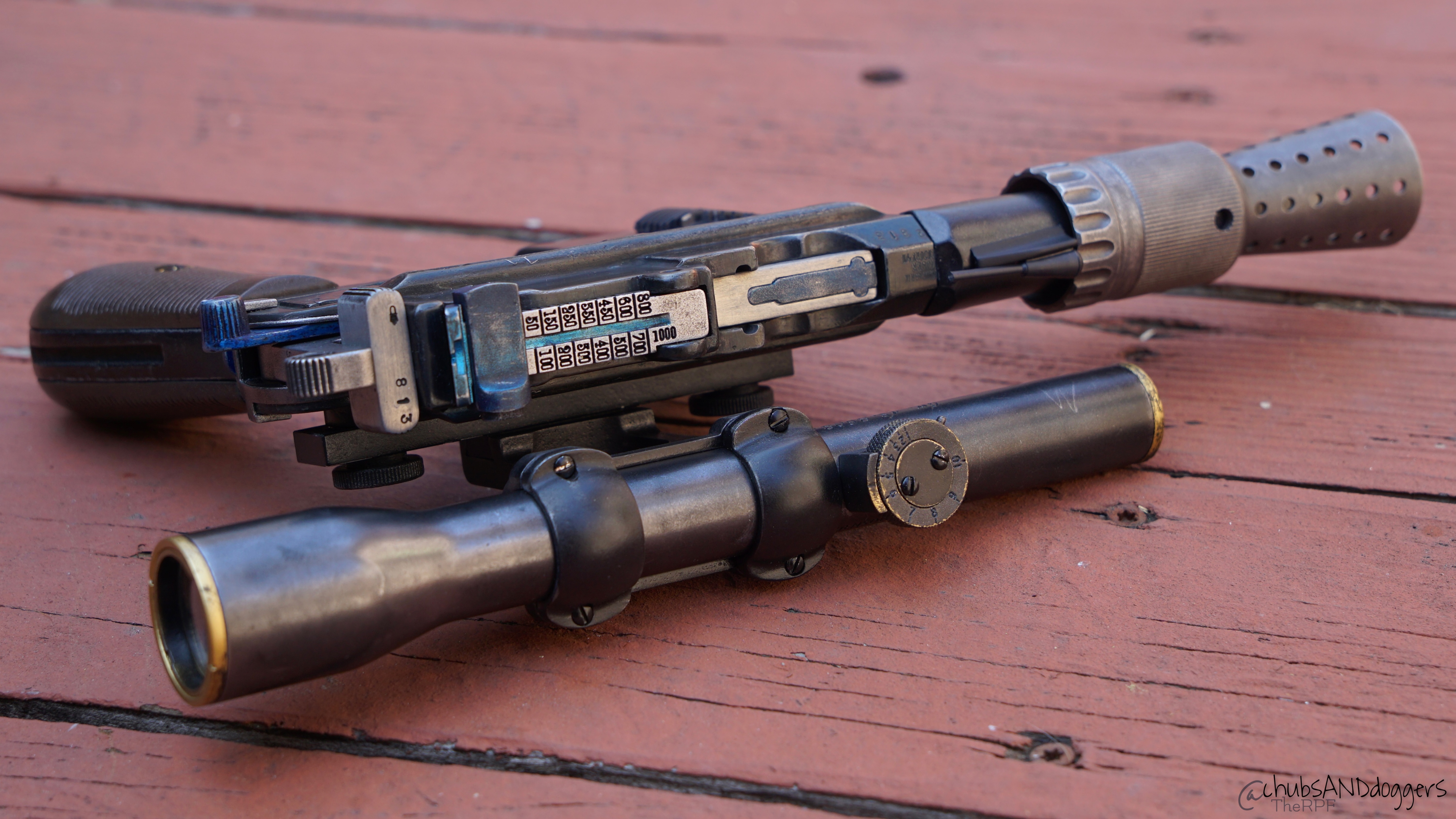

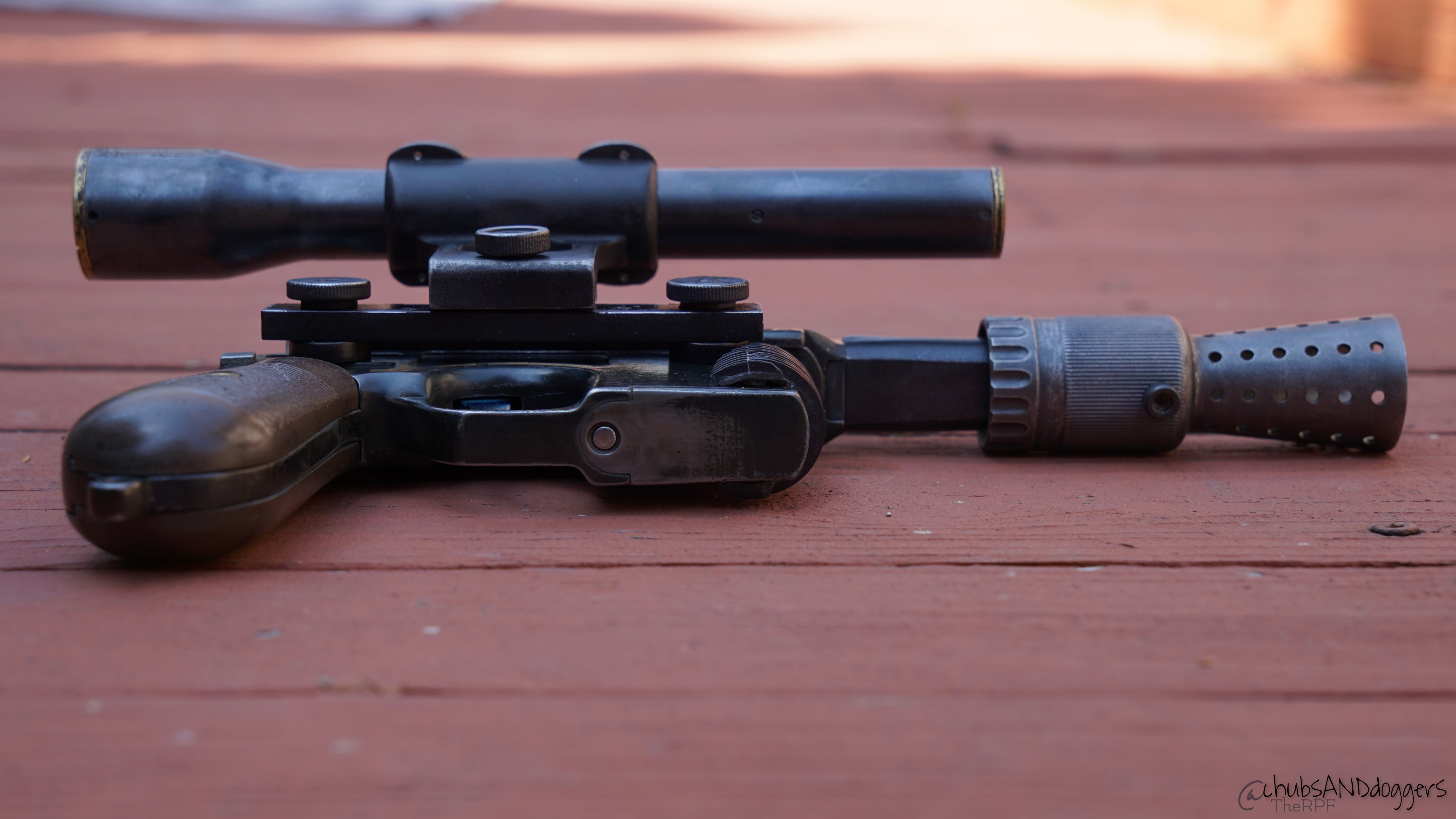

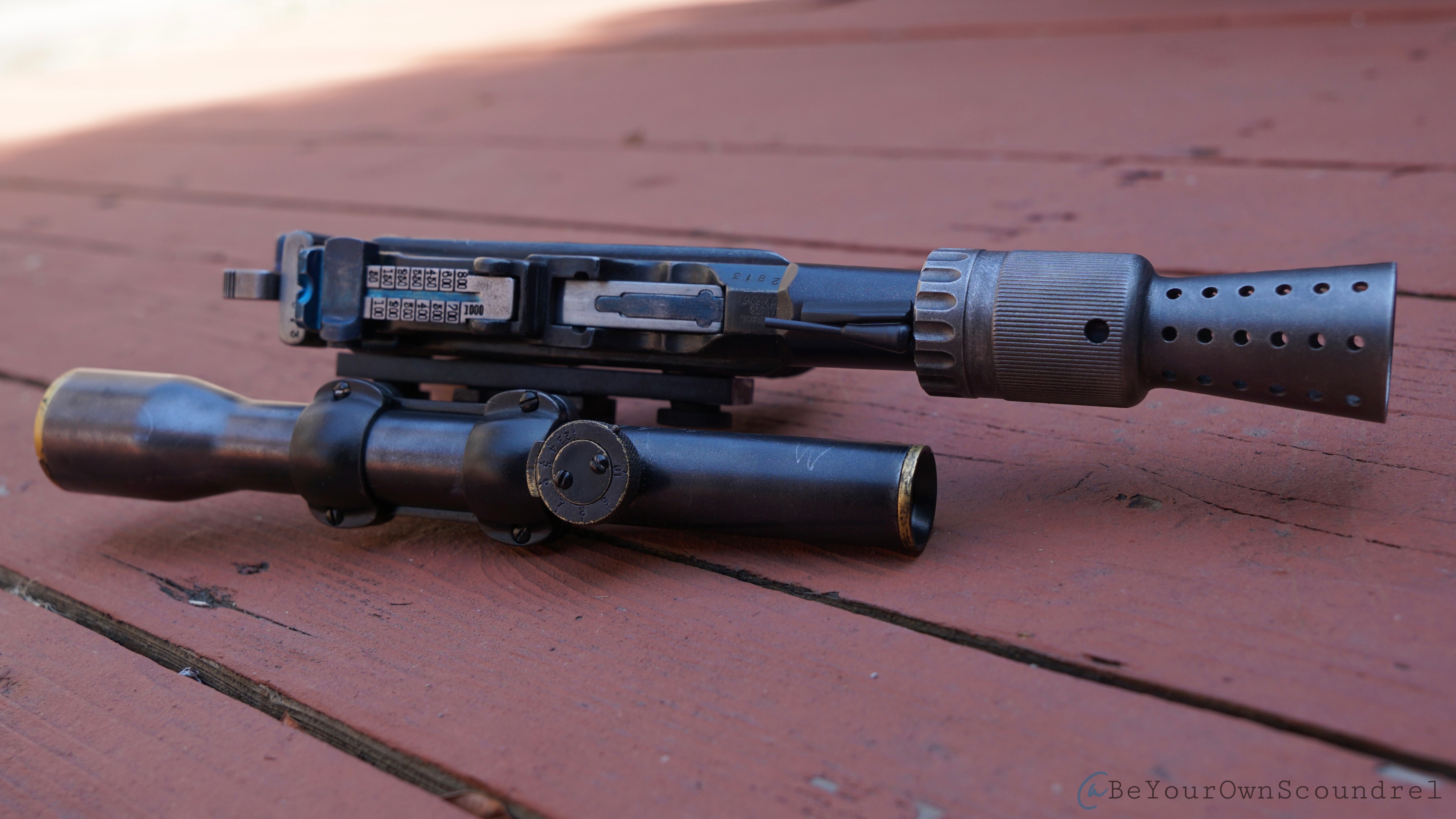

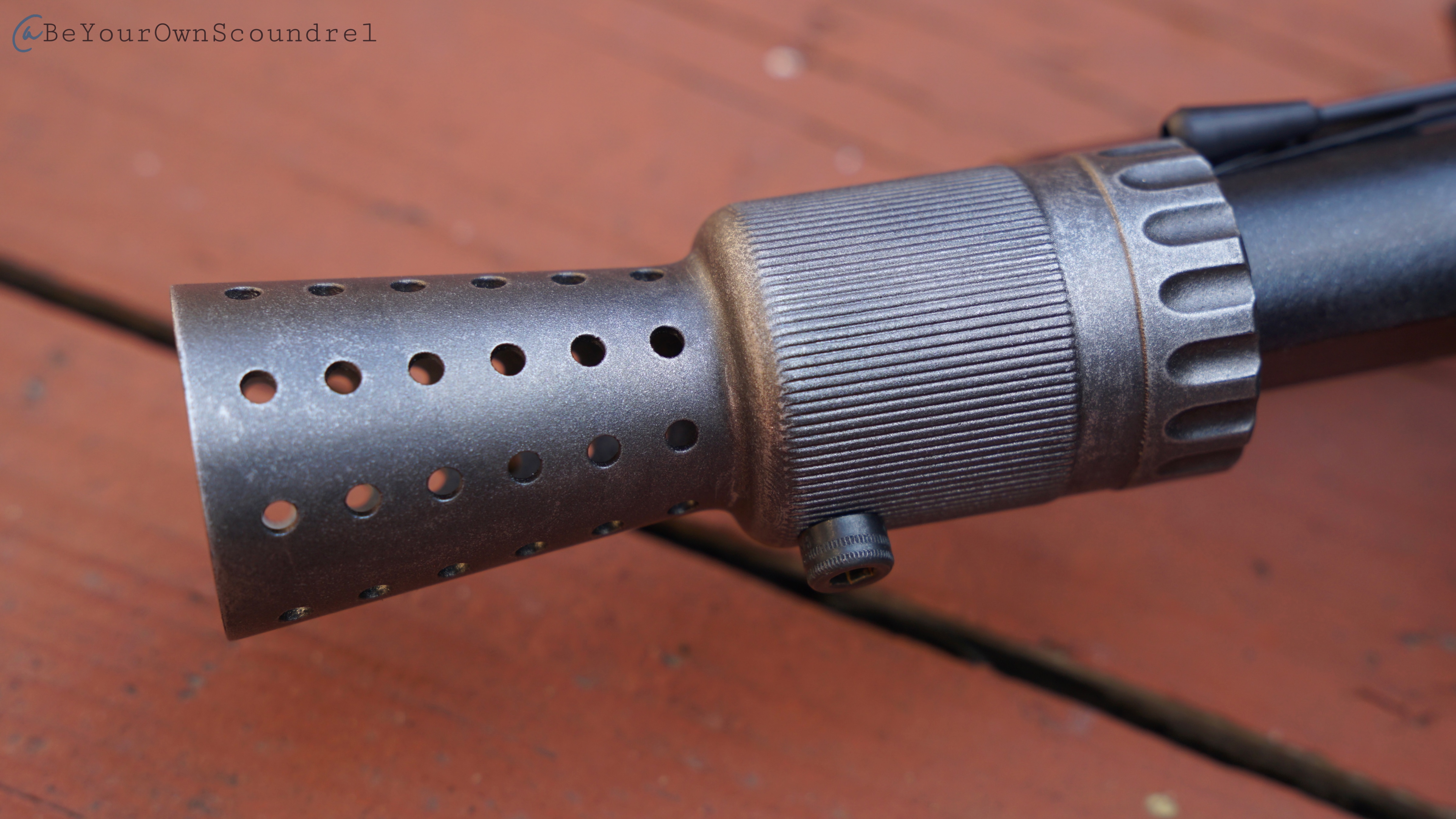

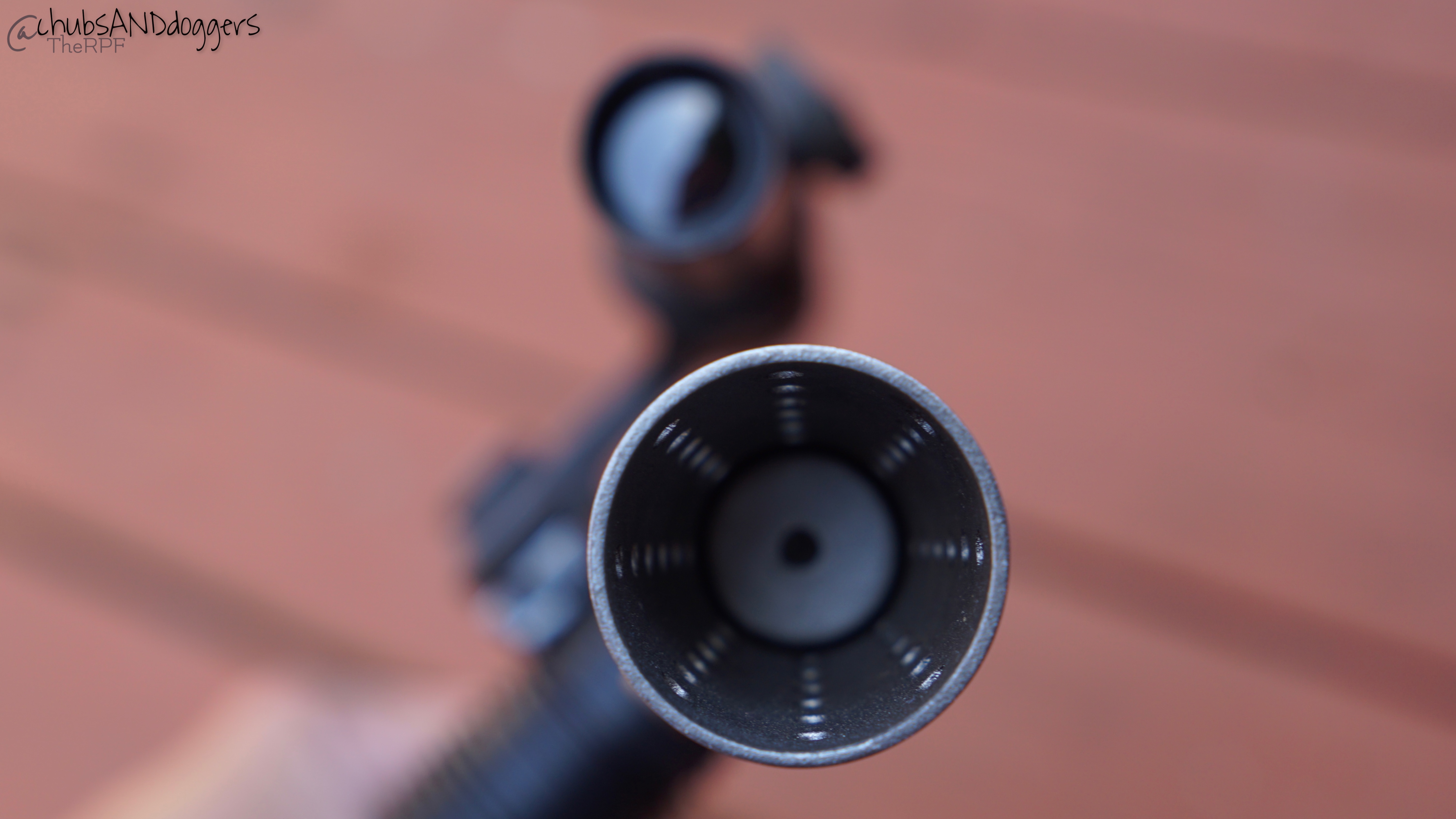

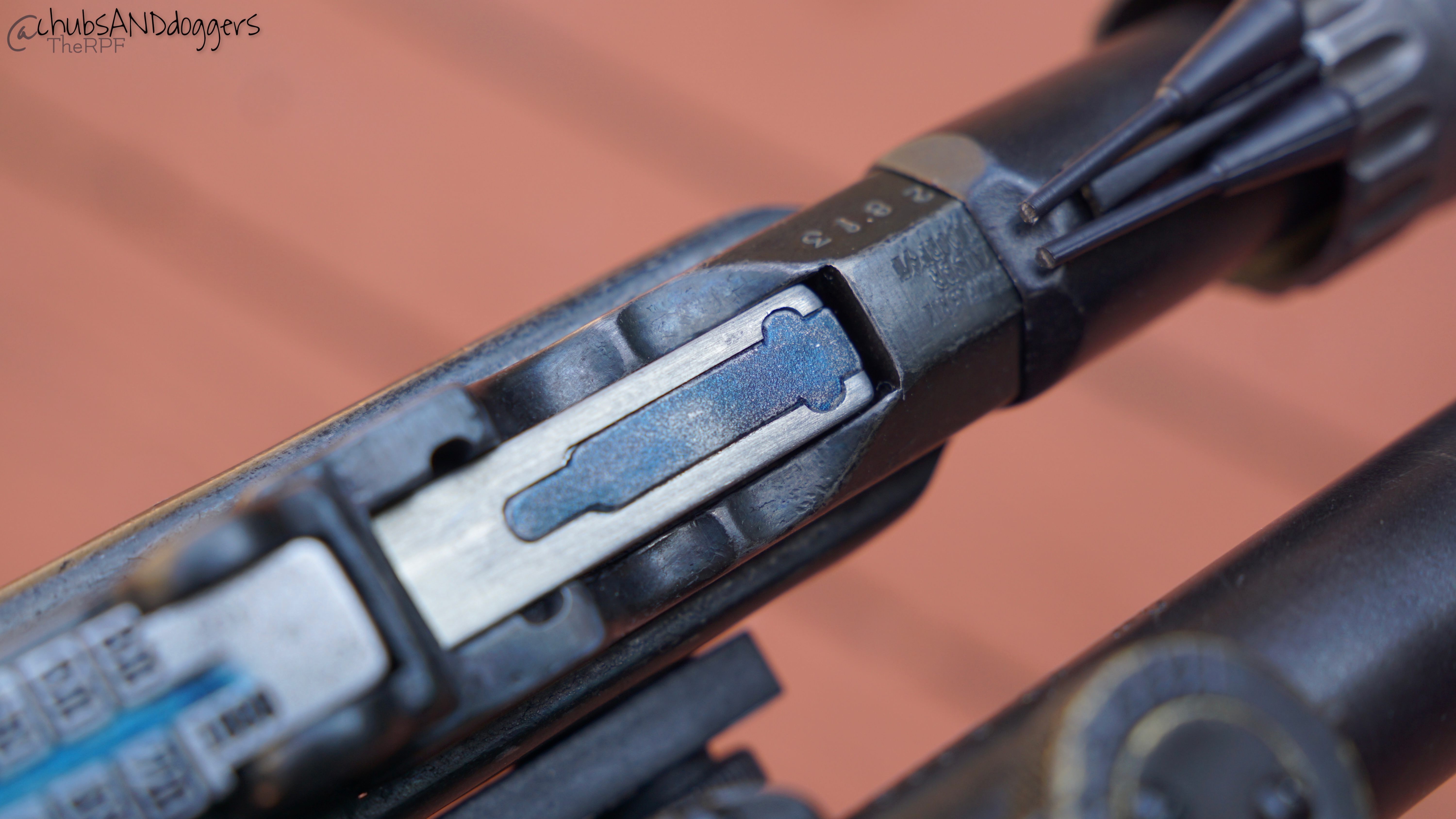

Just unloading a bunch of pics of a recent ANH Hero on a modified Denix.
Using a mini mill to upgrade the denix while all the conversion kit parts were designed in Solidworks with the majority being printed in MJF with a couple in Resin (Flash Hider, scope wheel, scope wheel base & c96 sight)..
