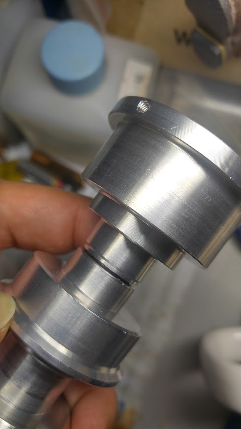

Hi I need help, I find the neck is a bit loose, can't screw it tight, how can I do to screw it down a little bit more?Thanks! 20180501_010643_HDR.jpg

Hi I need help, I find the neck is a bit loose, can't screw it tight, how can I do to screw it down a little bit more?Thanks!View attachment 813979
The saber is designed this way. check out my post a few pages back - I used a steel rod and shaft collar to tighten the emitter/neck
Re: Sign up thread for NEW Luke V2 light saber run. Spring 2018 edition (SIGN UP CLO
Thanks, I missed that...is nice but I don't have skill to do it,so... anyway thanks!

If you want it tight you can sand down the bottom of the steel part. Would take just a few seconds on a belt sander. I shortened mine and can now select to have it spin or tight.
I see! Thanks a lot!!! It's much easy to me:D, I try to do that!
Just take a little at a time and check in between sandings. Also remember remove the burrs and keep the threads clear.

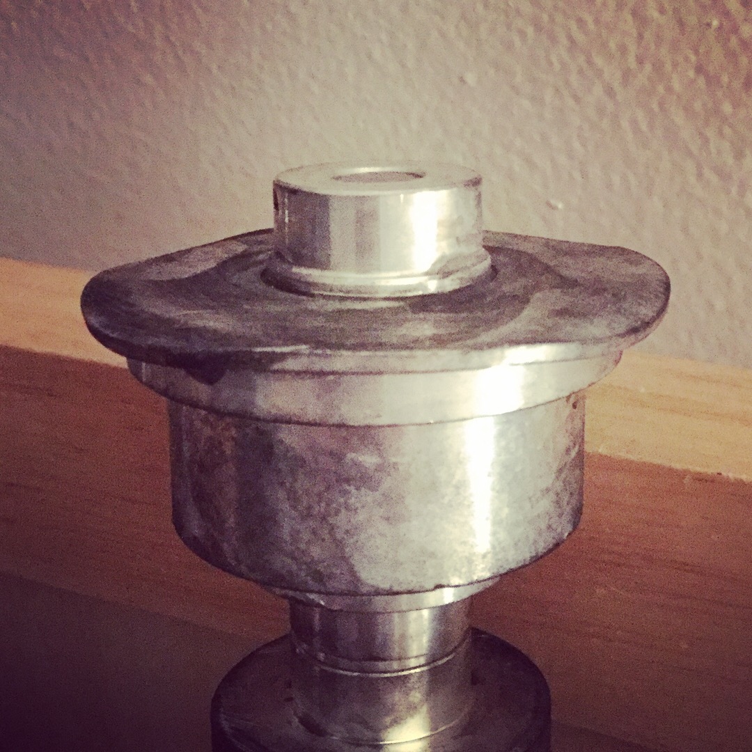

I used a butane torch and rubber mallet to get the bent emitter plate! Took it off just like halliwax did, chewed up the bottom a bit though in the vice. Meh, weathering. I smeared some aluminum black on it to prep for paint tomorrow!E4D4D35B-FE25-4D4E-95E6-76257DF87FCA.jpeg

I used a butane torch and rubber mallet to get the bent emitter plate! Took it off just like halliwax did, chewed up the bottom a bit though in the vice. Meh, weathering. I smeared some aluminum black on it to prep for paint tomorrow!View attachment 814079
Looks great tom!
