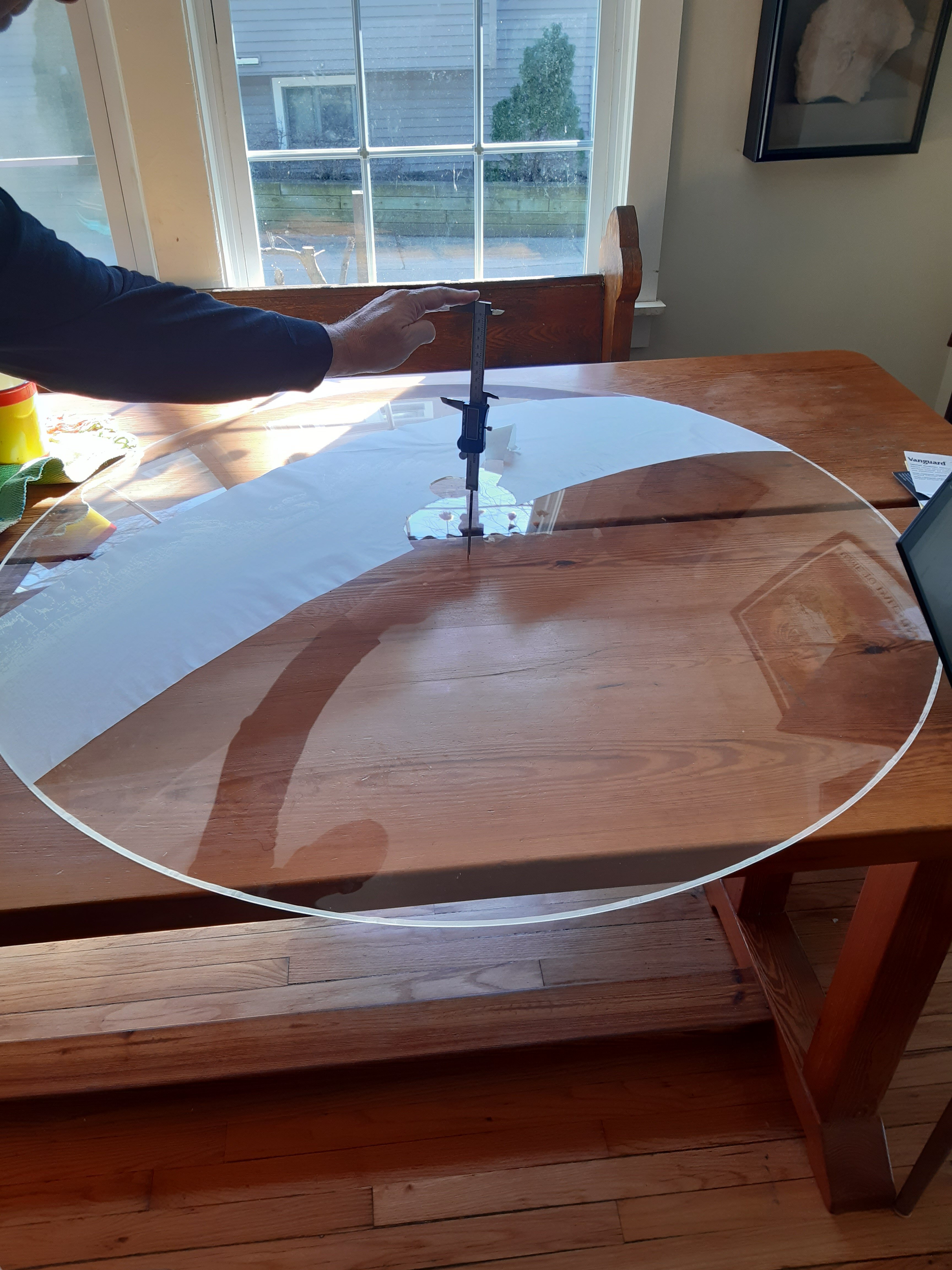

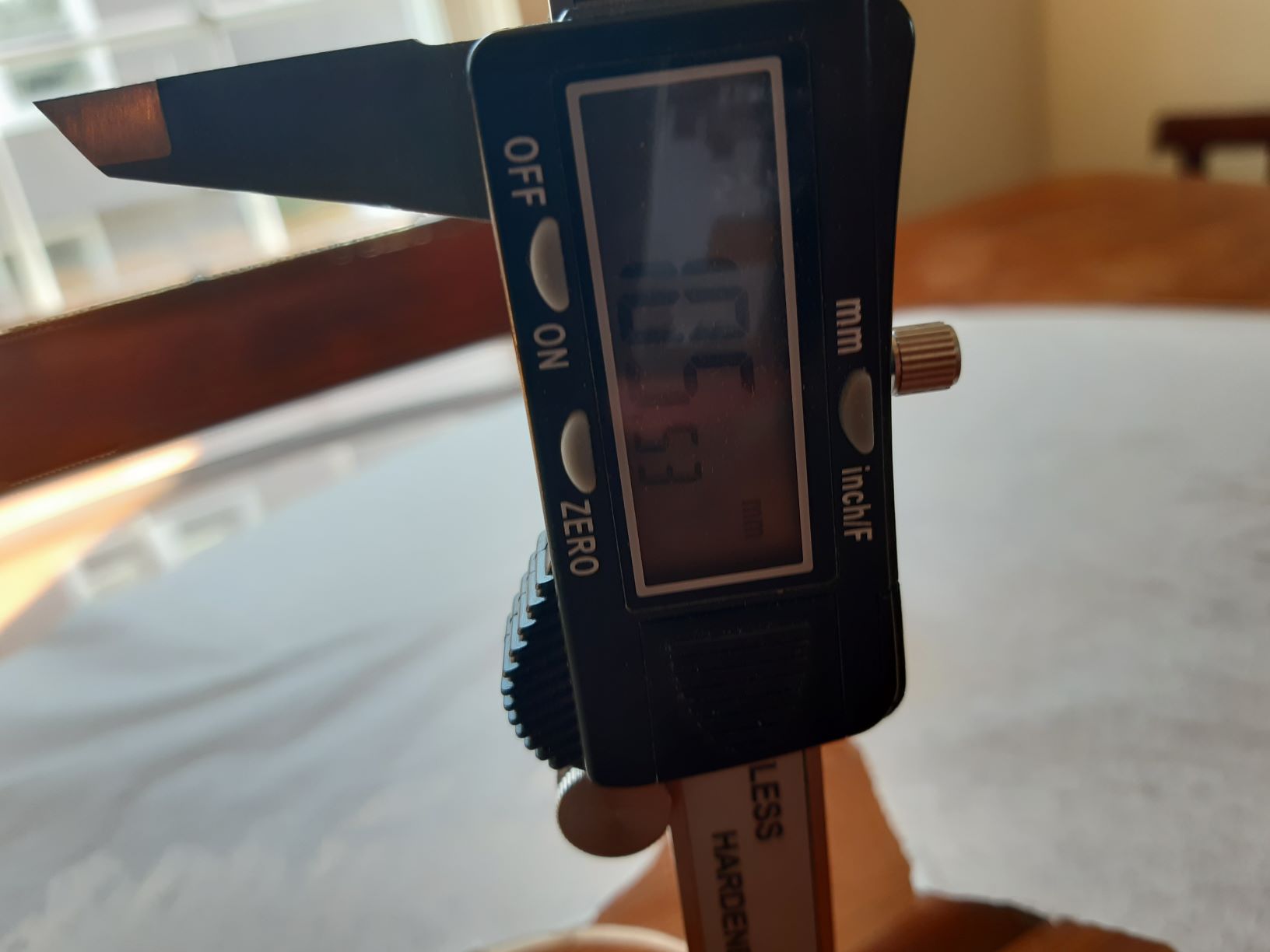

In case you're squinting, the caliper says 105.53mm
That's 0.12mm OFF of perfect. And I'm aiming for 1/10 of a millimeter in accuracy. So that means I'm outside my ideal tolerance limits by 0.02mm, and thus it is BACK to the drawing boards...
Argh!
No, actually... just kidding. I'm happy. I can live with being 1/10th of a millimeter and 2 one-hundredths of a millimeter off. It won't be visible to the naked eye. And more importantly, it won't contort or constrict any of the greeblie plant-ons or subassembly layouts.
Verdict:
Worth the two-year wait.
Worth the 13 iterations.
Worth the repeated failures.
Roma uno die non est condita.
Now, on to construction!

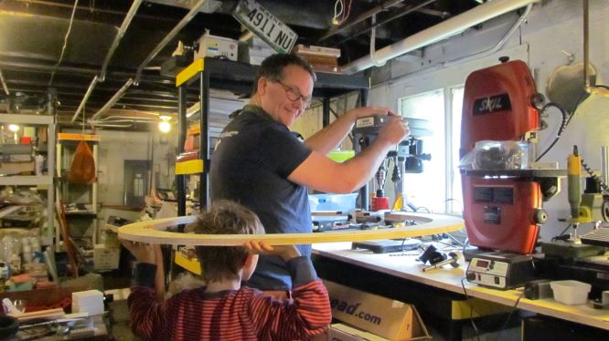

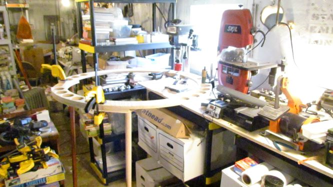

Speaking of nine rings, there are TWO methods for cutting your wooden support rings....
Method 1: The seven-year-old assistant method.
Works for about five minutes until... "Dad, my arms are tired!"
"But son, we've got 15 more holes to drill!"
Method 2: The jig method.
No seven-year-old assistant required.
"Dad, you're smart! Can I go play with my Lego Y-Wing?"
"Sure, son."
Gettin' there...
The price of wood was NOT kind on the budget this year. Made three circle-cutting-jig mistakes with the Rockler router jig, and ended up having to buy 8 pieces of plywood total. Like everything on this build, three steps forward, two steps back...
