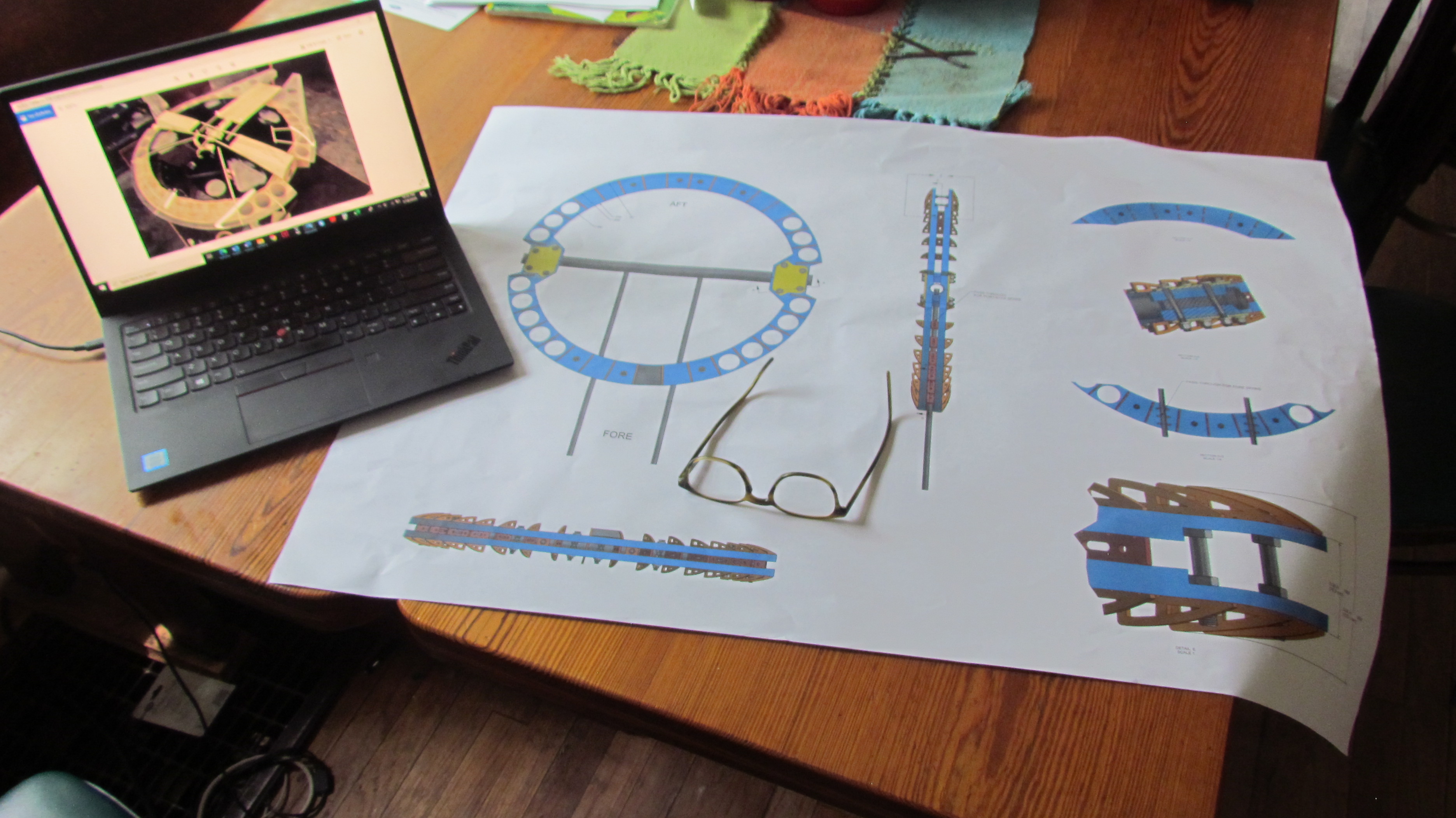

I don't mind the questions -- it's just that your questions are AHEAD of my build progress. I'm still figuring out the armature...
Deriving the armature schematics... by mixing the old-school build aesthetic with some newfangled CAD design and lighter materials...
Oh well, your build is AHEAD of mine, at least you have started it. Figuring out is an understatement, Really Cool ideas, keep at it mate.

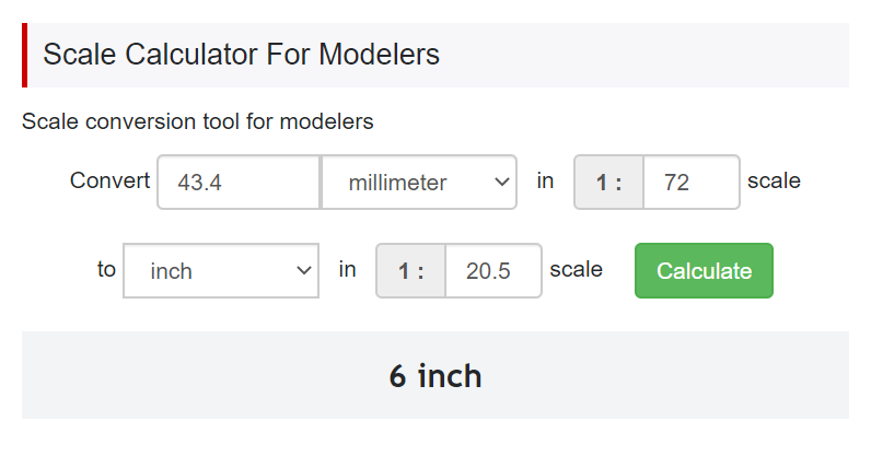

I'm proceeding with my build by working off the assumption that the model is specifically and precisely 1/20.5 scale. My logic and math are as follows:
Per scalecalcultor.com, using the radar dish at 6" on the five-footer which is 43.4mm on the Bandai 1/72 Perfect Grade Falcon, this works out to being precisely 1/20.5 scale
What this means, in absolutely super-simple terms, is that to derive any measurement, you would simply take the Bandai Measurement and then multiply it by 3.51152. (This comes with a caveat, however: Bandai did knowingly "cheat" some areas of the Falcon by resizing certain greeblies to make them fit onto the hull they had created, so while their bird is a "perfect replica" it's not actually a digital scan recreation of the original, but rather a digital scan of the original that was then converted into some "standardizable" units, which typically meant they balanced out any left/right or front/back asymmetries.
So on the Bandai PG Falcon, the longside of the nosecone tube is exactly 53mm. This means on the full-scale model you'd want it to be 186.11mm.
The short side of the nosecone tube on the Bandai PG Falcon is 28.575mm, which translates to 98.32mm on the short side.
This assumes a 30-degree angle cut of the tube. This also is significantly different than previous numbers on this measurement around 172mm long side and 95mm short side.
I don't know if these differences are simply accounted for by the move from a 5.75 OD tube to a full 6" tube, but I put it out there in case one of you knows trigonometry better and can check/correct my math.
Finally, this is all theoretical -- the real test will be how it looks when actually building it, and how it serves as a ground onto which to plant all the greeblies. So final confirmation of these theoretical numbers is months and months away (if not years).
And if you're still reading this, other interesting numbers are derived from going this route, one of which is that the base diameter of the turret gun ring is neither 11.5 inches nor 12 inches. This route puts the base diameter of the turret gun rings at exactly 11.75" -- a perfect average of the two most common claims for this measurement.

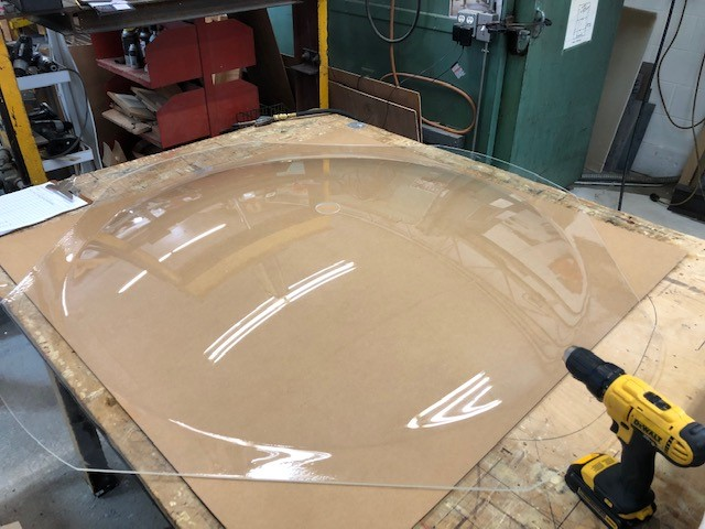

Patty of the burger is 46.31 inches OD -- to this vertical wall you add the greeblies all around.
OD of the bun (dome) is 48.72 inches -- to this you overhang even more durasteel plating, but if you're fabricating your own dome, this is the absolute outer limit of how large it can be (if you make it smaller, like an even 48", you can still make up for it with extra dura-steel plating overhang, but this is the number to achieve precision accuracy to replicate the original ILM filming prop)

Wow!!! That looks like King Kong's contact lens! The real art will be trimming that circular edge....! Then scuff it up good and even so it will start to take some primer coats I imagine? Following this with ALOT of interest..
