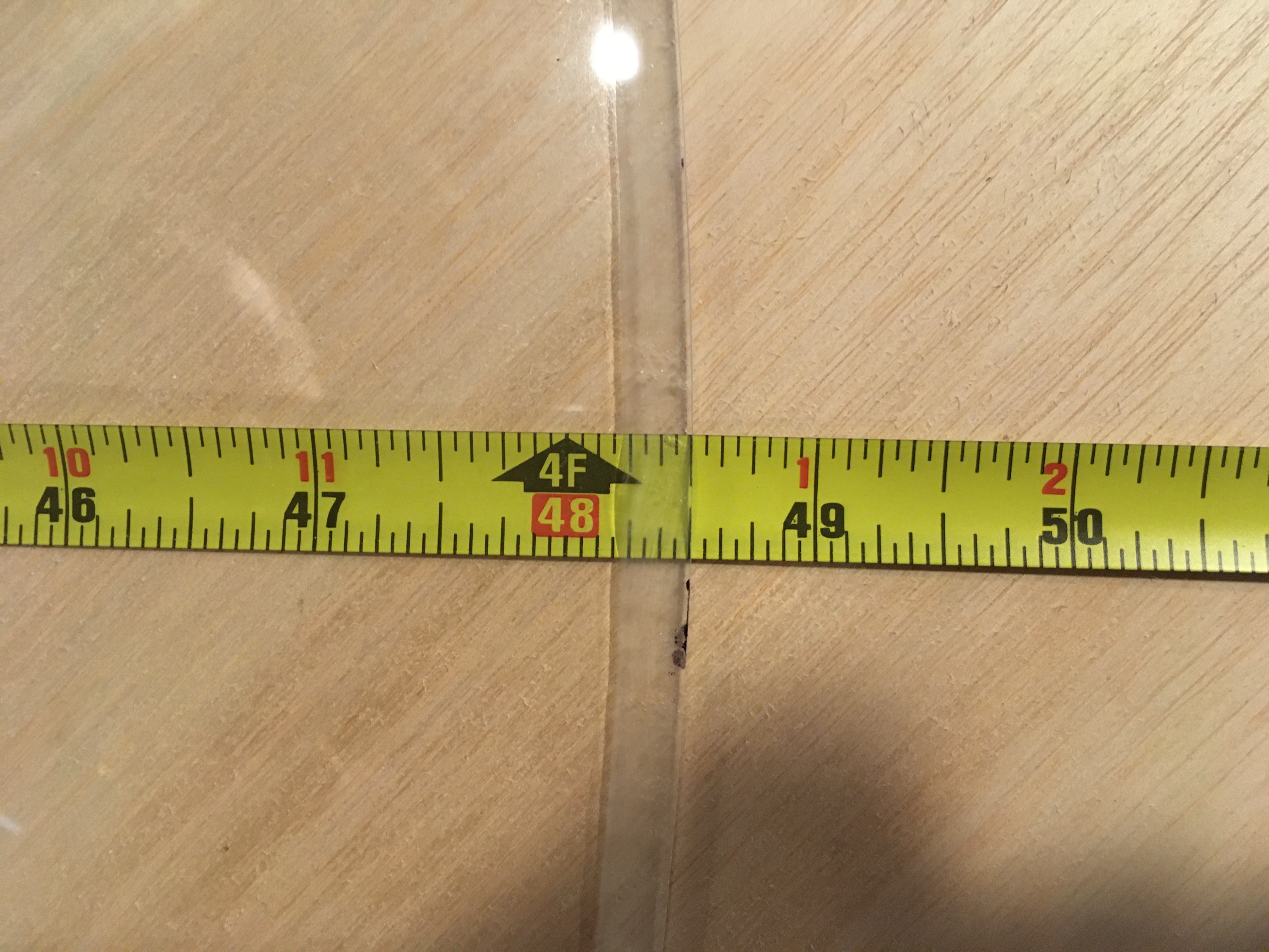

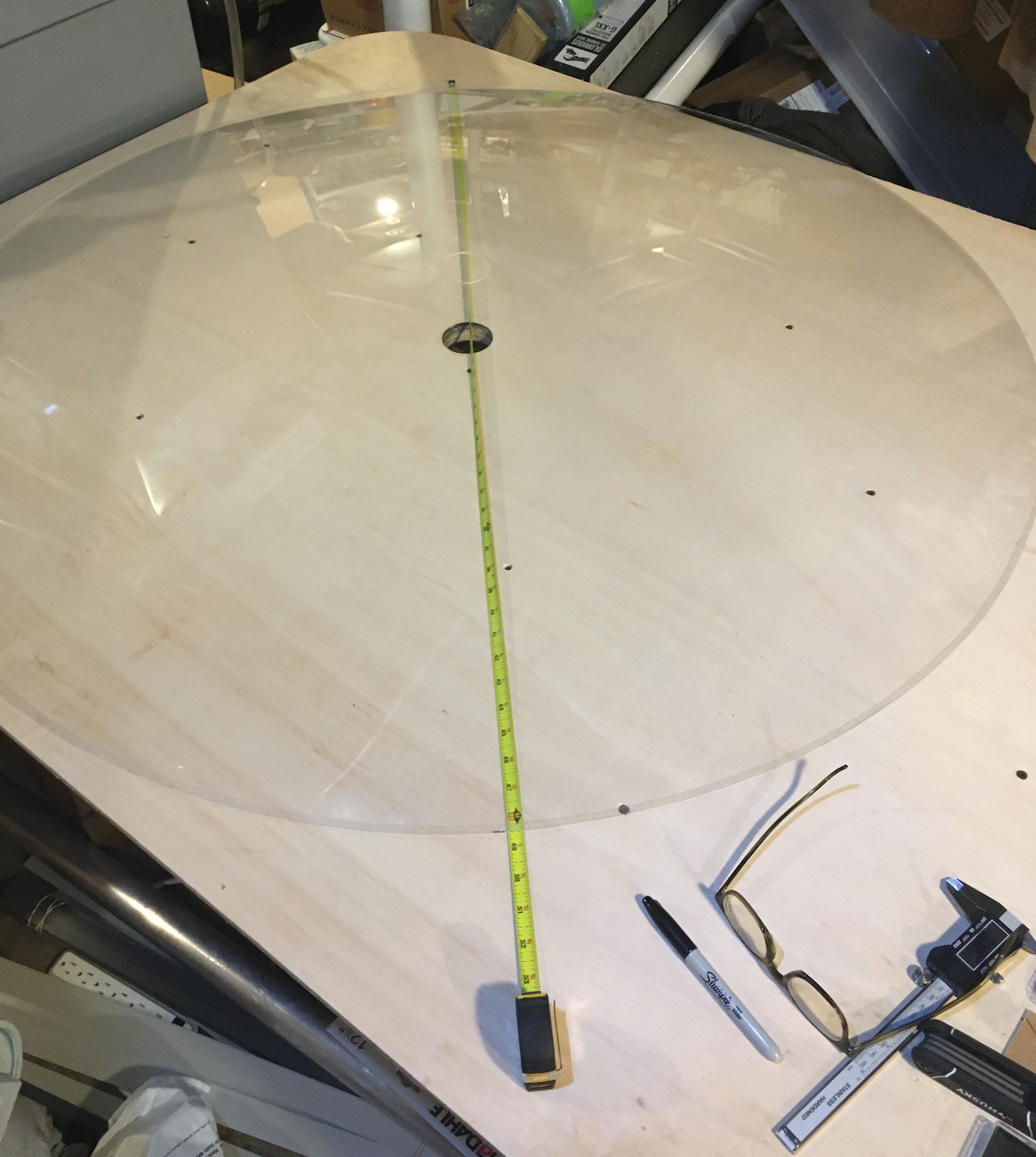

The above photo sure LOOKED good, but upon measurement, it was 47.5" at OD (not wide enough) and 4.5" high at center top of dome, a full 3/4" too high off the specified 3.75" height.

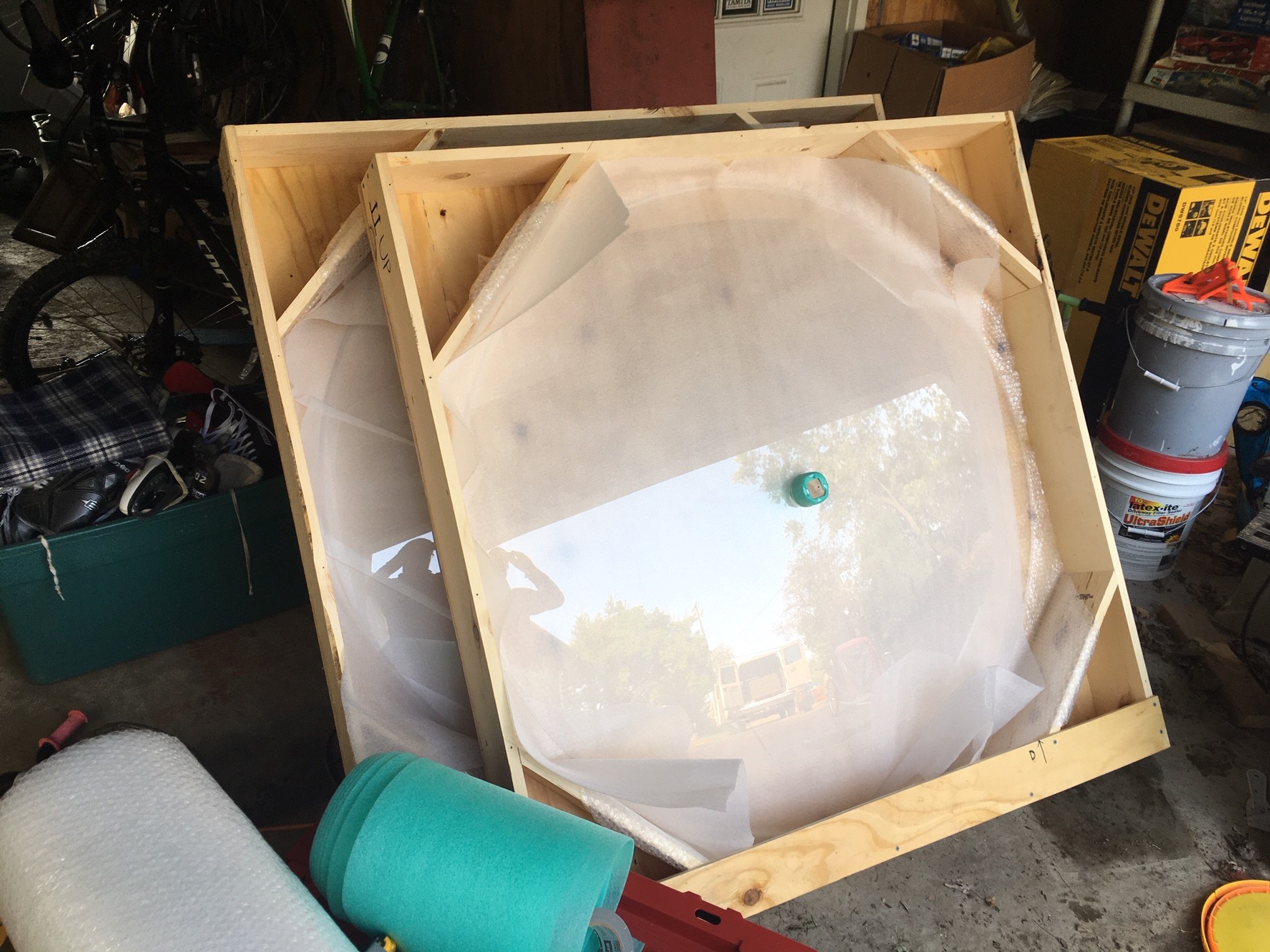

I made this order back in March of 2020.
Today, September 15th, 2020, the problem was finally corrected:
The correct outer diameter was achieved....
Here's a close-up of the OD -- as close to 48.56" as is likely possible:

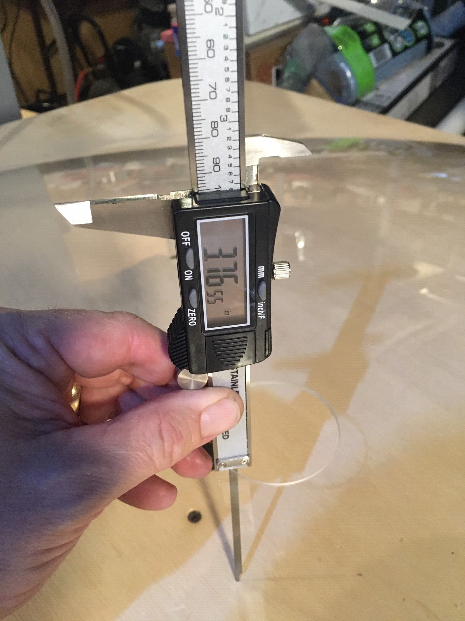

Here's a close-up of the height -- 3.75" requested, and we landed on 3.7655 -- totally happy with a number this close. (That's less than half a millimeter off -- 0.3937 mm to be exact)
Anyway, this is six months overdue and many thousands of dollars more than expected, but still it's always satisfying when something finally, actually, works out. So the truth is, I couldn't be happier.

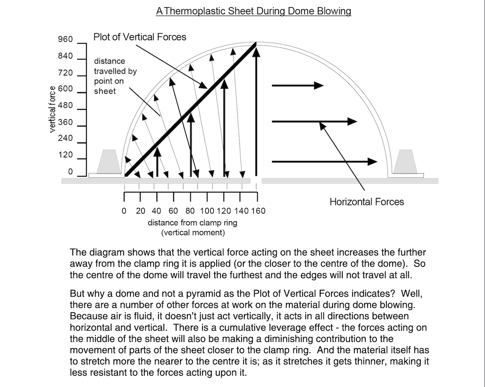

The domes are indeed asymmetrical. One is "saggier" than the other. Further, they are non-spherical, meaning of non-constant radius across the dome form.
(Screen grab from https://static.rapidonline.com/pdf/34-8646m_v1.pdf)
If anyone is interested, here is a paper on some of the materials science: https://iopscience.iop.org/article/10.1088/1757-899X/48/1/012004/pdf
Regards,
André
Very interesting Andre...thanks for that, it explains a lot
