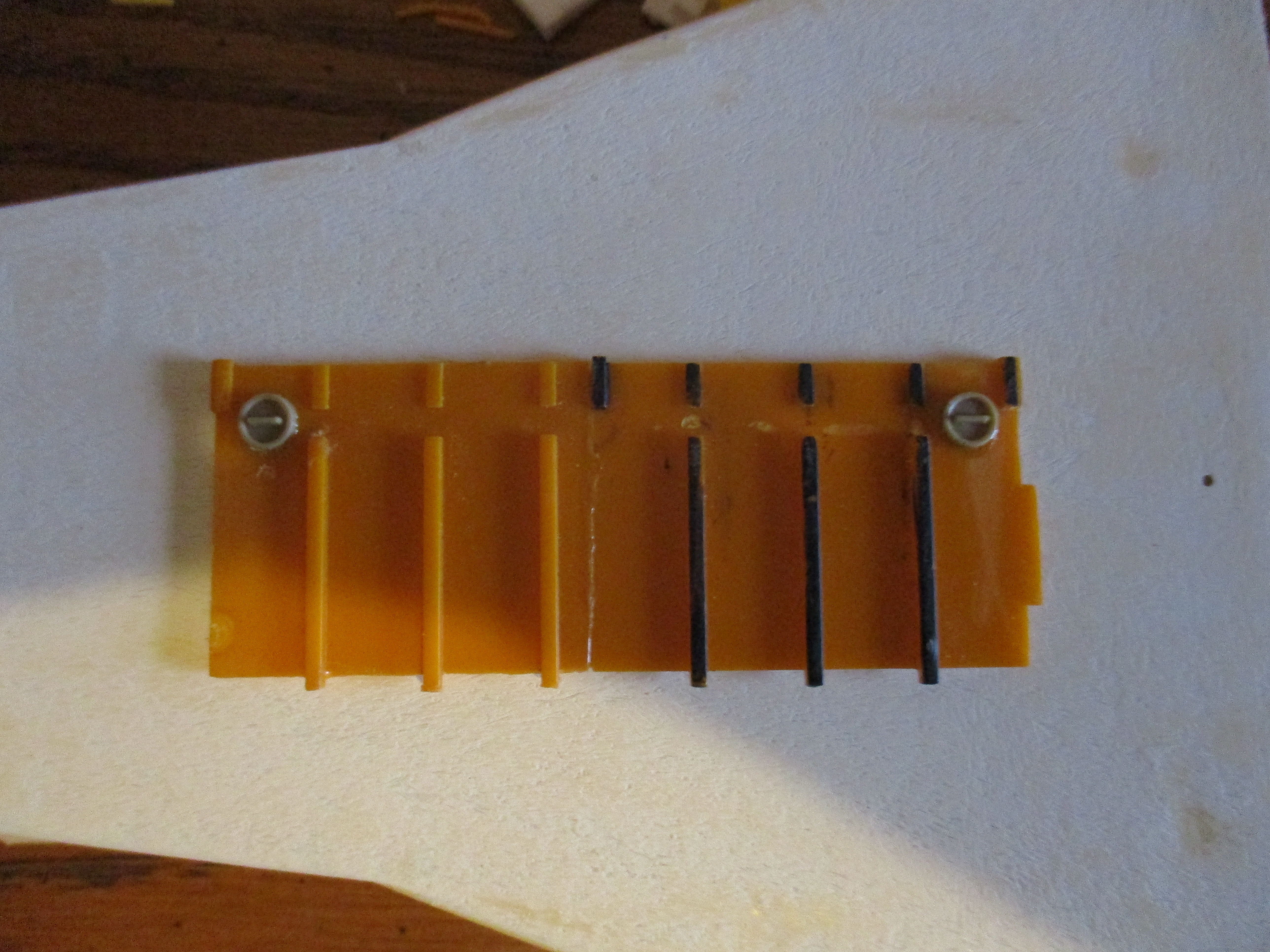

I'm slowly printing parts for a 5 footer. There are so many busted links and missing pics it's hard to find some parts. Has this part been identified? Thanks,
John

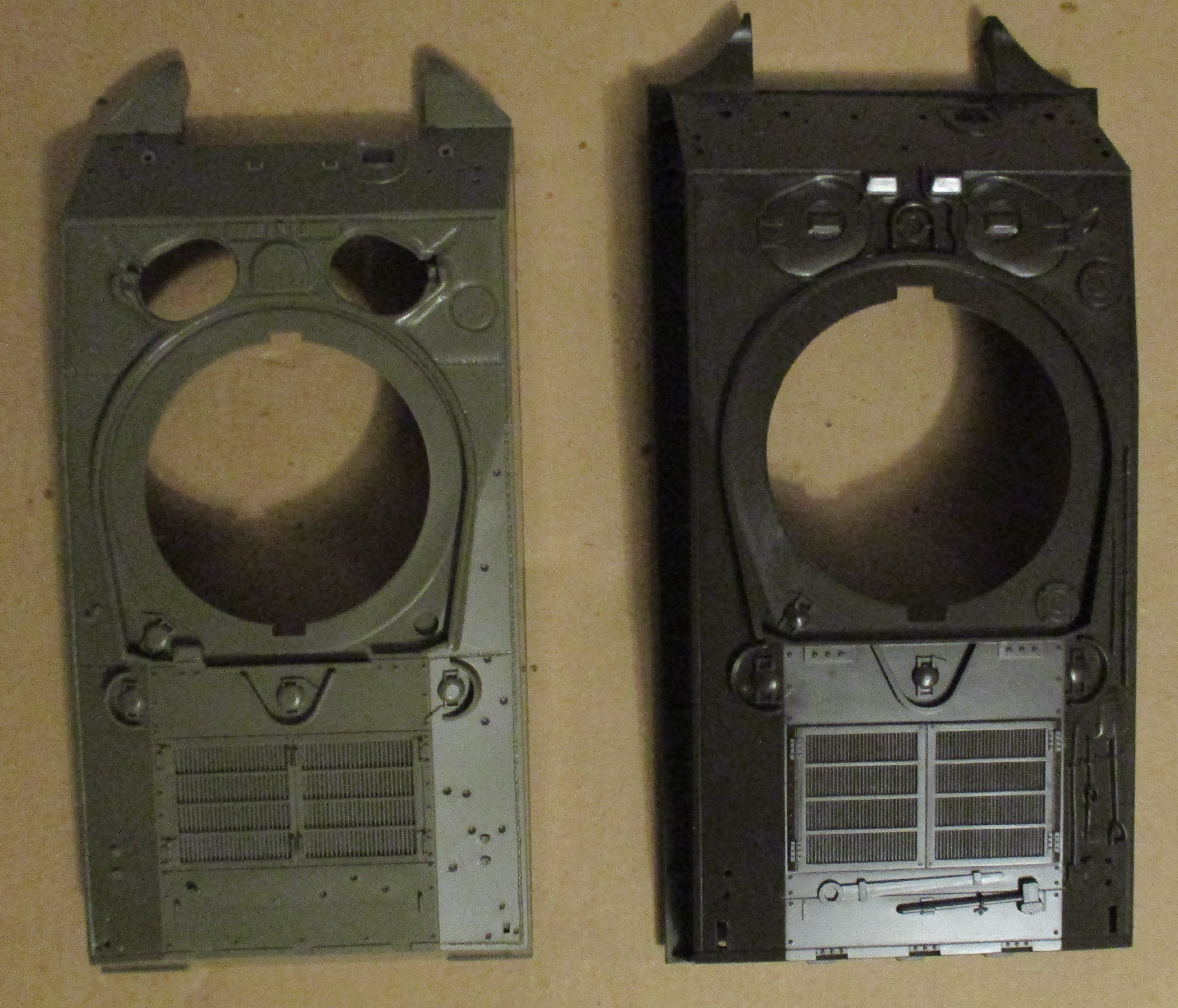

Here is the correct Sherman to get for the upper deck engine vents, cut out, then cut in half, to use as underlayment for the side docking rings.
If you were to get the modern Sherman by Tamiya, you would be off in your height by nearly 3mm:
Height on the modern Sherman: 22mm Height on the vintage Sherman: 24.8mm
Width on the modern Sherman: 45mm Width on the vintage Sherman: 46.5mm
Wow, didn't know about that. So, you really have to go "vintage" to make it accurate...got it(y)(y):cool::cool:

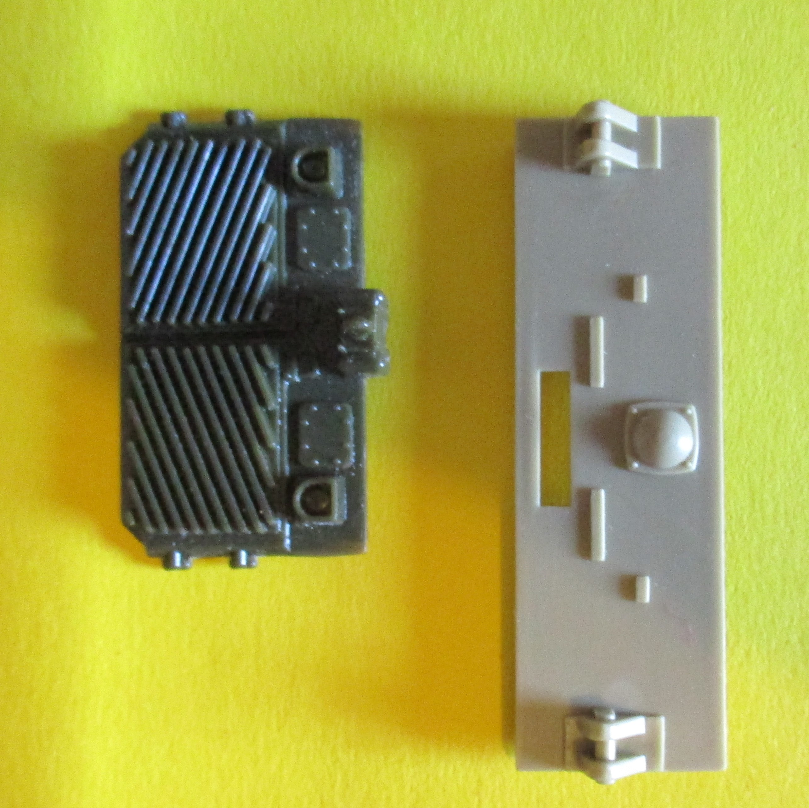

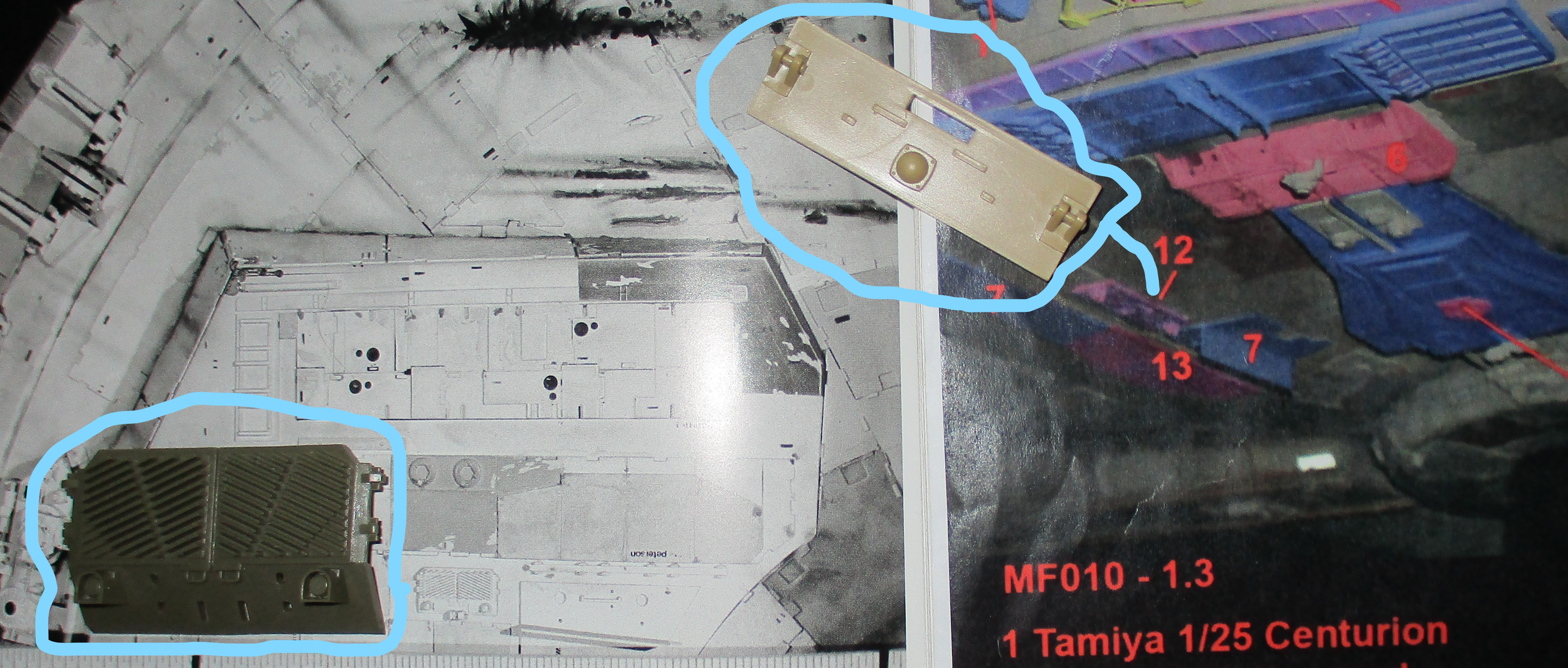

Portside rear of the landing gear box area -- here's one of the areas where it's critical to have multiple reference sources.
On the left, the original 1975 prop underside from the Chronicles reference book, with Part #A15 from the Tamiya 1/35 M60 (modified, with a center-edge greeblie added).
On the right, Gorts Parts Map MF 010 - 1.3 with entry 12 listed as the Tamiya 1/35 Panzerkampfwagen III Ausf. M/N part #A21, which is clearly a later shot of the current prop in its current state.
So ILM replaced this piece with the other piece.
Interestingly, though they are not at all similar, they do share roughly the same width:
Me, personally, I'm going Old School, because 1977...
Question: What is the added greeblie on the center edge of the old-school M60 piece? And is it attached to the M60 piece, or just adjacent to it? Looks like it's placed beside/on top of it, to my eye, but I can't tell for sure.

The left side piece, on the Original Falcon prop, is NOT from the Tamiya 1/35 M60, but from the vintage Tamiya 1/48 M60, part #A1, and THAT is what explains the "added greeblie" on center-edge.
Pic coming soon.
3 steps forward, 2 steps back...
Craig,
You don't think it was ever replaced? But it's not on the picture in Gort's maps, and a piece that wasn't there before is in it's place. What else could explain this discrepancy? Are they "both" there, and I'm just not seeing it? Send pics, if you've got them.

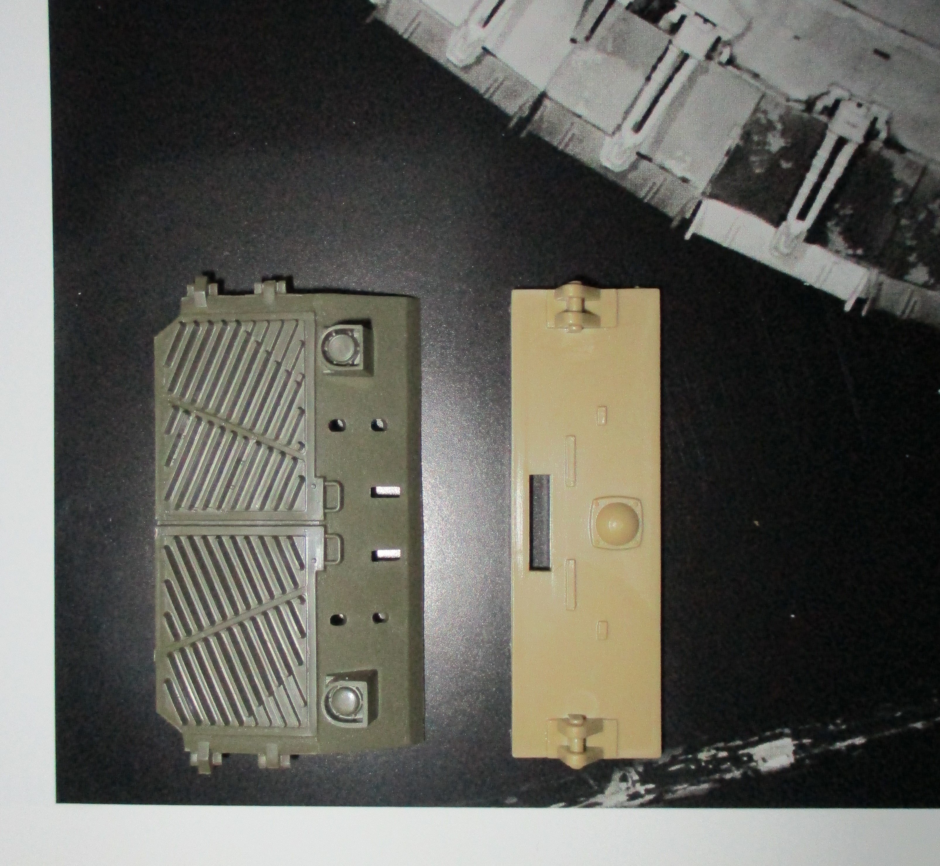

Tsophika is right again: I got the left and right side of the gear box confused. So here are the correct, non-replaced greeblies:
On the left: the Tamiya 1/48 M60 (vintage), Part #A1 (goes on the starboard side of the Falcon gear box)
On the right: the Tamiya 1/35 Panzerkampfwagen III Ausf. M/N, Part #A21 (goes on the port side of the Falcon gear box)
Man, that was really confusing me for the last two hours, because I was reading Gort's Parts Map as the "same side" of the gear box as the Chronicles photo...
Thanks, Craig!
Technically I think the Panzer part A21 is part B21, and I think it would have been from the Sturgeschuetz Ausf G. Both kits share the same sprue B as the Ausf M/N.
But I'm splitting hairs ;)
