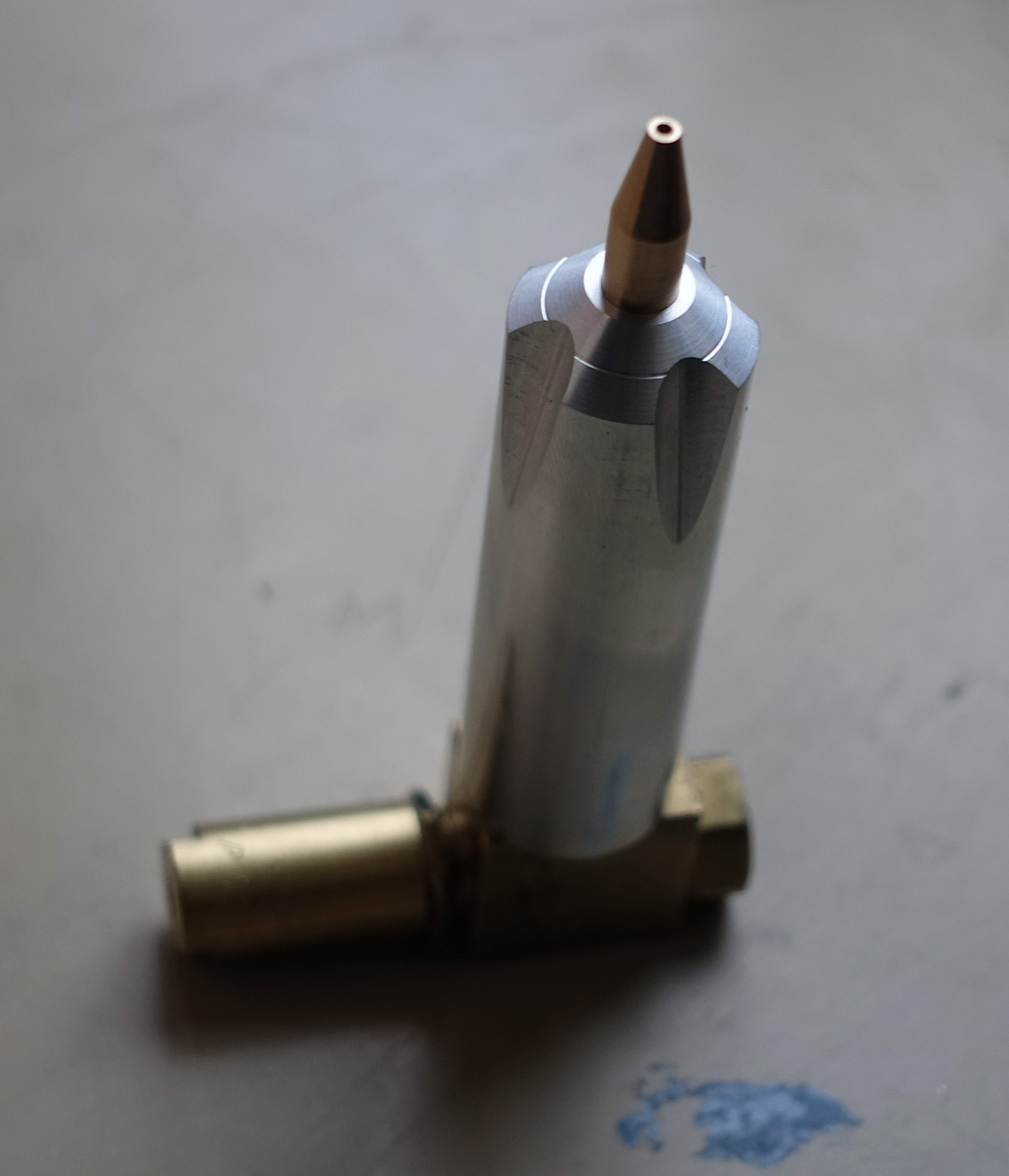

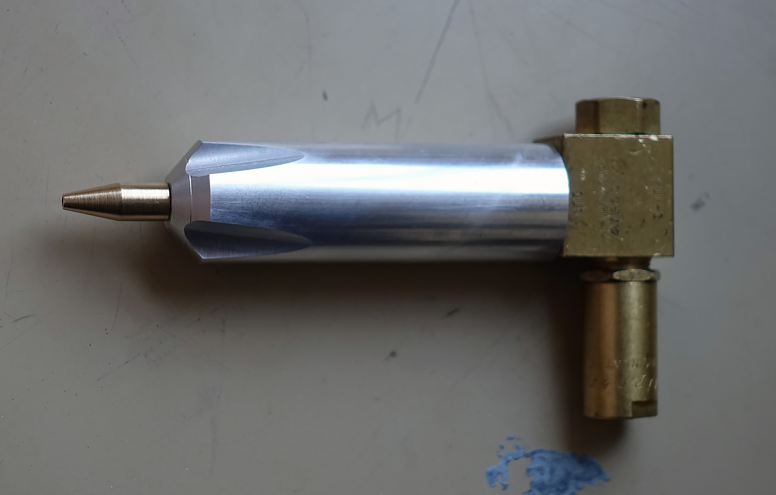

hey guys,
can't resist showing you because I'm so happy that this part is finally done and perfect! but I didn't make good photos, so I'll do more tomorrow with the camera :)
I hope you'll like it, this was a part that was worrying me from the start :)

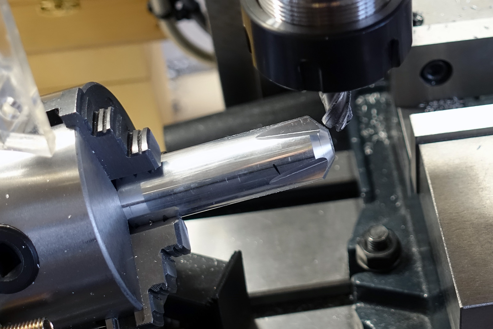

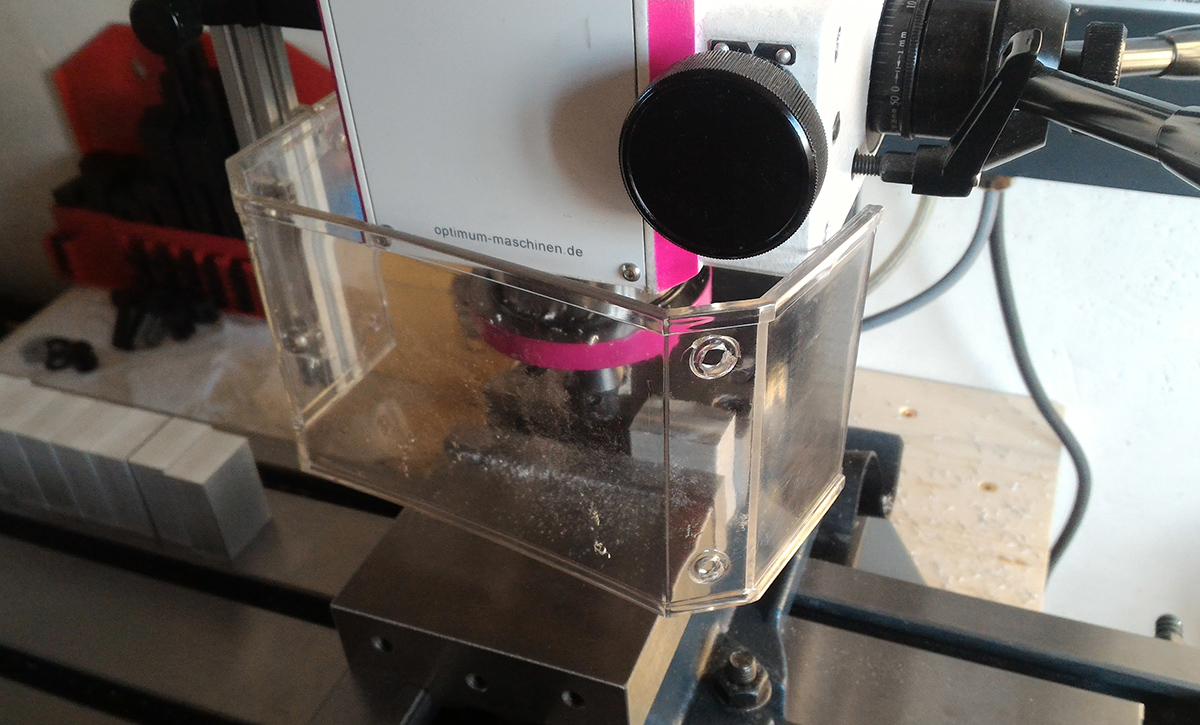

ok, for the next milled pieces, I need to do a few 45° angles on the parts, the mill head can rotate theorically, but don't get me started on that, I lost about half a day trying to figure that out, that mill is an amazing addition to my tools but it has so many misconceptions, it's crazy! I'll need to take some time to fabricate a few improvements for it if I can because it's pretty bad in some places.
very basic stuff, for instance, the protective screen doesn't have enough clearance to go around the precision depth module on the right of the motor, here I removed the inside sliding piece of the screen to try to gain some room but it is still not enough. this is something that would have taken a second to fix in conception, but it will take me half a day to try to fix it myself now... that's just an example of a simple issue, but it has much bigger conception issues in several places.
anyways! I guess I got myself started on my own in the end... sorry!

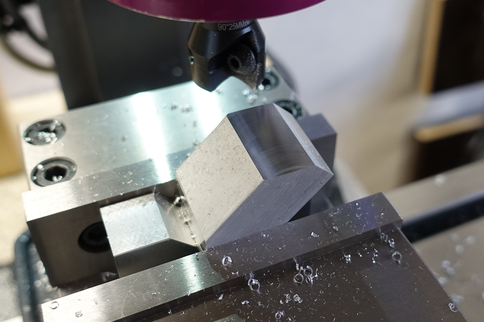

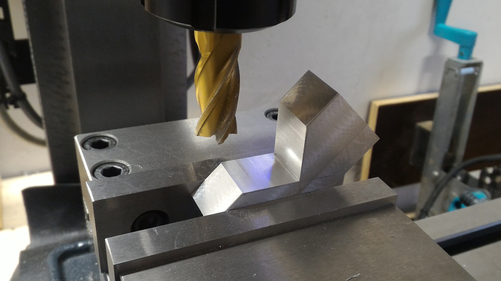

so I was saying, I needed to do 45° angles, so I milled a small V shaped holder for the pieces:
that makes things easy and quick to use!

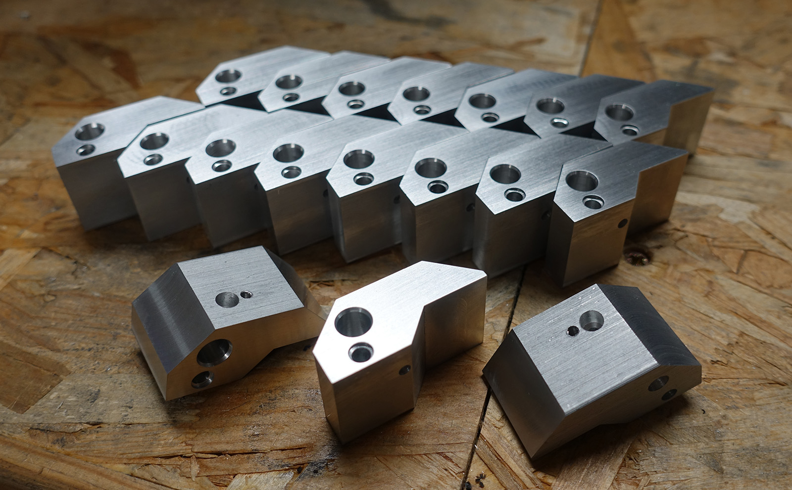

here are the "triangle" rocket holder pieces being machined (#13 on initial plan):

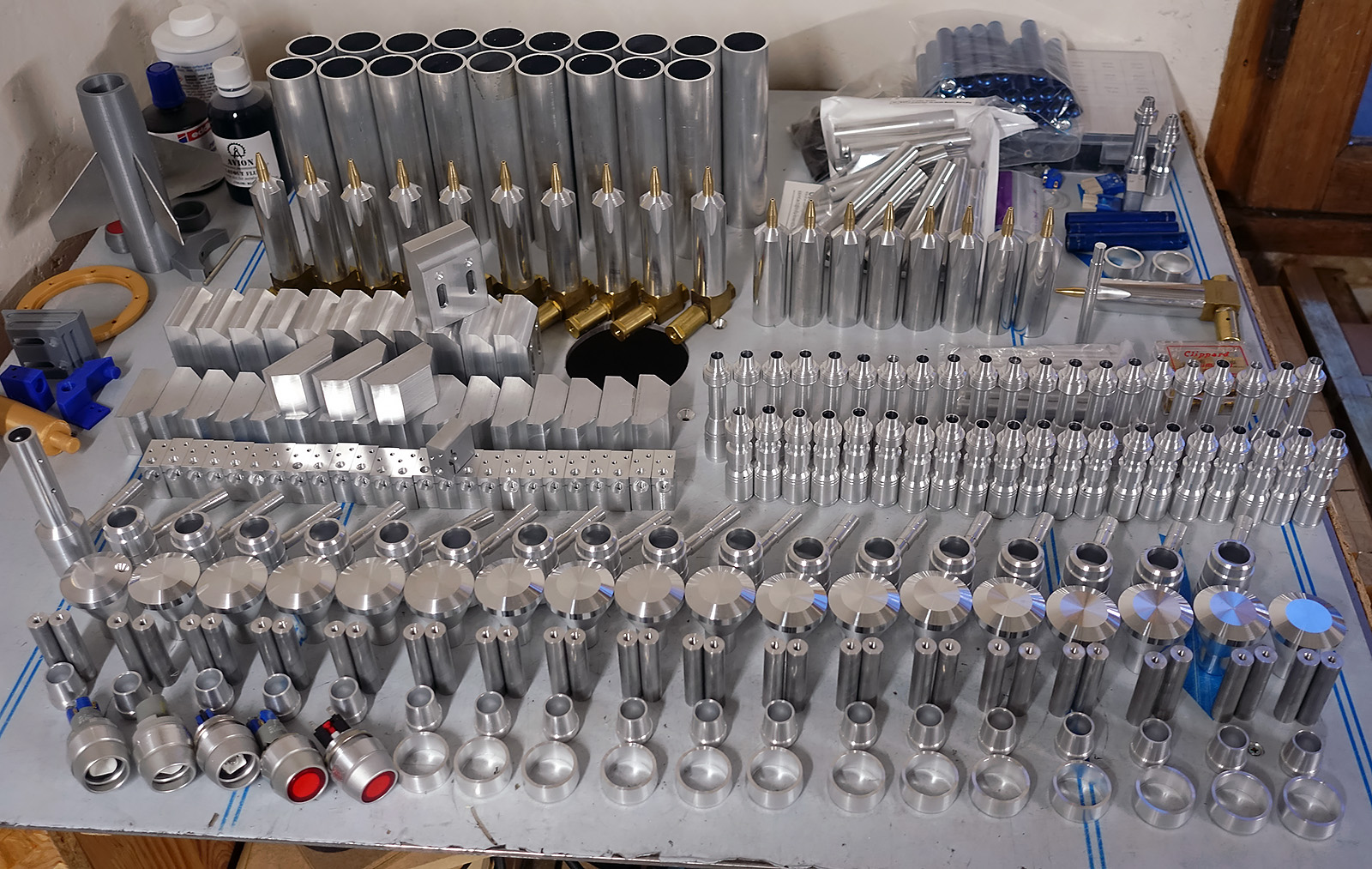

and... I think it has been a while since I showed my router table full of parts for that run :) :) it is starting to be a real mess :) :)

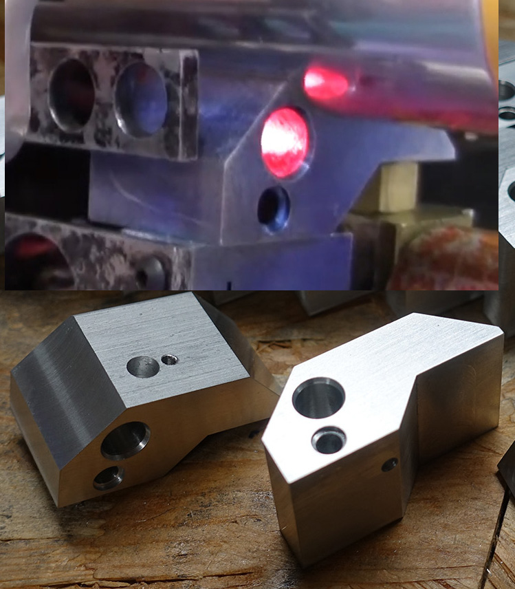

here is a quick update with the almost finished rocket triangle support :)
note the exact detailling on the holes, bevel on the upper hole and large hole/bevel/smaller hole on the bottom hole :)
sorry, I didn't think to take a photo in a somewhat similar angle to the ref!
