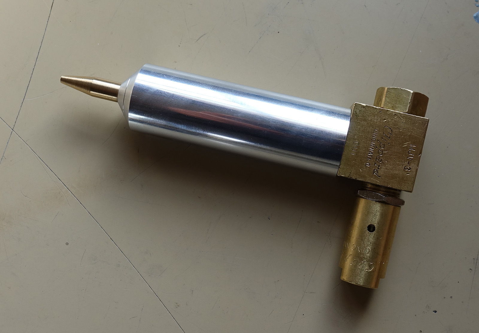

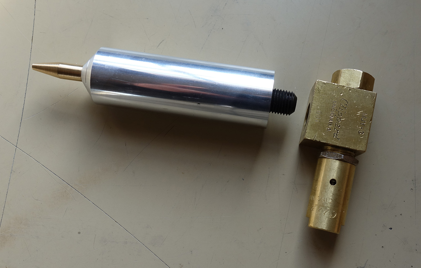

I did a lot of not so fun things today, mostly precisely measured holes and threading parts and stuff... but it's good that it's done! I'll show how I threaded the flame thrower parts to go perfectly straight onto the clippard parts later on, I didn't take enough photos to explain.

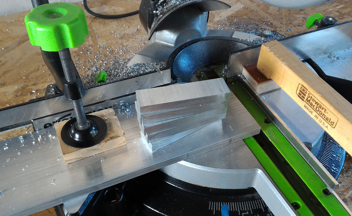

on top of that, I started preparing material for when I hopefully receive the mill and can start on the not lathe related parts. cutting 12mm thick aluminium into very small rectangles also take time!

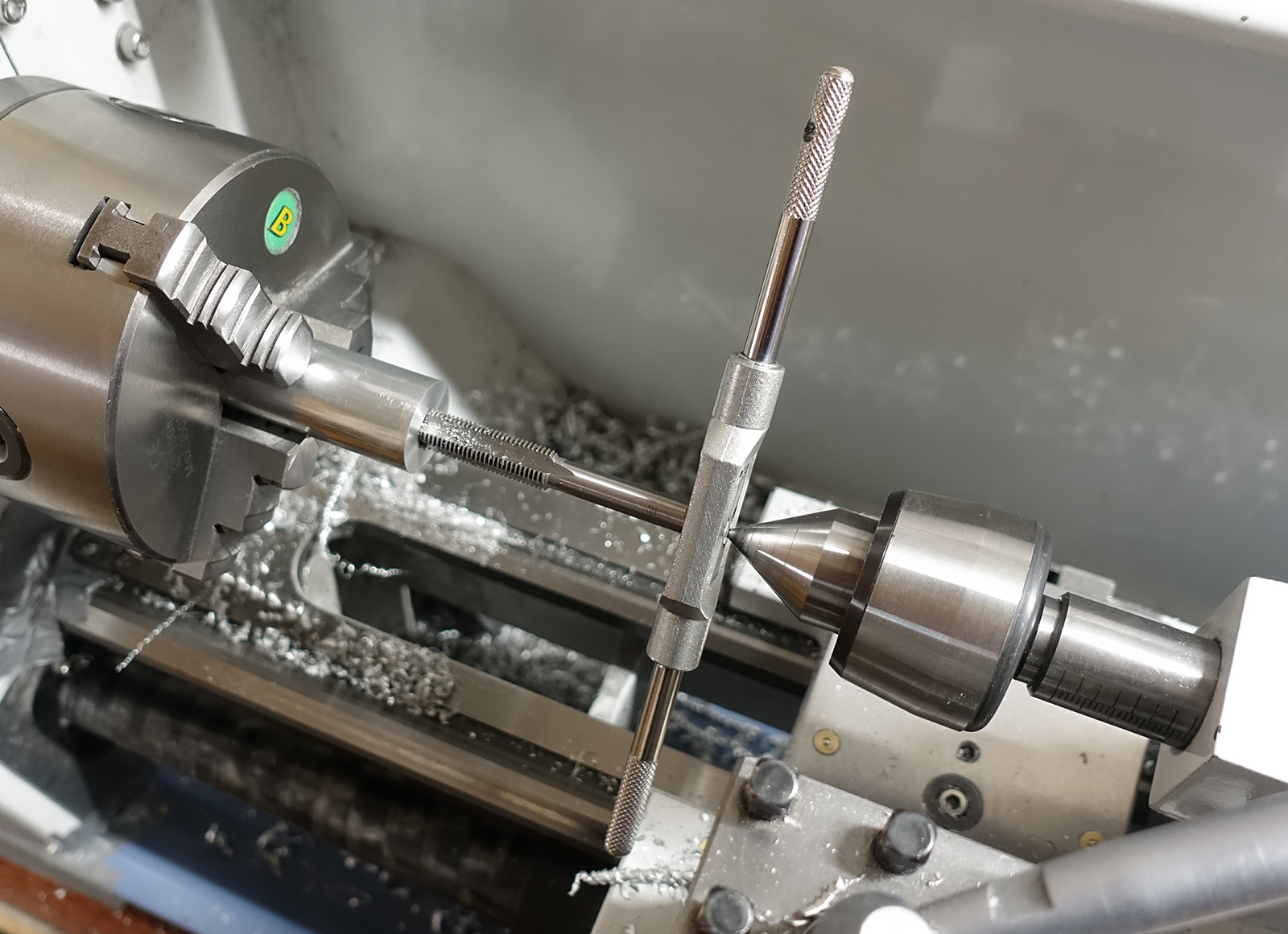

ok guys, so here is my small explanation on how I did the threading by hand but with the help of the lathe for a perfect alignment:

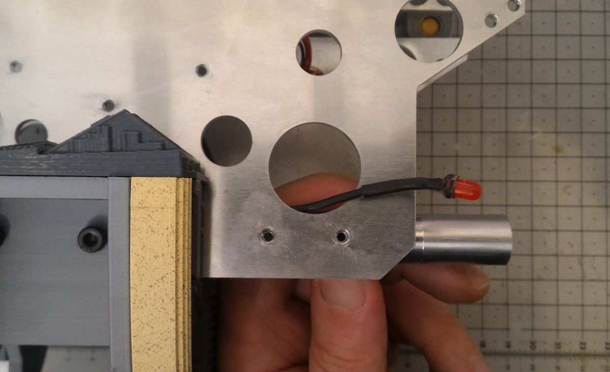

ok, appart from that, I continued on the non fun stuff to do and threaded all the holes for the ice cube system, 3 of them per piece. then I tested and attached each part to my own ZF-1 to make sure they fit perfectly! that was a fun moment putting then removing 36 screws.
here you can see how the holes are perfectly aligned with the ZF-1 frame, although it's not easy to hold a piece by hand and take a photo from the other hand on a smartphone...
and here with both screws:

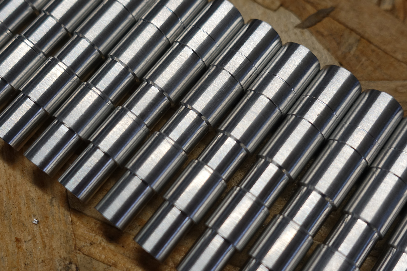

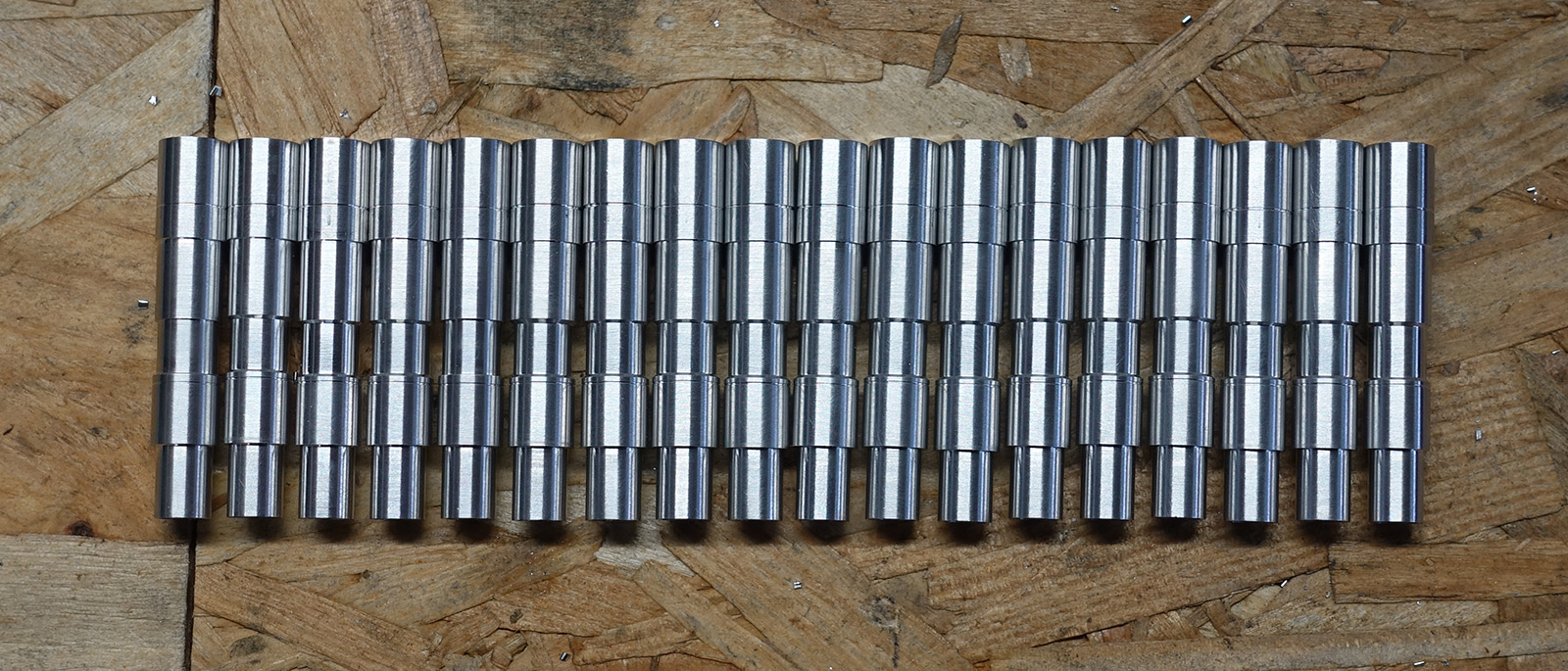

today, I did the ice cube system support tubes.

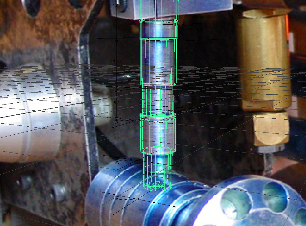

here is the 3D match to a ref:
without the 3D, to see a bit better the details that I reproduced, including the two small lines at the top and inferior third:
and here are the parts :)
I hope you'll like them :)

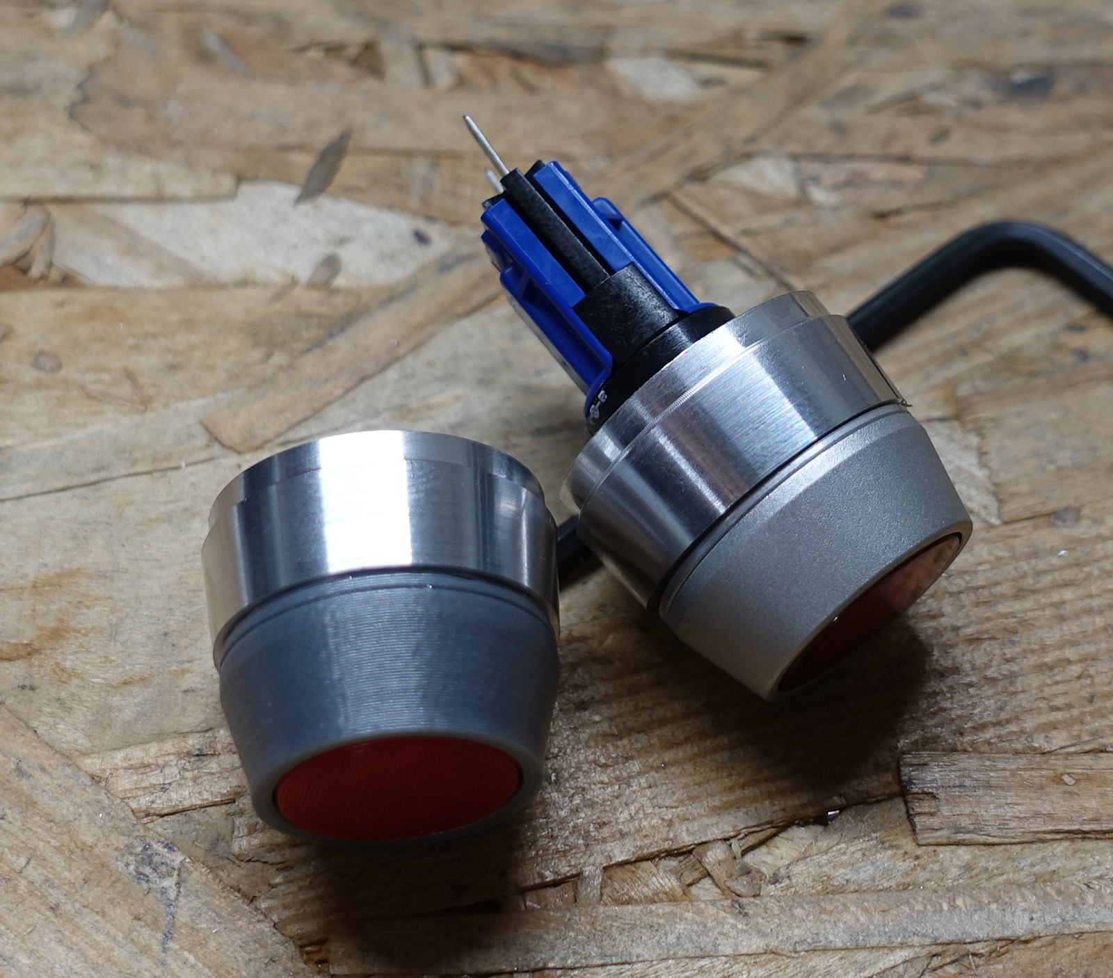

I started working on the red button contour rings today, which are the last parts that need to be turned.
well, this was supposed to be an easy part and I didn't put much time for them in the planning but they are turning out to be a lot more difficult than anticipated!
but this is worth it I think, this is a small upgrade but it has a good visual impact on the gun I think :)

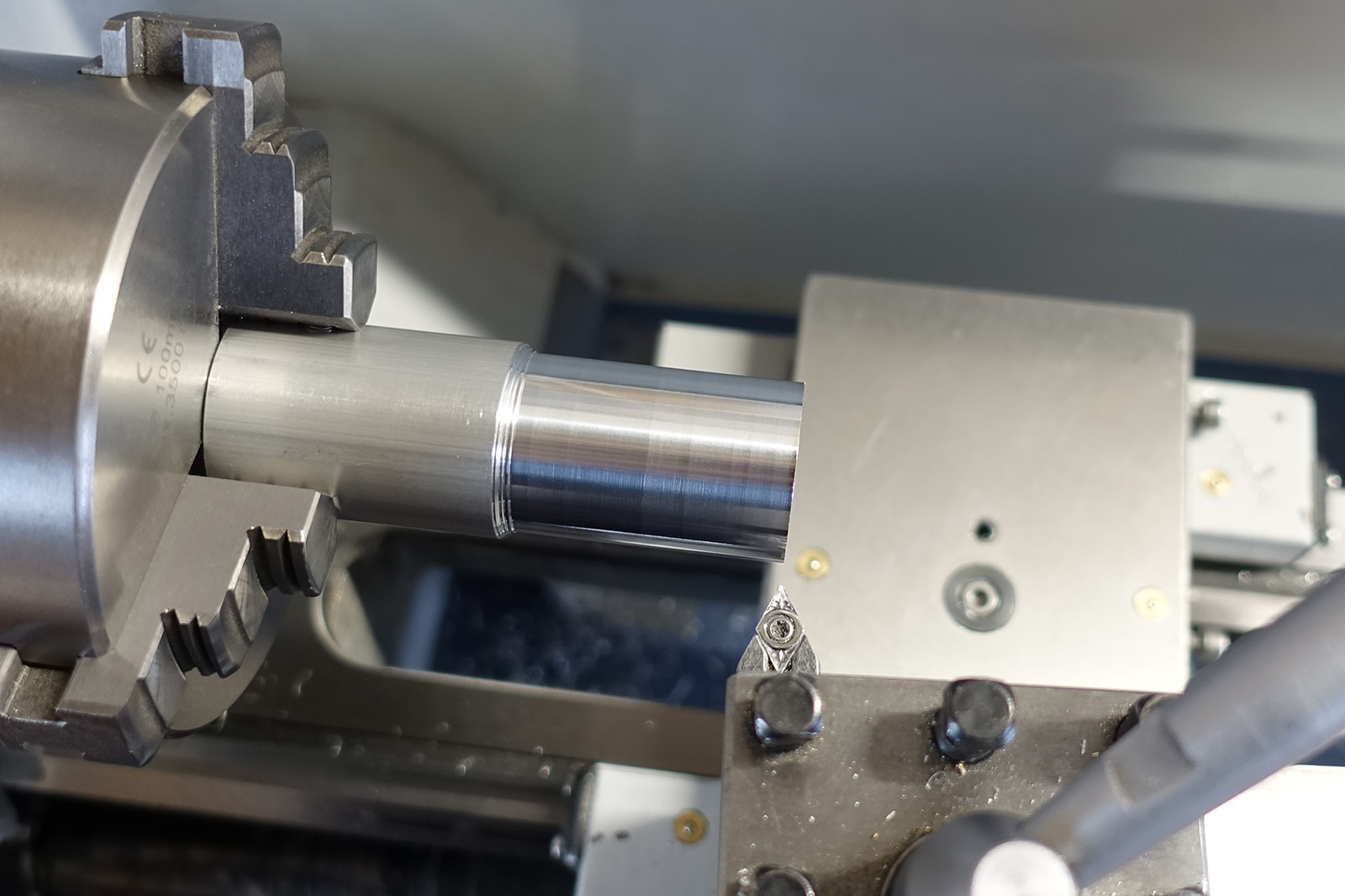

I'm starting from the closest tube I could find in size from my supplier, but there is a bit more waste that I usualy have on the outside sadly:
the reason they are more difficult than anticipated is that I need to enlarge a bit the inside of the tube until it fits the red button tightly, then remove 3mm of diameter from the outside. and I'm working with length of 10cm and doing 3 or 4 rings on it, then taking another piece of 10cm and starting over. The is the only way I have to do that as the tube is too large to fit inside the center hole of the lathe chuck and I can't have much more than those 10 cm as it starts being dangerous to work with after that.
here it is almost done, just need to cut it from the tube:
and here are two finished ones with a real red button and with the 3D printed red button.
I'm making them so they fit tightly the printed buttons and it works well, however, the inside is a bit large for the real button. but this shouldn't be a problem is someone wants to replace the printed button with a real one.
the back is turned to the good size to fit the hole in the ZF-1 frame but this is one of those parts that will require maybe a tiny adjustment to your own frame and some glue to make sure it stays on. Just the same way Jake intended it to work with the printed or resin parts :)

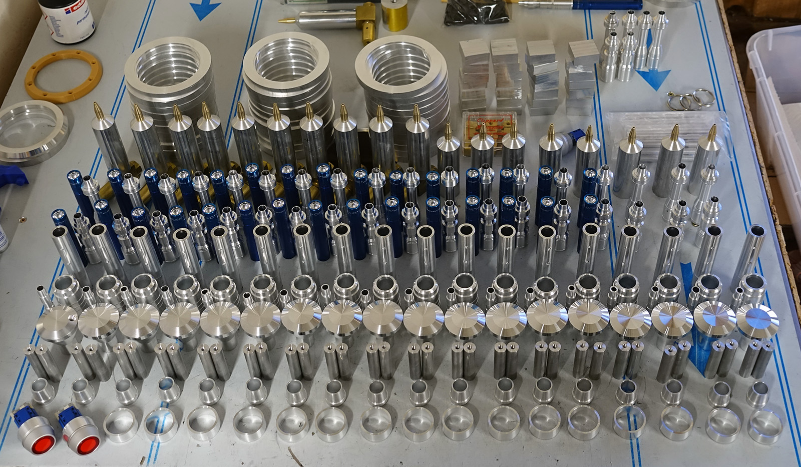

and here is an overall view of the run at this point, starting to take some room!

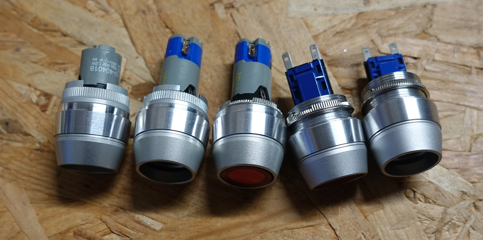

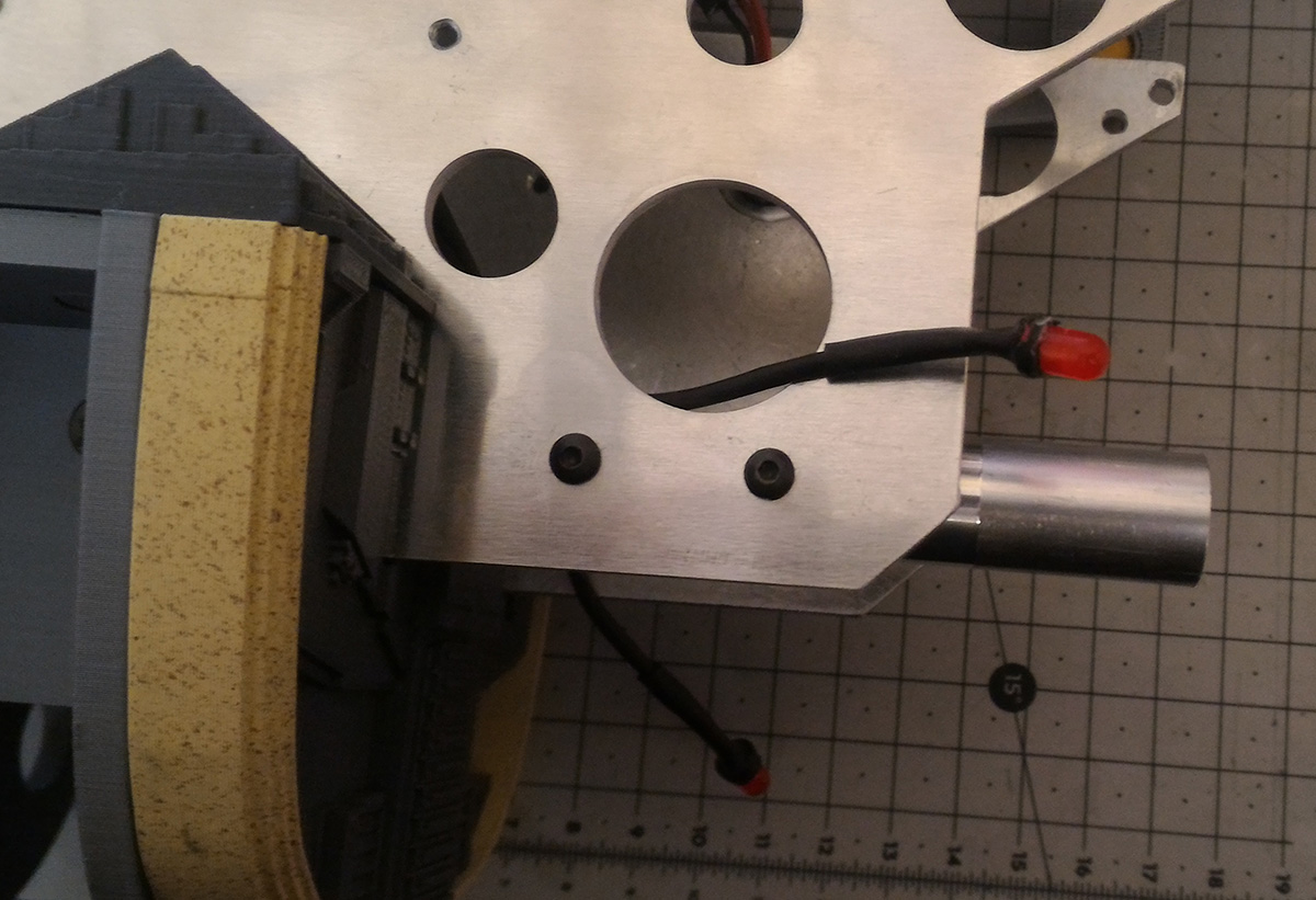

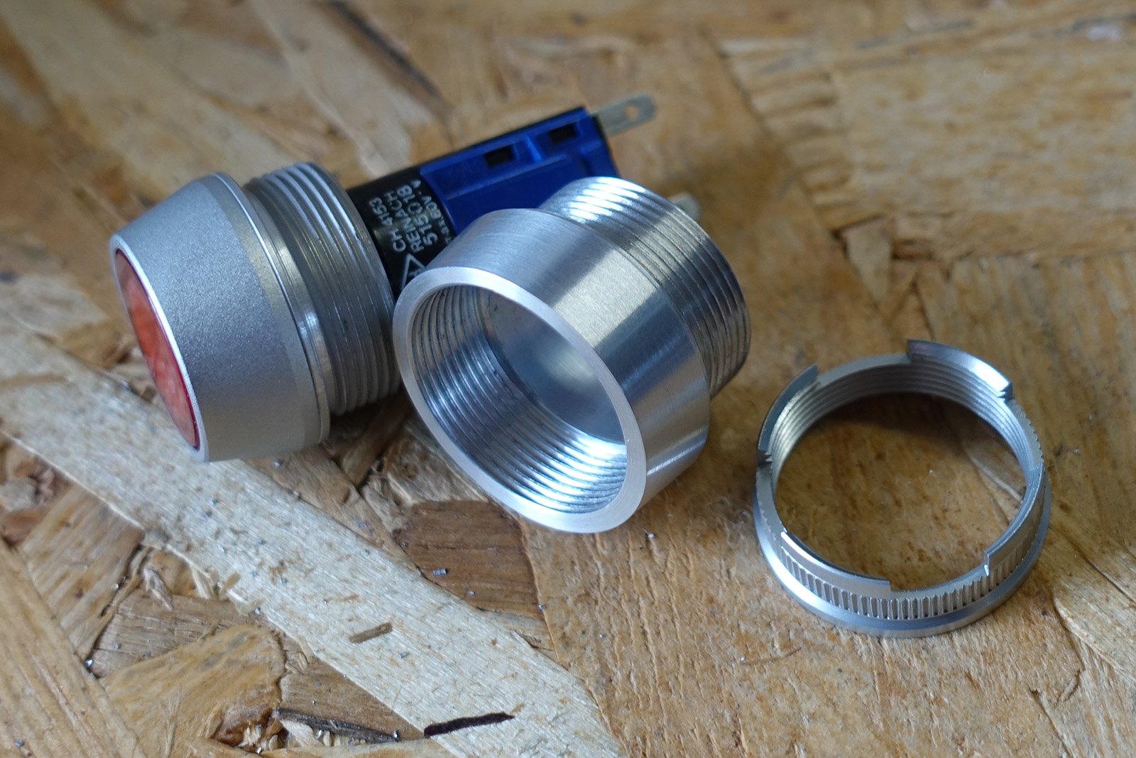

I worked on implementing real red buttons into the kit today and it was not a piece of cake! still have a few issues to work out but here they are with their respective custom bezels!
details can be found on the WIP thread:
No idea yet if and how this can make it into the run because of all the trouble it is to make them work and because of the last issues to solve. including finding red lenses for the 3 that don't have one.

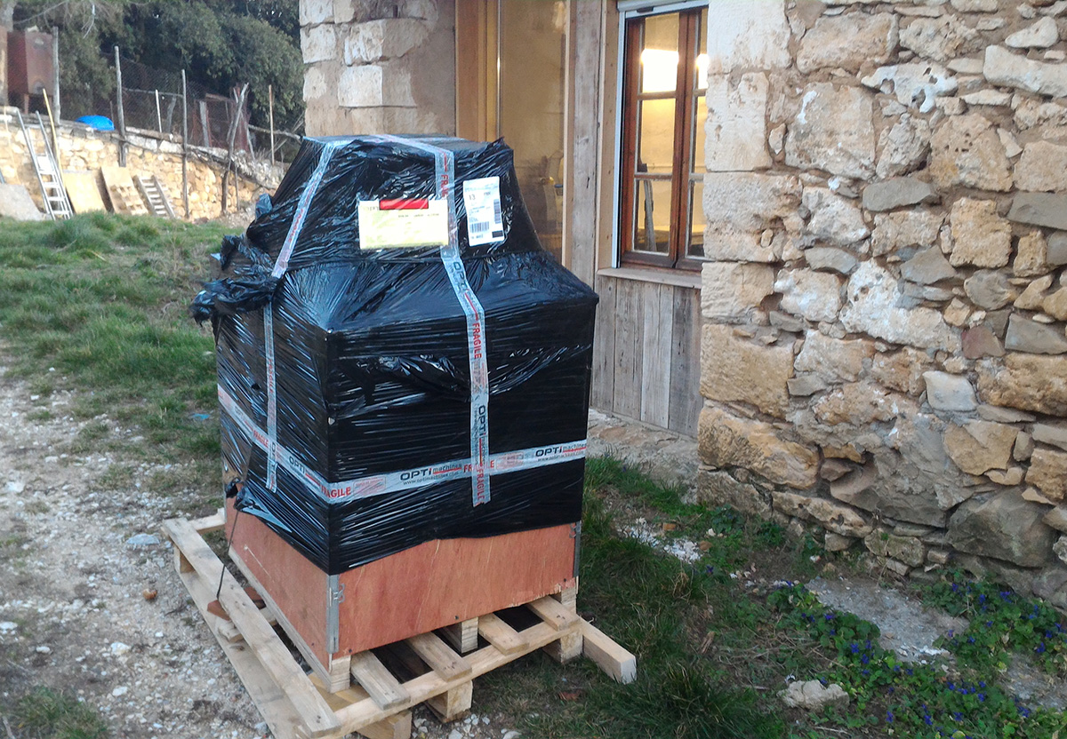

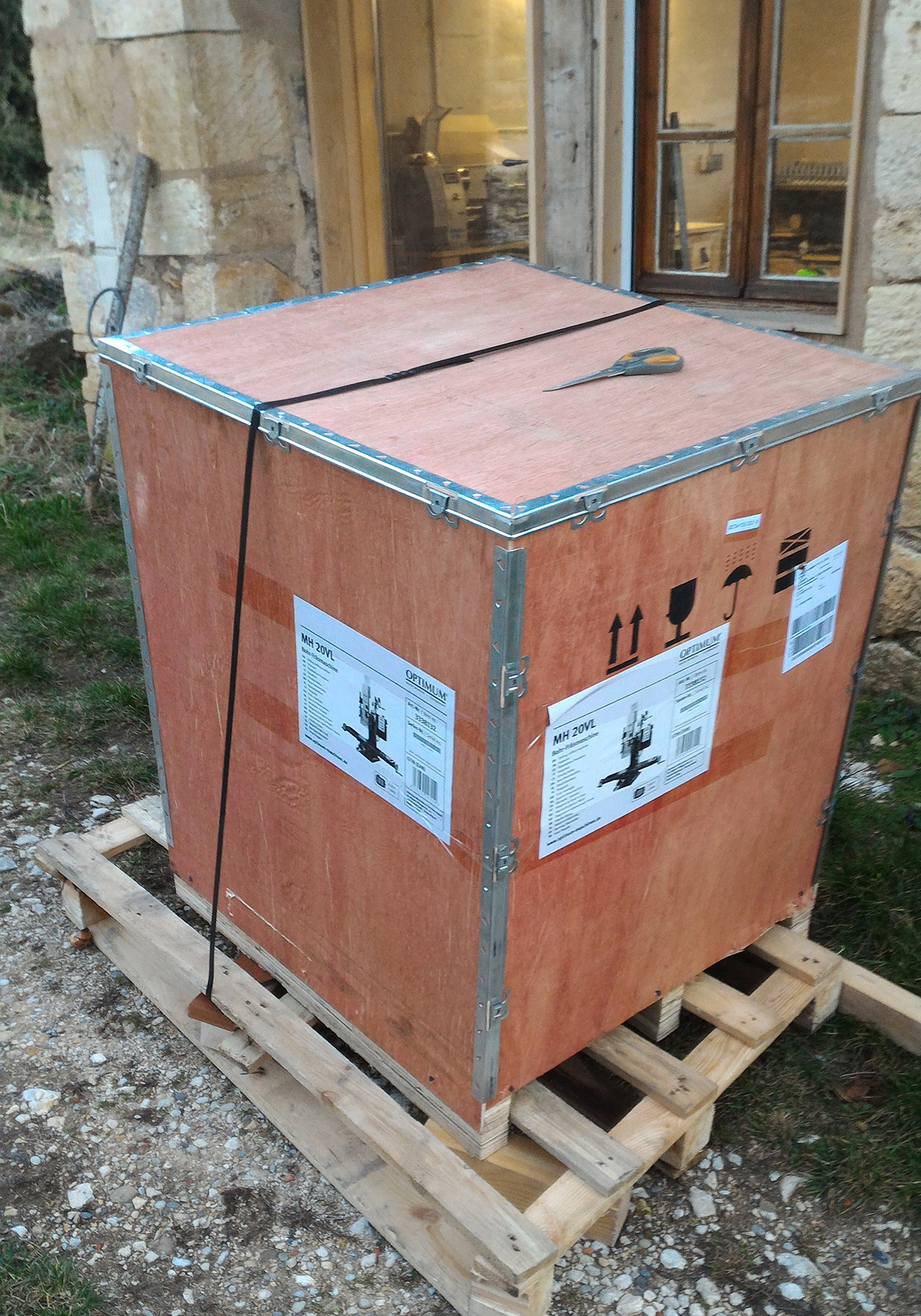

the new metal Mill arrived! without any phone appointment, without tracking number, just when I was leaving, fun stuff!
so, we tried to start moving it into the workshop tonight but didn't managed and my back is already hurting despite not carying much weight so far, so I'm pretty stressed about that and don't really know how we will manage to move it into the workshop and on to the workbench.
we already remove the upper section of the cross table to remove some weight, but there must be around 90kg left on the main piece...
will keep you guys posted!
Maybe just unpack it outside and bring it in in pieces? I'm sure the wood and edging of the container add a considerable amount of weight. Good luck and glad it at least showed up.
The wood is actually quite light but yes, I am removing it. We already remove the upper long part of the cross table which must be between 10 and 20 kg but i'm a bit scared to remove more pieces and not be able to put them back together because of their own individual weights.
Well, we are getting ready now and will figure out something!
A good update tonight hopefully :)
