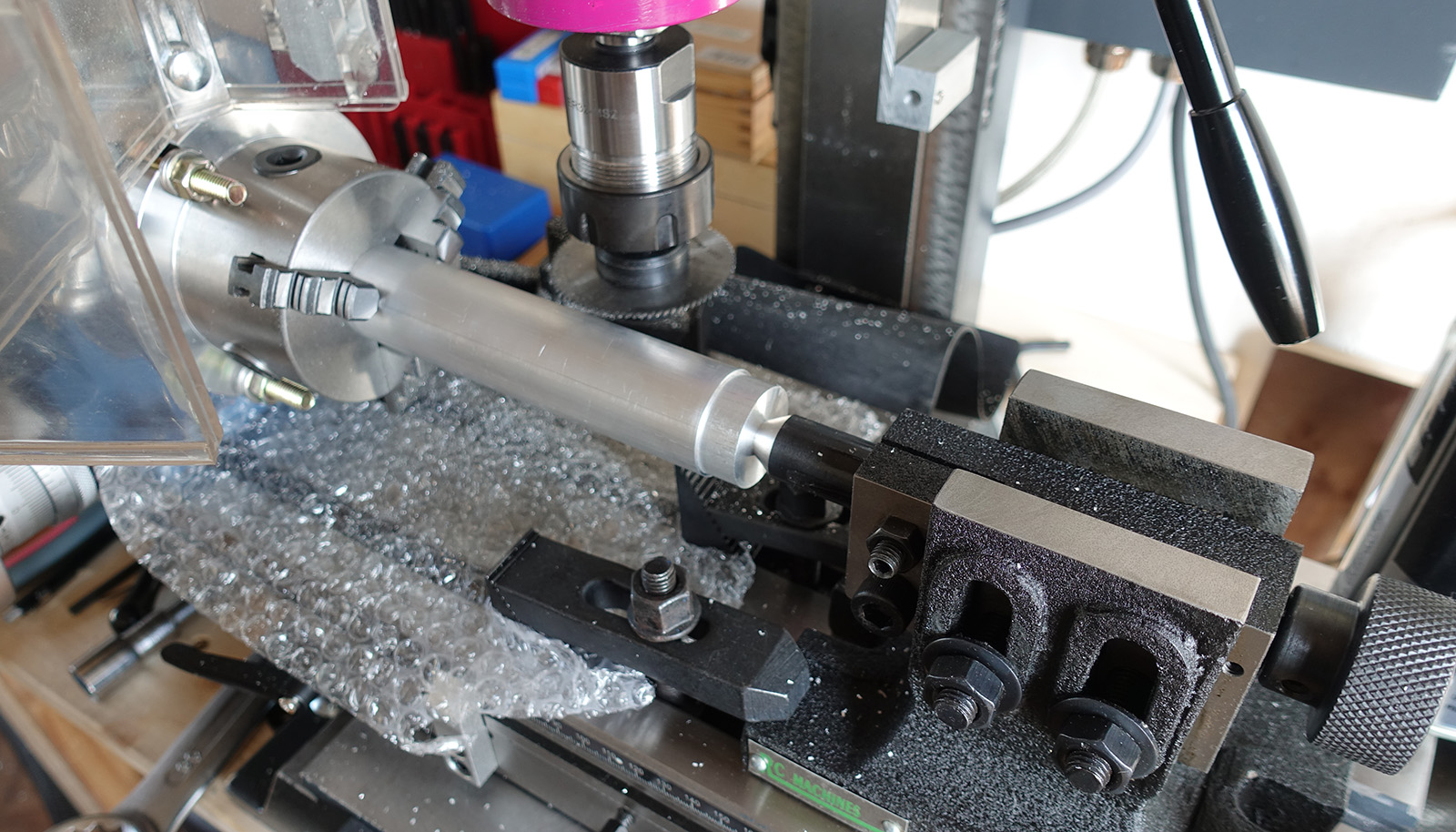

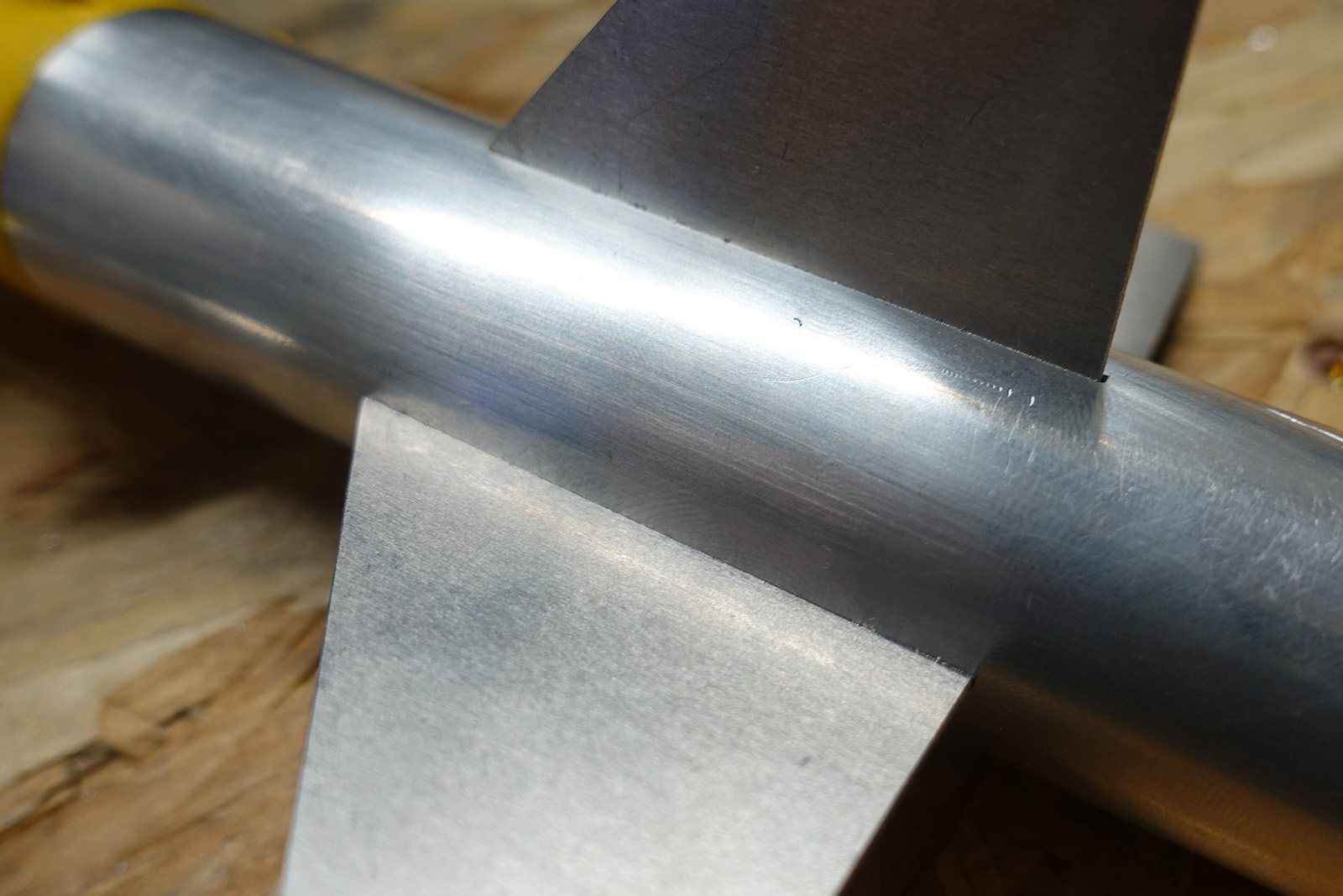

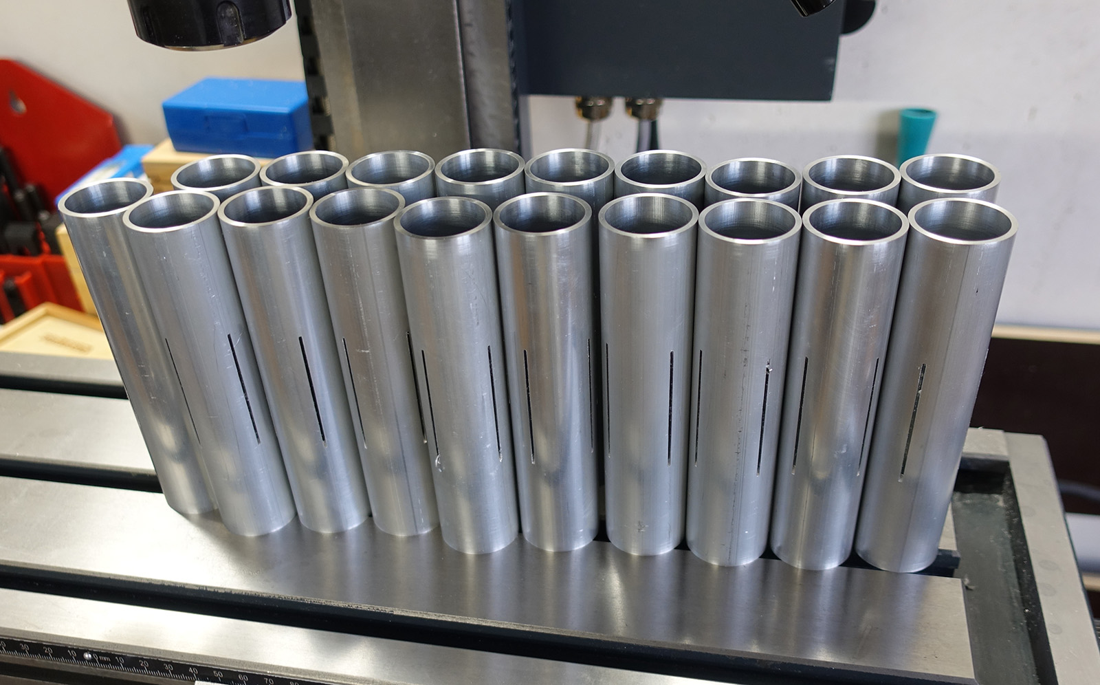

there was something I really wasn't looking forward to and it was doing the 76 slots for the wings on the rockets. well, this was boring and tiring but it went pretty smoothly, and I'm glad this is now done! this is also one of the few last steps left on that run, we are getting closer, and I apologize again that this is a bit delayed.
here we go, that was a bit of a complex setup and it took me a while to align everything properly!

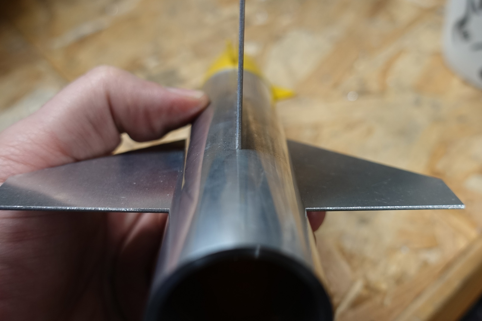

I'm really happy because I was afraid the fact that the tubes are only 2mm thick would be an issue to hold the wings straight, but it turns out the 1mm slitting blade did a perfect job of doing a very tight 1.2mm slot for the 1.2mm wings (nice flaw in that tool! for once) and I put my own wings on my tube without glue and it's a pretty tight and perfectly straight result, couldn't be happier!
I guess people should put a bit of glue for their wings, but I'm happy that the fit is really good as is :)
just to be clear, this is the most "kit" part of the kit. Most of the parts on the kits are drop in replacement and will actually already be assembled together even, but this one requires the wings from Jake's kit to be attached to, and depending on if you have the normal printed version of the ZF-1 or the deluxe kit, or even a real rocket, you'll need to adjust the rocket tip to my tube to make them fit nicelly.
In my case, I have the filament printed rocket tip and I just put a bit of thick tape around it until it was a snug fit, worked perfectly :)

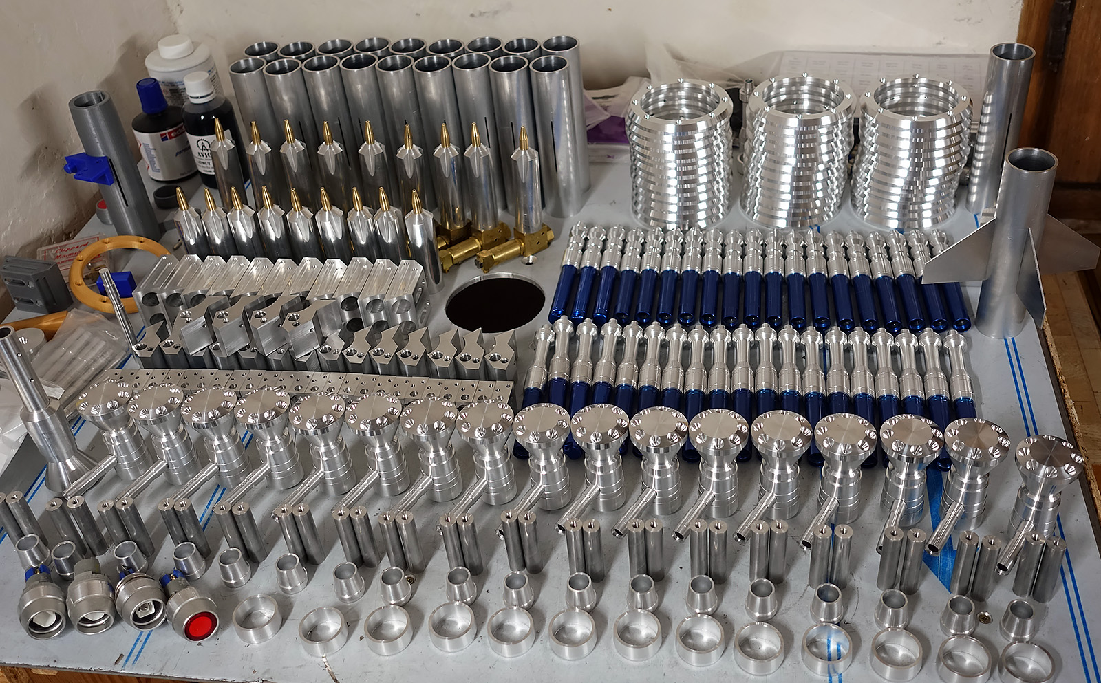

Here is a photo of where we are tonight, machining is 95% done, just a few steps left, the end is always troublesome and I am sorry for the small delay!

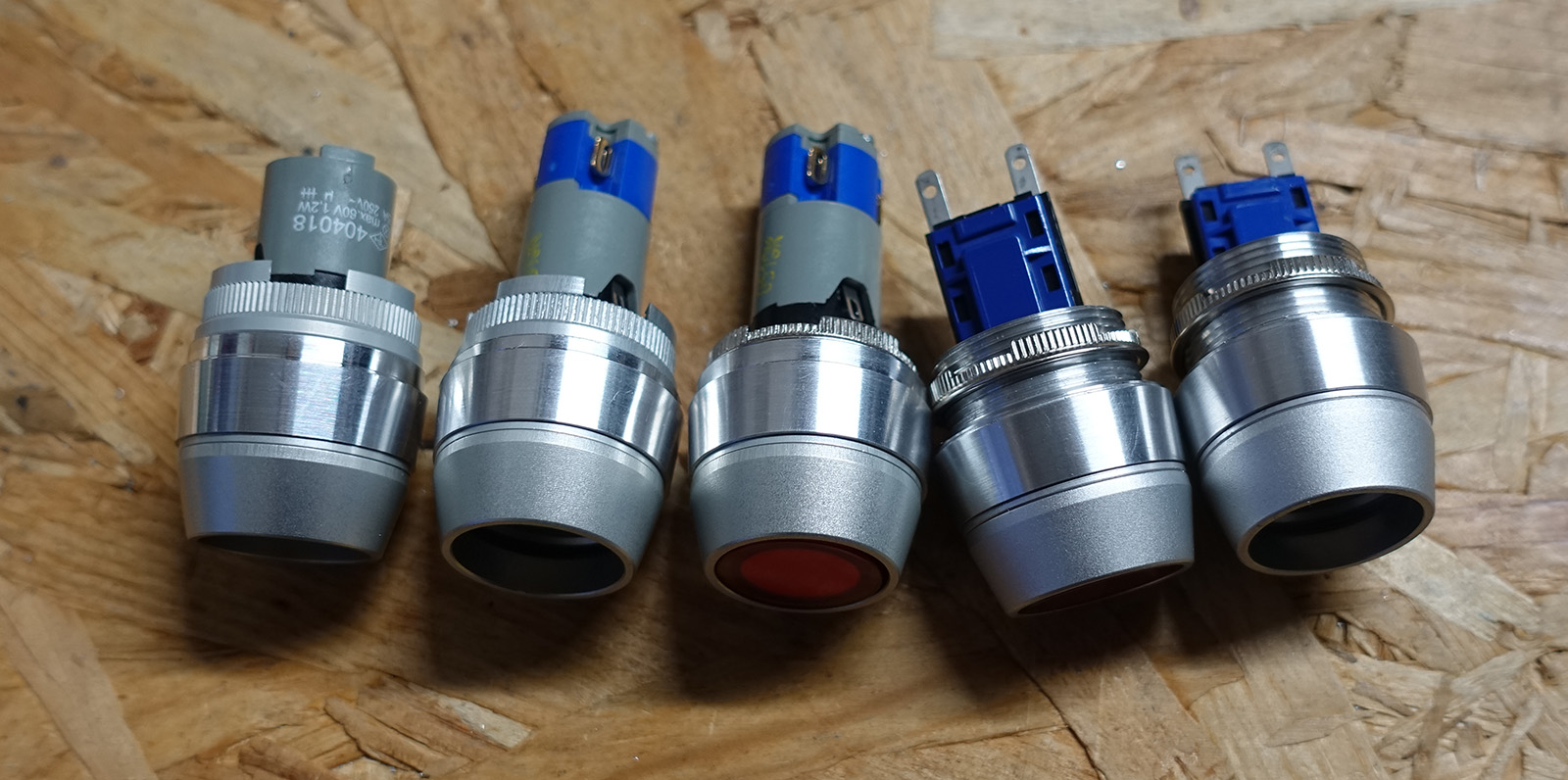

the red buttons I have, 3 on the left are RS components, the one on the far left has the back piece removed to make it more accurate, it's just two screws to remove. the two on the right are NOS from another brand and come with a red lens already installed:

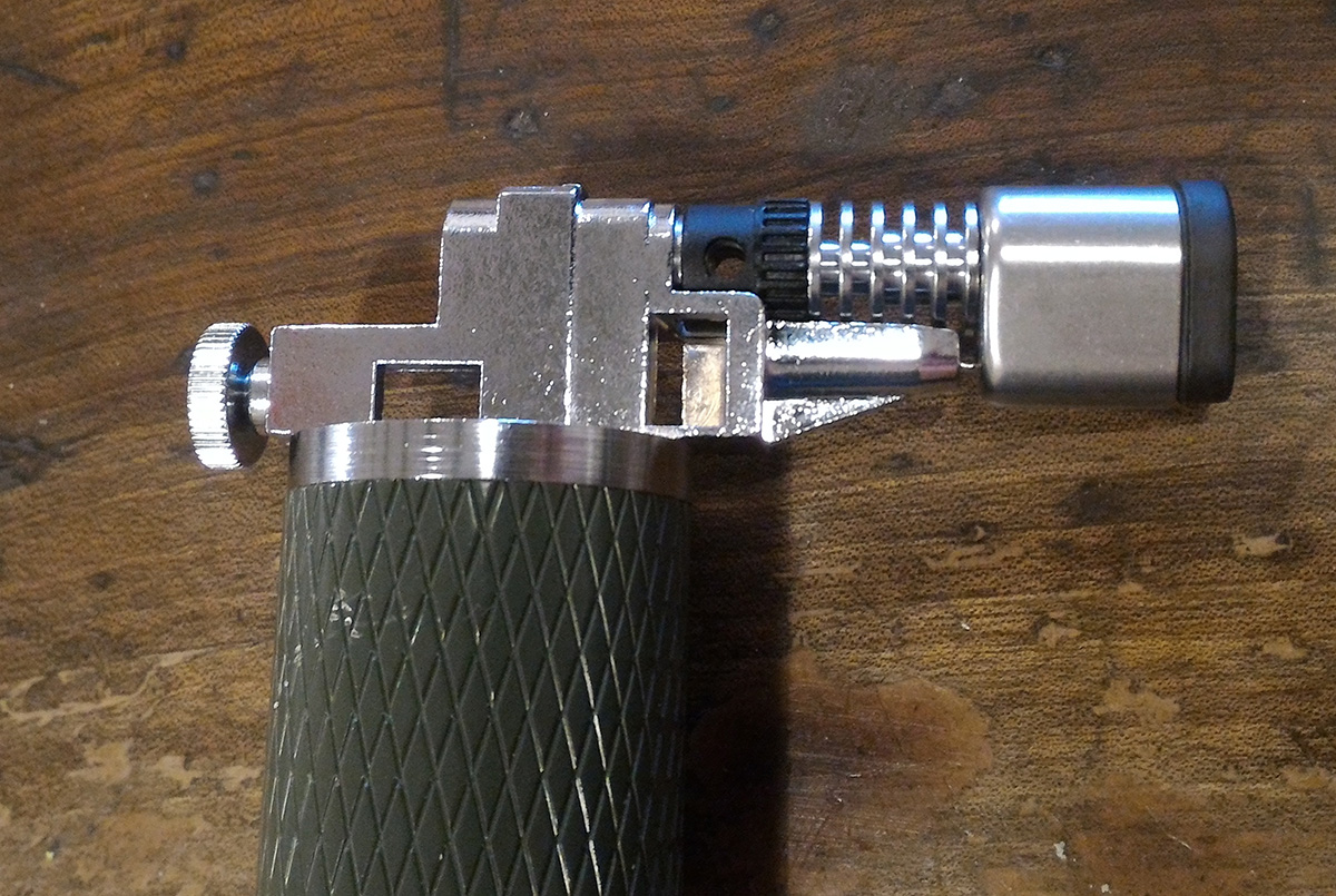

the proxxon gaz torch I'm using and can possibly provide. it is very accurate except for the black tip instead of white that most gaz torch now have, even though they can be white on the stock photos on website:

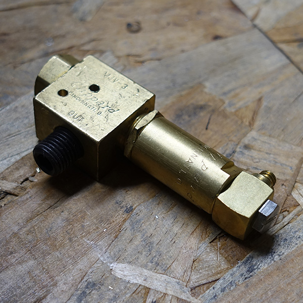

the clippard parts, with two added holes for assembly:

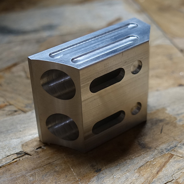

the torches holder (WIP, still need the large front face to be cleaned by a new tool):

After some carefull measurements, I was able to source a tap set of the proper size for the gaz torch tip. I received it today and it's the good size! so I tapped all the parts for that too. My prototype was done with a "close" enough tap that I had on hand but I couldn't do that for the run, but this was a very exotic thread size, M9 x 0.75, weird stuff. No photos for all that, sorry.

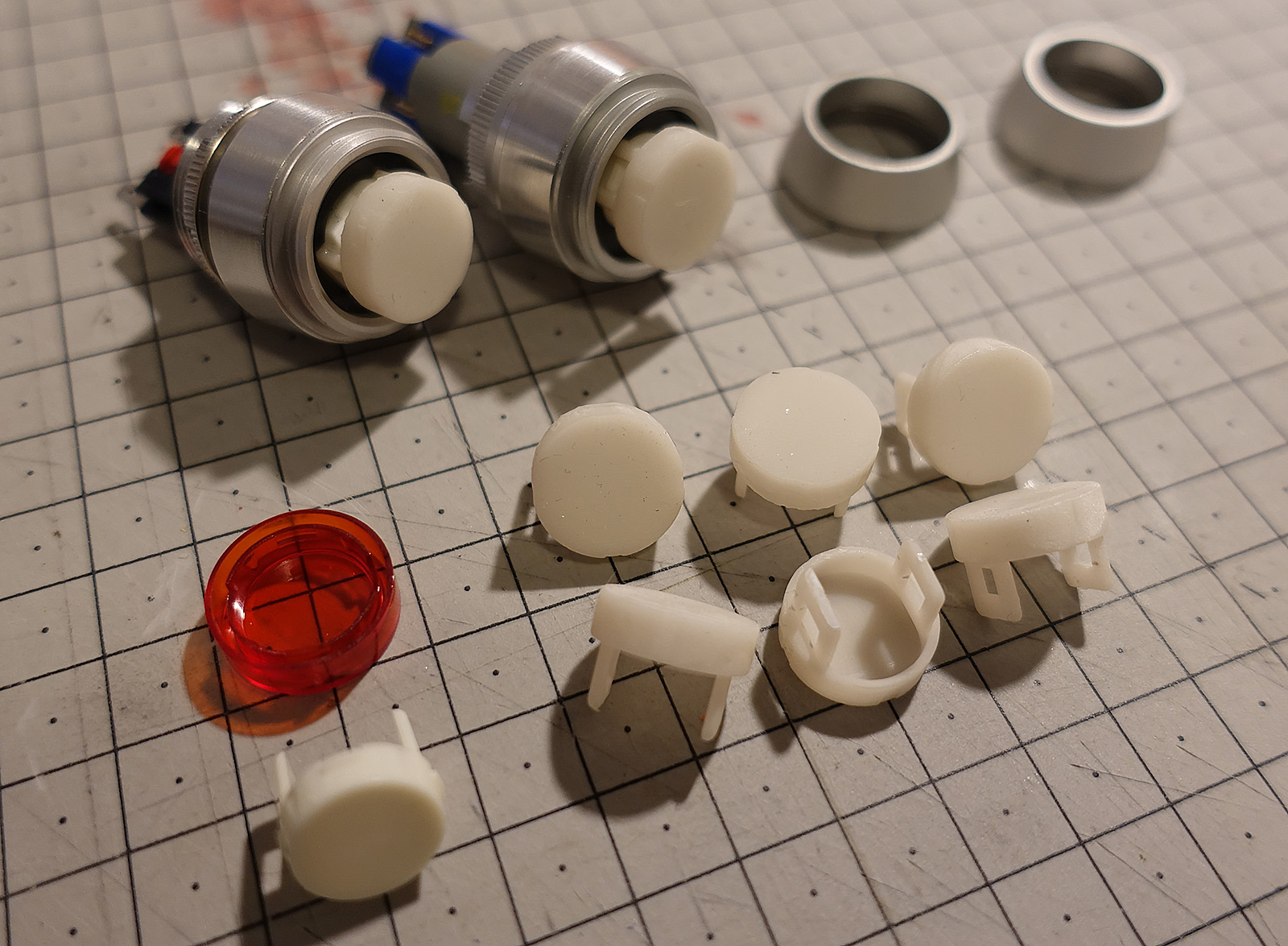

finally, I printed the white support part that go into the real red buttons to hold the red lenses, "just" need to print the red lenses now. The red lens and white support on the left are real parts, they are from the other, non RS brand. but the white part is a bit small to be completely accurate, so my model is based on the same principle, but larger :)

When I look up "Clippard MPA-3" I get options for inlet sizes and thread. Which ones are correct?
hey,
I think the MPA-3 has just one size, the MPA-3P is different, that's what I can find on their website.
In any case, they both have the same 15/32-32 thd thread on the large opening side that will thread directly to the MJV-3 block. but on the other side, and that must be the "inlet", we need the 10-32 threads, that is the screws that I bought and will provide in the kit.
I hope this helps :)
Ah, that makes more sense. Some said 10-32 and others said 15-32-32. So they're the same, just some people are listing the thread on one side, and others list the thread on the other end.
