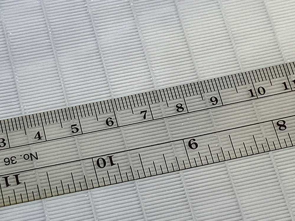

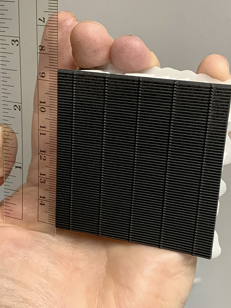

With a studio scale TIE model on the back burner I decided to start preparing for that eventual build and make my own 3D-modeled and printed Koolshade.
First a bit of modeling in modo with reference to original Koolshade specs and digital caliper measurements from some original material:

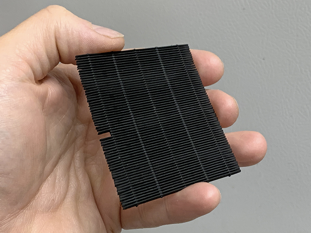

Then off to my new Photon Mono X resin printer with a small section to test how it prints:
Not too bad. Of course, this had to be backed by a mm thin base in order to successfully print, but even with real Koolshade TIE wings have an internal base layer anyway so I figure this will pass as good enough. I'll get a couple full sections of the appropriate dimensions printed up and then I'll try a test mold and cast...
Dan
This is great! Would you ever sell or make available the digital files? Modo is fine, that's my weapon of choice too :)

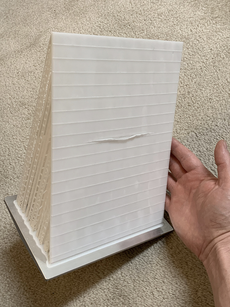

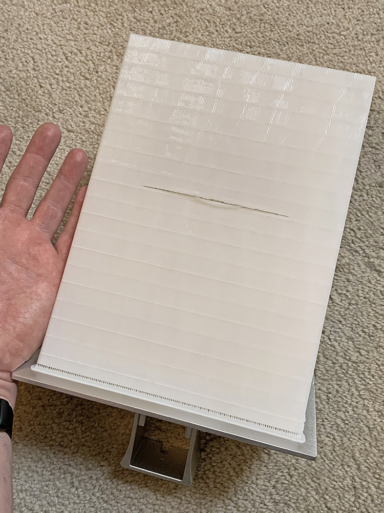

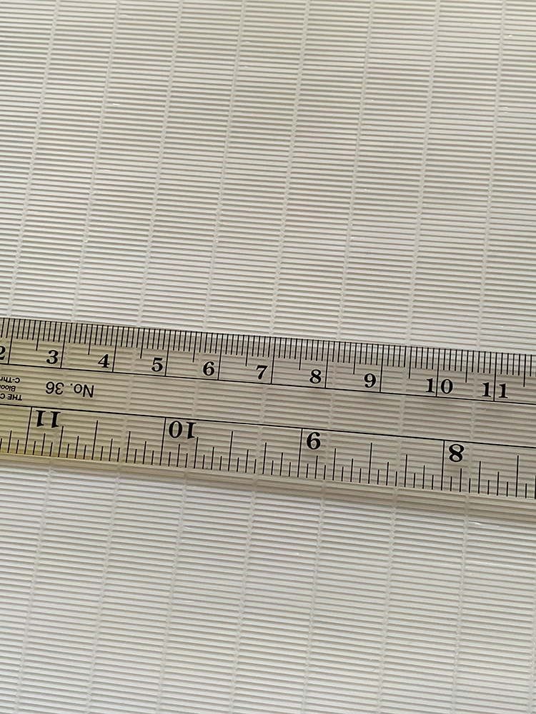

I promised progress reports, both good and bad. This one is both good and bad.
Good: first full print of an 18x24 cm section of the necessary size to fit the TIE wing stars is done. Beautiful stuff!
Bad: the print developed a tear right about half way into the process.
While it was printing I was thinking that maybe I could 'tuck' it back in after washing but before UV curing, while the resin is still a bit soft. But unfortunately that's just not possible in this case. One alternative to printing the whole thing again might be to splice in a narrow cm-wide patch in that area and try to blend it in with a careful glue job, but I suspect that'd actually be harder than it sounds to achieve a good seamless fix. So I'm afraid it's looking like I'm off to another 28 hours of printing with perhaps some adjustments to the mesh and/or supports and bracing (I'm not sure of the origin of the flaw)...

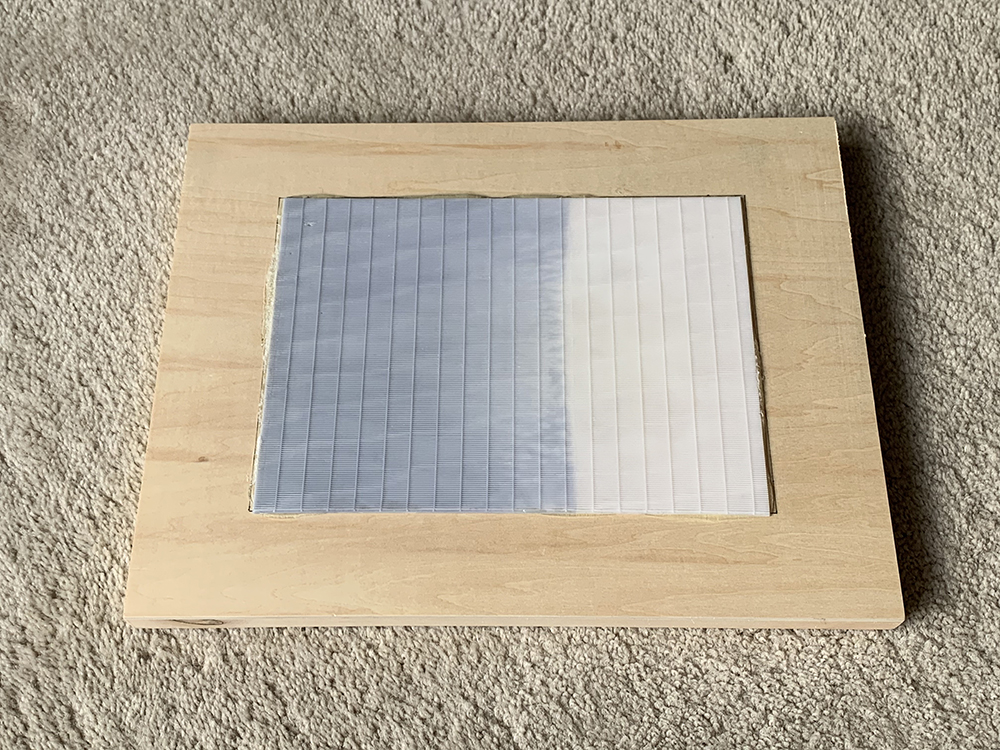

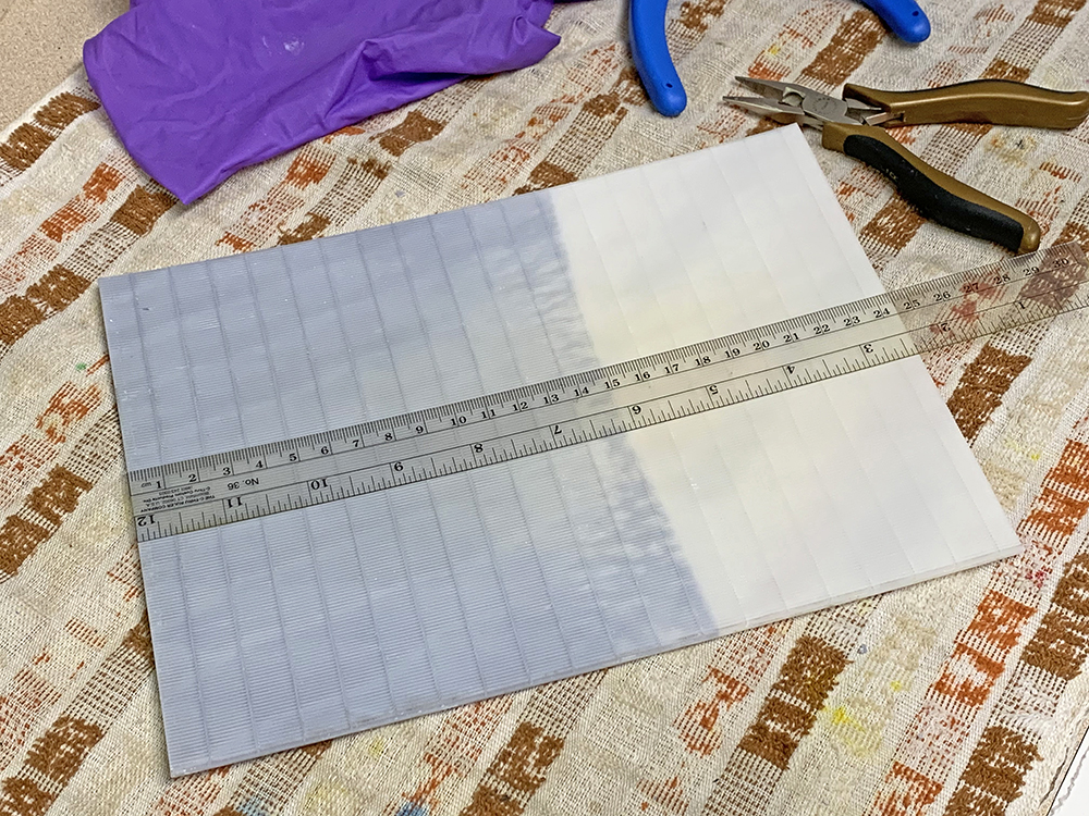

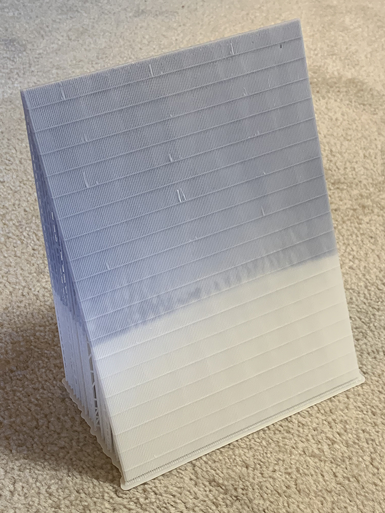

Another update, all good this time.
While re-printing the file in order to make the section to splice to the previous print to make the full-size mold master I saw that it had progressed past the point where the mesh tore the last time. So, I just let it continue printing just in case...
Yay! It all printed flawlessly this time - one continuous 18x24 cm piece (I ran low on white resin about half way into the print and had to add gray resin, hence the color shift). So this piece when affixed flat to the splitter board will be my mold master.
The original test print of a smaller section looks convincing enough for TIE wing material:

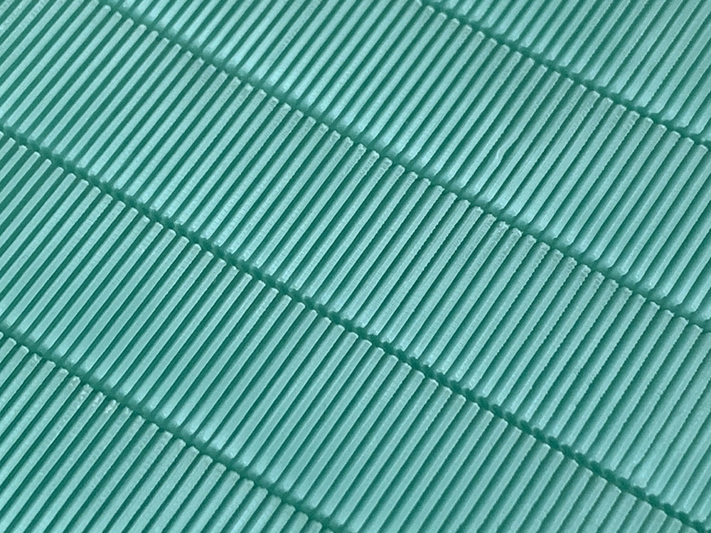

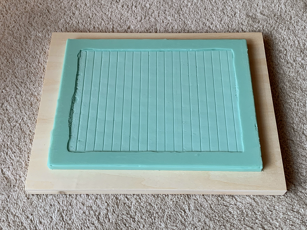

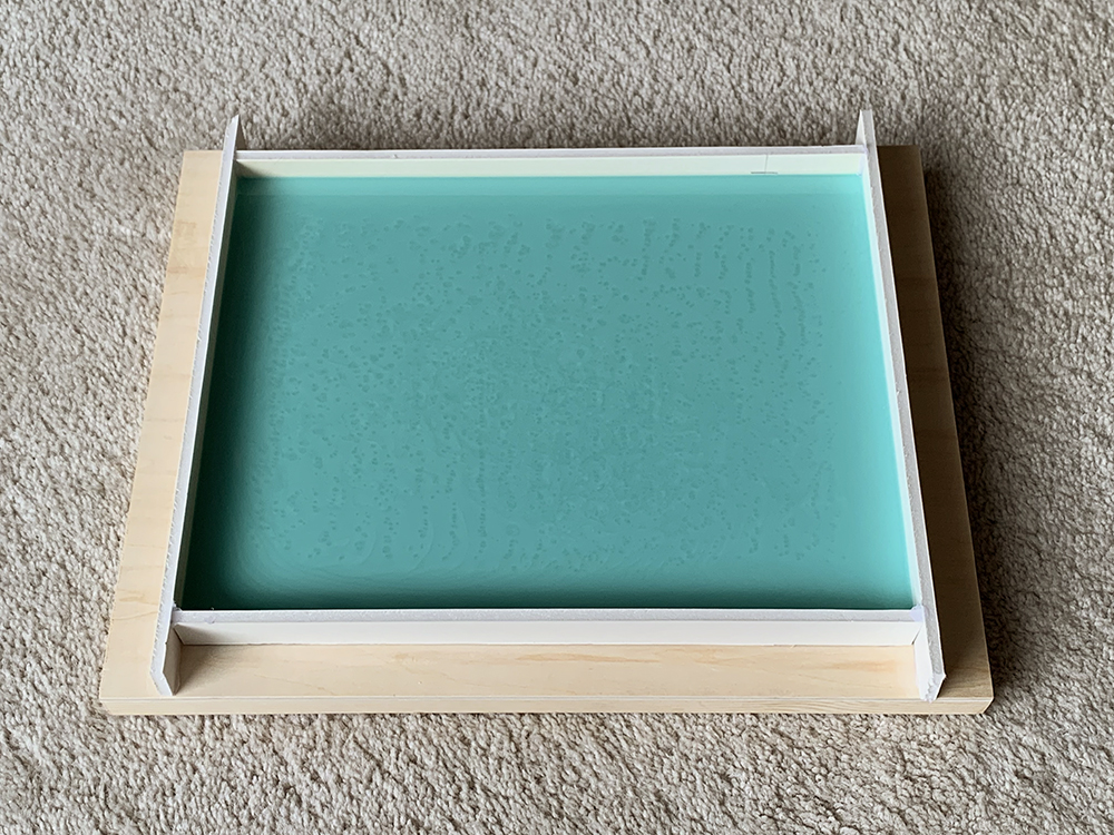

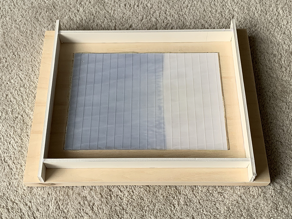

A bit more progress...
This is a nice mold - everything peeled from the master very cleanly (it looks rougher in that fourth image than in person for some reason). I think it'll make nice casts. I'll make the first test cast next week...

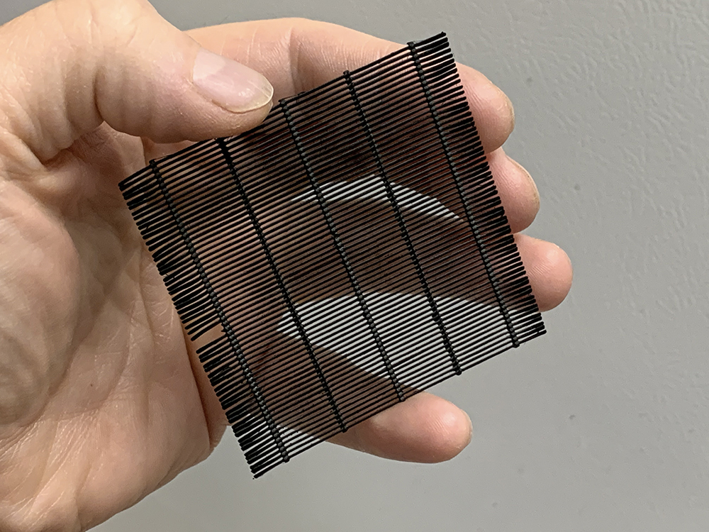

There are parts(anatomy) of Kool Shade that I don't have enough information on to really know how it all fits and goes together. I have a 1"x1" square piece of the original Kool Shade and it's really not enough for me to get a complete picture of how everything fits together.I think the slats photo etched is easy enough and straight forward enough and I think a jig can be made by a good machinist and then a softer version cast from the machined jig that would be gentler than one machine in aluminum. It would be photo etched out of extremely thin
brass .005 to .010 or less? I'm not sure how thin the material is? The nice part about sheets of it being photo etched is you can make them any size really by the size of the jig, but I think the brass could be anodized black like the original Kool Shade rather than trying to rely on matching it with the right sheen of black paint.
