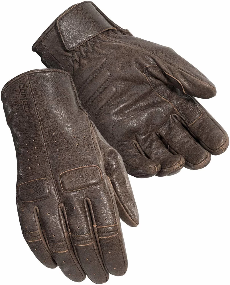

The Gloves
the.rebel.agent has already identified the gloves as Cortech Heckler gloves (STAR WARS - Skeleton Crew props & costume)
Sadly they seem to be no longer available anywhere, couldn't find them on ebay/amazon/etsy/other sites, even none on any smaller motorcycle clothing seller sites. However, I managed to find a company that manufactures apparal, among them motorbike gloves, and placed an order for a couple of pieces. Hopefully this works out well, I should know in 2-3 weeks
I’m definitely interested in a pair as well, I wear XL or even XXL gloves, I always have a hard time finding ones that fit….
