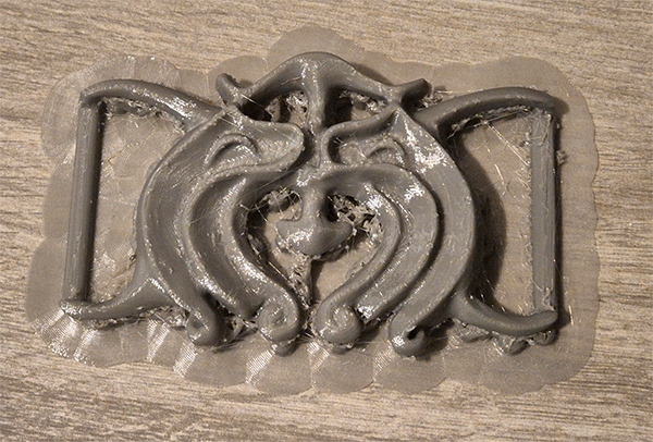

Is making a support block worth it? First you need to make it. I spent about 7 minutes in 123Design making my “winged” version. To make the simple block I talk about below it was simpler and only took about four minutes to model and slice.
I just did a quick slice of the presented .stl of the buckle using Prusa Slic3r since I have Prusa printers. I set the paraments for 100% infill and auto generated supports and all other paraments left at their default settings. The entire project with supports is reported to require; 5 hours 4 minutes of print time. 15.2 m of 1.75mm filament (45.33 g). The resources required to print the supports are; 1 hour 19 minutes, 3.92 m of 1.75 filament (11.69 g). So roughly 25% of the resources go to just producing the supports.
I also sliced a simple block 100 mm x 75 mm x 6 mm which is approximately the support block requirements. There are no supports and I set the parameters at 15% infill and all other default parameters. This project requires 1 hour 58 minutes, 9.28 m of 1.75 mm filament (24.72 g). This is more time and material than is used for supports in a single buckle print. (Parameters could be tuned to reduce time and material by reducing the number of top and bottom layers, wall thickness. etc. but all that just put my costs somewhere else other than the print. If I was doing this for production it might be worth the effort.
So if you are only going to print one buckle, making a support block is more expensive in time, material and effort. However after the initial investment of making the block, each additional buckle will save about 25% of the time and materials than if you printed each additional buckle with supports and without a support block.
Since there is a pause in the middle of the print and there are some manual efforts required, this approach trades human time for filament. Also if the printer is sitting idle because the operator was not ready for block insertion, the total project time increases. If machine idle time needs to be taken into account then a whole new business analysis would be necessary - but I don't do that anymore. Obviously this is a quick and dirty
analysis.
EDIT: I changed a few of parameters I mentioned above and reduced the support block print time to 65 minutes and some reduction in material. However I do not know if this block would provide the same confidence level I would have in the original beefier block.

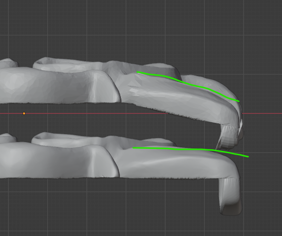

What do you think about making the 4 edges point down some more, so that they are not as aligned with the back of the buckle but rather are a bit more curved? Something like this:
Top: One of the edges is pointing downwards in a quick & rough edit.
Bottom: original position

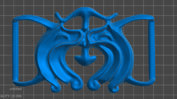

I was waiting for confirmation on this one as I had started a new build in another program, yesterday, that had a better pipe feature but had some issues with relearning all the commands again in such a short time period. I saw your post with the solo belt and immediately noticed it is sitting too high at the corners only to the scroll down to seeing you noticed it as well. It seems the art nouveau styling that joberg had pointed out shows strongly in this graceful looping around the belt. It reminds me of the mobius "block" version of the famous structual "impossibility". Which, of course, I had to make by hand after a challenge from my sculpting teacher in junior high. Three edges that wrap to give the impression of four.
For purposes of conversation, I am calling the buckle by its postion when Jod is standing. The "upper" being towards Jods head. The lower, towards his feet. The face, what is seen while it is worn and the back what is facing toward Jod.
(update after the below was written)
The upper loops seem to have 3 sides as they connect to the central mass. The bottom two loops seem to expose three faces as well, not perfectly flat but distinctly separated by an edge angle of more than 90 between each face. The back one is easy to read its path with the back face turning to face into the center across jod's waist in the direction the belt runs, the upper face becoming the face that holds contact with the belt (wrapping around the belt edge) and continuing after its corner facing away from the body ( if there were no belt in it, I would expect to see the flat face of what had been the upper face.) The lower face of the lower loops would then be facing partly toward jod but at an angle pointing to the hip bone edge.
The upper loop had been changed from 3 to 4 because I was hoping to find a way to make it completely flat.
The down side to making it correctly is that it will no longer have the option of printing the back bars separately. So maybe keeping the file with this bar but making the end swoop down to a near disappearing edge for this version and then a true screen orobable version where it just rolls gracefully around and underneath.
This picture:
I see the 3 obvious faces where the loops attach, one up vertical, one down vertical and one facing the body.
WHAT IF..... the back face dissolves into 2???
So, an eliptoid tube for most of the path from say here to here:
Or is it three faces where the back stays the back even when under the belt
My pudding brain is really wanting this to turn into a band like this:

After our discussion above, it does show the belt is being pushed ABOVE the plane of the buckle's flat back and it gave me some indication that, although curved, the back (including all final loop ends) may be on the same plane, or very close. Meaning, we may pull this off with very little support material during printing.
As a resin cast or even a 3d print, the resulting buckle can be curved afterward with heat.
I admit that I am being overly hopeful that a flatback version can be created but I also see the weakness in going so thin at the edges. I will be perfectly happy with a combination/compromise if we can get the differences (to onscreen) to hide in the back and not show during posing.

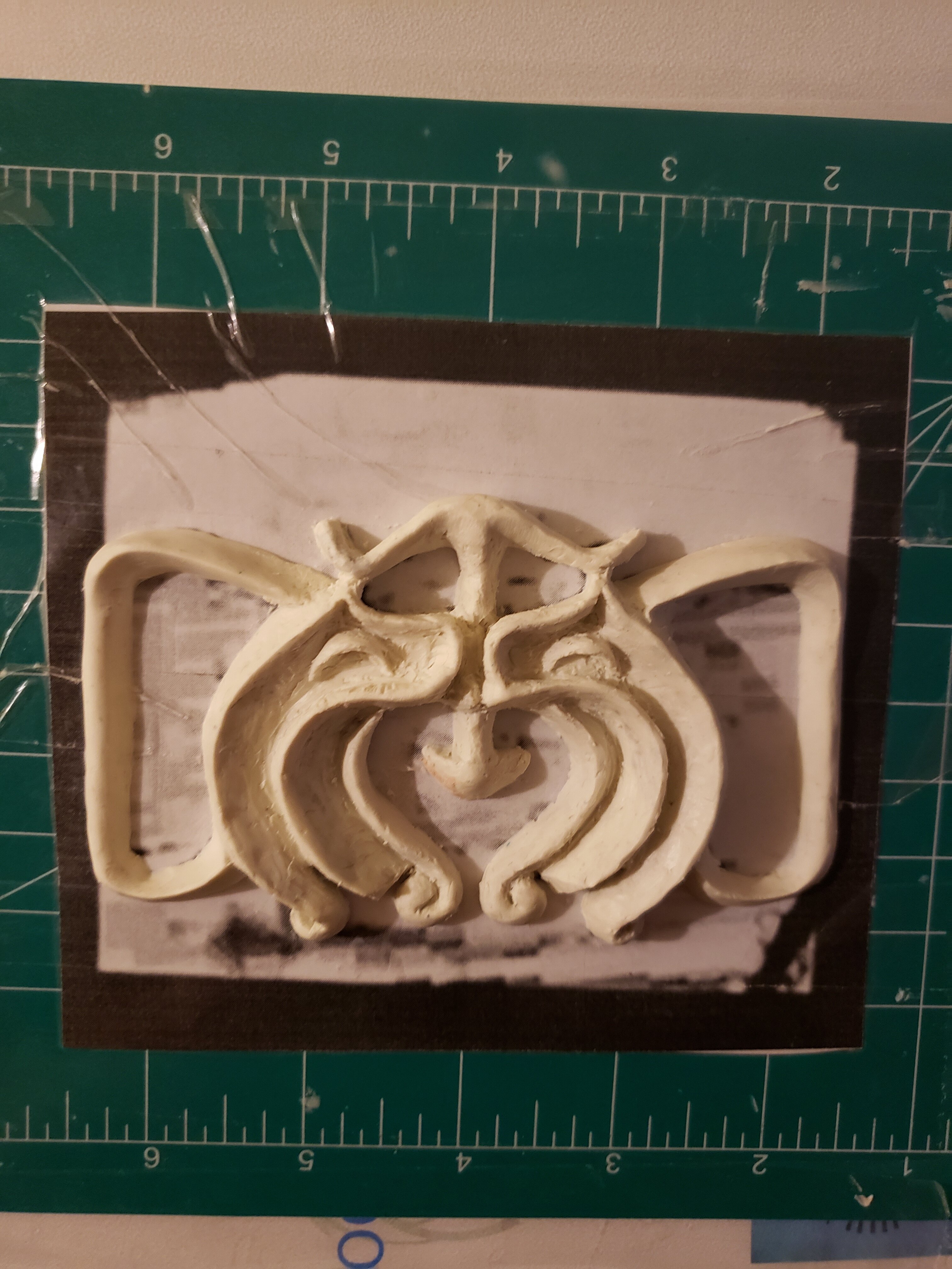

Here is the last clay version prior to rescan:
Modery is doing further tweaking as this newest scan takes us backwards a few steps in cleanup, reintroducing a lot of the stuff already cleaned before. The main point of contention is going to be keeping (or even achieving) the on screen front view match, while giving these loops some strength. While needing to bulge the actual belt forward, we are imposing strain on the end loops that is not there with the step back design. We may find this is possible in metal but not in print. I have been thinking on possible ways to strengthen prints.

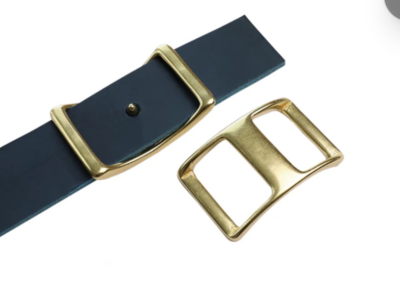

View attachment 1900969maybe it could be epoxied on top of a brass buckle like this. I never saw this sort of buckle until i read this thread. Star wars buckles have fascinated me ever since I bought tge kenner version if snaggletooth. Buckle found on.l Conway Strap Buckles (Solid Brass)
This is a great idea, even if I use it on a different project. I love this. Strong, permanent addition to any decorative buckle. This one piece would make many of the pirate accessories possible, like the weight bearing accessories that are belt attached.

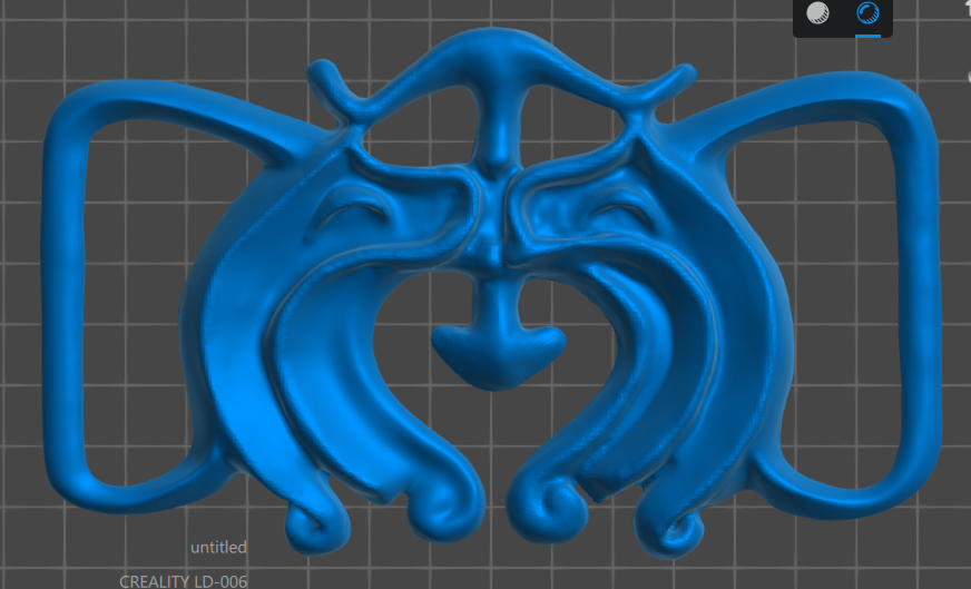

Uploading two files today. Both may yet get updates as Modery is still print testing and adding last look touches.
A big shout out to Jintosh as both of today's files had been over processed and over sculpted to the point that nothing I did would fix them. It is funny that when I was learning the scanning process, jintosh saved us so our file could be used for sculpting. Now that I was finally competent enough to use the software, and of course I mean we, several times handing this off to Modery when I was beyond frustrated, jintosh saved me again. The entire time I spent sculpting the face of these buckles, the software was working in the basement (imagine Isengard orcs) to destroy the underside. The underside that we have all assumed is completely smooth. Well it is again, completely smooth..... thank you.
One is the recessed loops version that we believe is the closest to screen accurate. In several side view photos, it can be seen where the smooth slope stops and it jogs back by about a quarter inch and then goes straight down.
This type of print will require supports so be aware if you are new to printing non flat bottom objects (I am a newb, so trust me on this ;) ). The second one is completely printable as a one pass, one shot, wonder print with no support material necessary (obvious print type exceptions to this). This one was created, on purpose, for cosplay builds where 3d printing is available to you but you aren't specializing in it. This one comes with an upgrade but I will not be uploading the upgrade until later next week after it is tested. This consists of two mirrored backing bars to strengthen the loop ends, designed and being tested by Modery , as he has done a very thorough set of tests on this flat version and it puts a great deal more torque where the belt passes through. The end result being, some materials from 3d printers are not flexible enough to pull this off even if you were just doing a one day costume. These bars are then epoxy glued to the back to form a much stronger loop end. Other methods are possible and we can discuss those as well but this one allows for the same no support printing.
Both of these prints, after cleanup and polishing, would then allow you to recast into your preferred mold method, even lost wax brass for some awesome person who would be my hero for doing so. Aluminum would be stunning as well and closer to his finished buckle with an anodized surface or the right textured paints.
The intended leather belt is the 1.75 inch wide commercial versions but is scalable when in the printing software so can be upsized or downsized to your body proportions (the ultimate goal for a cosplay piece). That part makes me smile. Please see link above (post 72, immediately above) for link to the full Jod build and belt conversation. Also some talk of the belt is in the Skeleton Crew props thread, also above.
My goal of course is print the receded loop version and clean it up enough to do the metal paints and stains as a one print and done version but I am OCD enough to fall into the lost wax brass process or the "king of random"'s aluminum arc forge chamber process once it is in my hands.

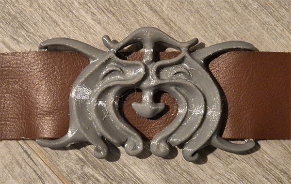

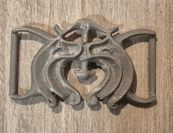

Smaller update to see the current version in action:
As mentioned I printed it at 95%. A 1.75in belt (4.445cm) should fit nicely in there, to be confirmed in the next few days (belts might arrive Monday or Tuesday).
Printed at 0.2mm layer height with 999 walls (so that it's walls only, no infill). Supports at the back and a brim that I forgot to remove.
Support material removed
Used a PU leather (or something like that, some cheap material I had) with a height of around 4.2+cm (think around 1.66in) to do a first verification:
Might have reduced the size slightly still, but waiting for the actual belts to verify.
Also did a small stress-test to see how strong the loops are. While you can definitely break them with force, they were stable enough to not break when I applied a "decent amount of force" - basically what I thought would be the maximum when worn with a belt.
I'll keep this as it is for now until the belts are here for final tests. In the meantime, I'll also print the flat version to see if there's any other feedback for that version
