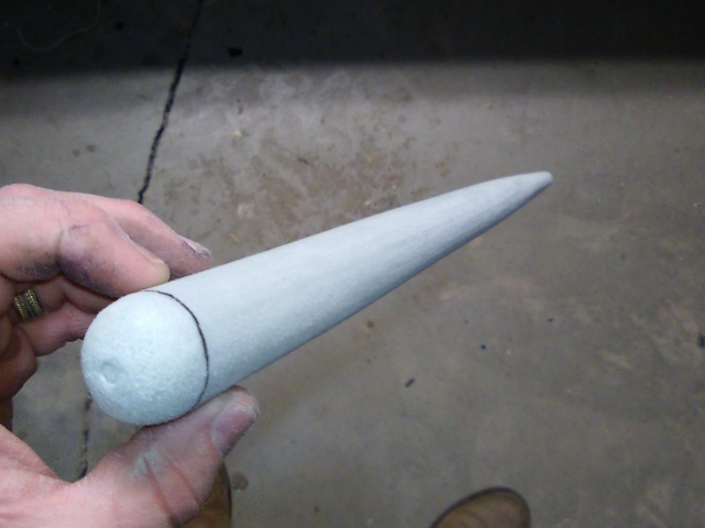

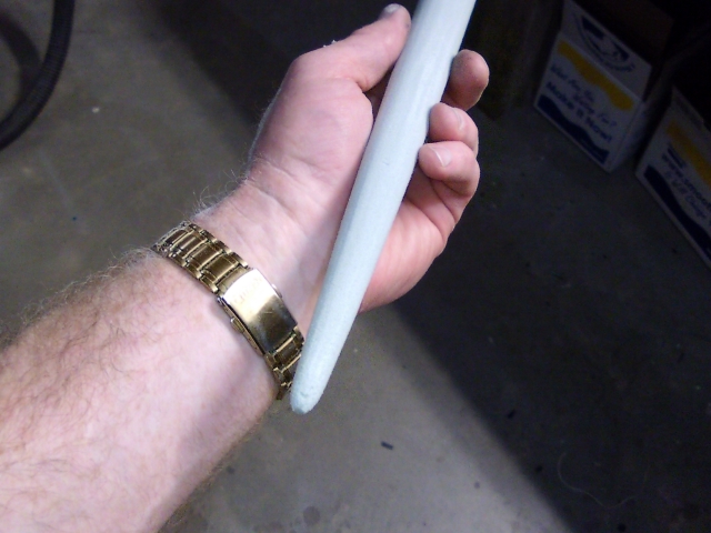

Just another quick video of my progress lately. I have changed the ratio from 50:100 to 35:100 A:B which produces a softer foam. Then I have started experimenting more with back pressure and as a result I am getting a better skin on the dreads and they are not as stiff as my initial attempts. I am slowly but surely reducing the amount of the larger cord I use and find they still release very easily with a little help from my air compressor so I want to try some with just a very short piece of the larger cord in the very end and leave the smaller cord off altogether. The cord does add some degree of stiffness so as I change the ratios for a softer foam I want to then increase back pressure and get a good flexible feel so I think removing the small cord will just about do it. I will very soon be working to make some new dread plugs using my trusty rigid foam and then painting them with PVA so I can coat them with my Smooth Cast 321 resin. I will give them less taper at the top which will move the center of gravity a little lower and try to get more of the original dread shape (less taper). Once I have htem done I will make some new silicone molds with PVC pipe with the intentions of ramping up production capabilities. When I spoke with a rep at BJB he indicated something that I may also try. He said that he has had experience with the color of the foam being affected by tin cure silicone molds. That it causes the color to come out more pale or faded as a result. He suggested using a platinum cure silicone instead so I may give that a try if I can afford it. I would just prefer not to have to dip or paint the dreads with Plasti Dip if I can help it but I can't justify the pre-tinted 5 gallon minimum for the TC-266. Once I am either satified with the reuslt I am seeing and I have my processes down I may take opportunity to play with other foams but right now I need to do all I can to maximize the potentioal of the TC-266 and if I never achieve the result I am looking for then I can try other foams as well but at least I will have learned what I can do with the TC-266 before moving on if need be. Here ias the vid....

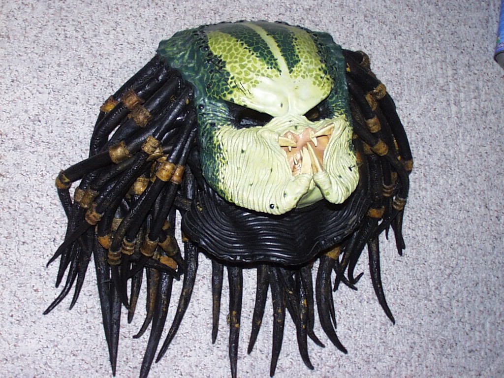

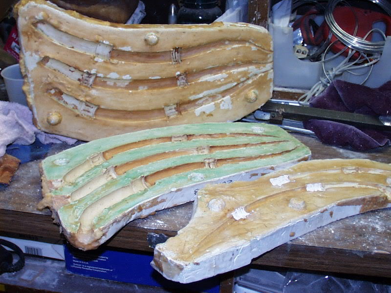

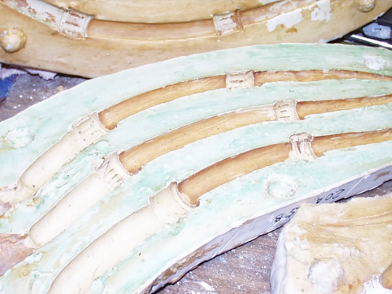

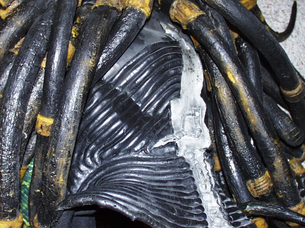

Hey Steve, I thought you might appreciate these photos. Back in the early 90's when I did my first suit I molded the dreads and beads in one piece as that was how it looked to be done in the movie. I would not do it again as it leaves no room for change and variety.
Here's the dreads 20 years later.
