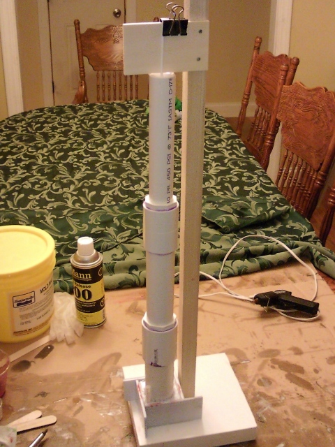

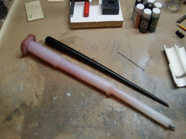

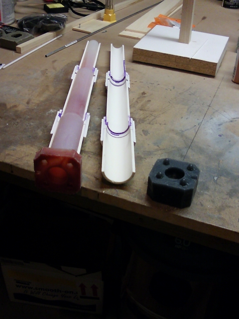

Steve, I know the Mold Max 27 T is pretty stiff, so I hope it stay straight for you without the PVC shell. I am anxious to see if it releases for you from the mold without tearing. They get pretty touchy at the skinny end. Let me know how it works.
I will consider doing a full tutorial on how I do these as well and putting it up-- When I get my CNC machine hooked upI may actually machine some aluminum or plastic molds to do the dreads in. That way It can be really controlled with a good clean shutoff and hopefully no seam lines. We will see.
