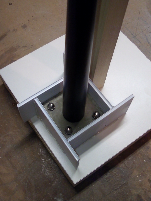

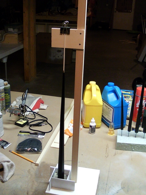

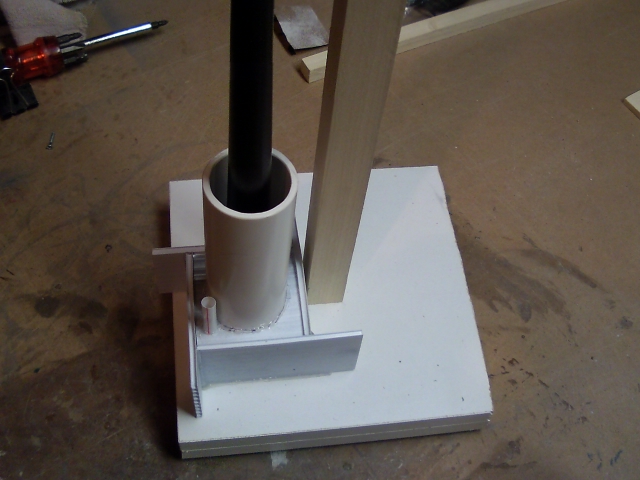

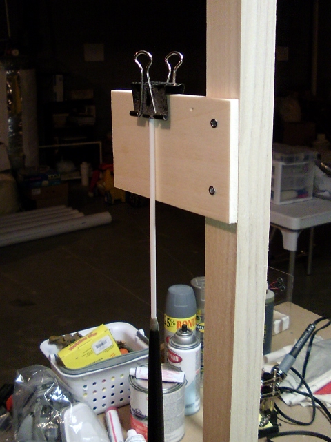

I started by making a stand or 'tree' to help facilitate both making the various length molds and eventually suspending them vertically (point downward) for the sake of pouring the foam. First up is the largest dread, if it works then I will do the others. In the end of the dread I inserted a 1/8" styrene plastic rod that will eventually allow for the paracord to pass through the silicone mold. The large end was set in about 1" thick modeling clay so the mold seam will be about 1/2" from the large rounded end of the dread plug (which should make any potential seam just about hidden when installed on a mask) and my usual plastic corrugated sign board side barriers were hot glued in place. At this point it is ready for me to apply the silicone. I hope the pics help make sense of my madness.... :D

very innovative Steve-- I like the paracord concept-- Hopefully it releases from the cleanly and without tearing on you or sticking in the mold. I havent had that luck so Im anxious to see how it goes-
Steve looks all good. I am assuming you are going to brush on the silicone? I have to say using a split pvc pipe as the mold walls/mother mold does work very well.
I hope to find out soon Clay. The paracord may help to break any vacuum created in the mold that could hinder the release and I would also have the option to squeeze the mold gently to help loosen the dread inside. The foam manufacturer recommends squeezing the foam to force gasses out of the cells and allow air back in anyway so timing of this could help get the dread out of the mold. Another option I will have is to introduce a small amount of air pressure into the mold where the paracord passes through the bottom tip to help it up and out while I am gently tugging on the top of the cord. These are all just some of the things I have been thinking about with this. In any event, I anticipate learning a lot on this one. Hopefully more good than bad.  :) I love to try new things like this though so we shall see. It is just part of the adventure and if at first you don't suceed...

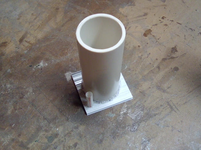

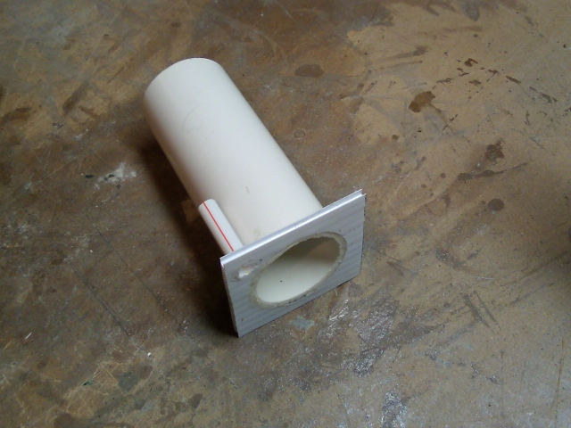

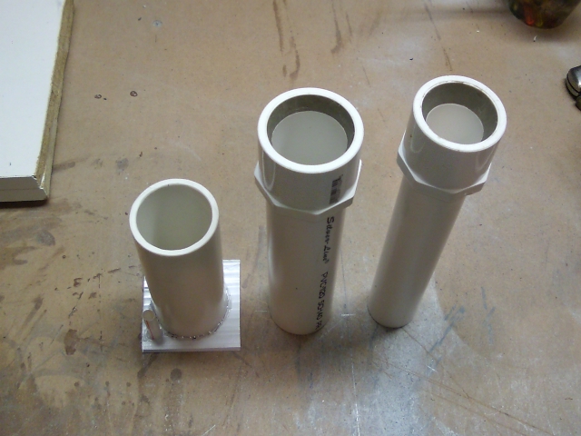

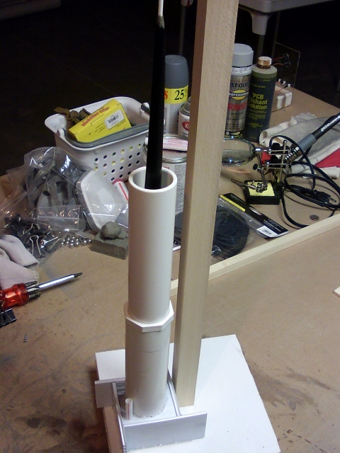

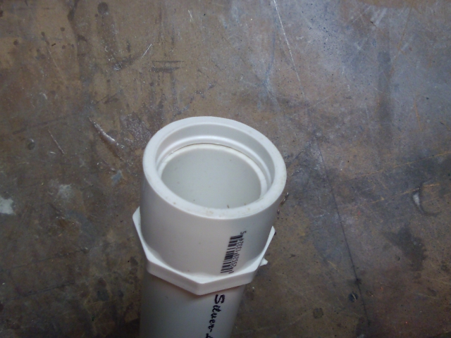

Thanks Clay. We will find out soon enough I hope. I spent a little time last night building a couple sections of PVC pipe that will give me a little stepped taper to the mold. It should reduce the amount of silicone required and keep the mold walls thin enough that I can still work with them but also be more uniform than brushing on silicone. My next step is to stipple on a thin layer of silicone and then assemble the tubes onto the plug so I can pour silicone into the cavity. That is my plan anyway.

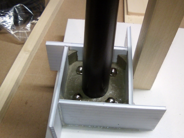

I am using 1-1/2" PVC for the bottom with a 1-1/2" to 1-1/4" reducing fitting. I am also reducing the 1-1/4" to 1" PVC. I smoothed the inside joints with a little fillet of modelling clay. On the largest bottom piece I hot glued a flange that was cut to fit inside the mold box. In the flange I also added a straw as a breather which I will plug with clay at the right time while pouring the silicone.
Inside the corners of the mold box I added some clay fillets to help support the PVC contraption.
When all put together it will look like this. I will just use a thin layer of modelling clay to seal the joints between the sections.
