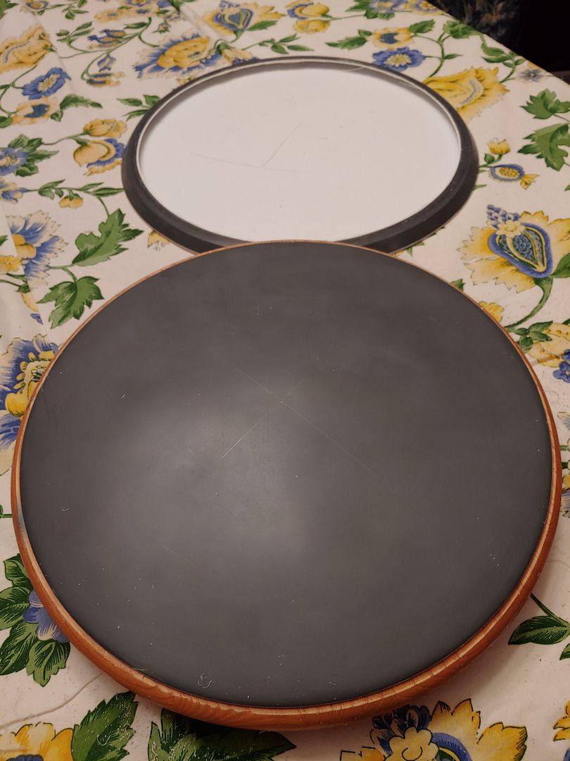

Removing the incorrect dome shape...

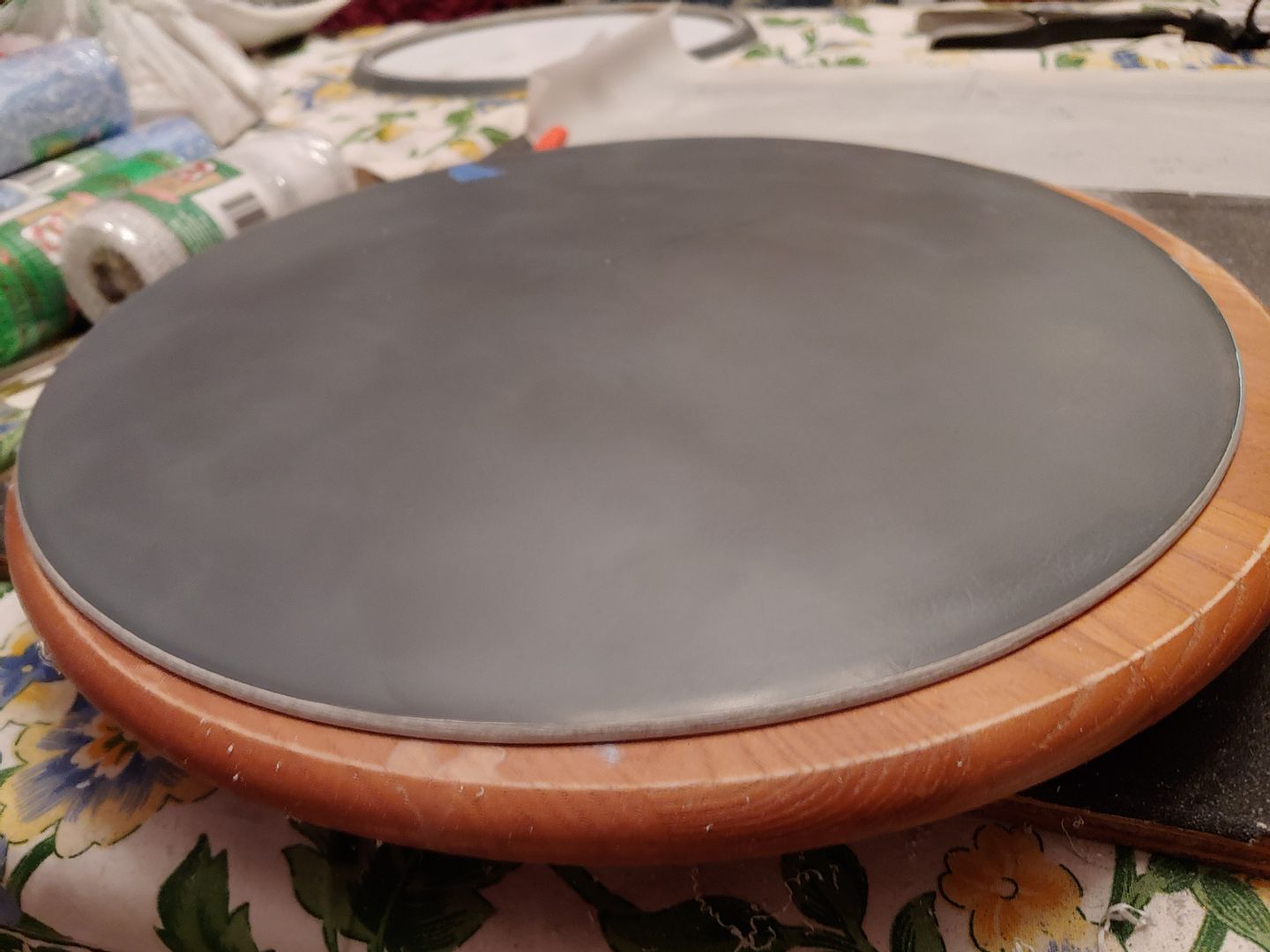

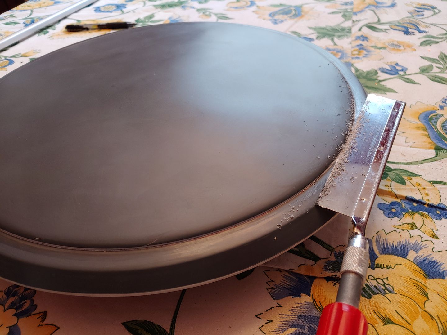

Removing the excess to reduce the dome down to the proper diameter...

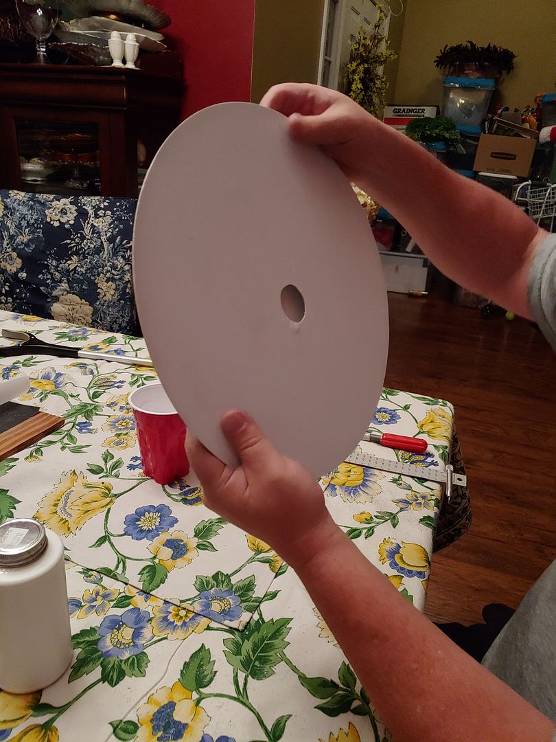

1mm sheet styrene cemented to the base of the dome to rise it back up for a proper profile...

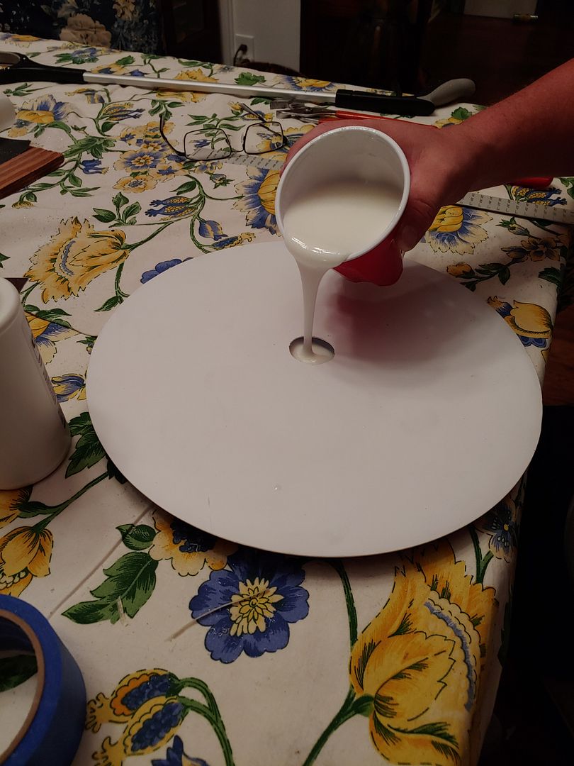

A hole is cut into the new base so resin can be poured in for support...
The resin is poured in increments, then slosh-cast to make sure it goes into all the nooks-n-crannies...

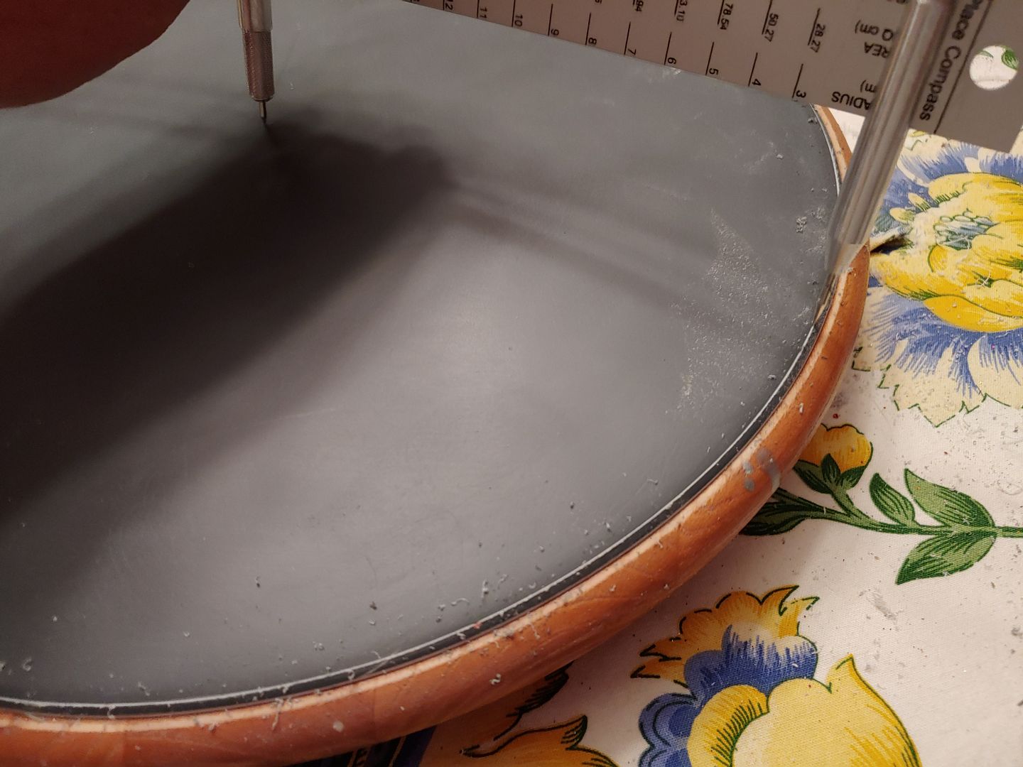

After all the resin is poured in, I taped up the hole so I could hand roto-casted it to make sure all the inner surfaces get a good layer of resin. Before the resin cooked off, I clamped the dome down to a flat surface to ensure the dome didn't warp from the heat of the curing resin inside. At the top of the last image, there is the saucer's profile traced from ILM plans scaled to my project. I will be making a screed blade from that to level out the domes surface.
