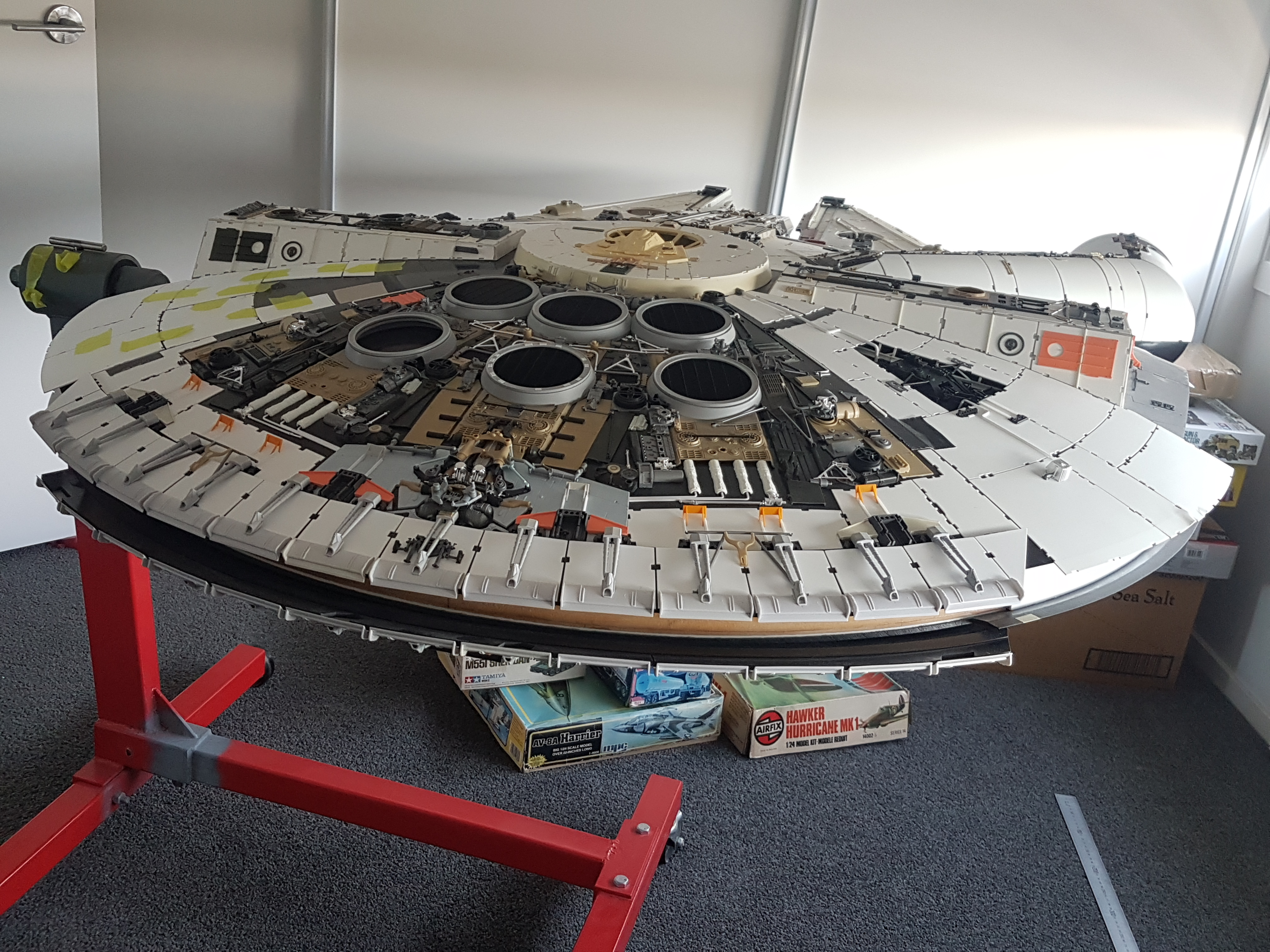

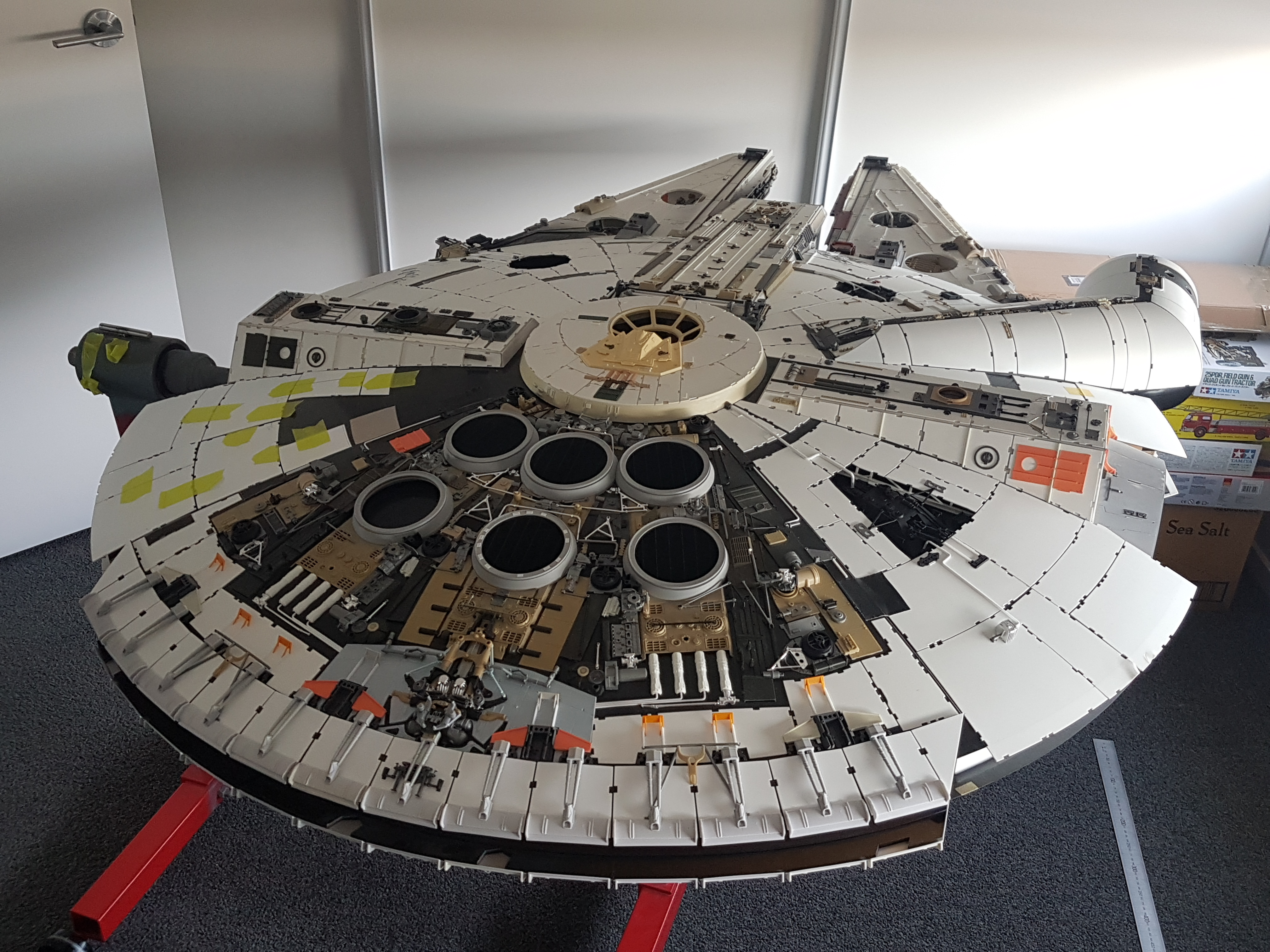

These latest pics were 'staged', but they give a good idea of the size & i do work around the ship doing things similar to these pics.
Many areas on the go at once is ny method i guess, so no boredom sets in...something always to think about & get back to it later if it gets a tad tedious.

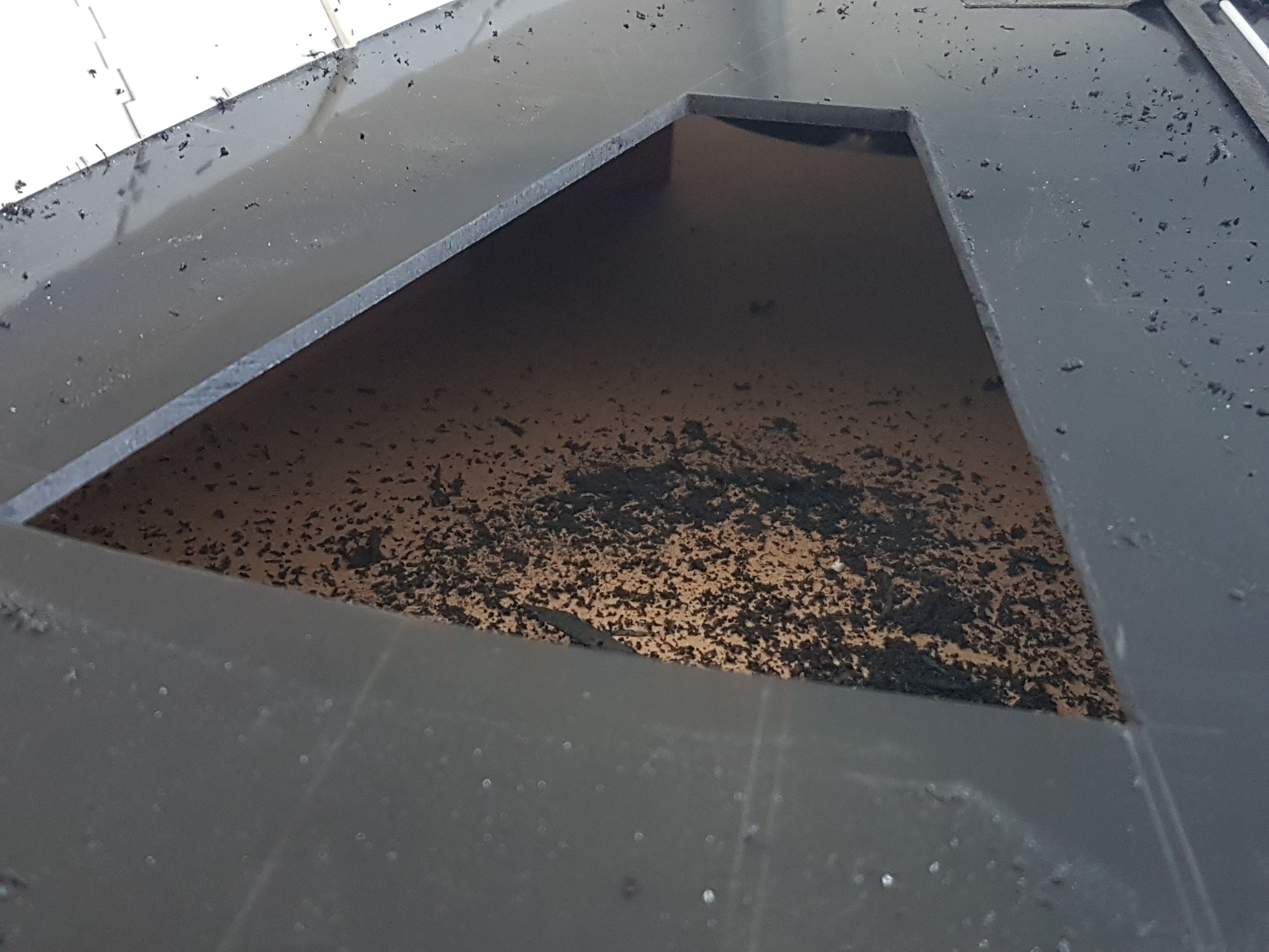

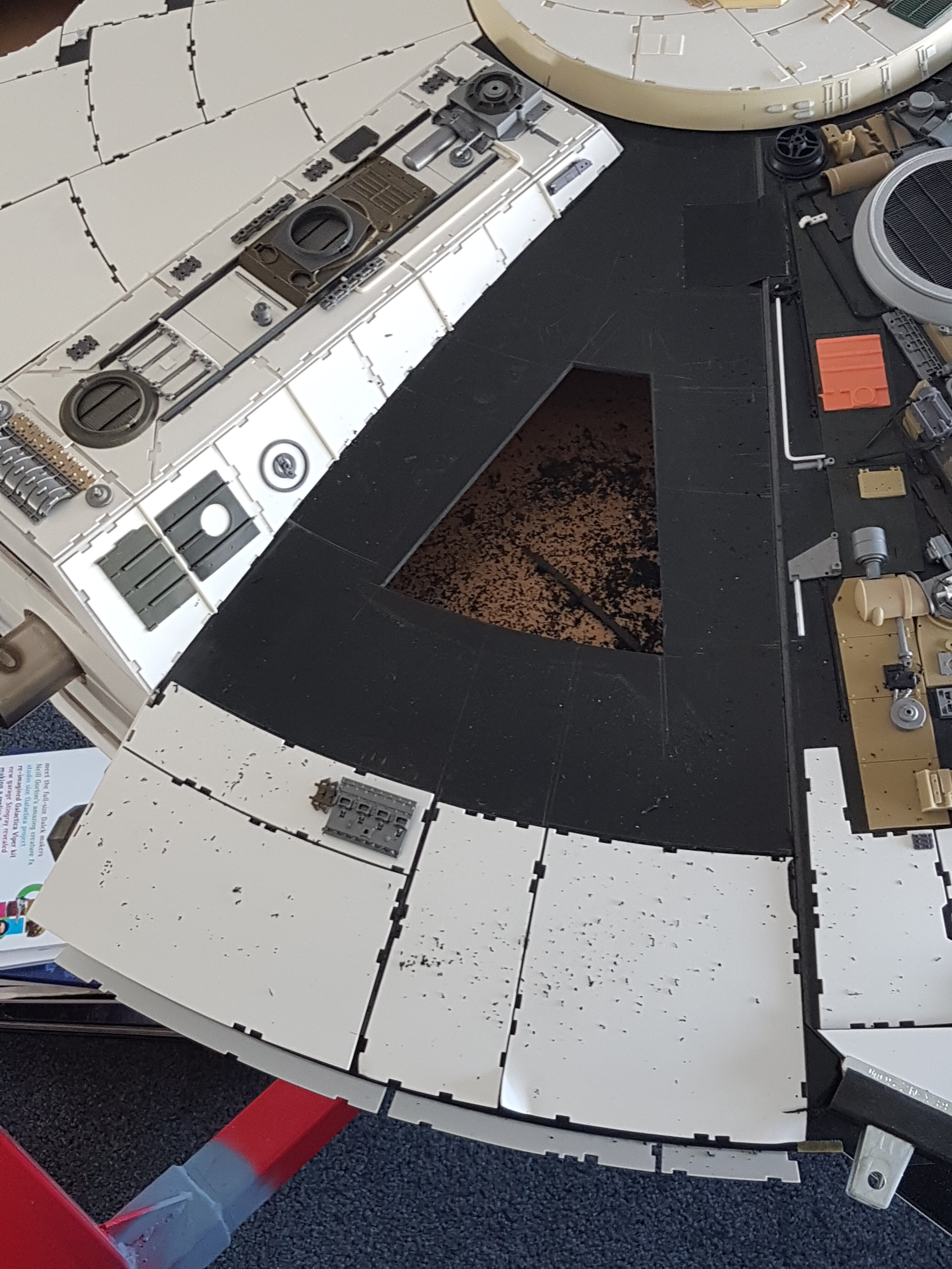

So here i am at the last pit to be cut out, well it is cut out now haha. I've been all over the place really on the model of late, working on the rear exhaust strips mainly & kind of been putting this pit off, not sure why, but back on it!. Now the cutout is done with working out the lines & styrene plates I need to make the pit 'tray' for the casting detail plate to sit in. Then add the rest of the plates & pipes & kit parts & oh yeah...all that glorious chipping!.

Wow! Those are some NICE, SMOOTH, STRAIGHT, PRECISE, FLAWLESS cuts. Would love to know the secrets to not making ANY mistakes on this kind of cut.
Thank you.
Not really any secrets, just a steady hand & confidence in my sawing ability.
I of course mark out the lines, then drill a number of holes in each corner, say 3 or 4 each way as close to the marked edge as possible & use a saw to cut. The saw i use makes short work of the ABS.
The pit cut edges don't need to be neat & clean as evidenced in ref of the actual miniature. You can see saw marks & they probably didn't bother cleaning up the corners of which aren't visible anyway, which is how mine are.
I do prefer a hand saw over a moto tool with a cut off wheel though, much more control & straight lines that need virtually no clean up i find with a hand saw.
