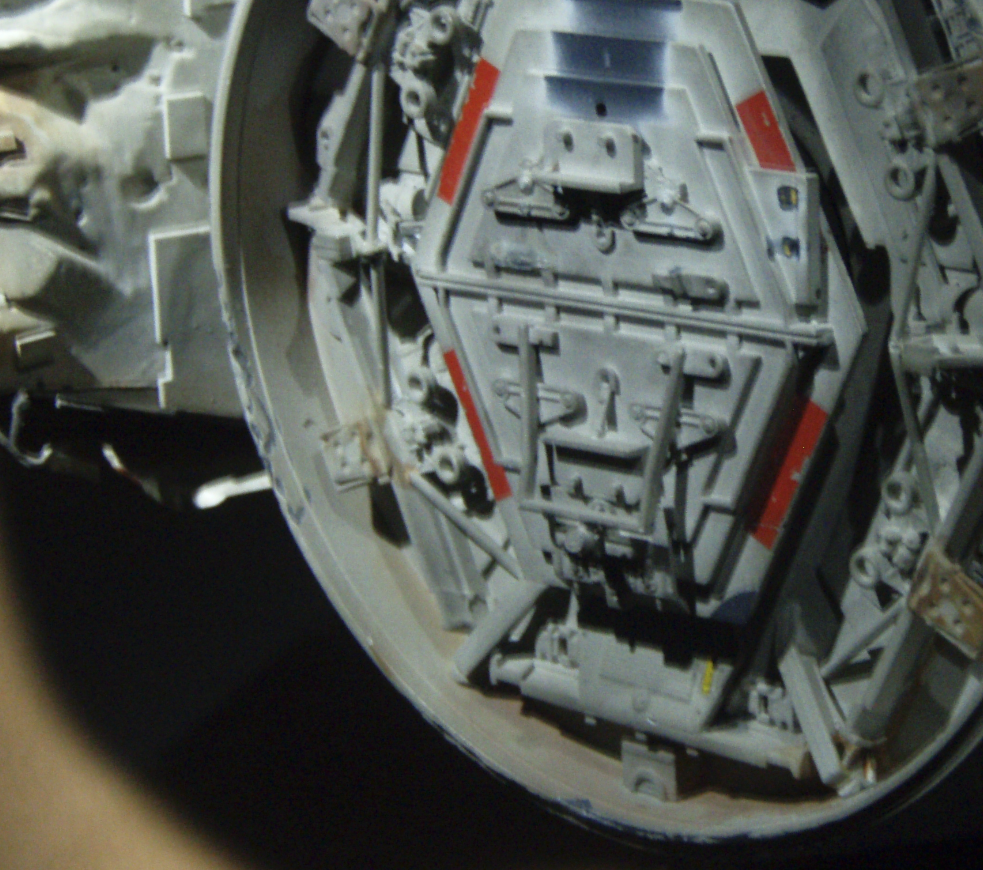

I was wondering, is the docking ring perfectly concentric, say as if it was machined, or is it slightly out of round?
And that aside, I was thinking it may have originally been the base of a paint mixing pot. It has a very slight ridge on the inside opening where the greeblies are which reminds me of the base of some plastic cups.
Maybe like say, the construction of an Escape Pod model, unless it was indeed a container of the Colonel's secret herbs and spices....I'duno?
Just spitballing here...
Reference pic showing ridge bellow.

I haven't ever found out what the original miniatures docking rings were made from. I think its turned wood...i think i possibly saw a pic or two of the inside years ago, but the mind plays tricks haha. It could possibly be a container of some sort, that inside lip is a good tell, but they could have easily added that on the lathe too!. I have that lip on my rings by the way haha.

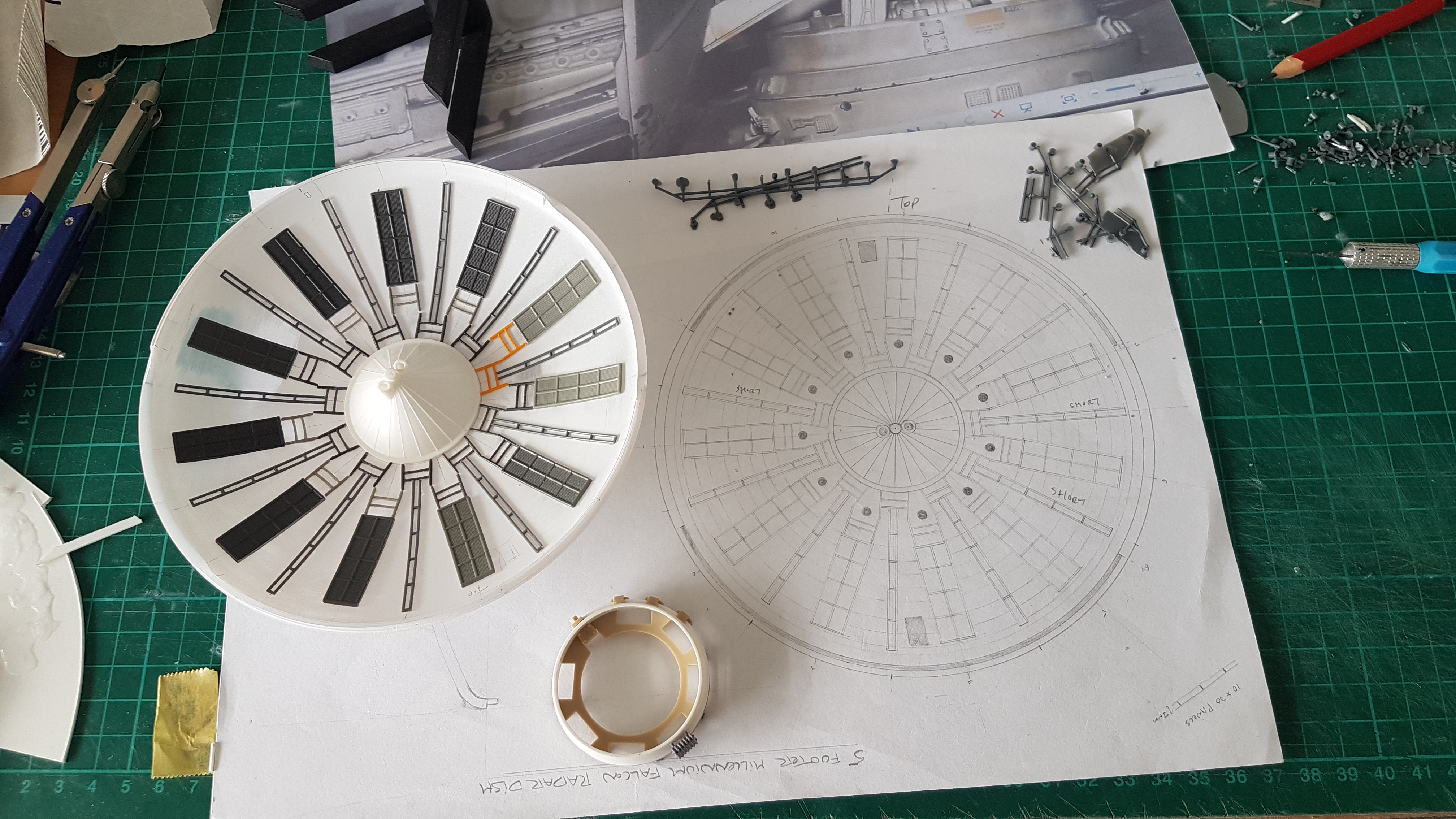

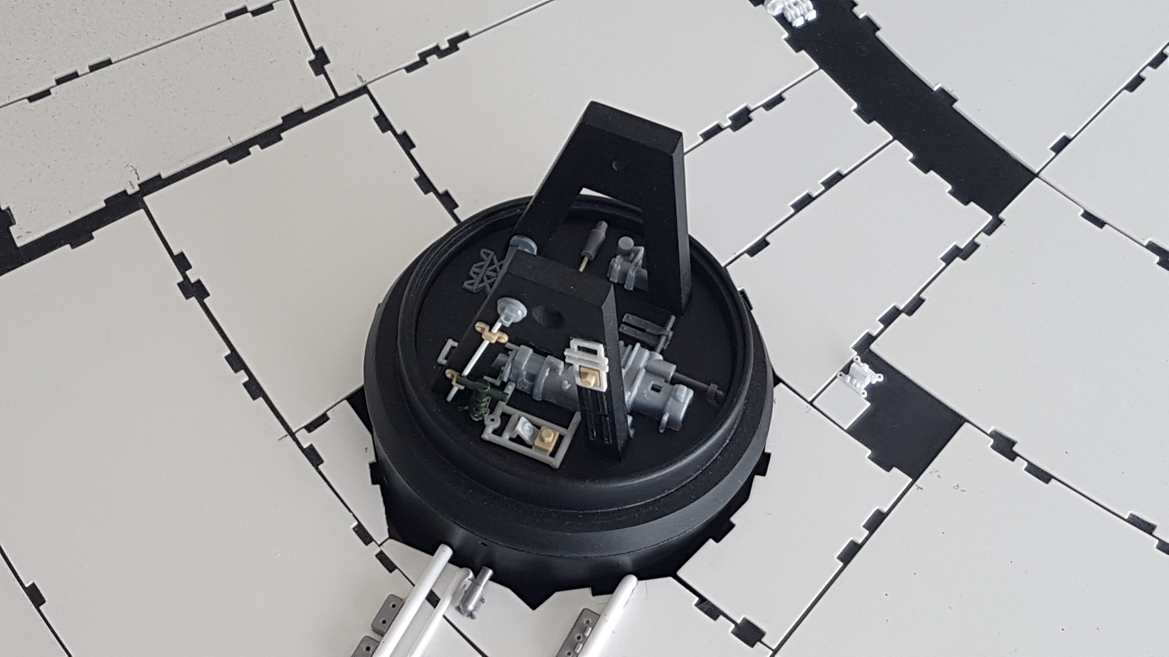

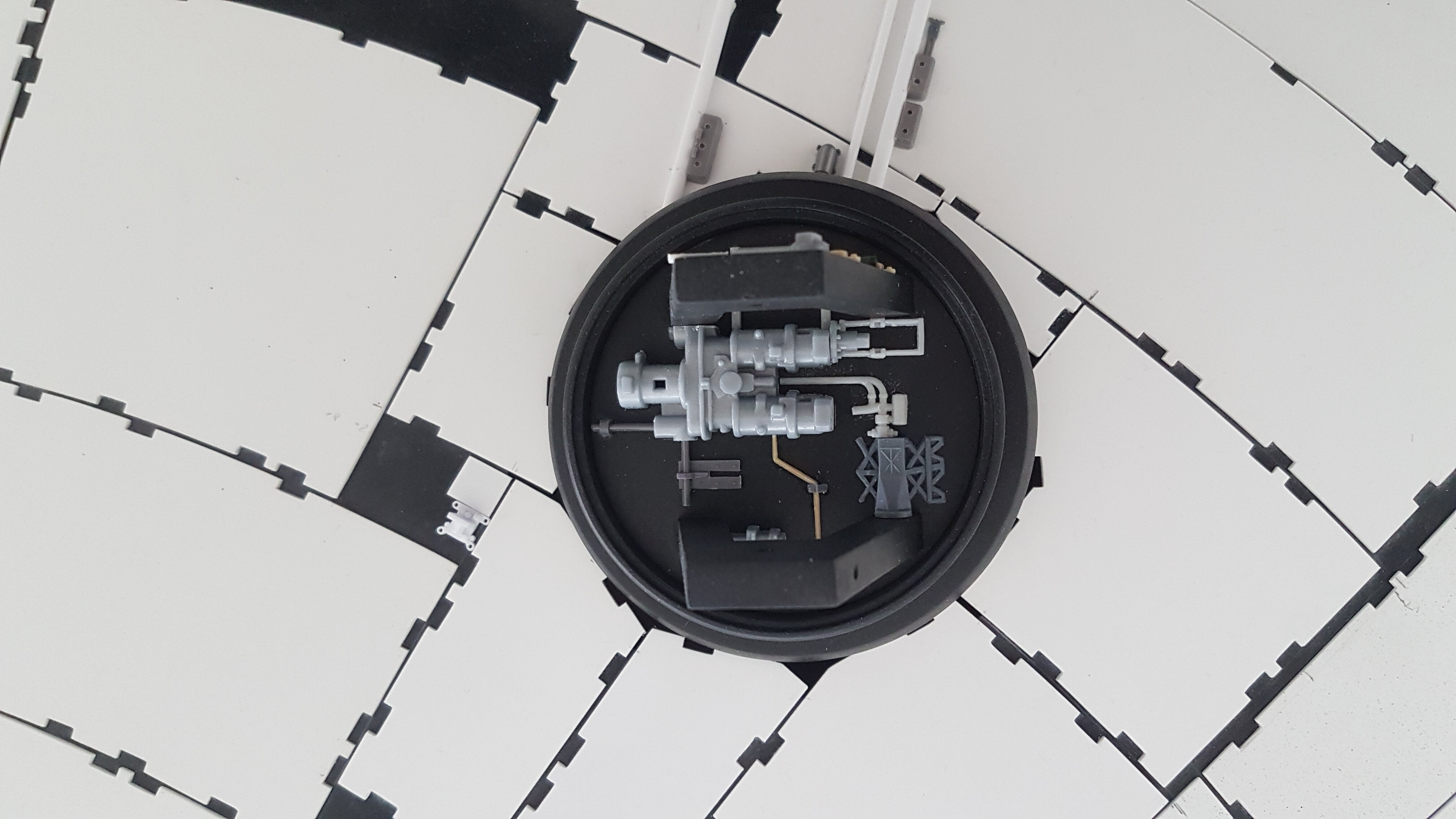

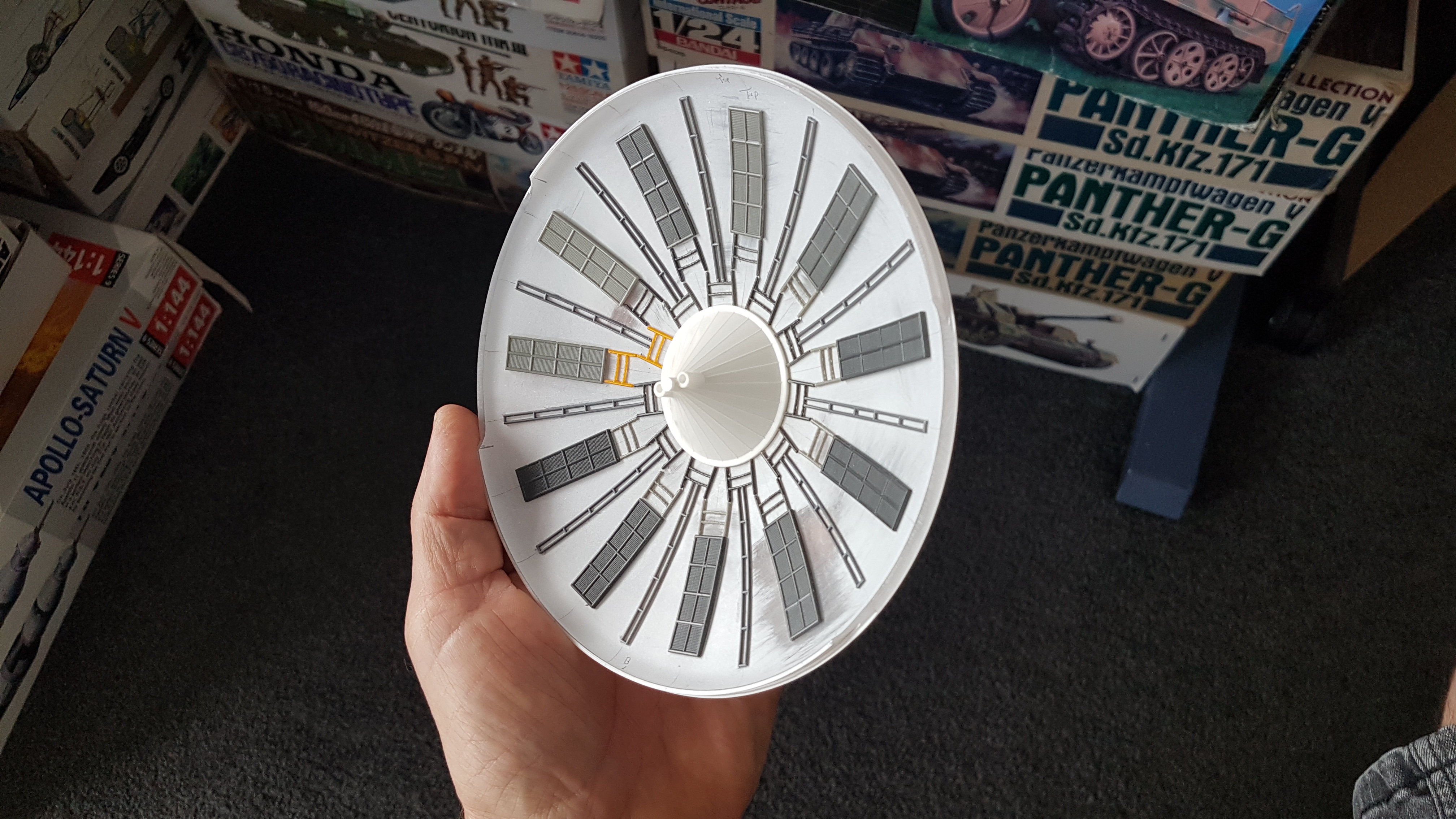

Another video up now & the radar assembly i discussed a little, but i will add some pictures here & a little more explanation.
So as per the other pits...you have to have the assembly to know the size of the pit cutout. Plating was worked out around the known diameter of the radar base & the height determined also. I'm still detailing out the assembly with kit parts & all those tiny Plastruct T strips!.
My assembly will be fully poseable in any position, but ultimately i like the classic pose of dish down, facing forward slightly to starboard.
Now, in one of the pics here, you will see a blueprint i drew a few years back...its good, but not fully accurate, there's some details i didn't pick up, but now incorporated into my final dish front face. As i said in the video, there's a detail in there that's hard to spot, but it's there!. That's what what you get staring for hours at reference pics & seeing these things...moments of 'oh i see now'.

Love that early drawing Stu. Some old school technical drafting skills there. Take's me back to my drafting at school. Very Joe Johnson like.
And thanks, I think I blew an hour yesterday trying to find these pieces on the dish....nup, nada, nothing jumping out. Too funny!
The pics of the parts on the dish assembly and pylon are a big help. Very clean work by the way.

Ha yeah, that drawing took an age to do & even now its wrong in a few details...but i still love it & its a nice thing to have on the bench while working on this assembly.
Well, you're going to have to look harder my friend for the hidden details that those crazy ILM modelers put in there!.
I almost had a heart attack when I saw you video explaining the build/scale of your MF; your long arms gesticulating over that beautiful Studio Scale model made my heart skip a beato_Oo_O "Please, don't hit it" was my thought!! Great radar dish for sure and glad to see that a pencil, compass and line drawing are still the fastest way to flesh/design something!!
