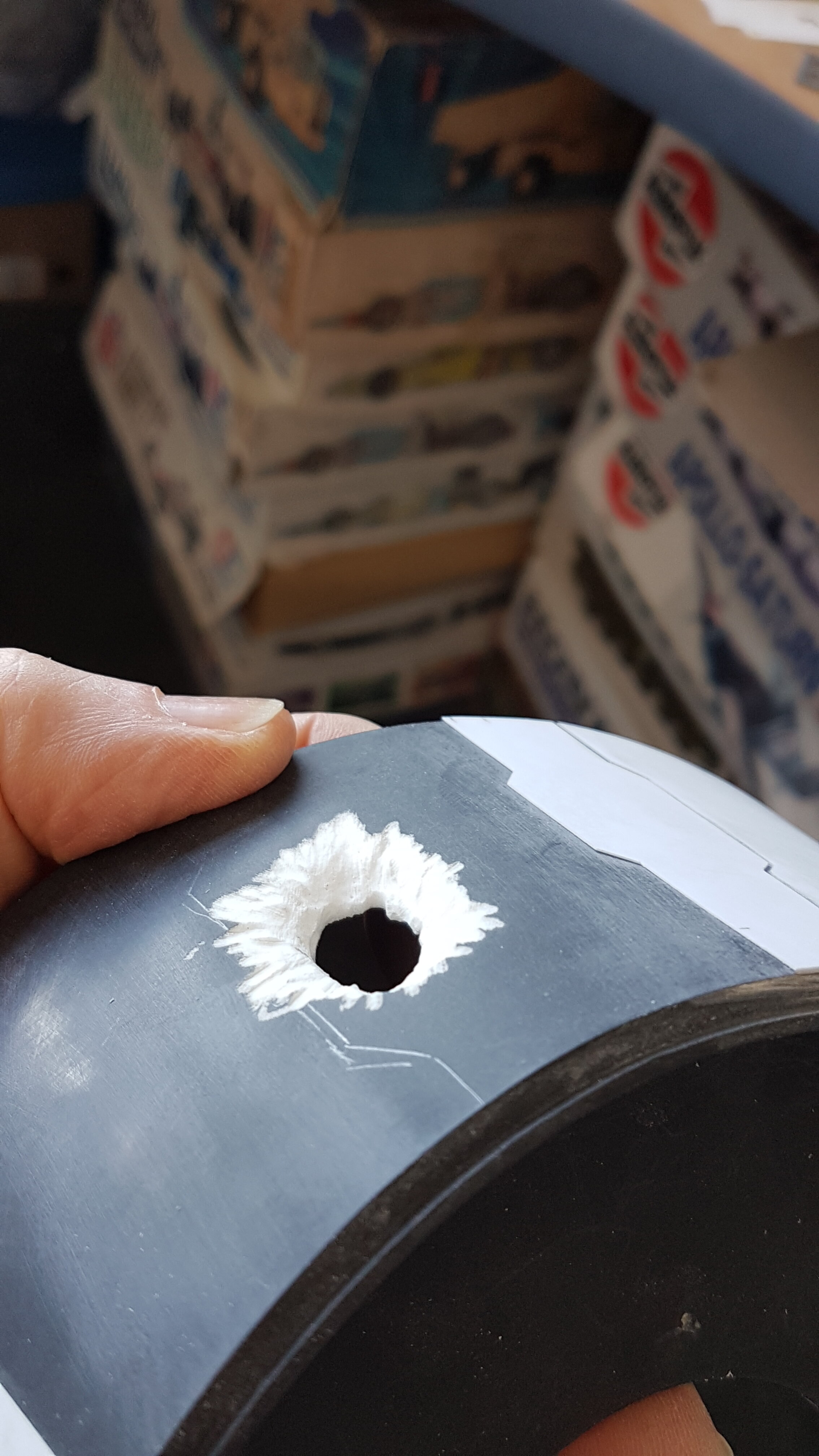

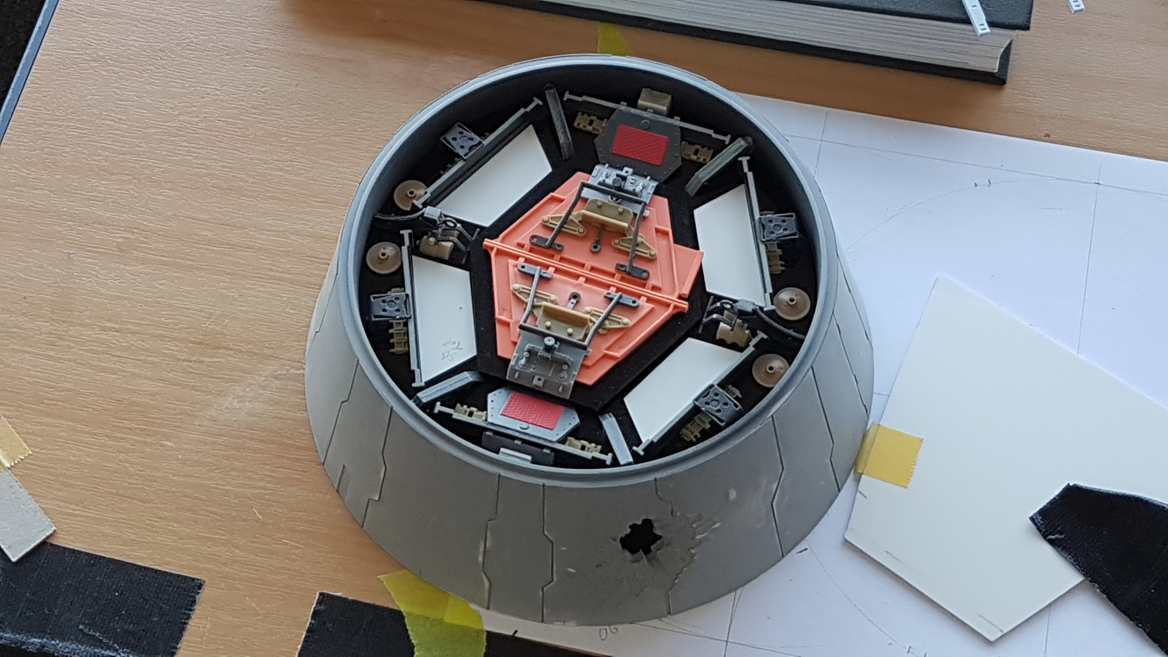

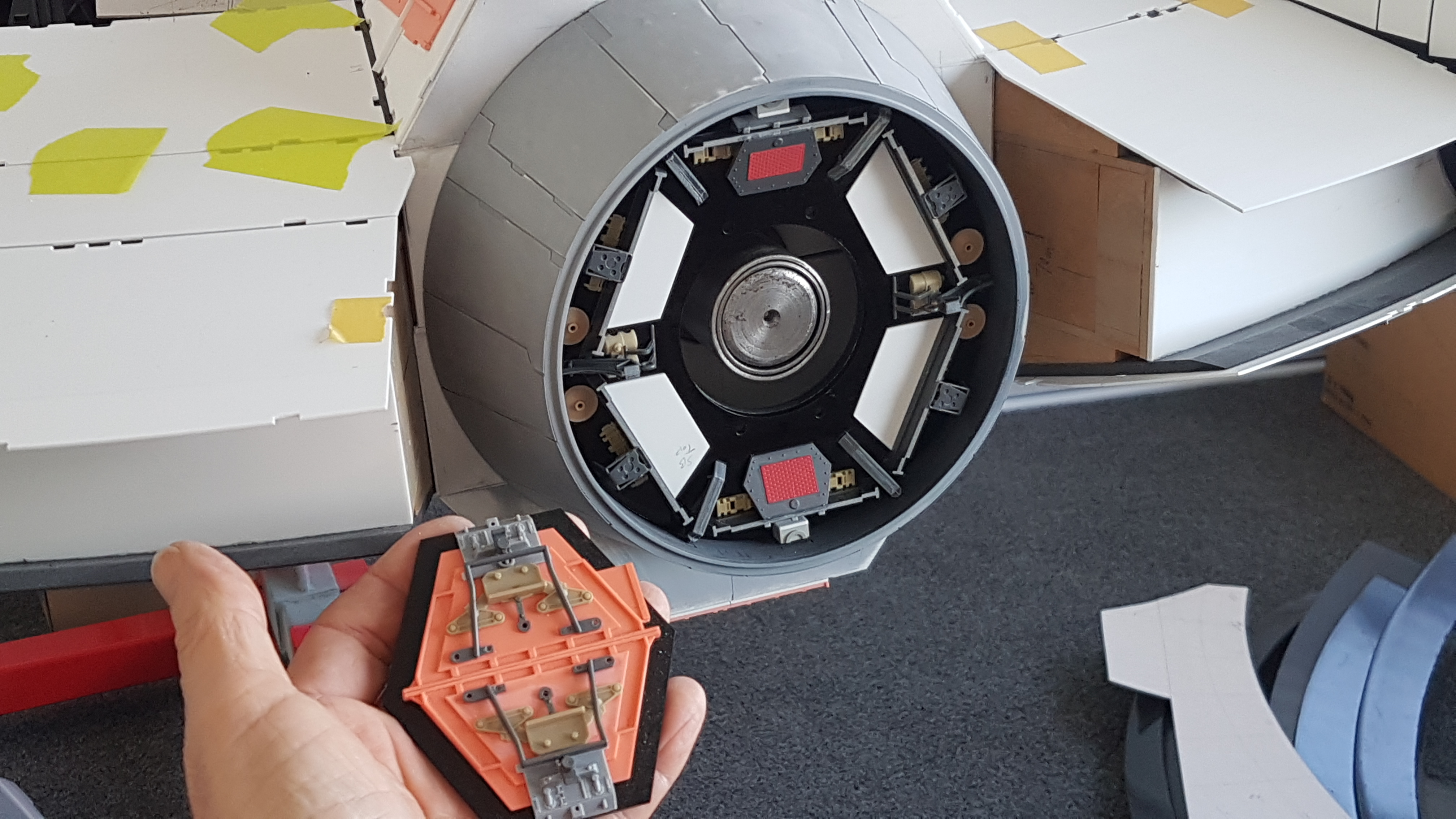

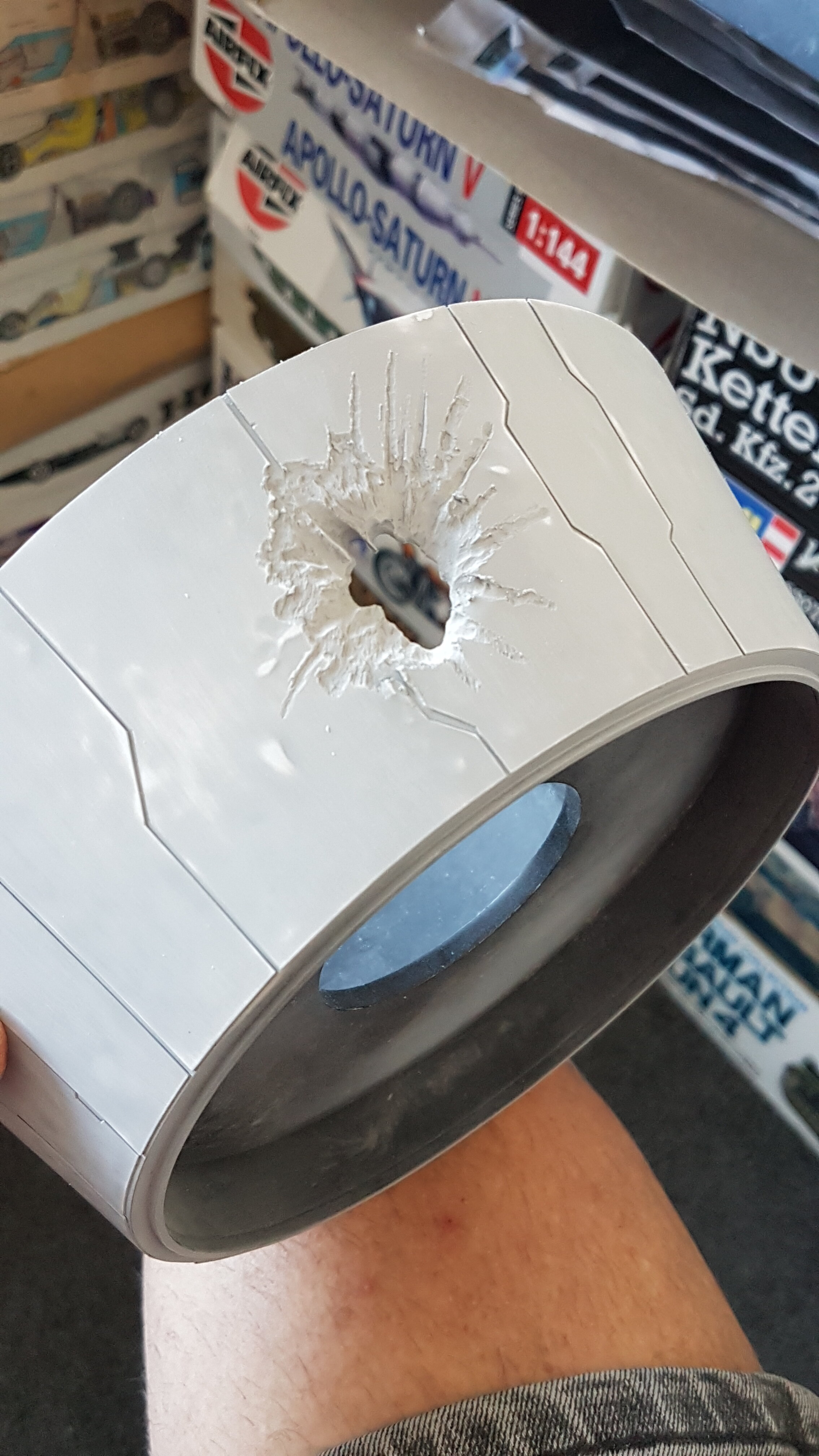

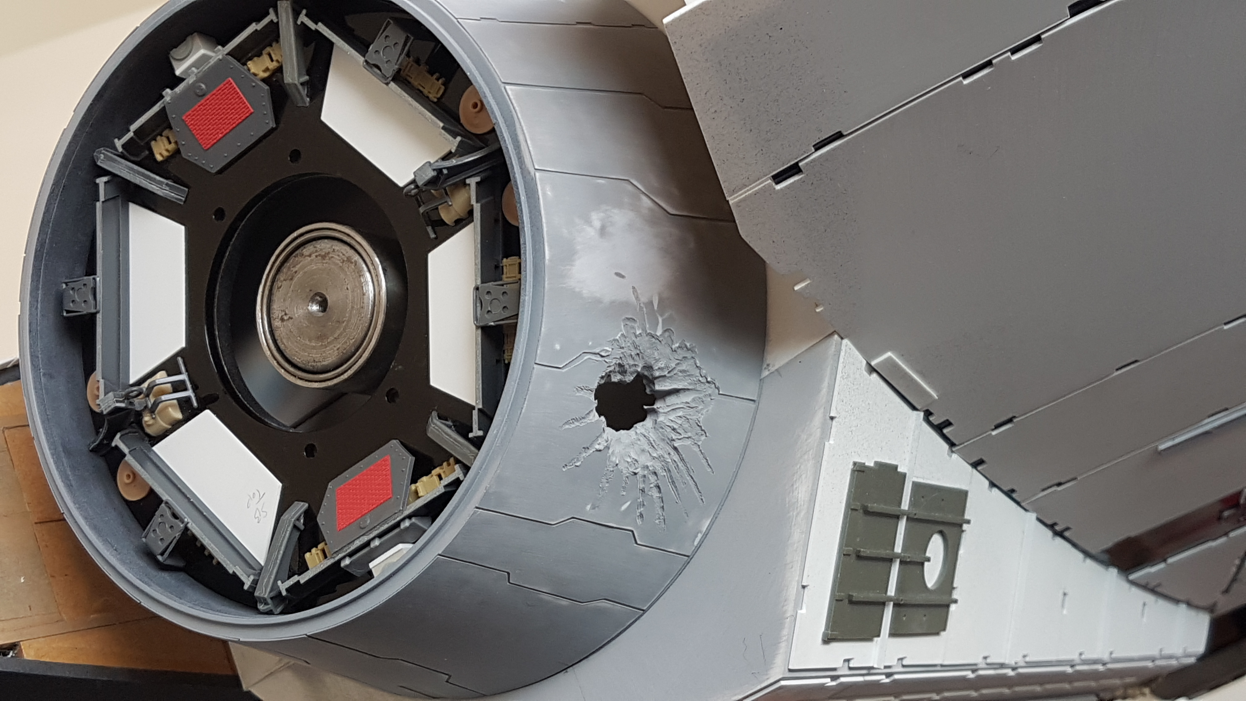

A bit more progress done!. Starboard side docking ring plated, the laser blast damage added & finally the whole thing attached to the model.
Still a few kit parts to add inside the detail plate & around the diameter of the DR.
Pretty cool to see this in place after all this time & looking forward to the portside DR in place!.

Great work eagle 1. Layers upon layers of kit part detail is quite an art form all by its self. Then, again, so it the talent of CAD, printing & casting. Love the flak damage. Must have looked at a lot of tank armor damage pictures or played with black tip ammo.
Hi Stu, I was wondering when we would get to see the docking rings. Looking fantastic!
The styrene card around the outer radial surface looks the part, but does seems very thin in comparison to the rest of the ship. Curious what thickness are you using here?
Cheers,
Yes the plating around the docking rings is very thin styrene, same as the original miniature!.I used .25mm sheet. It looked right to me when looking at reference, anything thicker & it looked wrong to my eye.
I suspect the original modelers applied a continuous 'wrap' of this thin styrene around the ring & then cut out all the details, but I chose to add each panel individually matching a template. In hindsight I could have gone the 'wrap' route as well, but I guess both methods work equally as well.
0.25mm looks right to me.
I think you have chosen the right way to tackle this. I can see some pieces are not as uniform or a bit rough which also adds that 'piece of junk' appeal. As with the gaps perhaps.
And in some way similar to much of the original plating, as described perfectly in your recent youtube of laying the 1.0mm armor plating.

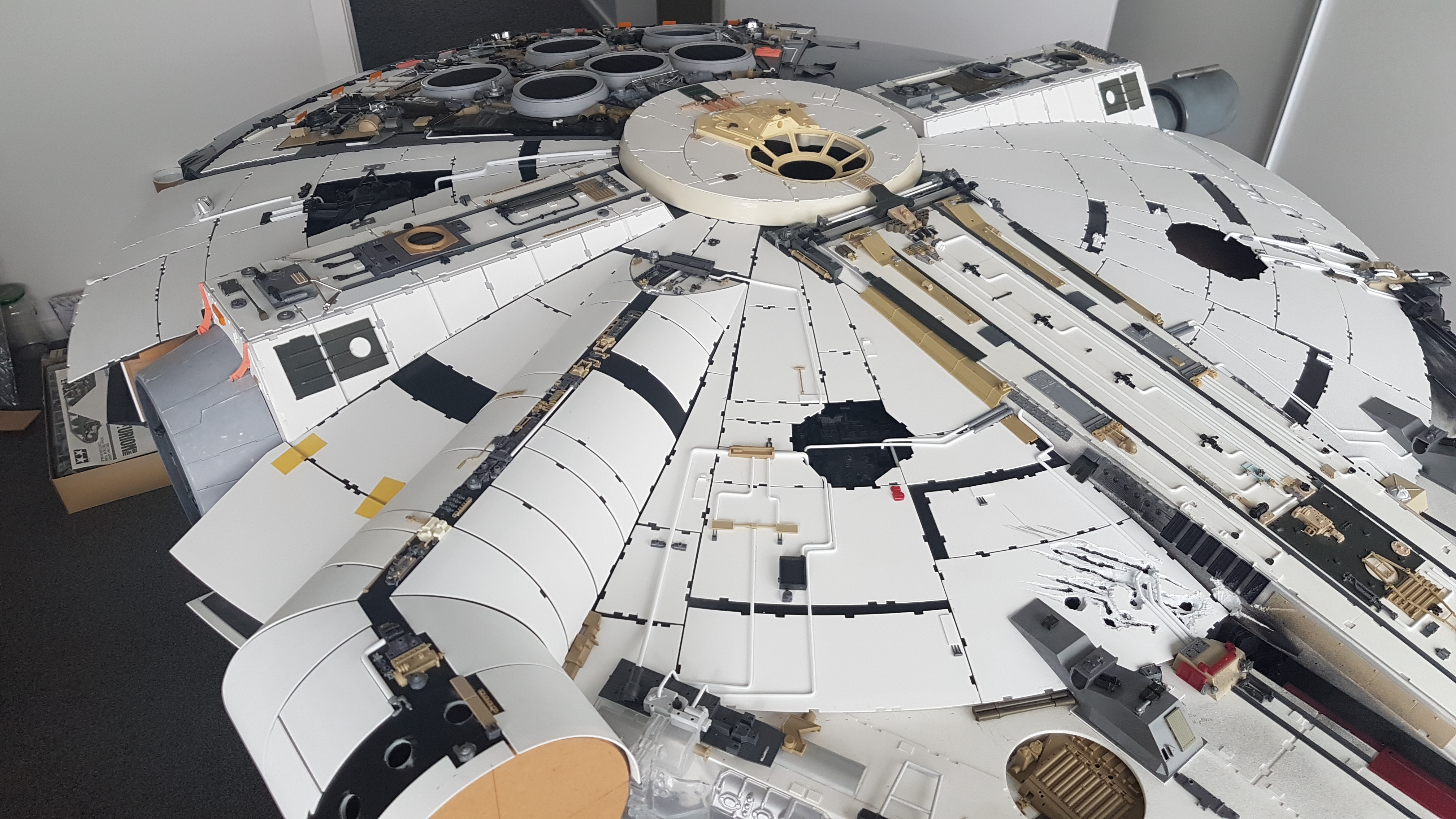

Every time I visit this thread, and see your hand next to the model, I just am amazed at how large the MF actually is.

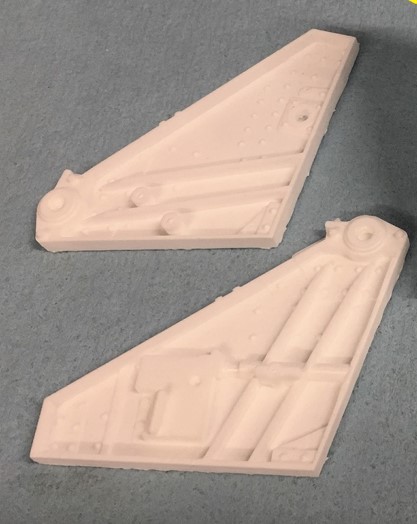

A bit of a hail Mary call, and I know there are a lot of these are expensive and people have been collecting them, if someone is willing to cast maybe I can offset the cost of an original to someone. Some items I am looking for, like many here assembling the parts takes time, slowly slowly catchy monkey, I am not too fussy on recasting as there are some rare items that I have never seen for sale in all the five years I have been searching. If anyone can help out with any of these, I have a postal address in America and UK so you don't need to worry about EU import duties. Some examples of items I'm looking for. I haven't listed all the Stug parts but I can discuss if anyone is willing to cast any of them. I have a few original items I may be able trade.

Wow - coming along very nicely! Great progress. I love all the stages of a build like this - when the greeblies go on it's fun to see all the individual donor part colors, then the priming stage unifies it all, and then the actual painting and weathering stage makes it all come to life.
