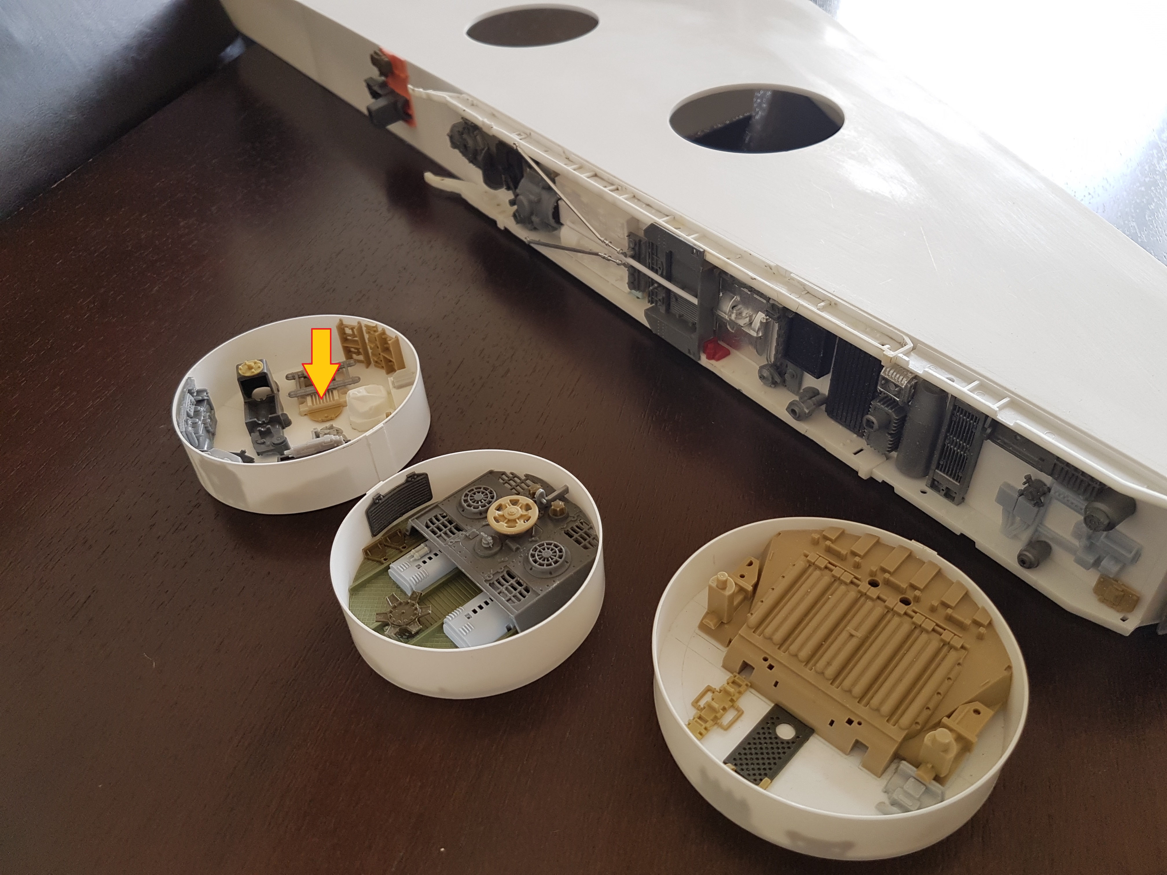

Stu,
What is this piece, and/or how did you make/mold/acquire/print your substitute piece:

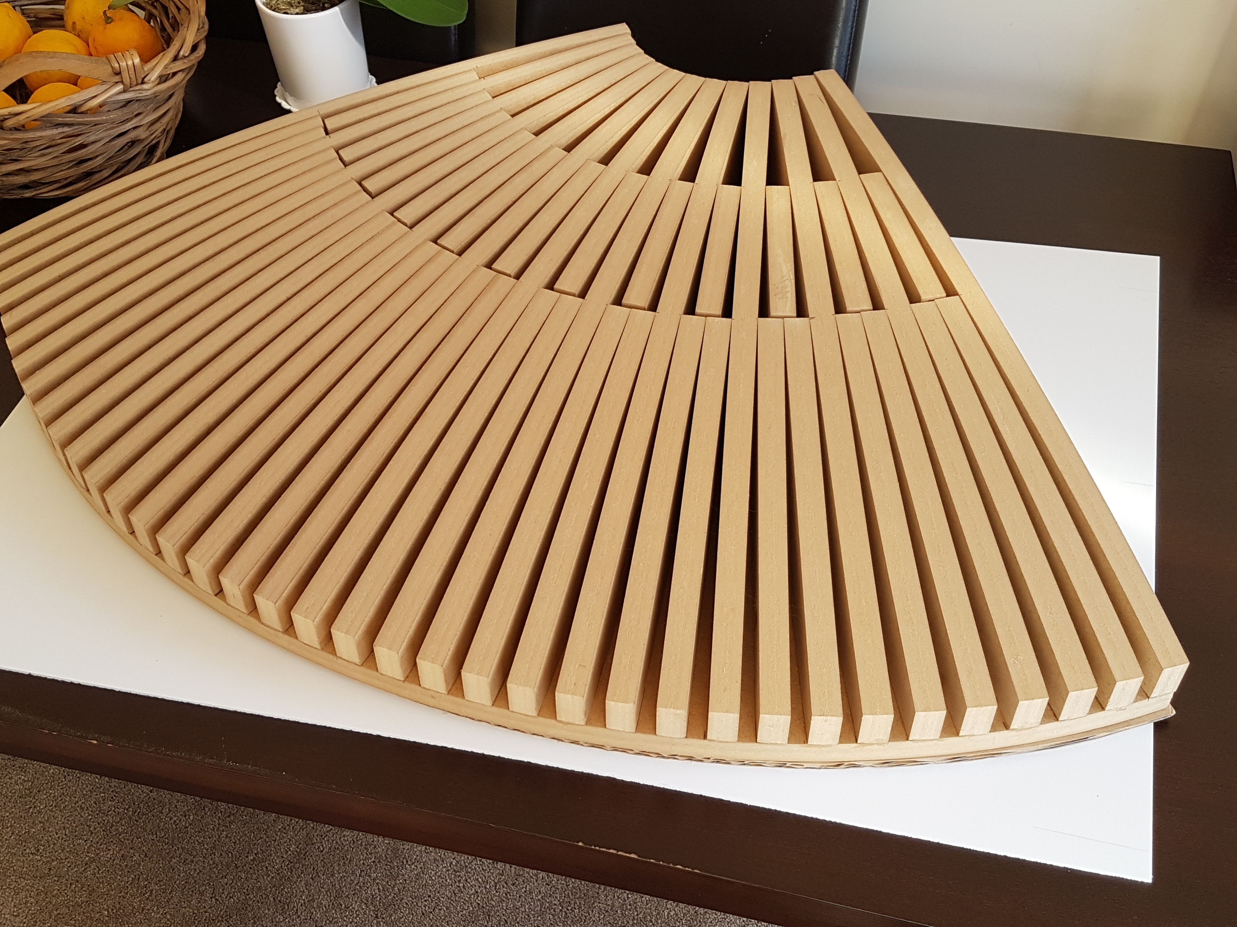

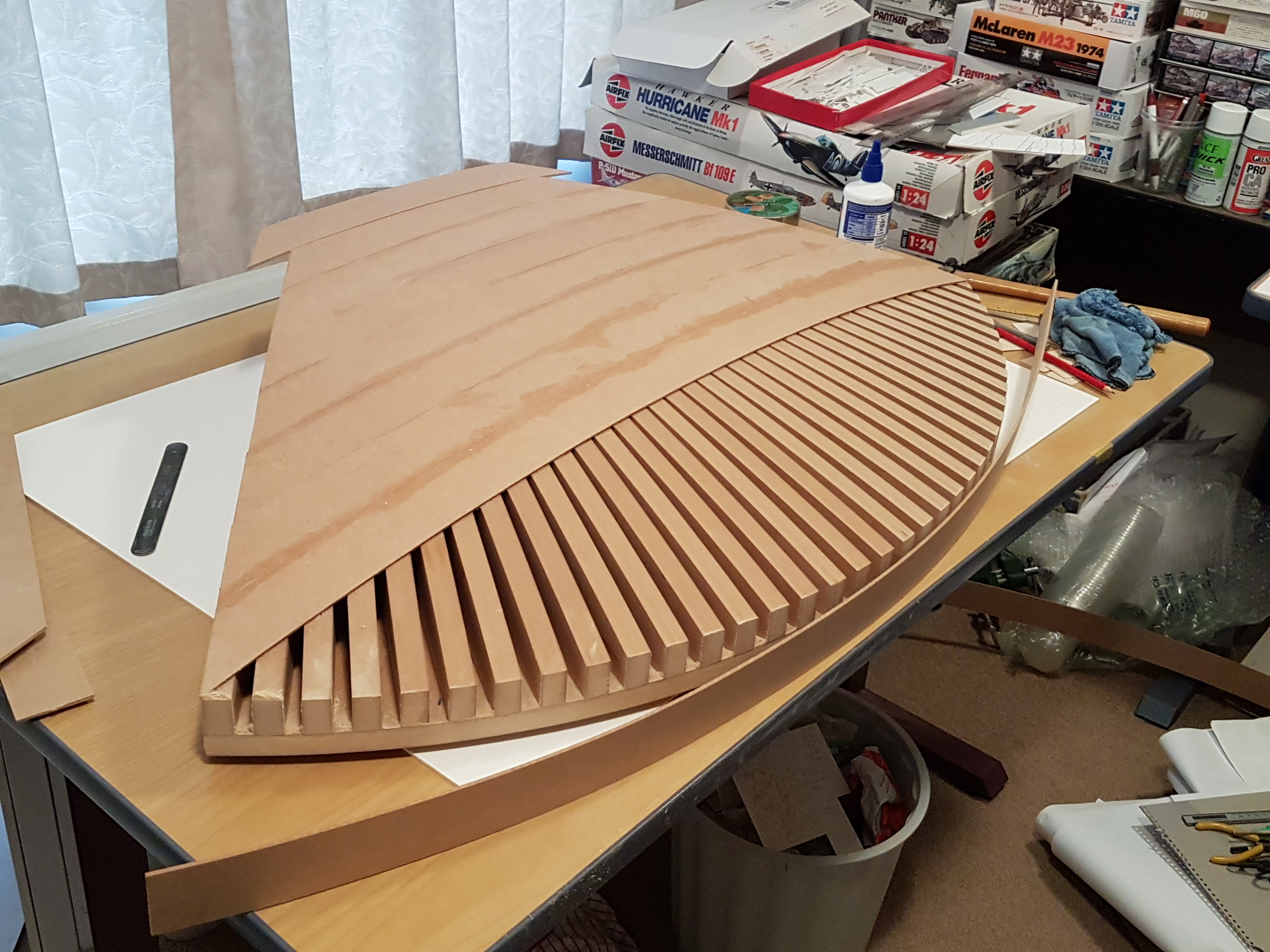

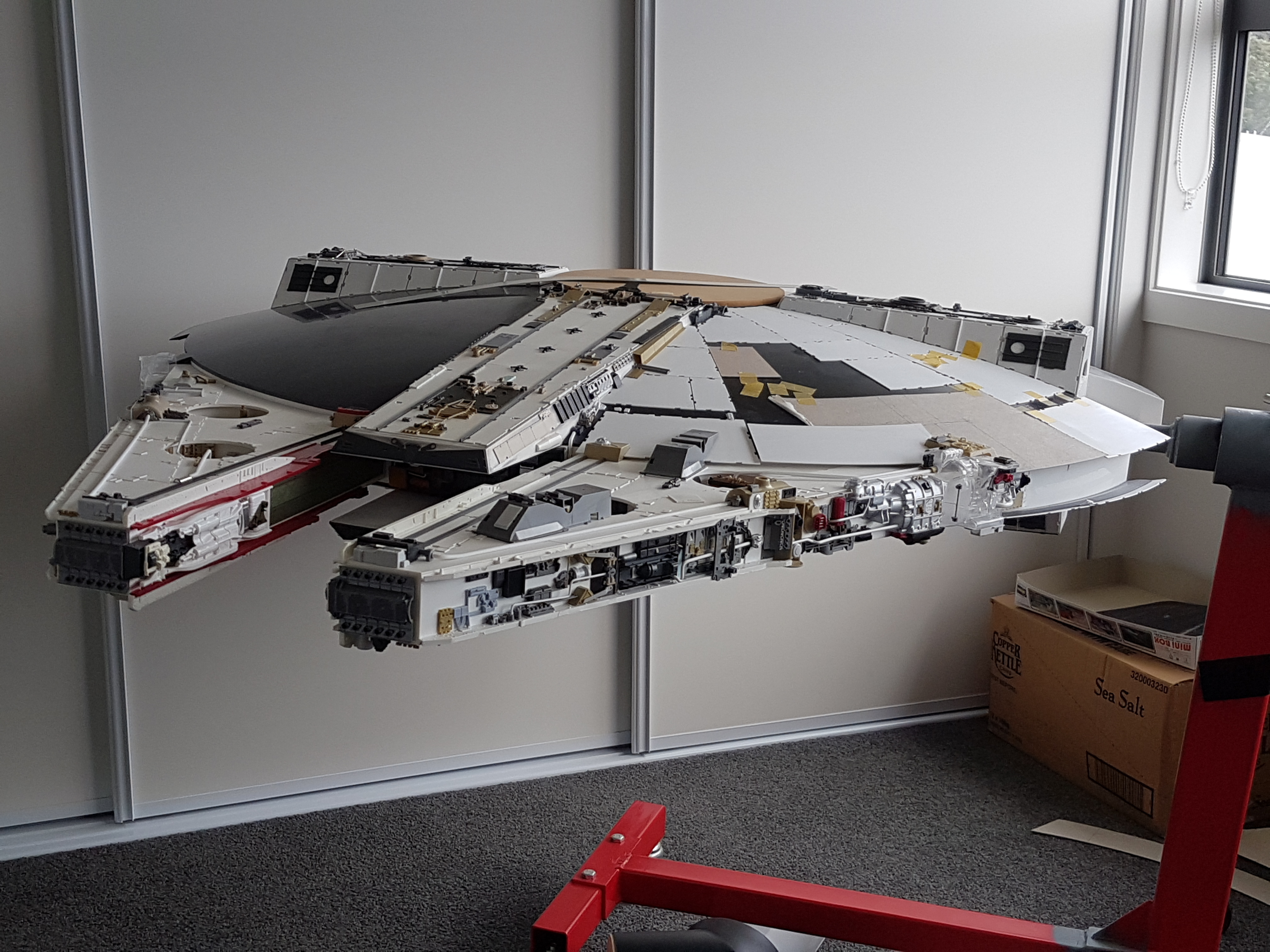

Thought I'd post some progress on my hull dome work.
I realised early on & couldn't find a place in New Zealand anyway to blow mold one piece domes, that really, there is no point to full domes, why wouldn't a half dome or even a quarter dome section work!. So that's what I have done, built an oversize quarter section form or tool, to have the domes vacformed in 4.75mm ABS. The tool is oversized to allow good pulls & trimming when placed on my core. The tool was all CNC'd MDF. Just finishing up the skinning now, which is 3mm MDF. All this will be sanded smooth & filled if needed & sanded again & sealed. Then it will be down to the plastic formers for vacforming. 10 pulls will be needed for 1 Falcon, 8 for the 2 domes,1 for the engine deck & the last for the engine petal strips & maybe another as a spare.

Well the buck ribs were derived from working backwards really. The full dome contour was ascertained, allow for the dome thickness & make the ribs allowing for this. You really need a side profile to have a rib profile to go off.

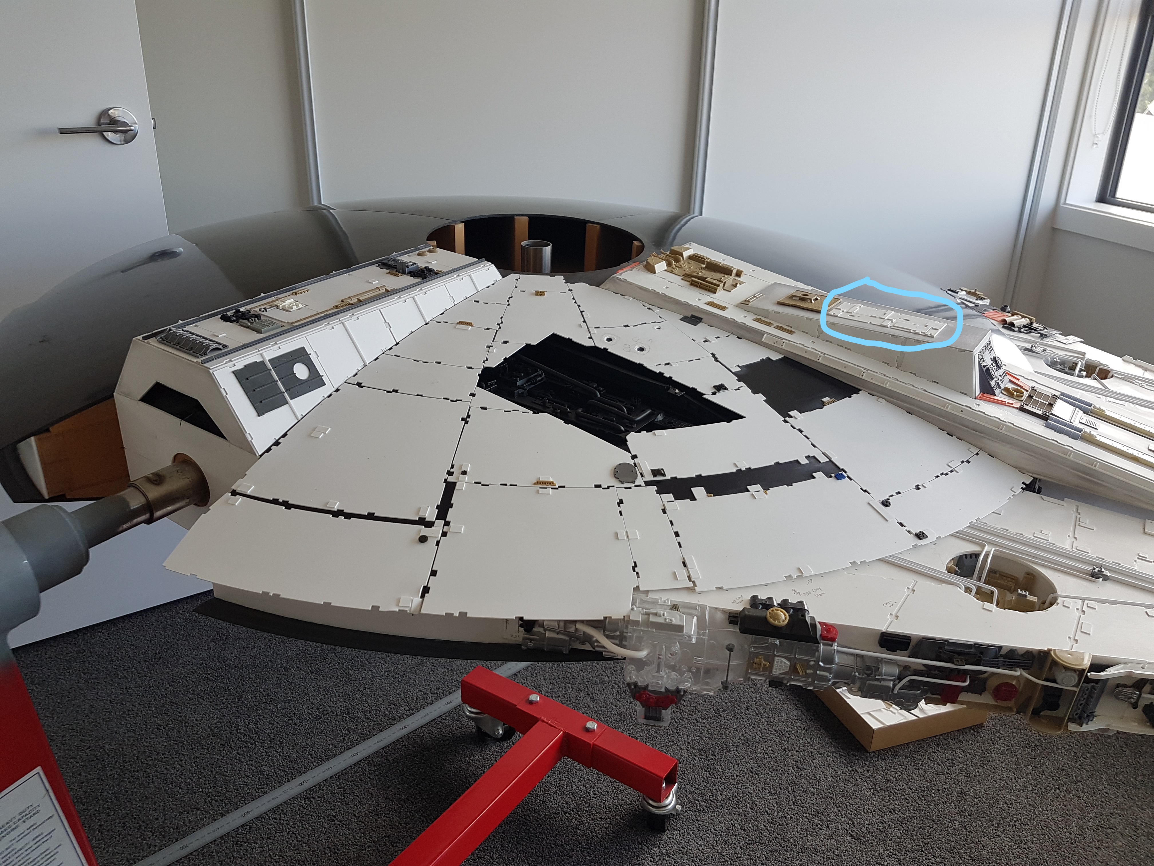

So model is flipped over for the topside plating & 3 pit, one radar pit placement & install.
I find when it comes to plating each section you find out if your subassemblies are slightly off here & there. Not really had any issues at all, oh apart from top of big landing gearbox being a tad too tall on the highest points & was modded to match the ref & all ended up perfect there, but here at the portside mandible top I found where I had marked out the placement of the McLaren tub & where I glued the Panther wedge shaped part were off, the plating overhang to parts not quite fitting to the ref. So popped off the Panther part, brought this forward & pushed the McLaren tub back 3mm. It doesn't seem much, but all these running mods are worth it to match the ref. If you can do it now...then do it!. So really pleased how when these parts are glued down they sit with the plating perfectly.

So glad to hear that the parts are fitting Stu...!
The model is looking amazing!!!
apb
Thank you Andre.
Well as we know, the proof is in the building & having done the hard yards in blueprinting beforehand.
Minor tweaking & mods while building is nothing new to builds such as this, you only find out by actually putting it all together what works & what doesn't.
Happy to say though that the 'core' is solid & everything is a joy to slap on...a testament to you & Joshua's astonishing blueprinting!.

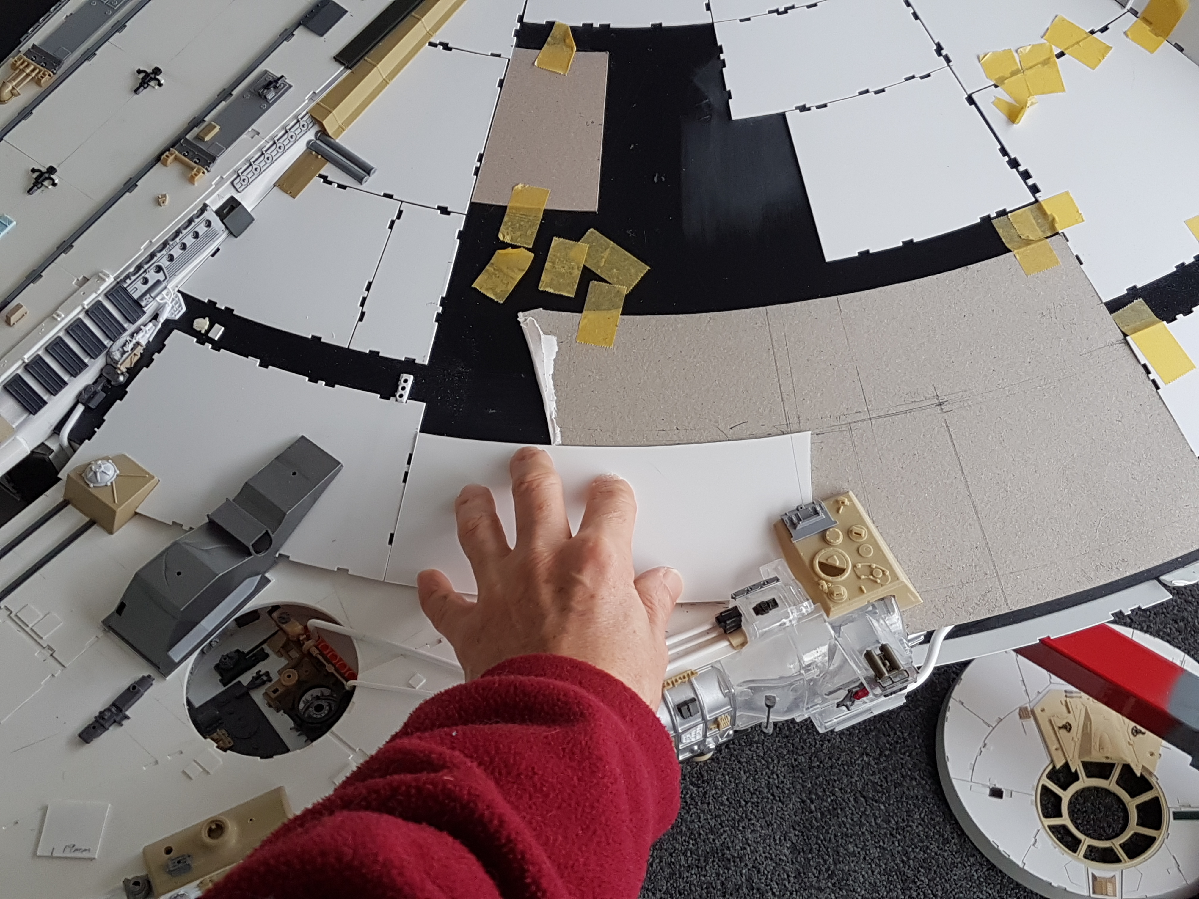

Topside panel fitout!. Marking out, dry fitting, testing with kit parts, adjusting, templating & final styrene panel placement!.
I think armor panel making & nibbling all the little notches is the best part of the build process, after that...glueing down the kit parts!.

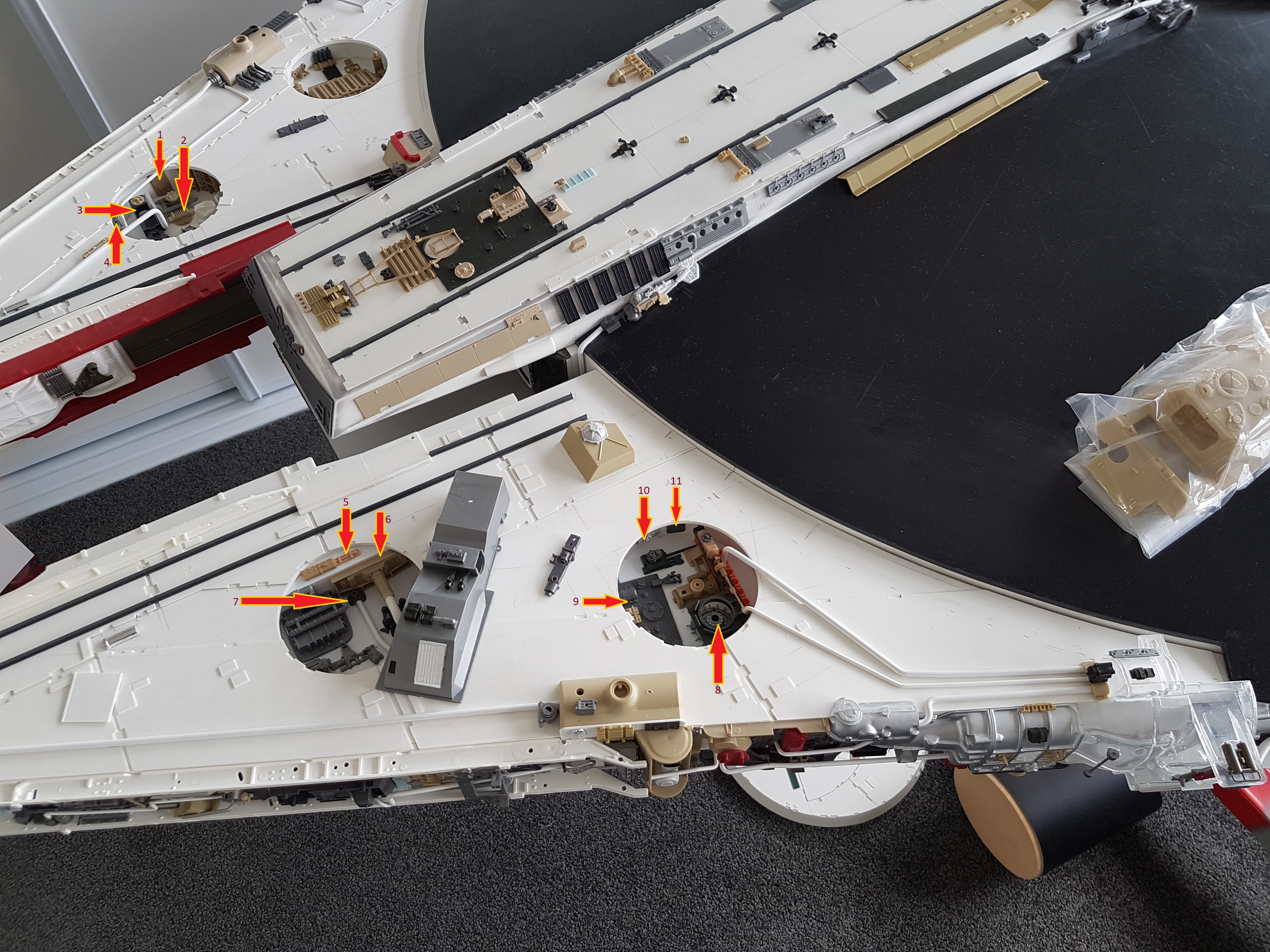

Good morning all,
I am contacting you because I have trouble recognizing certain parts: /
I have numbered the ones I have a problem with.
On the other hand, the 9 is tiger I bandai 1/48, and not tamiya? as shown in the kit part?
thank you in advance for your help.
