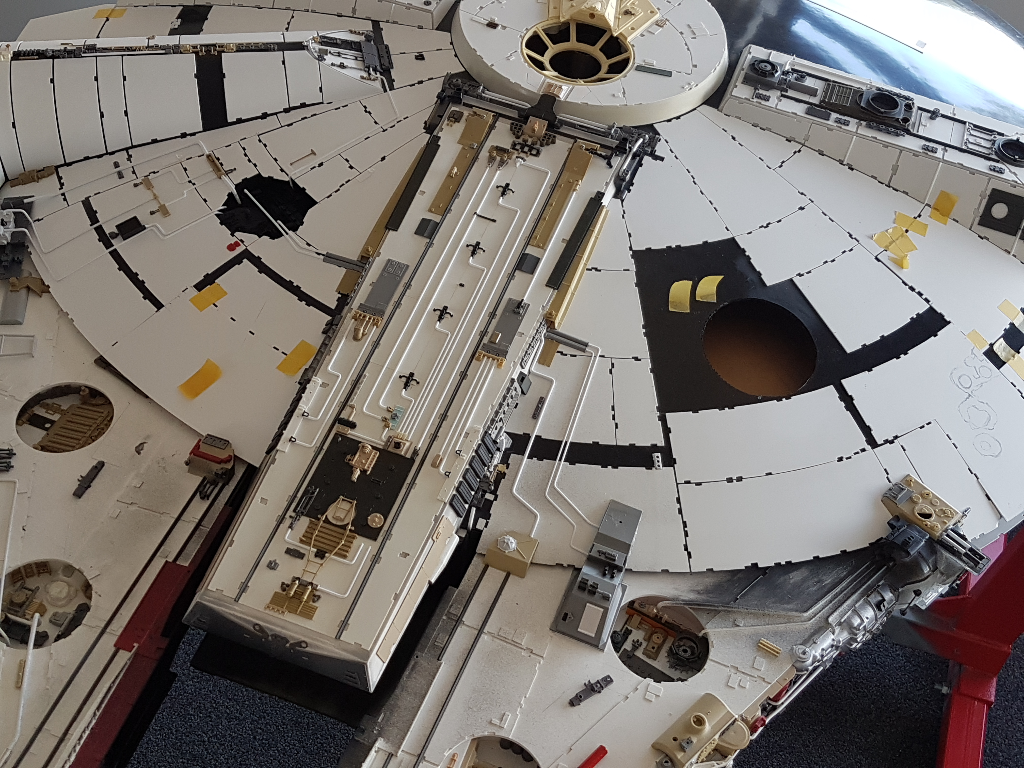

With the pre-formed curved styrene panel making being only 1mm thick, I simply pressed down on the roughly cut panel on my bench & marked out the correct size. The panel was then again pressed down almost flat to cut it out. The panel pops back up to its curved state as plastic has a memory.
Yes I do have the holes for those extra holding/handle points on all 4 curved sidewalls, or at least I added extra material behind my kit core walls to allow me to do this later. Each handle entry point through the casting plate & sidewall material also has it's own unique cover hiding the hole.

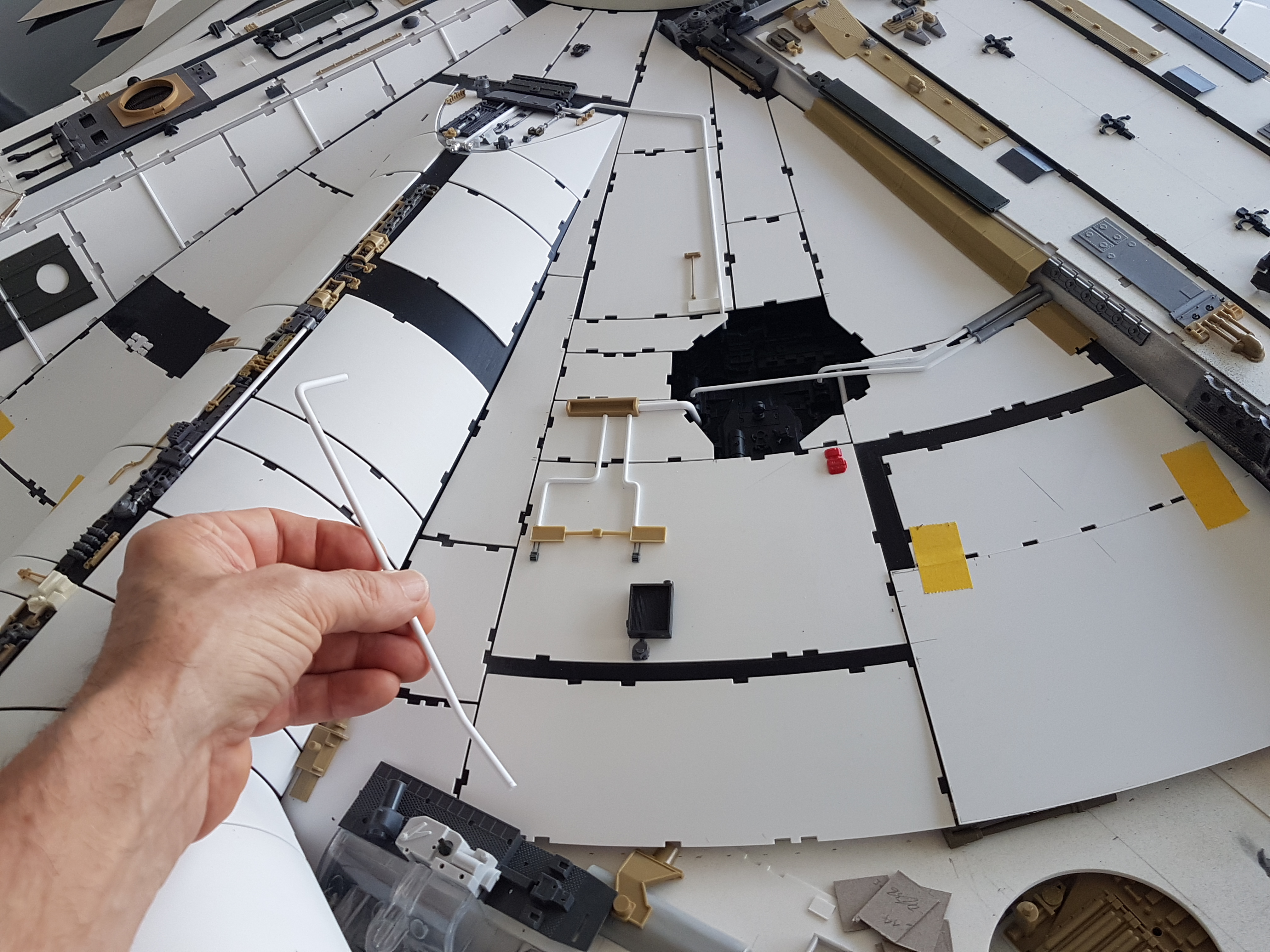

Stu, what technique are you using to achieve the bends on the styrene rod. They appear perfectly formed.
The pipes are all pretty much bent over a candle. Thicker pipes are held closer to the flame over the thinner ones, but not too close, it's all a matter of practicing & seeing what works. Some can be bent simply by bending with your fingers, especially the thinner pipes, but without heat they tend to spring back & don't stay in the shape wanted. Heat bending gives the desired tight bend needed for alot of the pipes, it's the only way really.

Whenever I bent a rod over a flame, it always made that part black from the burn. Maybe I held it too close, or are you wiping off the burnt part. (Or both)
It gets primed/painted anyways, but just wondering.
If you are getting the pipe black, then yeah, way too close!. Larger diameter styrene rod you can hold closer, say 3", but not for long at all, it's only to soften & pull away to do the actual bending, not holding over the flame at the same distance while pulling a bend.

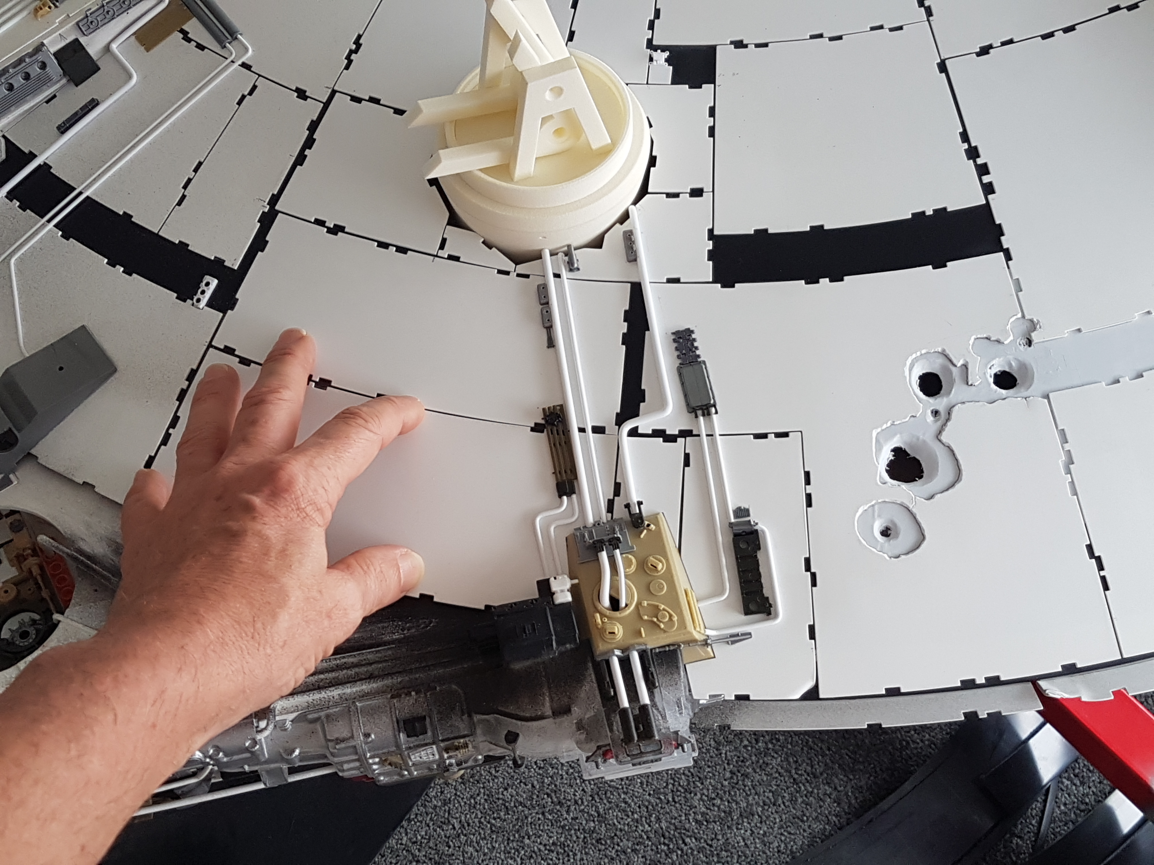

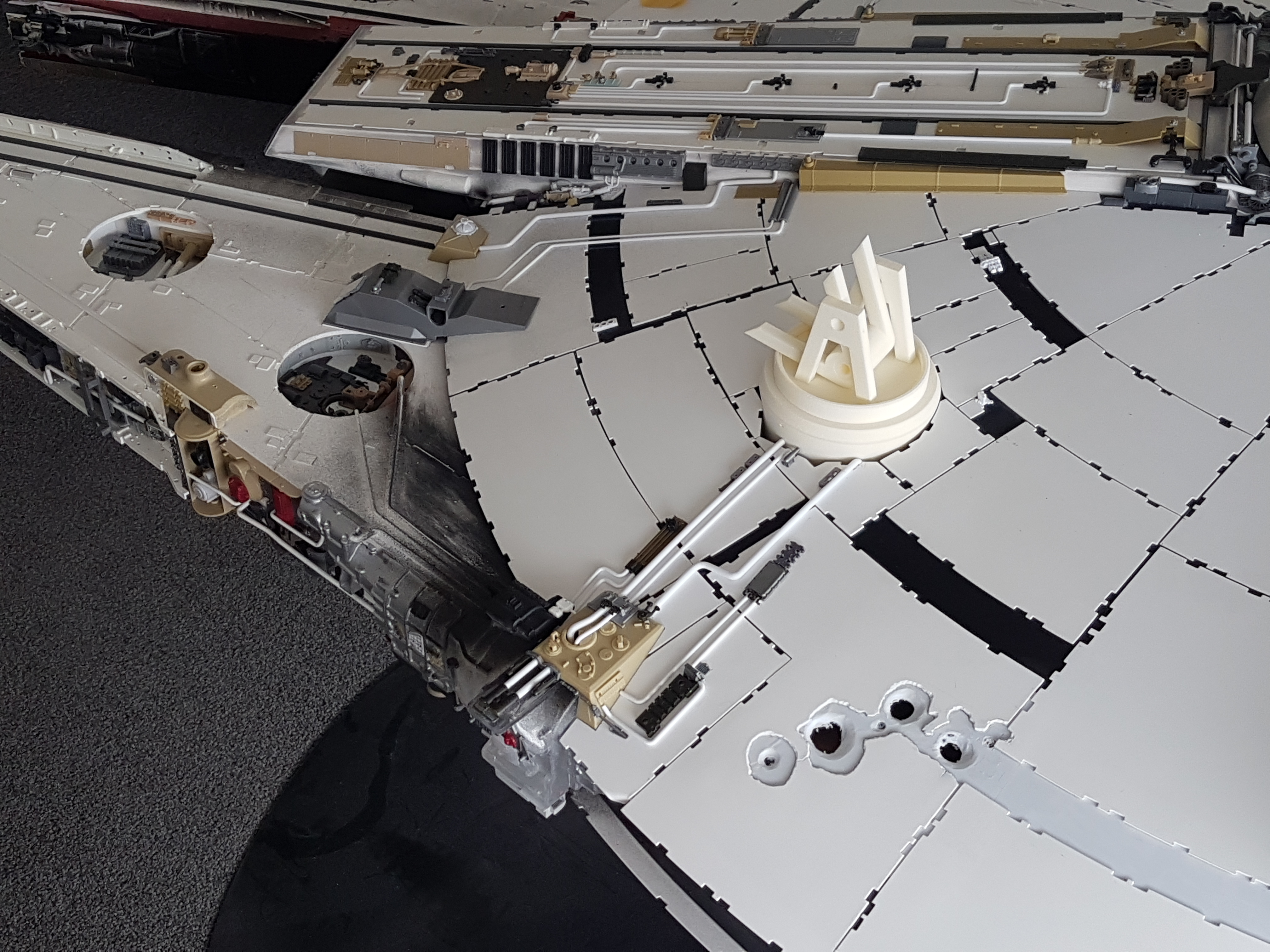

Radar quarter section progress. Plating complete & the 'blast' damage added with more work here needing to be done with layering of damage & dremelling to replicate the miniatures wonderfully applied damage.
One more donor part to add, seems to have gone AWOL for now, but will have another hunt for it.

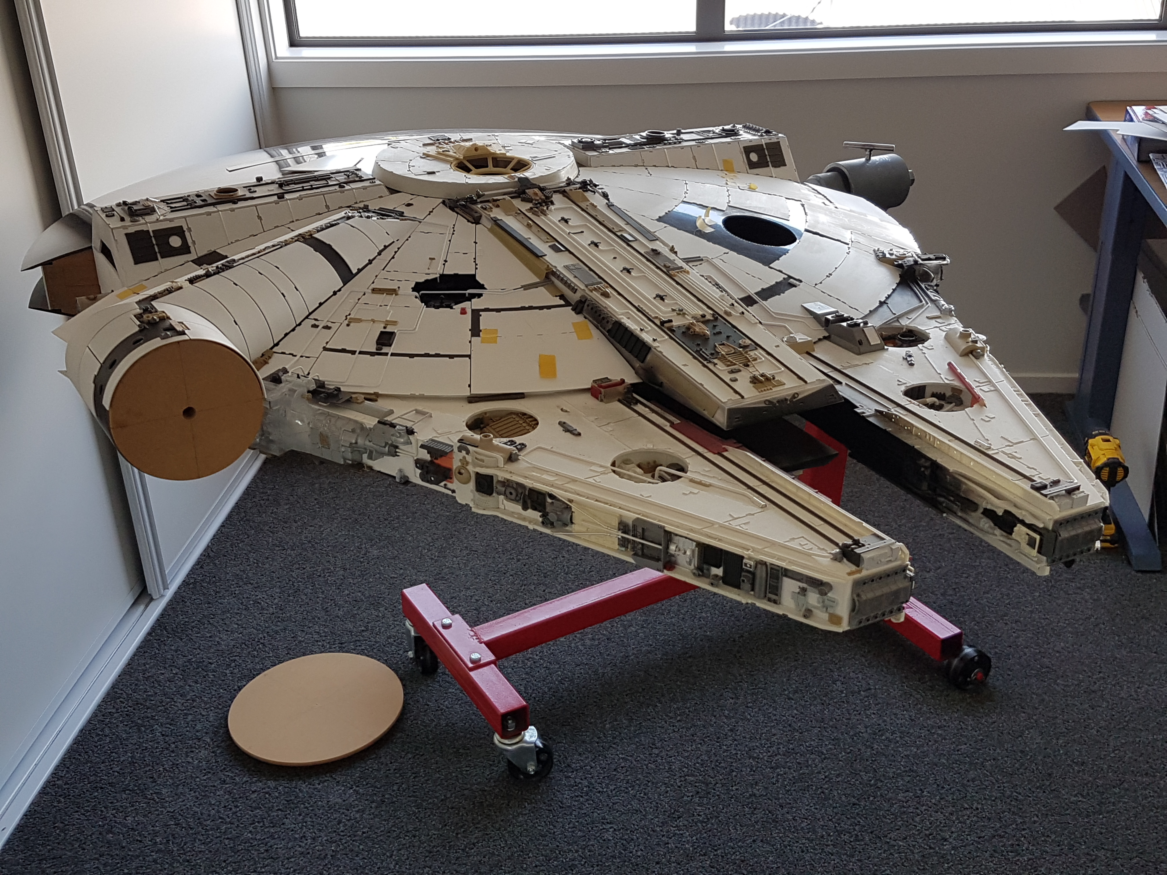

Thought I'd post some progress on my hull dome work.
I realised early on & couldn't find a place in New Zealand anyway to blow mold one piece domes, that really, there is no point to full domes, why wouldn't a half dome or even a quarter dome section work!. So that's what I have done, built an oversize quarter section form or tool, to have the domes vacformed in 4.75mm ABS. The tool is oversized to allow good pulls & trimming when placed on my core. The tool was all CNC'd MDF. Just finishing up the skinning now, which is 3mm MDF. All this will be sanded smooth & filled if needed & sanded again & sealed. Then it will be down to the plastic formers for vacforming. 10 pulls will be needed for 1 Falcon, 8 for the 2 domes,1 for the engine deck & the last for the engine petal strips & maybe another as a spare.
