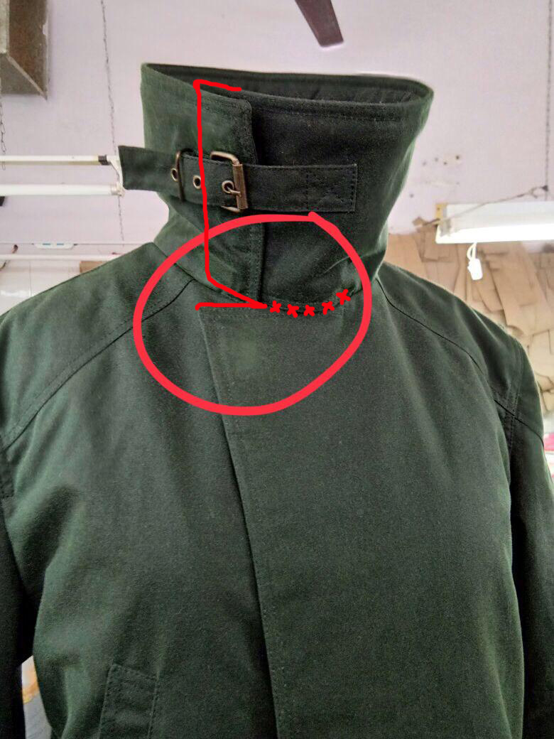

I think the problematic area is here. With the two flaps connected at the seam, it looks like getting it to lay flat when being worn up would be difficult. I’ve been trying to think of a design solution but I haven’t been able to come up with anything. I’m certainly no tailor!
I suppose a doable compromise would be to only stitch the two sections together halfway, instead of all the way down to the end.
What i'm suggesting is this:
First of all, using aeonpulse's picture I've drawn a little red line to sort of give us 'x-ray vision' through one side of the collar to show where the other side reaches to...
Then I drew little X's to show where the stitching would connect the two ...
but the idea is that the them being stitched together wouldn't go past that point.
I'm convinced that this would give the jacket both features.
...but lemme know what you think :)

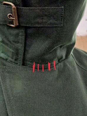

I've' just gone through every picture I have and I can't find any evidence that four stitches (basically placed as Mitch has it above) aren't on every coat. So, we're going to add this detail to our pattern unless we find something to the contrary. Excellent photo-analysis work, guys!
