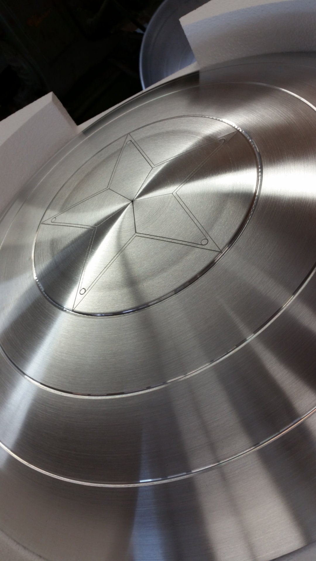

Hey guys I know Im late but Im tryring to replicate the masterworks or Efx shield on 3d printer and cast it in fiberglass or aluminum. Can someone with a EFX shield confirm my measurements? Thank you! Also can you measure the rivet head that hold the strap of the shield? Pic of the shield was taken from RPF member Chewi Thank You
