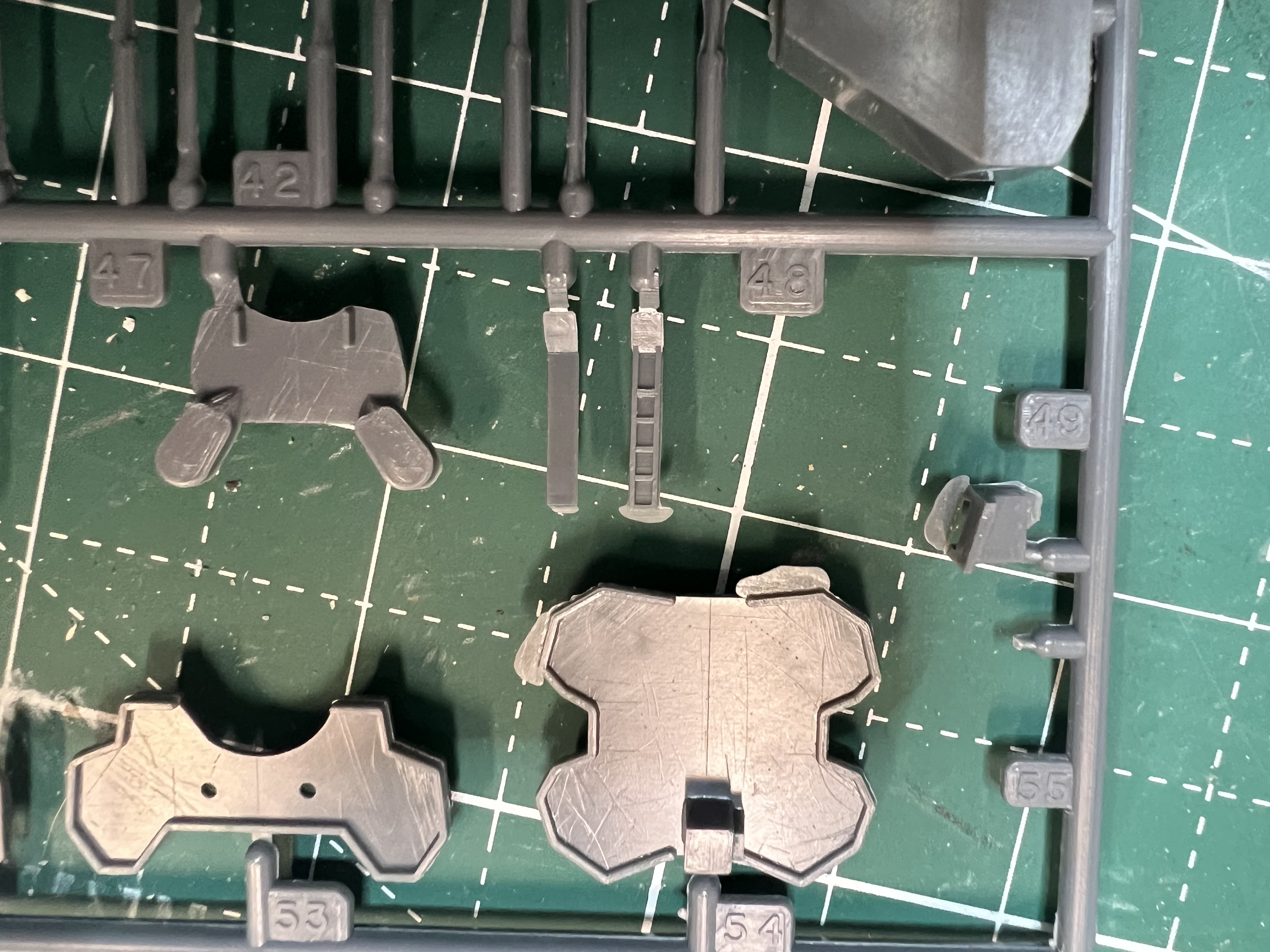

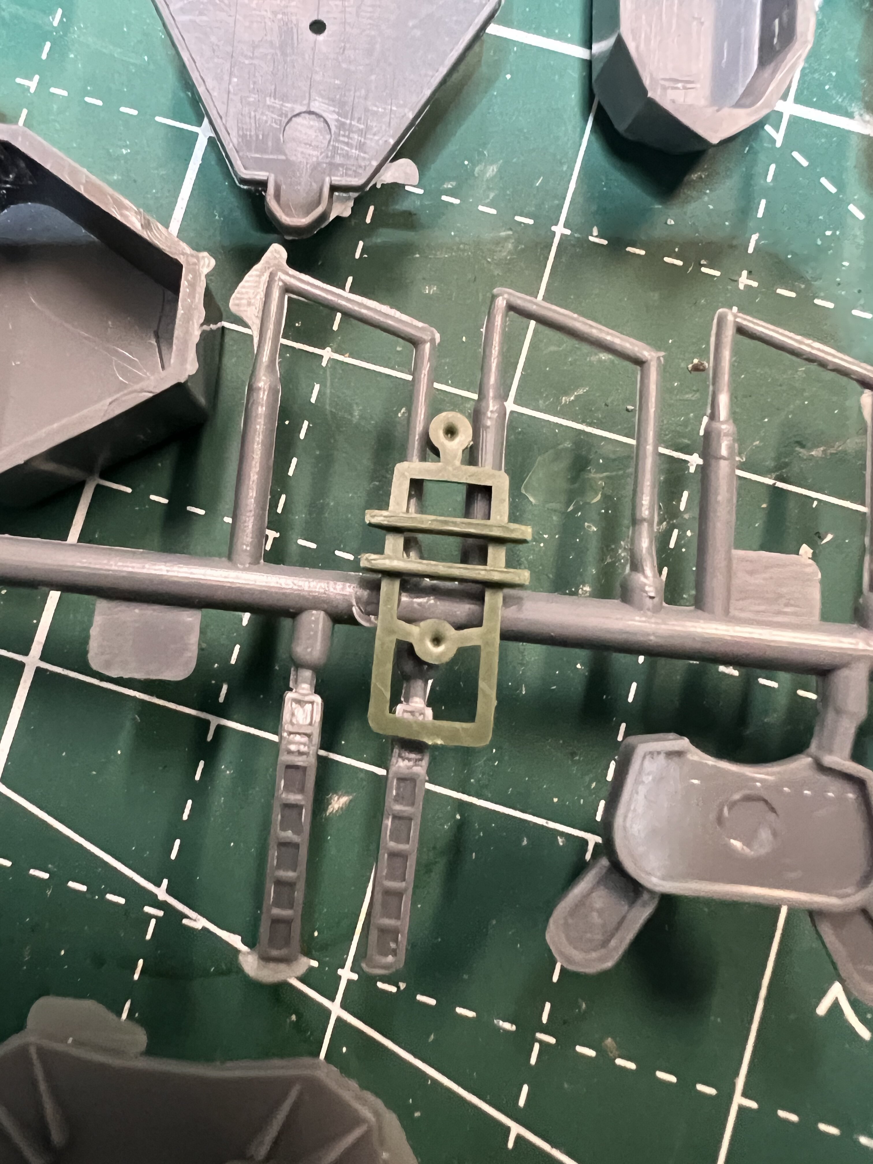

This is all I could come up with so far, and none of them are right. Im guessing these are ladders in the kits?
In the Nichimo Ise kit: Part #48 (back side of sprue) from the Ise only has 6 “rungs”.
Whereas the part on the Falcon radar base looks like it has 15 rungs on the top two pieces, and 17 rungs on the bottom two pieces. Double check me please! Lost count a couple times. Starts getting blurry every time when your count starts getting to the end going top to bottom. LOL!

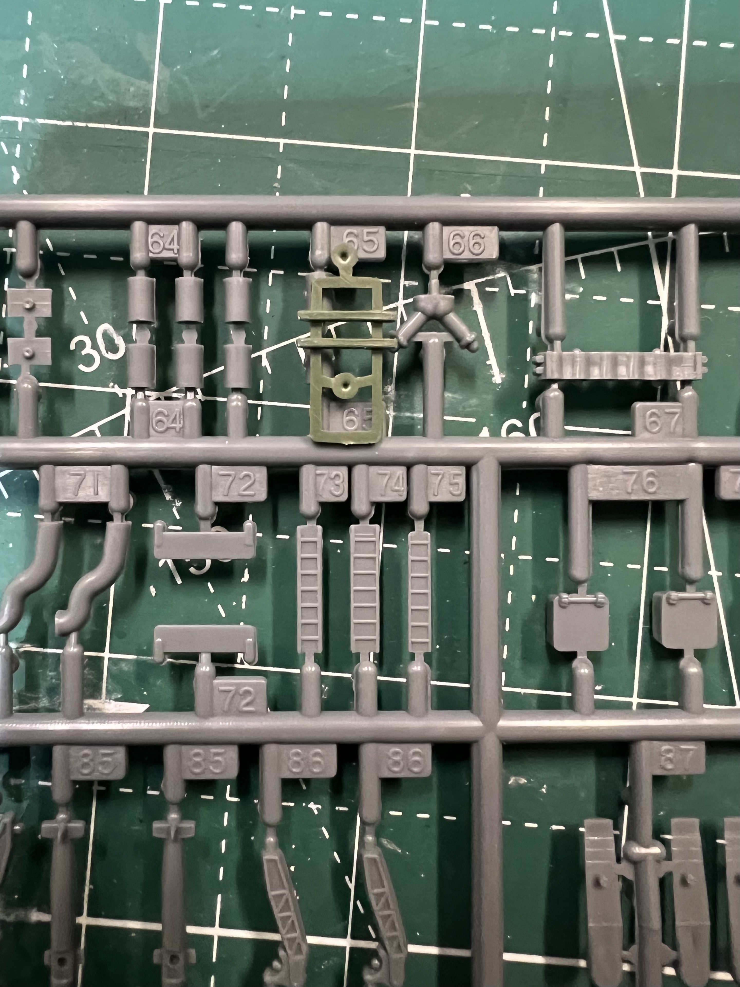

I checked quite a few kits that I have here and one of them, which is not a donor to this (as far as I know), is the Nichimo 1:200 Shiranu. Part # 22 & 23 come darned close at 14 rungs, but they’re too tall. Then that kit has a couple other parts #’s 73, 74, and 75 which are similar, but don’t have enough “rungs.”
The 1/500 Ise I have is the 1980 #U-5009. Maybe we need to find an older one? The 1/200 Shiranu is a 1976 #U-2014, not that it makes a difference. And as far as I can see, I don’t see a 1/200 Ise anywhere on the intranets. It’s probably right in front of my face here somewhere… as usual. Haha! Or it’s an older version of the Ise, which I don’t have on hand.
But as far as I can see with the actual Falcon parts we’re looking for, all those parts are shorter than the HP 0/400 piece. And the closest ones I show here are taller than the 0/400 piece.
Ise part # 48, back side on sprue. The part has a bend in it:
And the parts I see in the Shiranu kit: especially #22 and 23, but they are taller than the HP 0/400 piece and don’t have enough “rungs” on them. Plus 73,74, and 75 in the kit, but none of these are right either.

I think I found the missing radar dish leg pieces:
screenshot-2023-04-22-092409-jpg.1693776

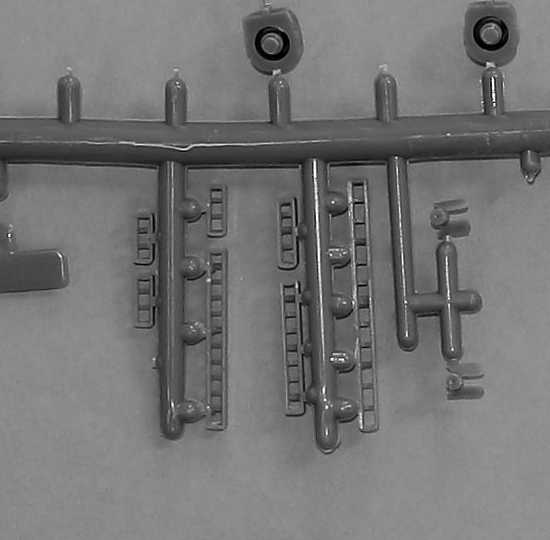

These four guys must come from the original vintage Nichimo 1/500 Ise ship, and not the new/reboxed one that is also boxed as the Hyuga:
You want the kit on bottom, not the one on top.
The instructions for the vintage kit look like this:
and if you look closely, you'll notice that in a separate bag you get a different set of microgreeblies (on separate black sprue, not grey) than what you get in the modern boxings:
I'm fairly confident that the 4 pieces you're looking for are "2 tall" and "2 short" pieces from Parts #122.
And of course, I say "fairly confident" because my kit came with everything EXCEPT these pieces, so I don't have them to photograph and compare and count 17 ladder rungs on, but I know they are in the black sprue separate baggie by comparison to the modern kit, and because part #50 was the mystery greeblie that evaded me for years on the Y-Wing wing subassembly. And they look to be around the right size, in comparison with part #50 which is only about 4.5mm tall.
Anyway, that's my theory. Anyone who's built one want to confirm or deny?
Thanks so much for the effort. Hopefully this is it. I'm thinking so, as this kit is mentioned on several different maps from different builders.
Hopefully someone will have a pic.
