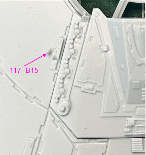

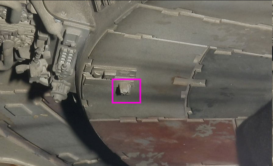

So one last comment/question on the lower gun platform and I'll hopefully leave it be :)
On the Bandai kit, there's a 'spikey-bit' just to the port of the actual gun mount. It's sort-of-kinda visible on the photo references of the filming model, but there are not a lot of good shots of the lower platform. Anyway, as near as I can tell, that part is the Fujimi M36 Jackson, part B15.
[edit] - Also this assumes Bandai got it right and this wasn't an ESB add on. I've found quite a lot of extra, missing, and incorrectly sized parts on that kit, so it could be just a Bandai kit thing.
