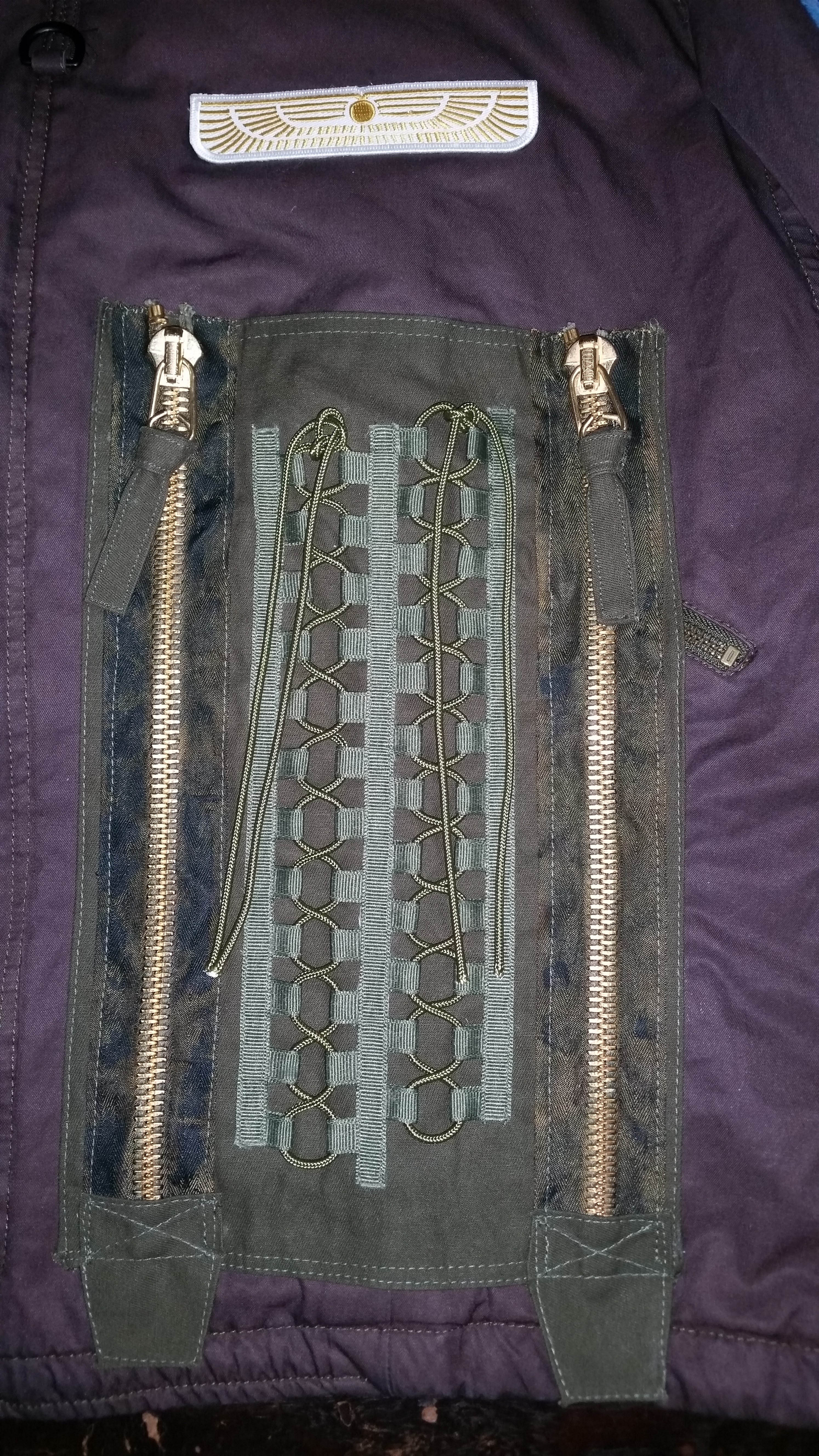

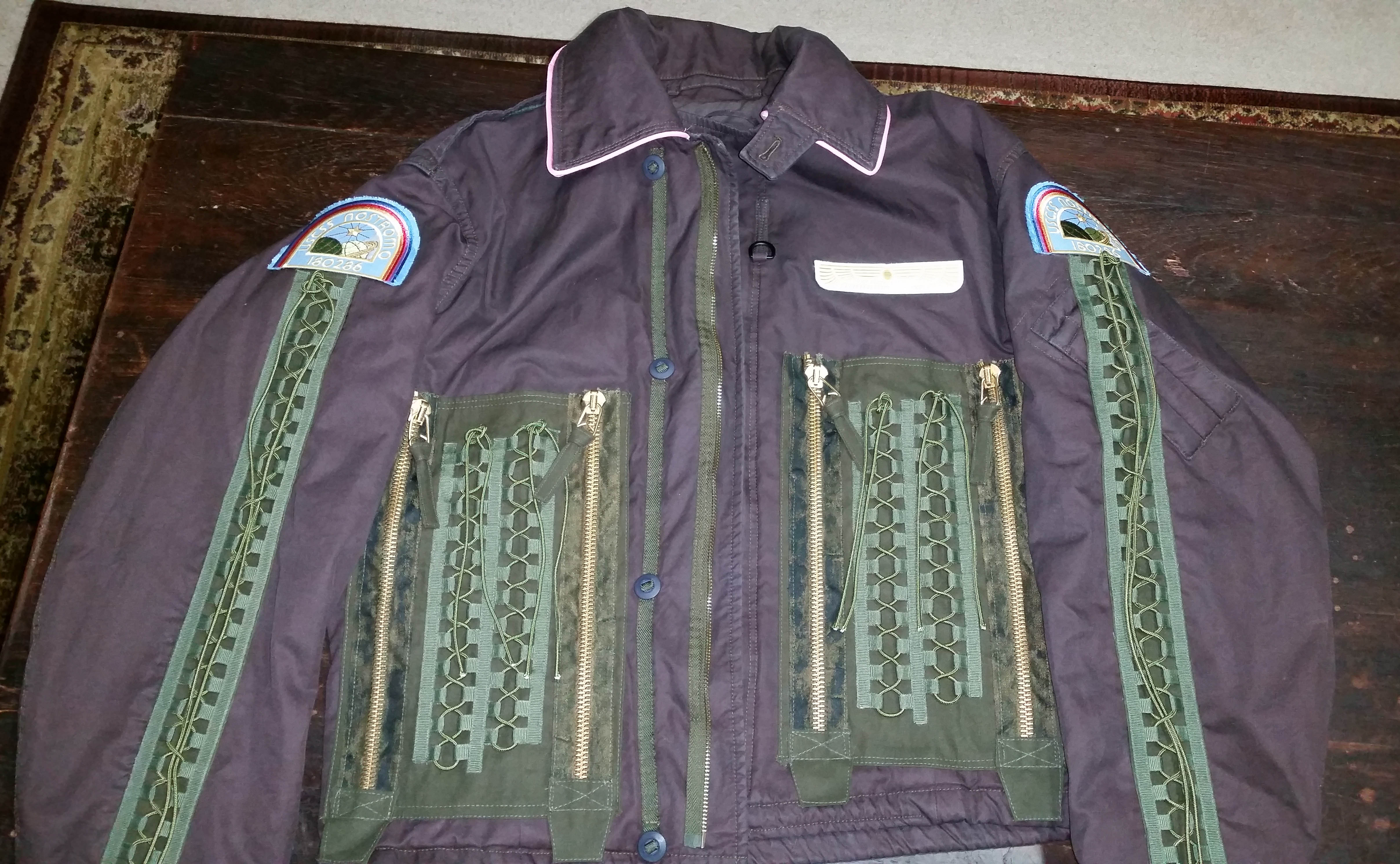

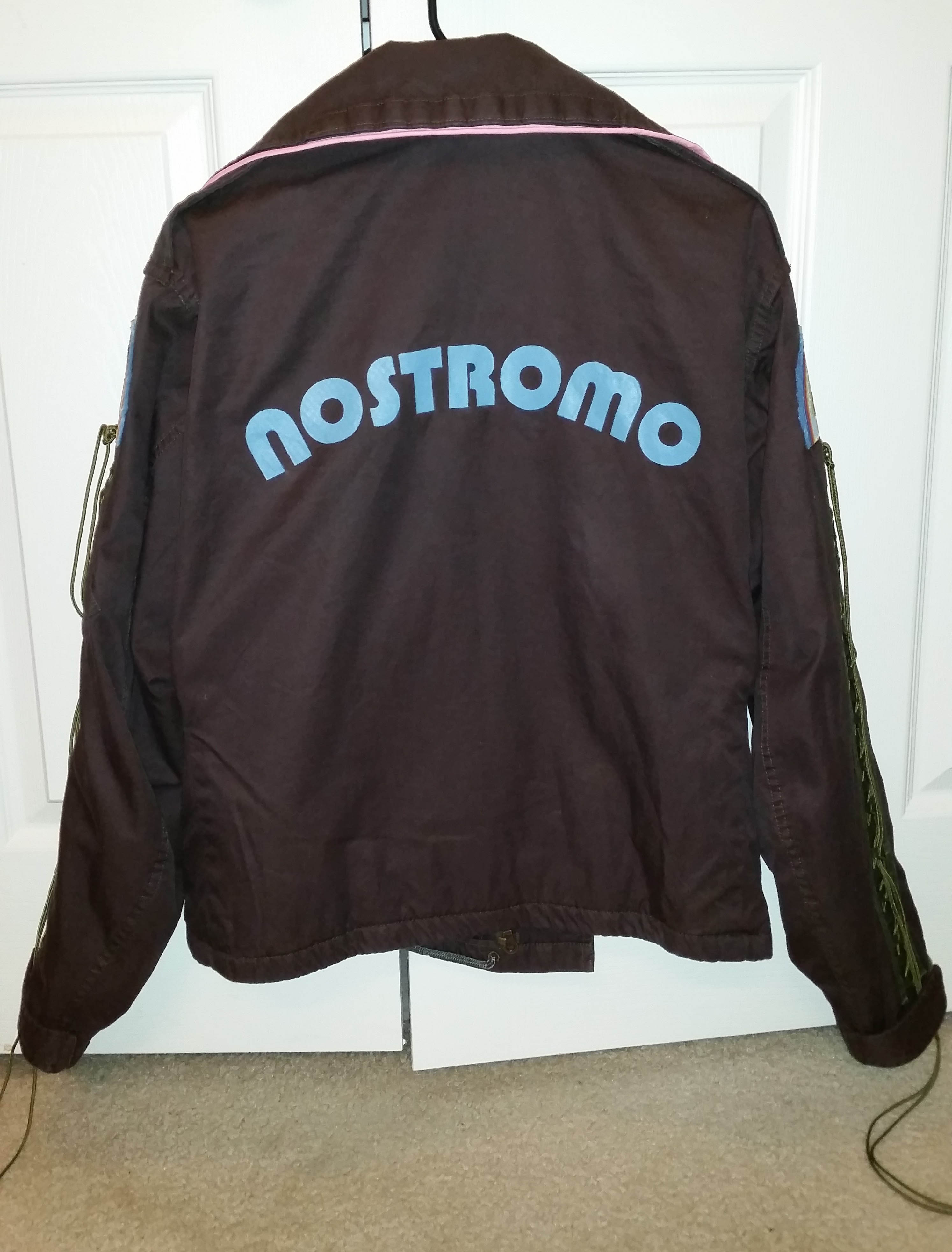

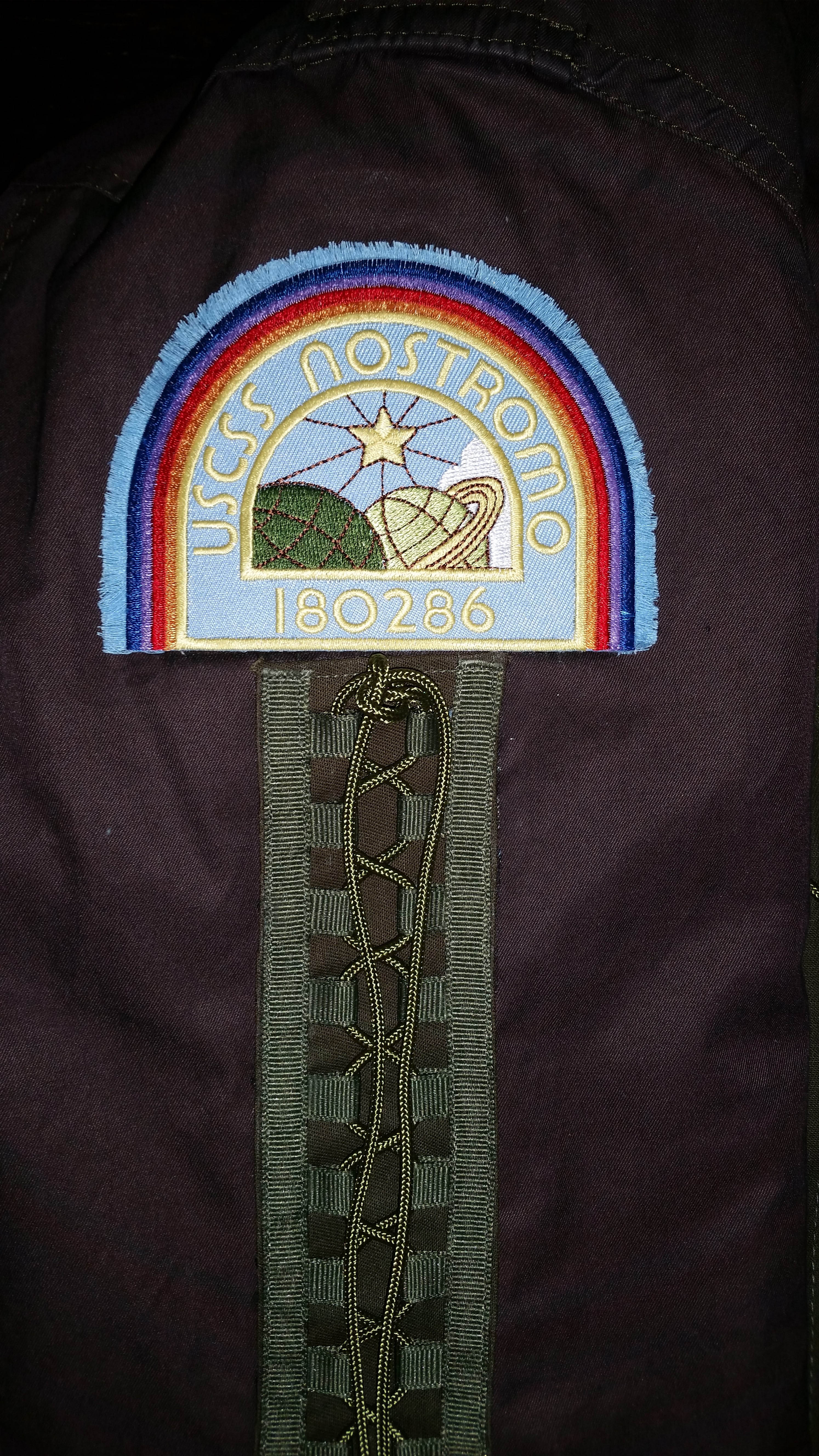

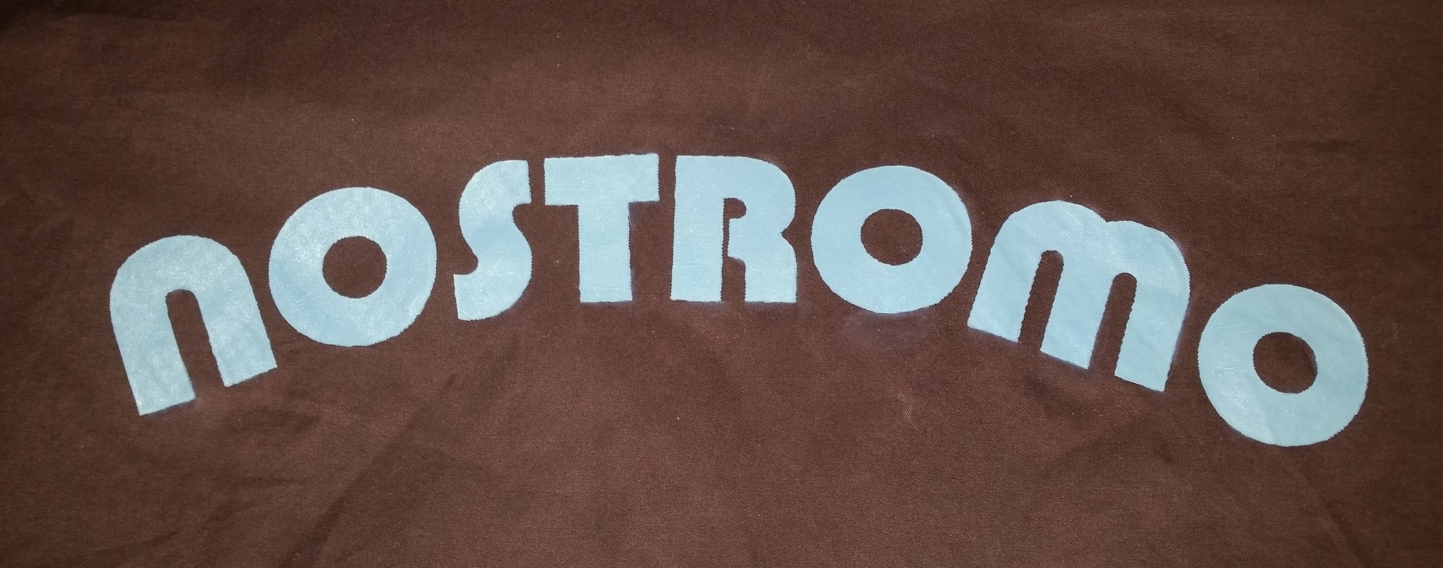

Here are some pics of my finished jacket. It was a little more challenging than I expected, but I'm satisfied with the results.
Special thanks to Banzai88 for the stencil. I used acrylic paint, and ended up with a lot of bleed out (due to lack of experience, I'm sure), but I was able to clean it up nicely.

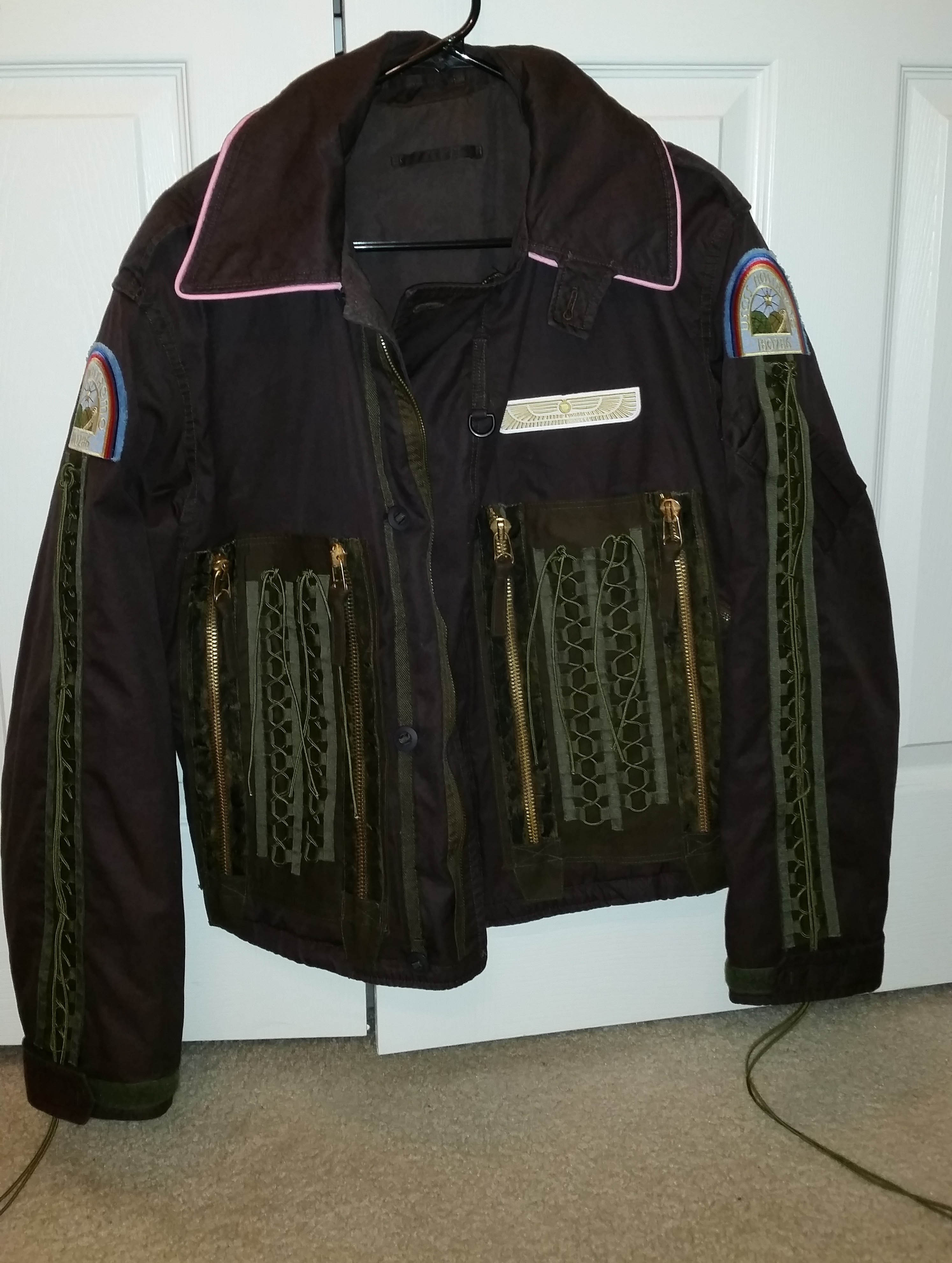

Johnhenryc, that colour is really good. I tried to dye my Mk3 four times but I'm still along way off! What's your secret?
sliuman - My jacket, I presume like most, was dark green to start. I dyed it 4 times also. :p I used Rit dye, and I started by experimenting with a small amount of dye on patches of fabric. I thought I had it with 2 parts brown, 1 part navy blue and 1 part light gray. But that didn't translate when I went up to 6 gallons of water for the whole jacket, apparently, and it came out too brown. So then I re-dyed it with just blue and gray, but didn't use enough dye, I guess, because it didn't change. I tried again with more dye (gray only), and it barely changed. Then I did one more time with a lot more dye (blue and gray), and it finally turned this color. The first few dyes were using the powder and the last was using liquid - not sure if that matters. My guess is that I should have started with closer to 1/3 of each instead of 1/2 brown. I'm not sure if that info is helpful or not, depending on where you are with the color at this point.
If I were to start over, I would use 6 gallons of water with equal parts cocoa brown, navy blue and light gray (about 2/3 of a bottle of liquid dye each). Of course, that's not what I did, so I can't say what that would actually produce.

I left the hood and flap intact as I like the details like that. I stopped the piping at the tab per the film. Since these are vintage jacket to one degree or another, they've been wash a lot already. Mine is the same fit after many washings.
Wayne, I cut off the beaver tail specifically so I could use it to test the dye, since it was not onscreen anyway. I also cut out the hood, but mainly because I could feel it bunched up against my back and, again, it didn't take away from the screen accuracy in terms of how it looks. Also since I already cut off the tail, the "unseen" authenticity became less important to me. If I had already felt comfortable with the dyeing process, I probably would have left the tail and then also the hood by default. But this was the first time I ever dyed anything, and I didn't want to accidentally ruin the whole coat.
As for the piping, I had assumed it went all the way across, because that just makes more sense from a design perspective, and I uncharacteristically didn't double-check that detail - so I just continued it over across the tab. I think that is the best way if you want it to go all the way (rather than interrupting it at the tab). However, afterward, I did notice that it doesn't go past the tab on the on-screen jacket, so I'm considering chopping it off to be more screen accurate, and would probably recommend that route.
Mine did not shrink at all after 4 dye steps/washings, but I did use a low heat setting when drying it.

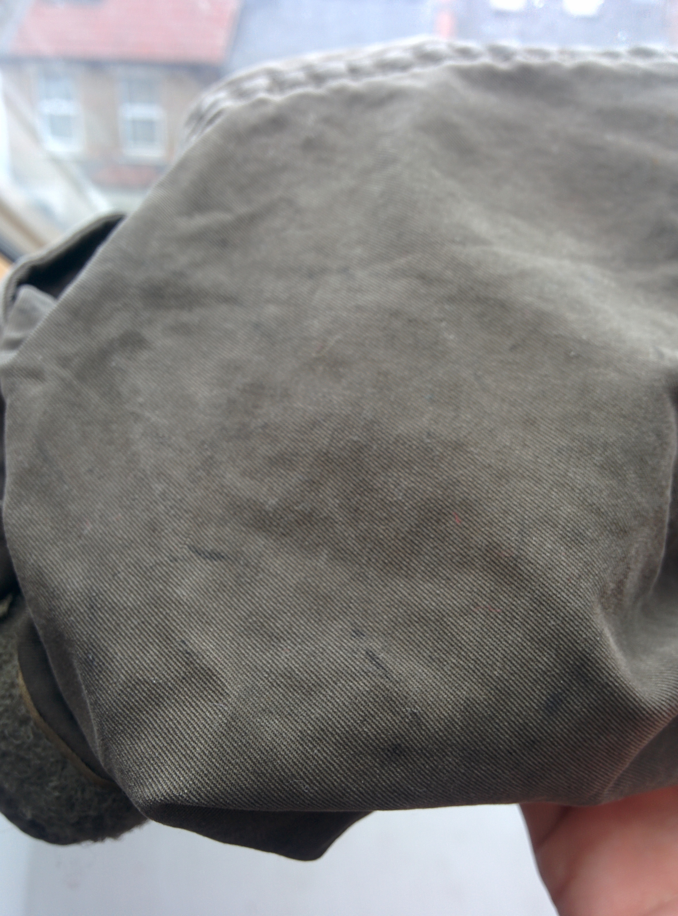

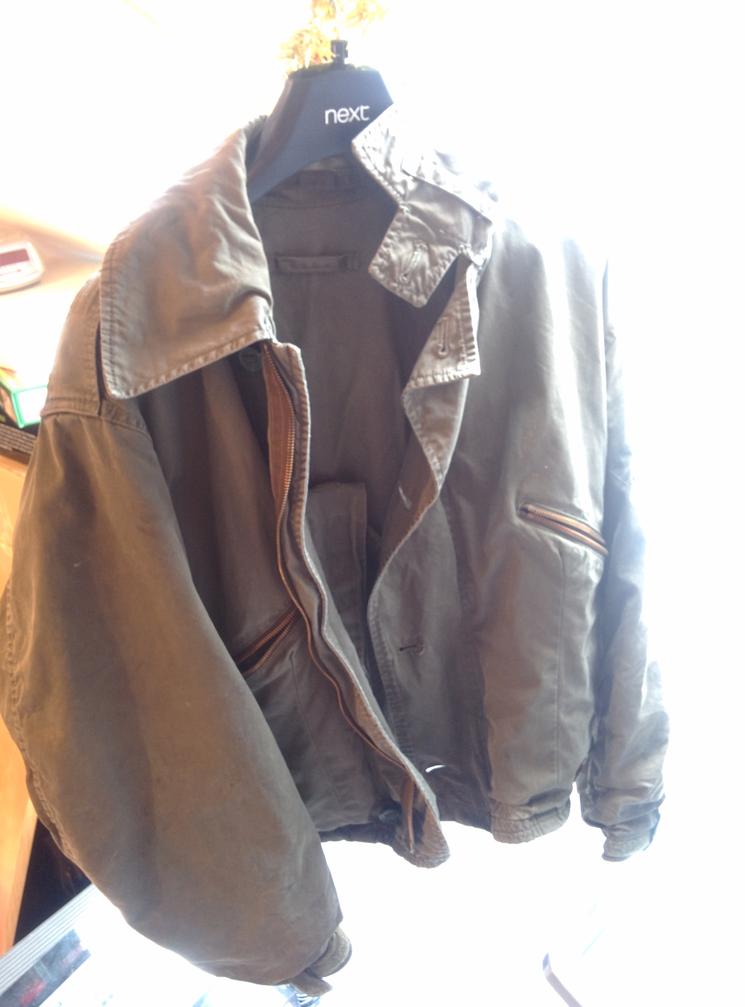

Ok, exams over (and not a care in the world 'till August...) Jacket arrived in one piece (With a tear on the sleeve, but it was on the eBay image so I can't complain that much...) It is the standard NATO green as far as I can tell, but it is fairly washed out (As you hopefully can see in the picture).
So now I embark on the dyeing process! Given the colour (its as accurate as I could get on my camera), what kind of proportions of grey to blue dye would you all recommend? And also (This probably is a silly question) should I stitch up the hole in the arm before or after dyeing, and if before, does the thread have to be a shade darker/lighter due to different amounts of penetration into the fabric?
