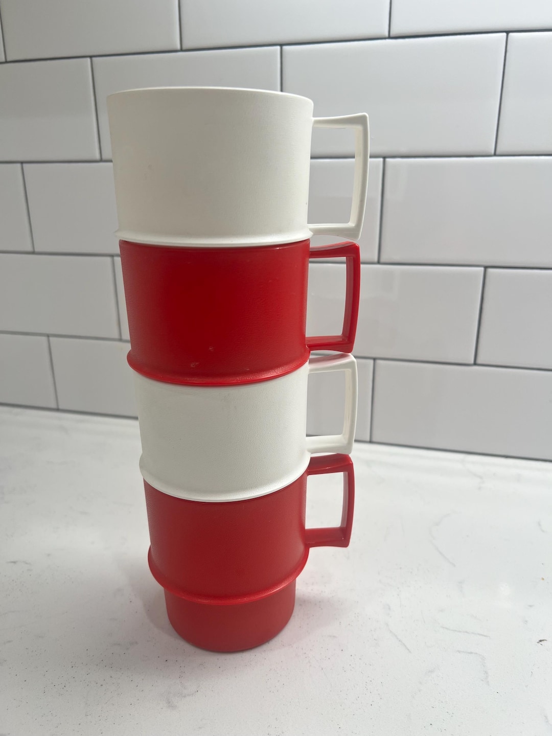

And do we think the cup holder is a custom shape?

I would fabricate the cupholder with a single plank. Use a hole saw to cut out the 10 openings. Split the plank down the center, offset the forward edge above the backward edge by the height of the middle(?) of the cup handle (measure tabletop to desired height on handle). Notch the front half to accept the cups' handles. Attach the two halves with PVC pipe cut to the correct shape (low in back higher in front) to cradle each cup. Put small separators and facing trim between the "tubes".
The view with the cup holder on the left doesn’t have the coffee cups above. Different area I guess.
The coffee cup holder I think layers of MDF could do nicely and capture all the details like the chamfers. It’ll be heavy though… maybe hollowing out the lower layers to shed weight would help.
