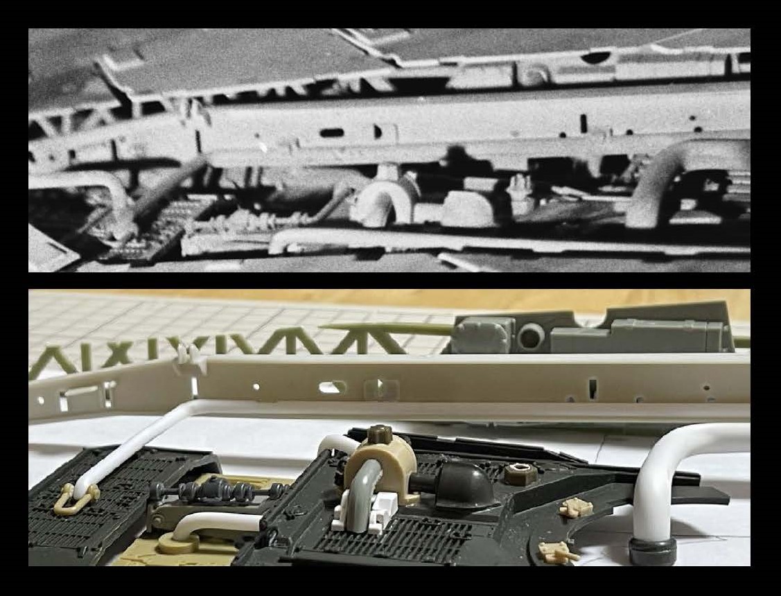

A quick question for those that may know. Did ILM use brass rod or plastic rod for their pipes? Using heated plastic rod, I'm struggling to get some of the pipes with more intricate bends, or bends that need to be in exact locations to go around corners. So I'm wondering how ILM did this with plastic? Or if they just used brass which is easier to control.
thanks
thanks
I "think" the technical answer is that they used both. Telescoping brass for Y-Wing guns, for instance, and possibly some Y-Wing pipes, but I think most of the other bent/curved pipes are melted plastic -- there are tricks for this, such as a coiled "tube bender" tool, or filling the pipe with sand before heating it, and others, that work fairly well to avoid kinks or bends that are "too" sharp.
Great, thanks.
The issue I'm running into is not the quality of bend, it's that the rod or tube ends up bending in the wrong place. It's always a mm or two in-front or behind where I actually need the bend to be. I just think if I used brass I could be more precise, but ILM likely used styrene, so I'm a bit torn on how to go about doing some of these complicated pipes.
Great, thanks.
They were free. It was possible to place and move the parts to fit the bent pipe. However, we are not allowed that freedom.
It's easy if there's only one place to bend, but it's quite difficult if there's two. And if it becomes three, it won't succeed anymore. Compromise is necessary to finish this work that will last forever.
If it's too long, how about cutting the straight part and fine-tuning it? It is much easier to erase the traces of connecting the pipe. ;)

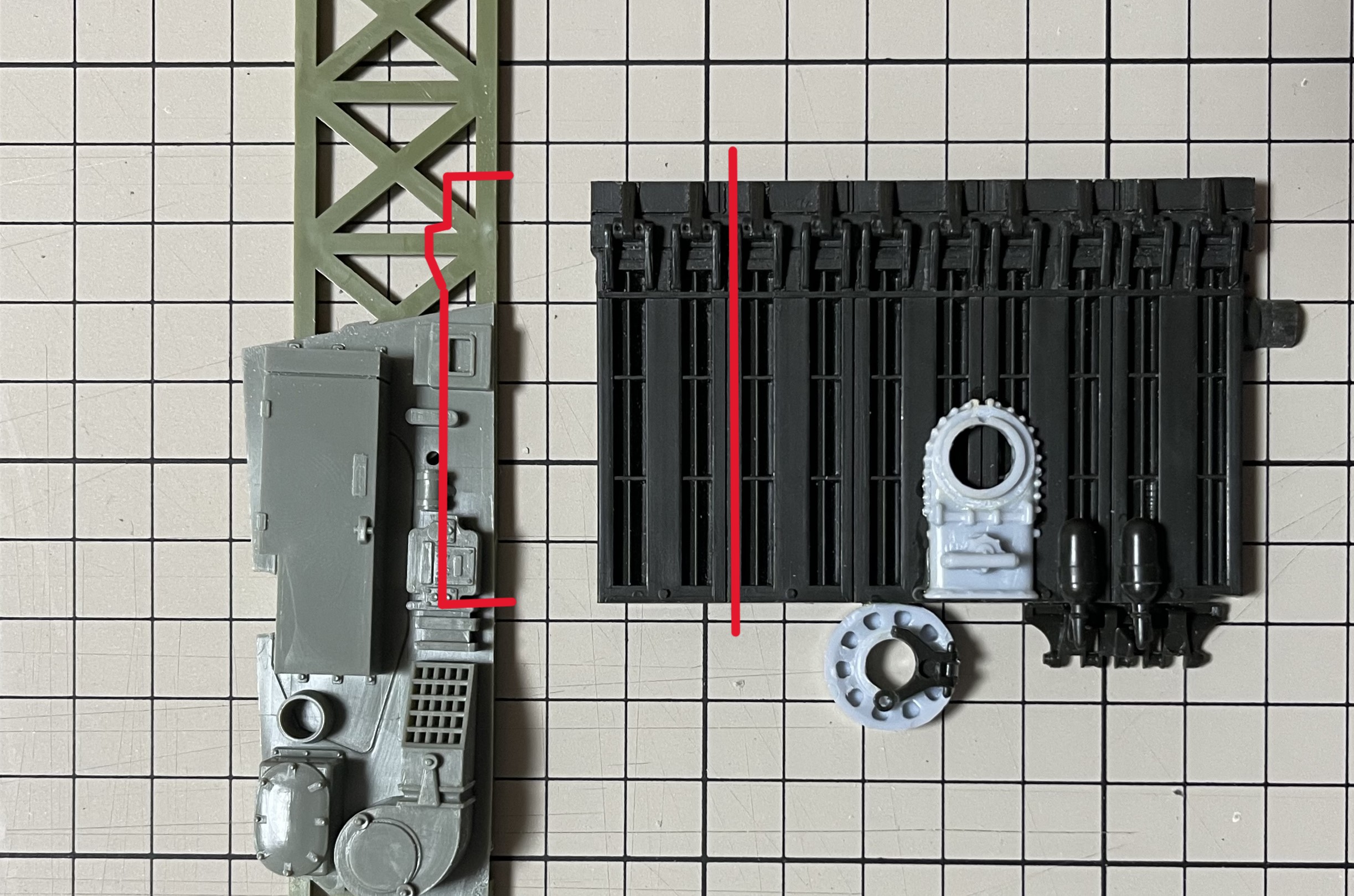

So, this is what I currently have for the back wall of the port lower mech pit.
When compared to the Bandai kit, you can see many changes. There are two parts found by Shamon. And the Hurricane wire harness no longer butts up against the large pipe. The horizontally positioned ME-109 gun doesn't strike me as the correct part but it does sort of match from certain angles.
On the far left, the large pipe no longer has that M577 console but rather just goes into the back wall. I don't know where Bandai got that detail from but I'm not convinced it was really there.
There are also a couple of items that are missing. Specifically the 'box' on the far right in the corner.
How do you think that sits within the pit?
A bit of a crude illustration but;
Option A. Do you think it sits directly on top of the Centurion deck (H6) and is only glued to the pit floor via the little pegs?
Option B. Or do you think there's a notch cut out to accommodate the Centurion deck (H6) and the rest sits flush on the pit floor?
Option C. A third way I've not thought of?
This is my existing part, just flipped upside down. I don't believe that the flat side of the girders face inboard though. This is a rough placement of Option A above.
Something else to note with Option A, is that the gap between the top of the girder and the top of the Centurion side panel (J8) is correct. But to do that, the girder is held to the pit floor with just two or three little pegs.
I'm leaning slightly towards option B. Both forward and rear 'gaps' around on J8 are there as well as there's no visible girder behind the semi-circular notch in it either. Where as there is a girder visible in that notch if you go with Option A.
I'm curious to know what people think.

It would certainly seem easier to cut the Centurion part than the bridge although, if the ILM guys are gluing bits into the pit well, more or less at random, would they have started with the bridge part? It seems to me they would have started with the Centurion deck, and if so, why cut it?
Maybe they just placed various bits into the well, figured out what they were going for, and then cut the parts as required.
You're very likely correct, I'm just trying to understand the thought process that was involved here in creating the original.
