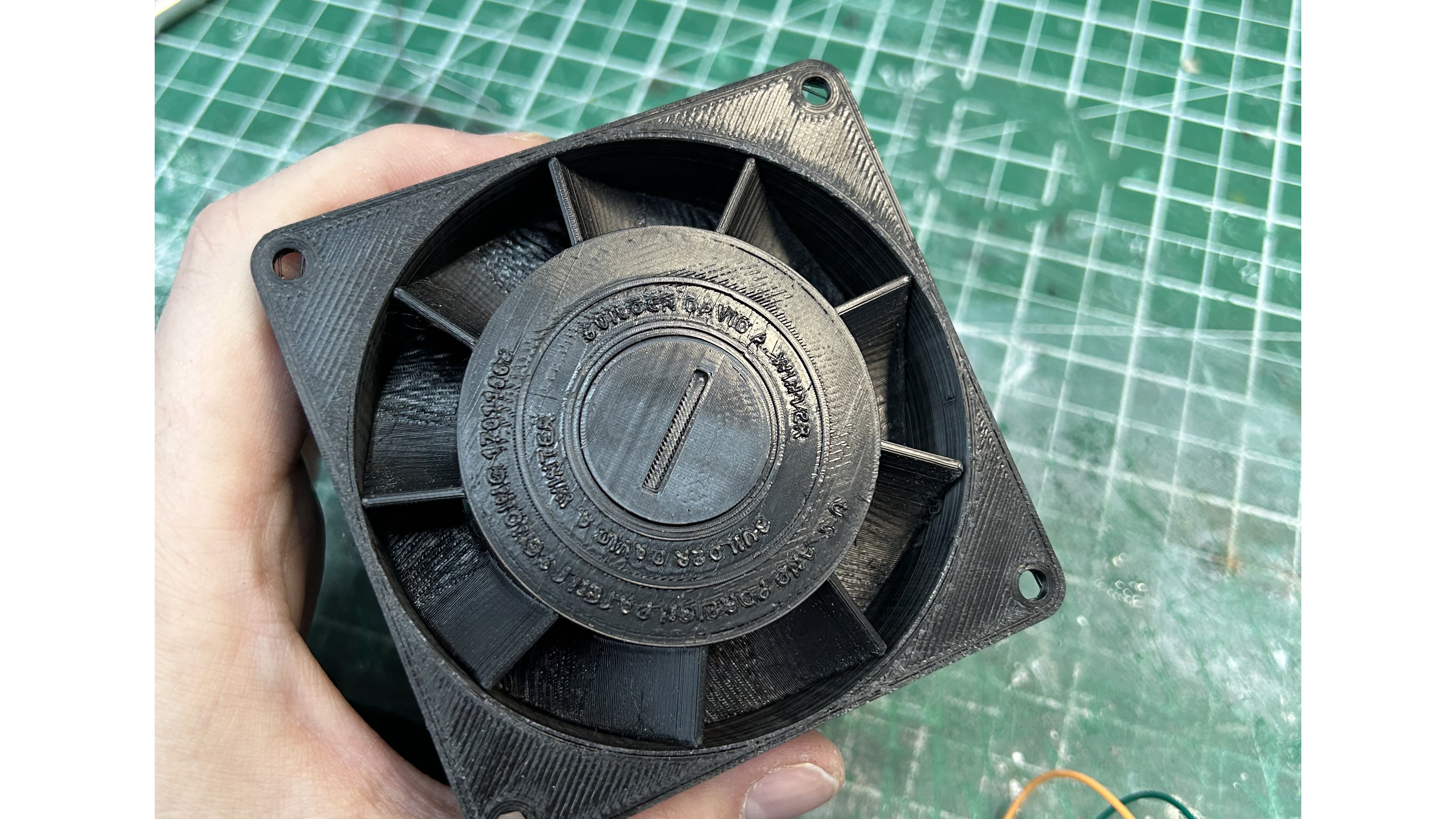

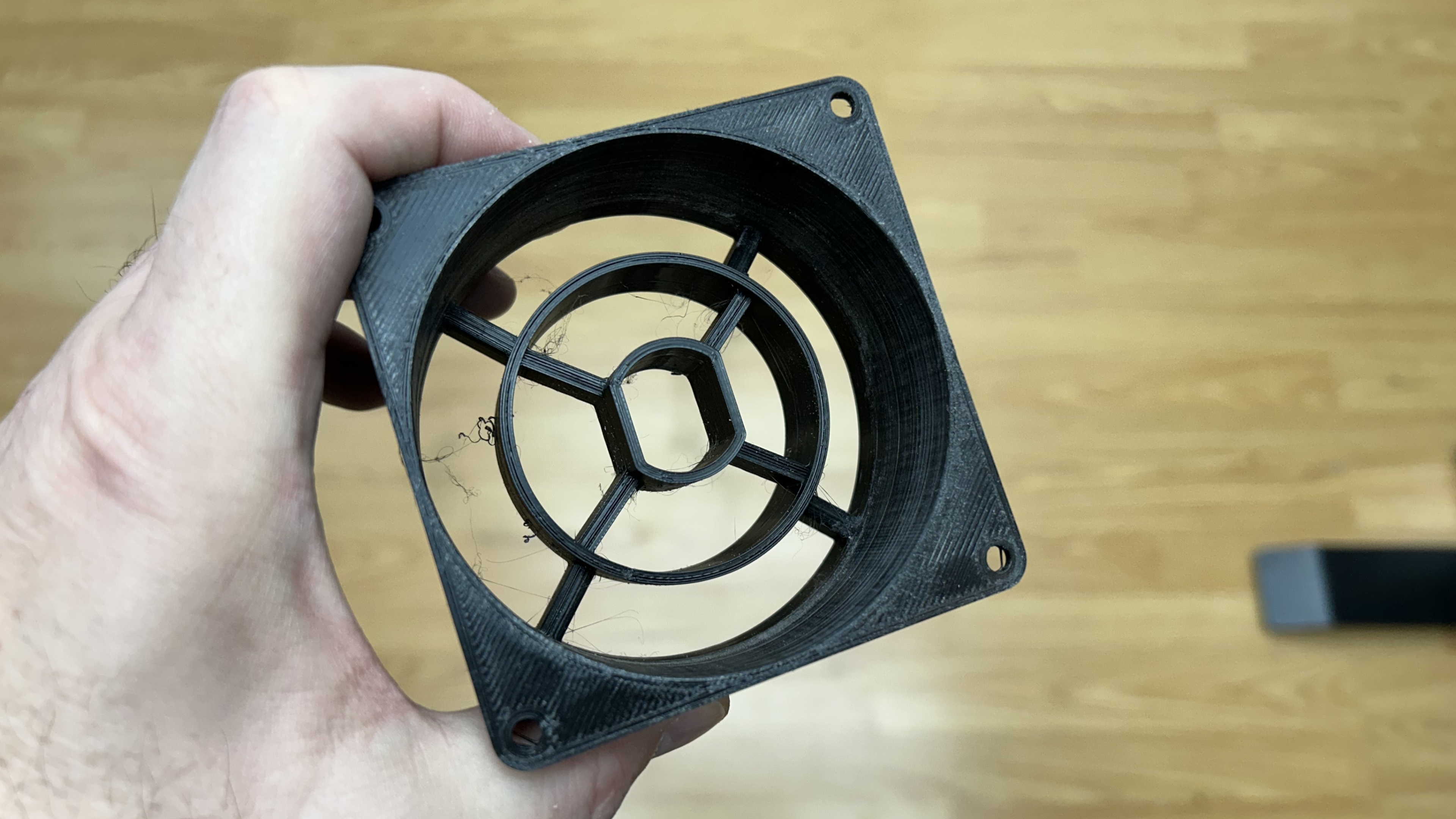

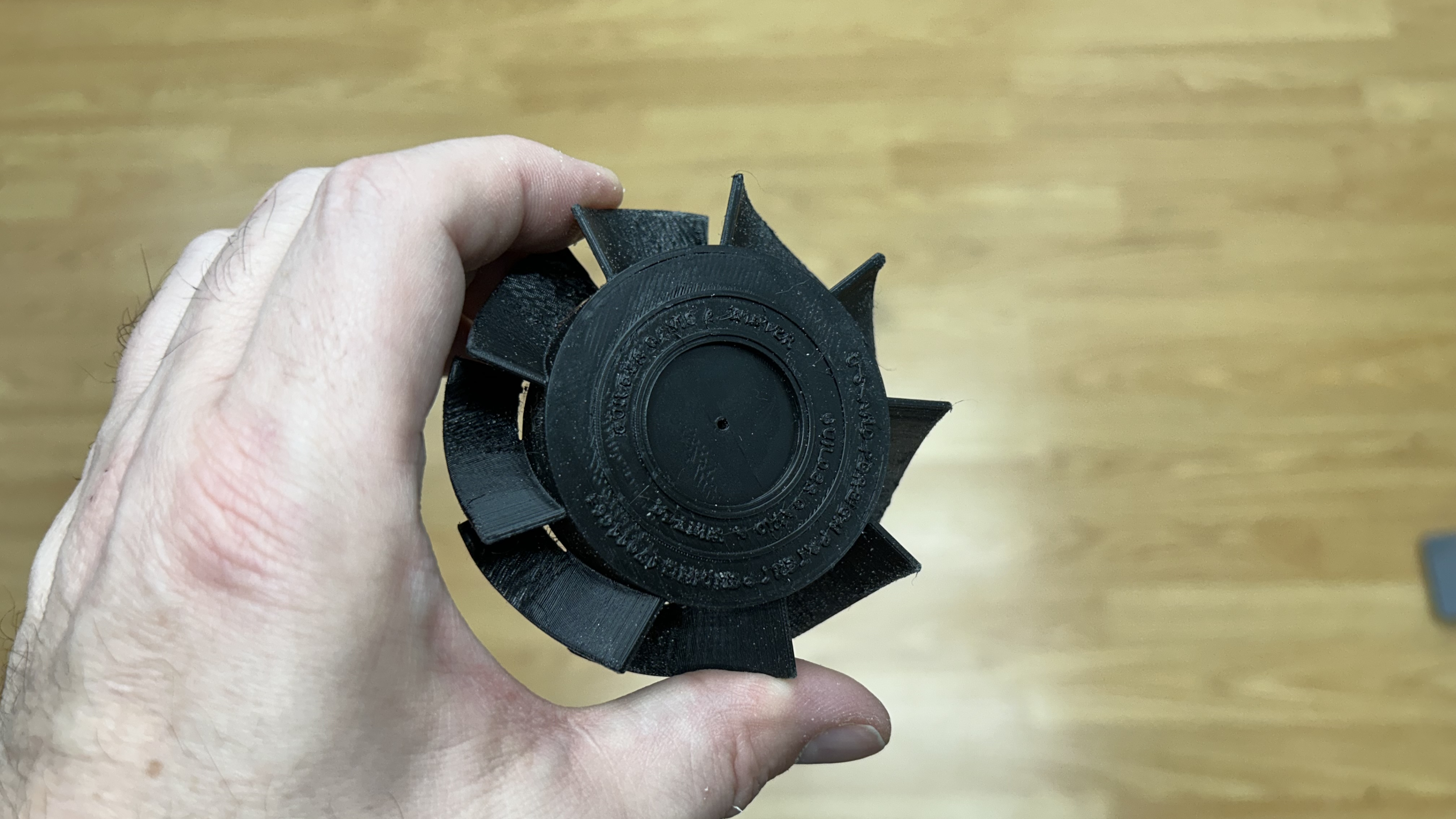

In the mean time, I printed out a low resolution prototype to check my concept. This is printed at 0.21 layer height with a 0.4mm nozzle. It gives me accurate(-ish) dimensions, but doesn't look very pretty. 0.1mm layers with a 0.2mm nozzle, and slightly slower speed, would improve the looks.
That said, it does function as I intended, and that was the point of this exercise. It also pushes air, which is sort of neat :lol:
Video here -> 3D Printed Muffin Fan.

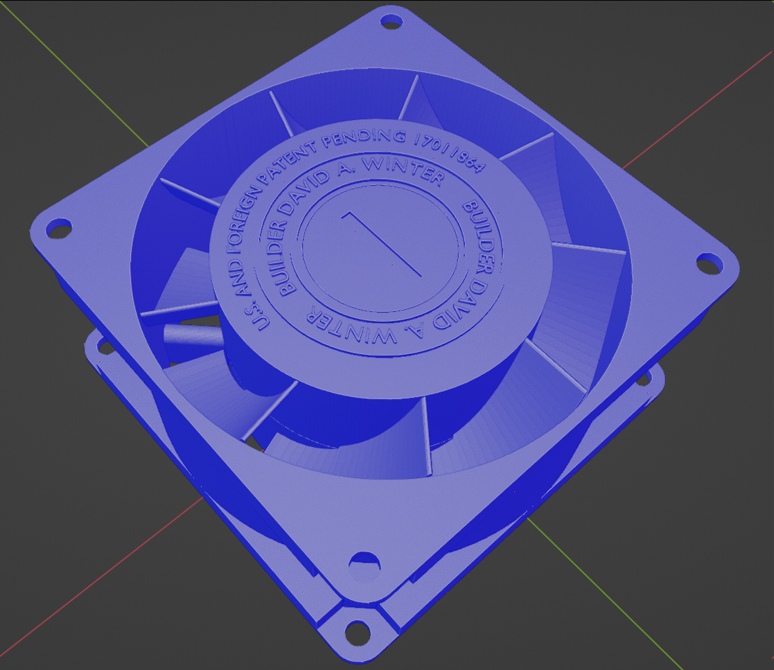

So a thing I made.
The 'muffin fan' from under the engine deck. Practically nothing about this is correct, except perhaps the fan blade shape.
As I do not have the real thing, and the only photos of the real thing I have are obscured by Koolshade, almost all of this is guess work.
  • I have no idea what the exact dimensions are, so I've tried to go from photos and dimensions of similar fans.
  • I am 99% sure the outer ring of text is a US Patent number, but I don't know the number, so I made one up.
  • I have no idea what the inner ring of text is, so I made it up.
  • In at least one, small, fuzzy, photo of the purported real thing, the top of the hub sort-of-kinda looks like it is slightly rounded, but all other images seem to show it perfectly flat. So I went with flat.
  • Also in that one lone photo, the corners of the outer casing are inset about 5mm. However you can't see that inset in any of the Falcon photos. (at least not in ones I have). So I went with completely flat front and back sides of the fan.

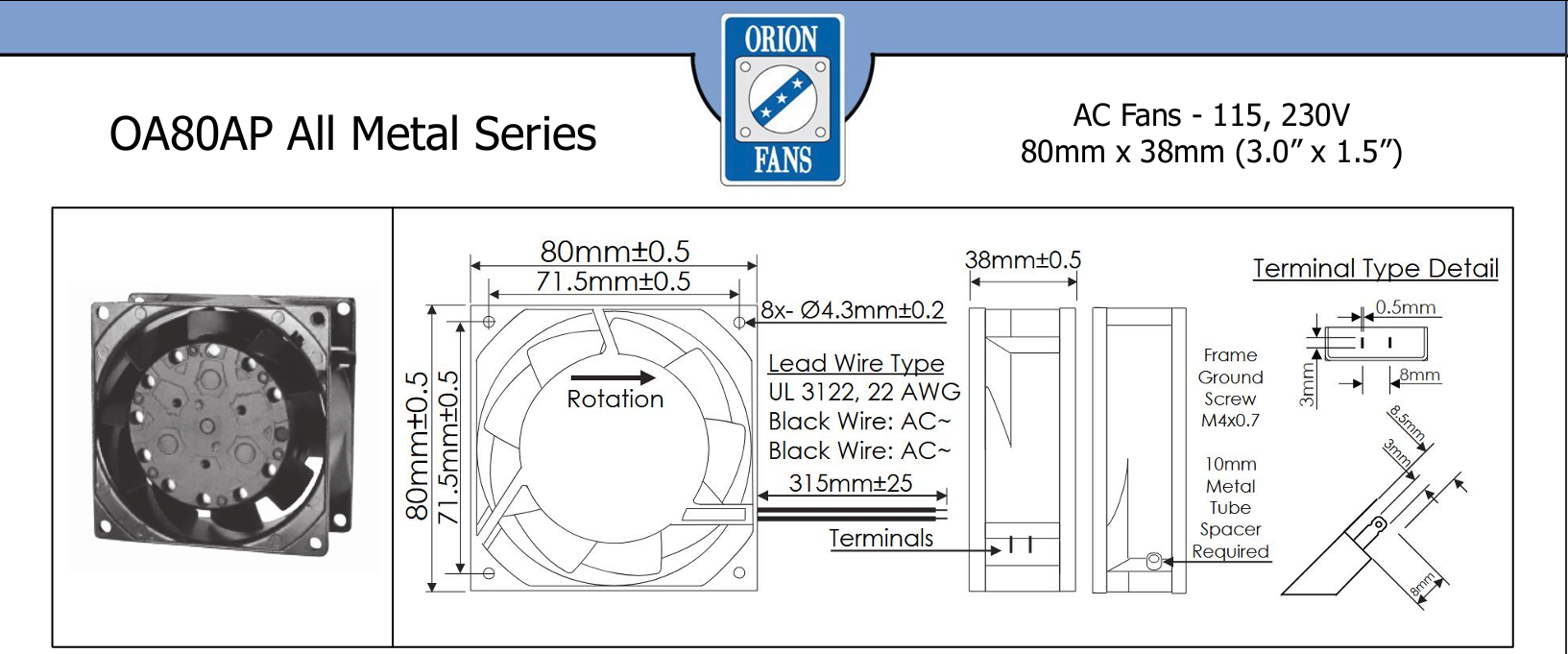

  • The blade shape came from the only other fan I could find that was the correct size, had close to the correct hub diameter, but more importantly, the correct number of blades; The Orion OA80AP series of metal fans used in aircraft avionics. I then took the concepts of that fan's blades and tweaked them until they looked sorta-kinda like the Falcon's fan blades. 9 blade muffin fans seem like a rare breed.

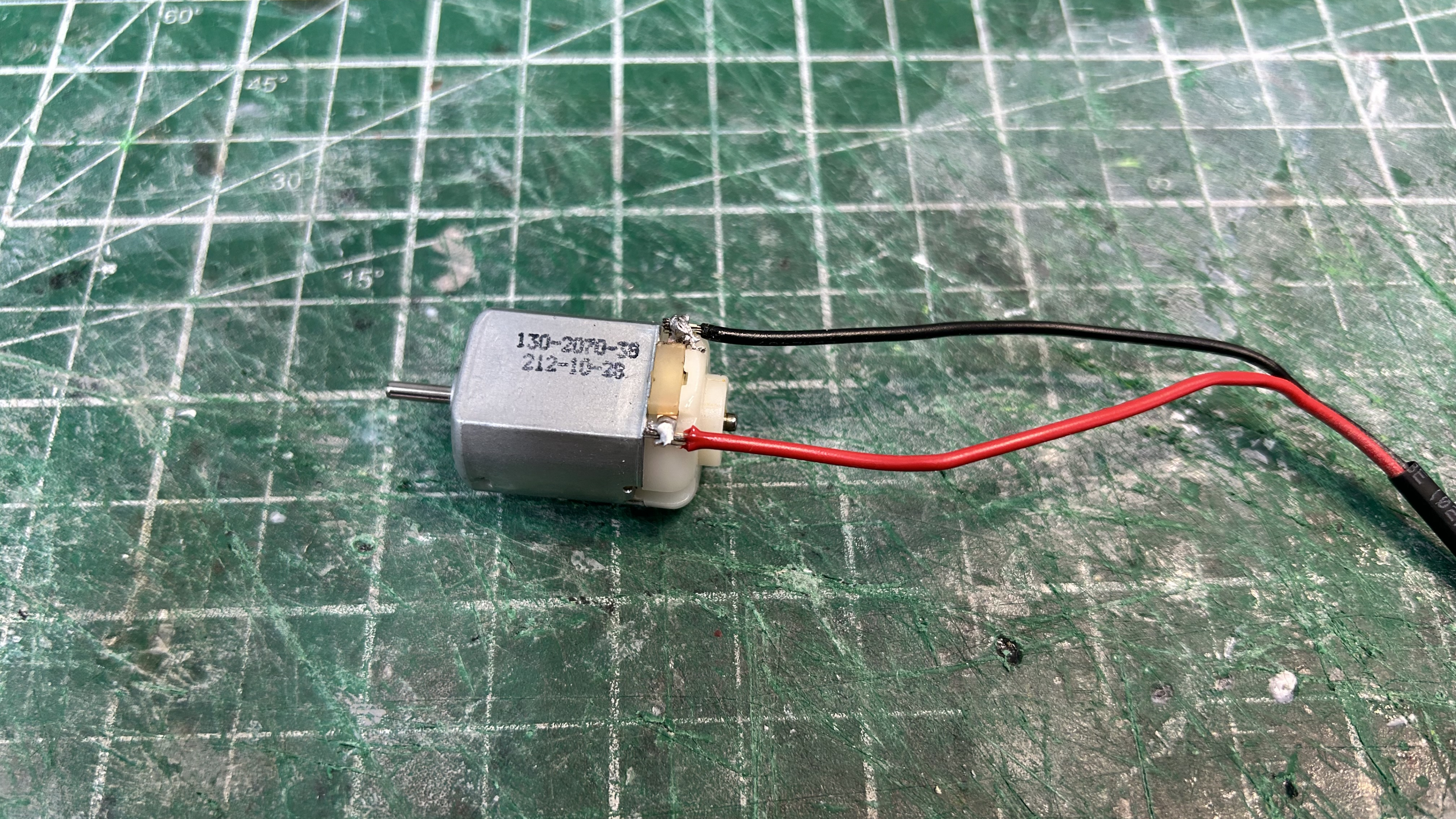

  • I wanted my fan to be functional so it was designed around the small Type 130 6VDC motor. With 3VDC it'll spin around 1000rpm, which is far, far less than what the real fans would do, but mine isn't real, and that speed will still sell the point.
If I ever find out what the text really says, it'll take me about 30 seconds to update the model. And if any of my dimensional guesses are close, I should be able to swap these fake ones out with real ones if I ever find any. I really do hate using 'fake s**t' on my build, but it sort of is what it is at the moment.

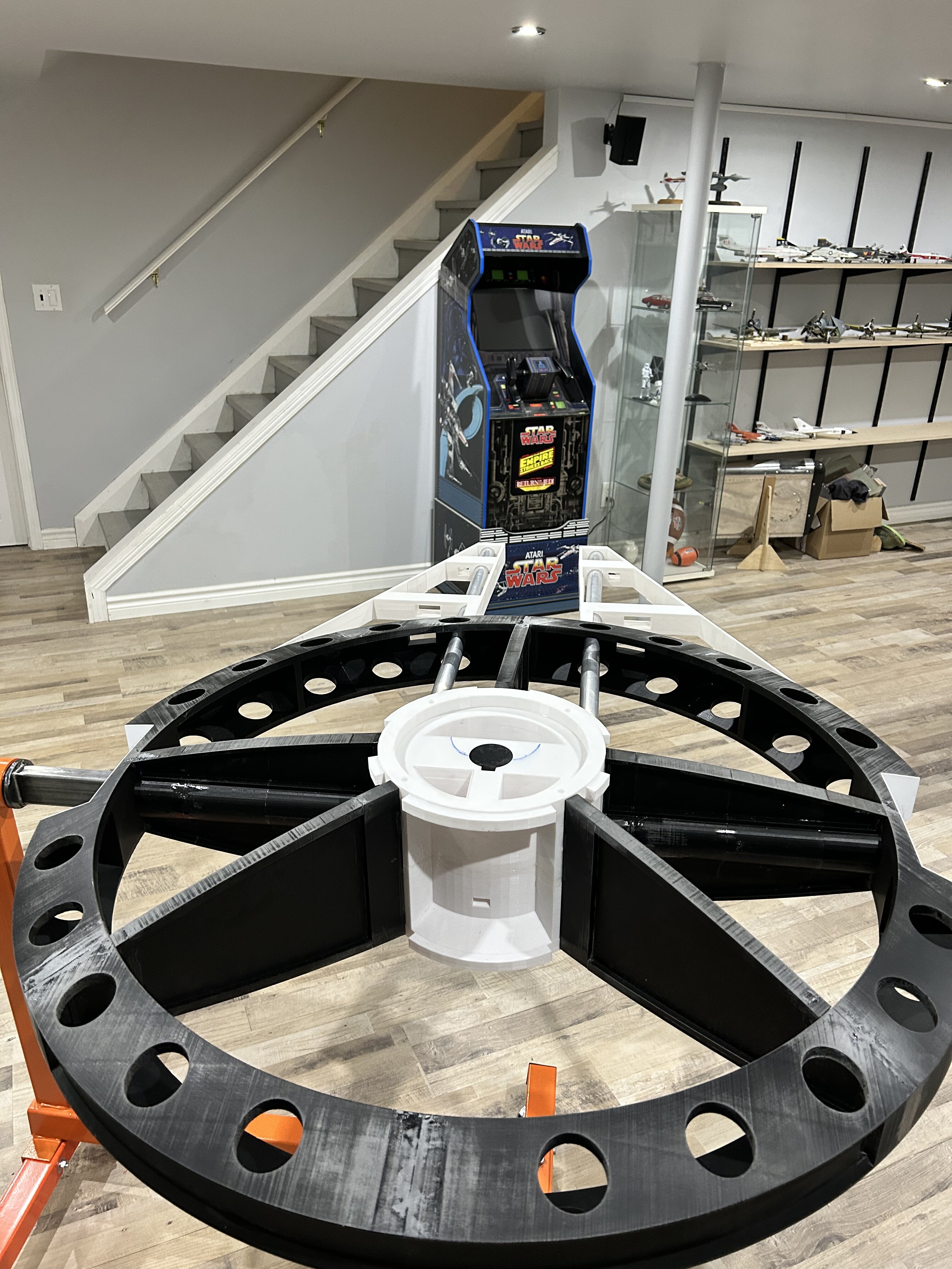

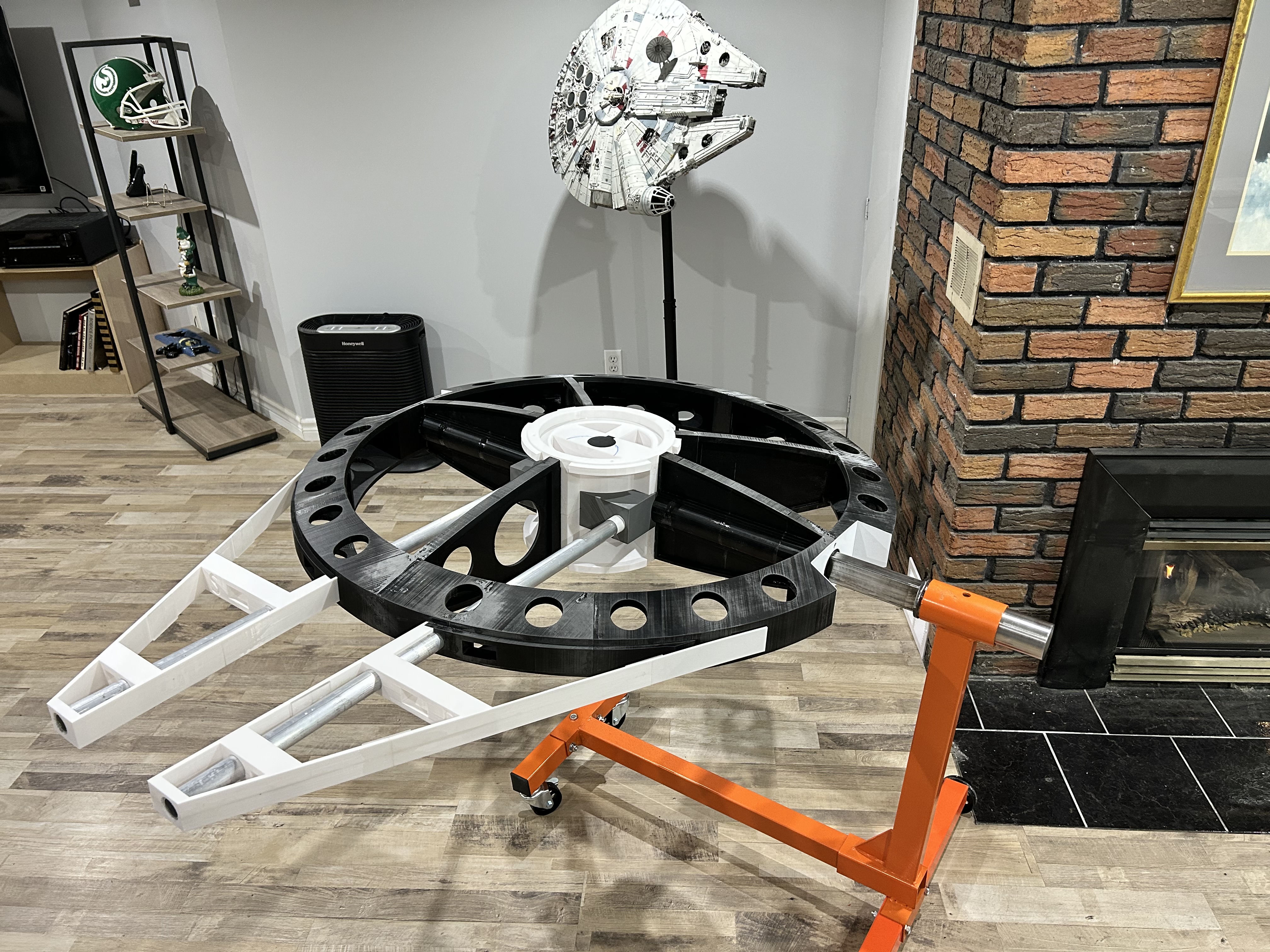

Small milestone tonight. I have the new lateral stand mount installed. I designed it myself, but had it manufactured by a metal working shop just outside of town. They can weld. I can not. They did a fantastic job. Also the Mandible sidewalls and supports are complete.
My orange engine stand is a bit of a dud. I'll have to get a new one. It's a cheap Vevor stand and it was welded together unaligned. So only 3 of the 4 casters touch the floor.

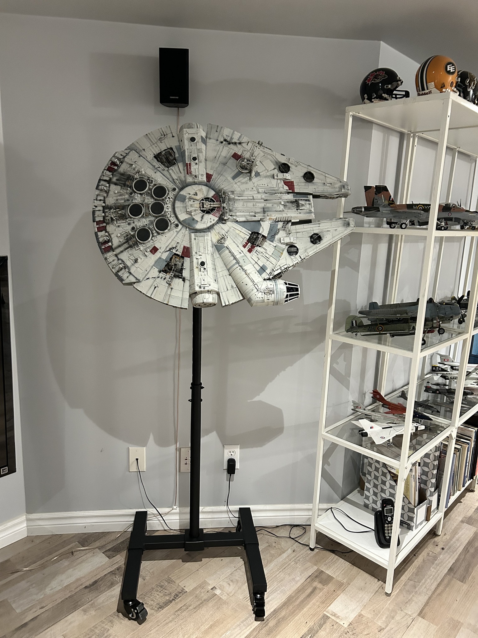

Thanks everyone for any suggestions. For kicks and giggles, this is my 32" build. It's mounted on a rolling TV stand so I can show people the bottom and move it out of the way if needed.
Hi there David, just joined the forum and seen this picture, can I ask is it 3d Printed and if so where did you get the files from, i've been after making my own for a while now and this is by far one of the better ones at this size i've seen.
Thanks,
That's not 3D printed. It's a corrected version of the Deagostini kit.

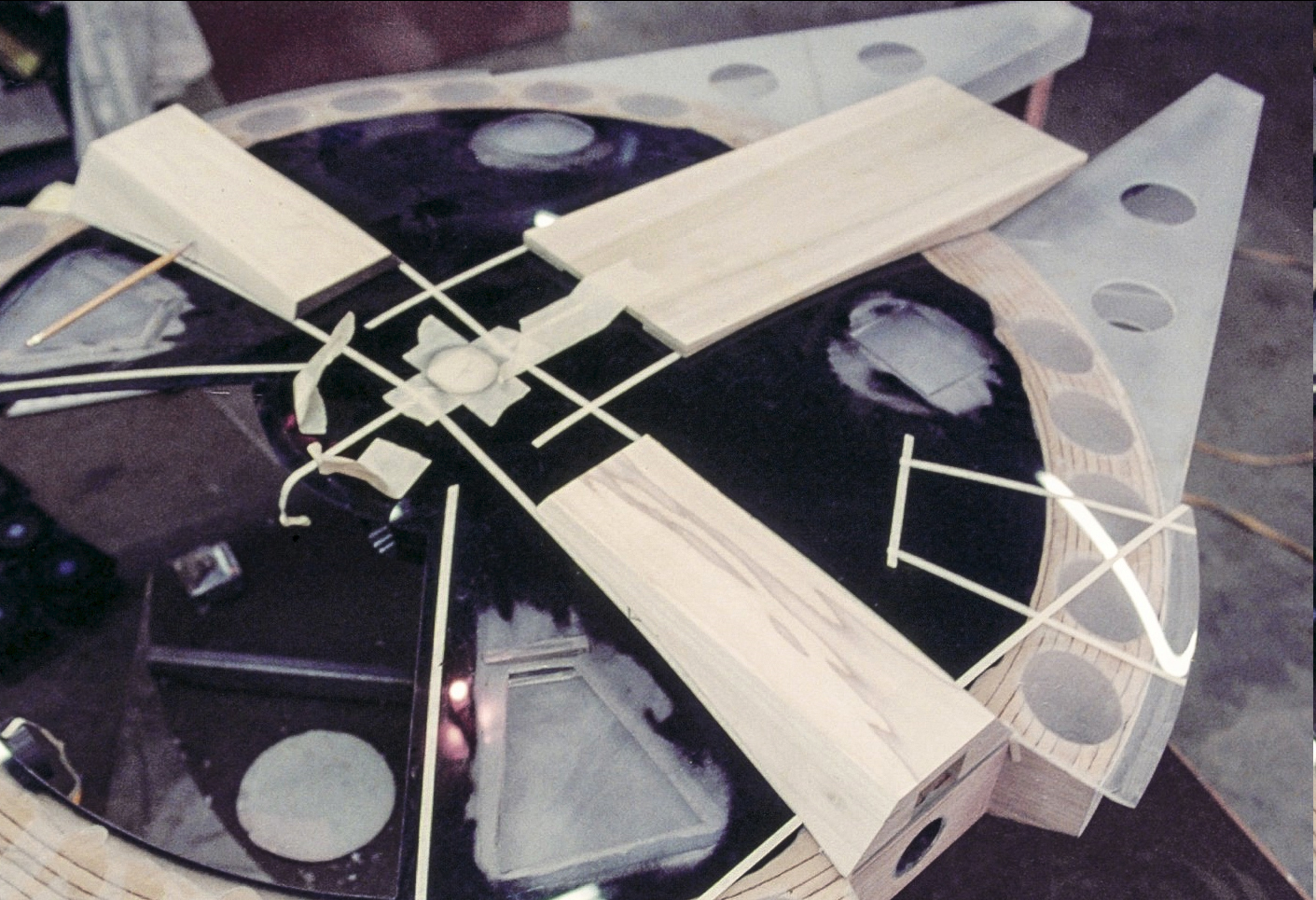

A quick question regarding the wood used on the original filming model.
The wood used for the walk ways and mandible boxes, do we know what wood that was? Bass wood I'm assuming, something with little or no grain. And also, were these covered in sheet styrene before painting? Or how was this sealed?
Any ideas?
thanks
Any ideas?
thanks
You are correct: Bass wood, covered in styrene. No exposed wood anywhere on the model.
