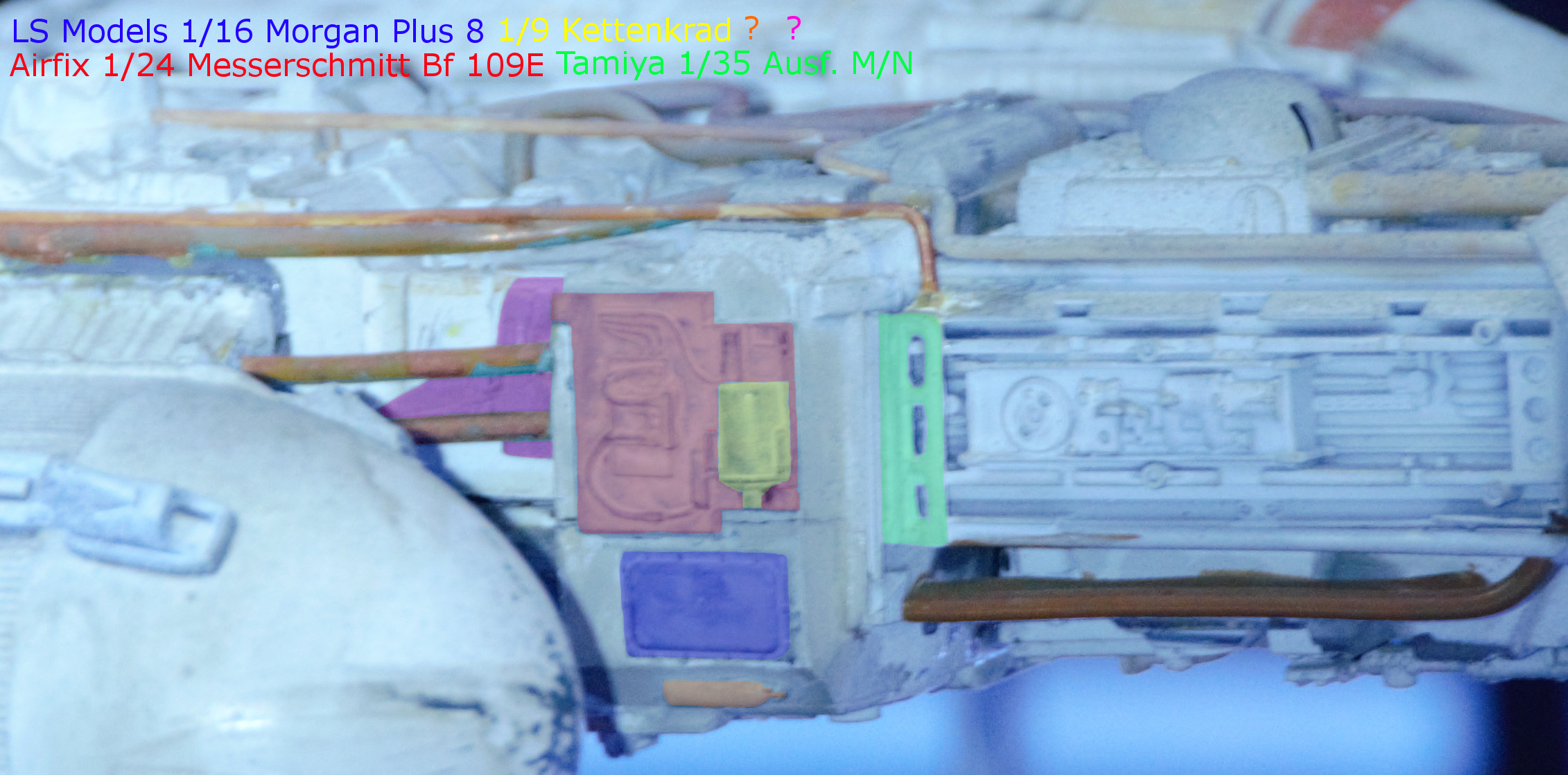

Hey Julien,I trimmed mine,but compared to the rectangle Harrow part in the ref pictures mine looks a little long?It even looks shorter in the 5' master picture you posted.Maybe I'm just seeing things:)
Dave
Re: Y-Wing Parts Map for the "Green Leader" Project

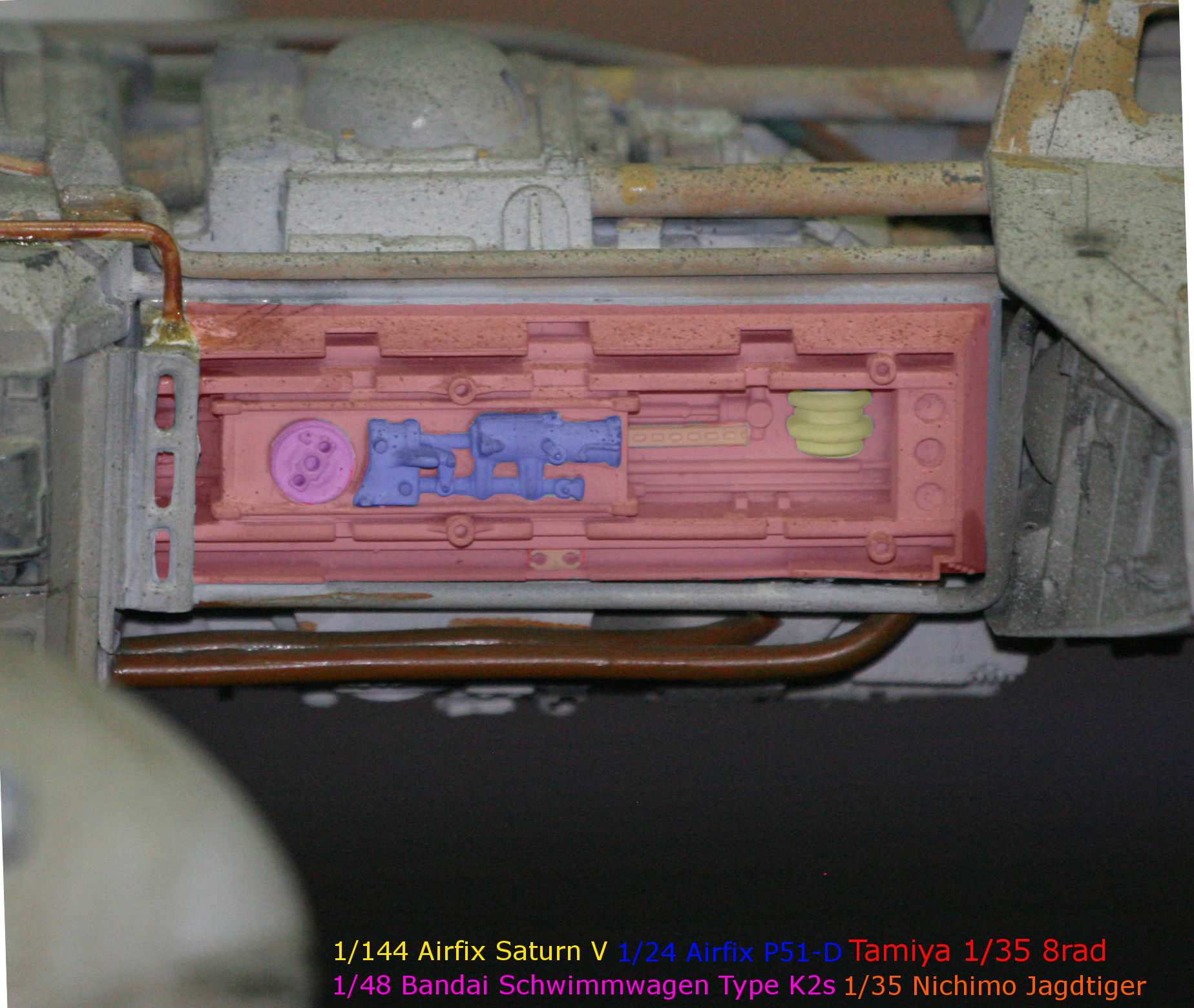

Dave thanks for posting your master there. I had never noticed the tiny nichimo piece in the channel on the side of the 8rad all by itself! I'll have to denote that in the parts map. Oops!
Question as a new guy like me with little experience actually building kits: What are some preferred methods by you guys on trimming parts or even eventually cutting that 8rad assembly into 2 pieces?
An X-Acto razor saw and patience! Use a little wax or dish soap to keep the blade from binding (be sure to clean well after).
Thanks Craig.I'm also seeing it on the 5' refs & y-wing refs.I was wondering if the Harrow needed trimming,but I don't think so?Anybody have some good reference pictures of that part of the5'?
Dave
Thanks Juien.That's more of the angle I was looking for.
Dave

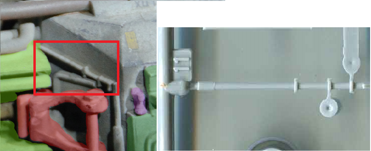

Any thoughts on this piece from the Tamiya Scharnhorst being correct? I've seen the kit be listed as a donor and this is the only thing I have come up with so far.
No it's definitely not from Scharnhorst,just couldn't remember what kit it from at the mo..

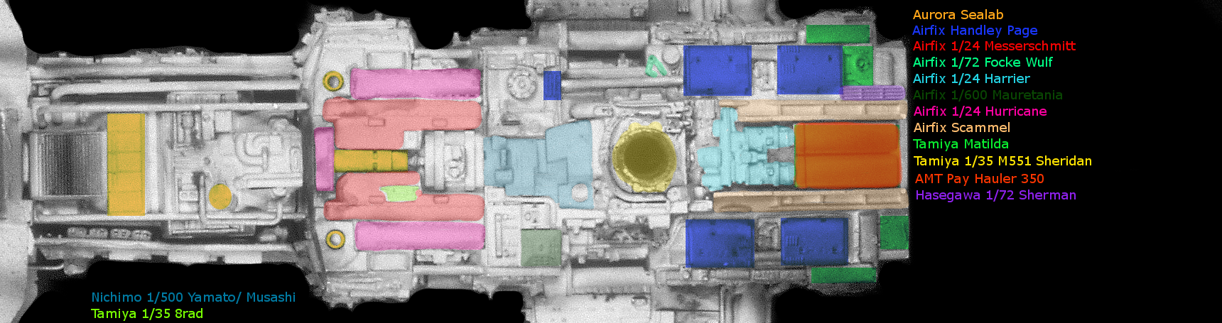

I've been sitting on this one for a while but thought I'd post for the moment. I may split it up into 2 images for the sake of simple kit separation, but here is what I have for the moment. Will probably update tonight when I have some free time.
Revised a few more maps. They took longer than I thought they would :/
I'm trying to spread the ID'ing across more images now and make it a little simpler to understand. Hopefully this can be more digestible to peoples eyes!
