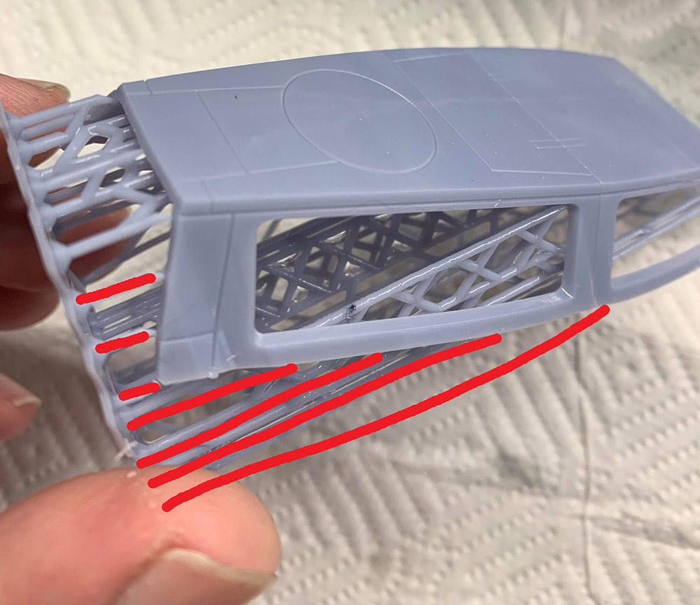

No problem, the distortions should not be there, the resin is flexing on the supports, combination of give and the resin shrinks slightly in the plane of the bed when curing.
Try thicker supports with 2 times larger contact points, and add some more from the bottom edge of the canopy, like this
Fantastic THANK YOU! I dont think I will be able to do the rest of the cockpit sections. Think my printer is to small. Waiting on the Saturn to get stocked.

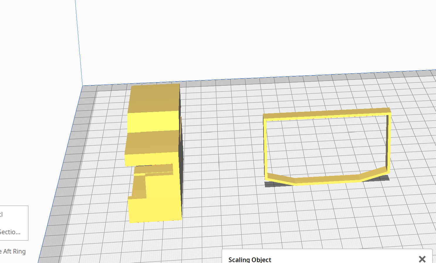

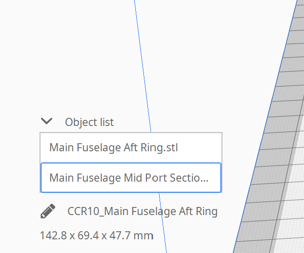

I do have a question if anyone is also experiencing. All the files import great, and size up perfectly by 2540%. However, for some reason, these four files come in at 1000000%. I'm using Cura, and no matter what I do to try and downsize, they only show up as a 'shadow', are not selectable and are just in the object list, can't be selected as an object.
Main Fuselage Mid Port Section
Main Fuselage Mid Starboard Section
Main Fuselage Underside Yolk
Main Fuselage Aft Ring
Any ideas on how to fix or import these in the same scale/size as the other Main Fuselage STL's?
Thanks a BUNCH in advance - this 3D printing world is totally new to me, so I know I have a lot of learning to do..

***UPDATE*** - Hey Cheesy, all, I figured it out. I just opened those 4 files in a STL viewer, reduced the size to 25%, saved as a .3mf file. Then dropped that into Cura, resized to 2540% - BOOM, perfect size!! Thanks, Sean
Thank You Cheesy - When I drop the .stl's into Cura, a little alert window at bottom comes up with "Scaling Object - Auto scaled object to 10,000% of original size" PS, it's 10,000% not 100,000%....

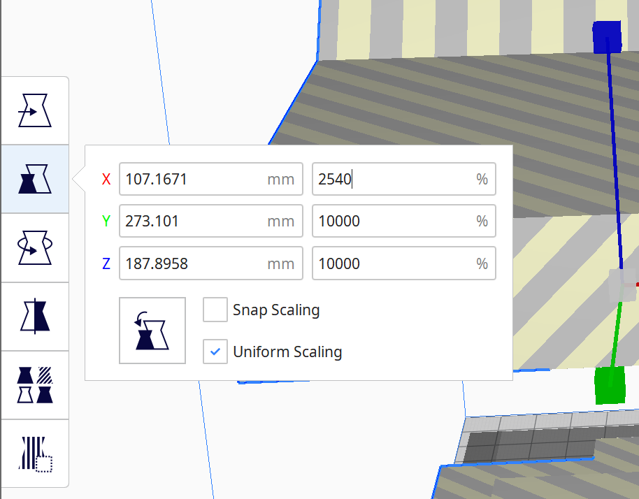

OK, I can recreate the issue in Cura 4.7. Here's what I did to override Cura's auto-scaling function:
1. Open the STL in Cura
2. If you cannot see the STL on the print bed, select the STL name in the Object List:
3. With the STL selected, open the Scale menu. Ensure 'Uniform Scaling' is checked/selected. Overwrite the 10000 with 2540 and then press Enter. X, Y, and Z scaling values should all update to 2540:
4. If all went as planned, you should see a correctly scaled STL on your print bed:
Hope this helps!
Chris
Hope this helps!
Chris
Thank You Chris. I'm using 4.8, I did exactly as you noted above, but all it displays is a 'shadow' on the build plate - it won't show the model for some reason - could be a bug in new Cura. At any rate, by importing a reduced size .stl, I am able to import it, see the model and scale it properly! So all good - Thanks again!
-Sean
