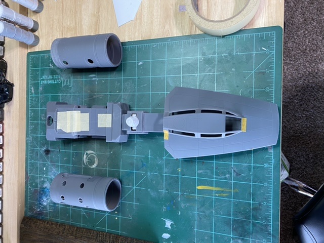

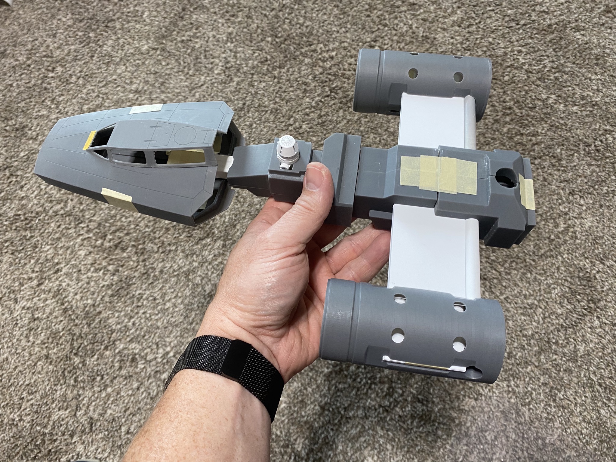

Here’s mine in the very very early stages...

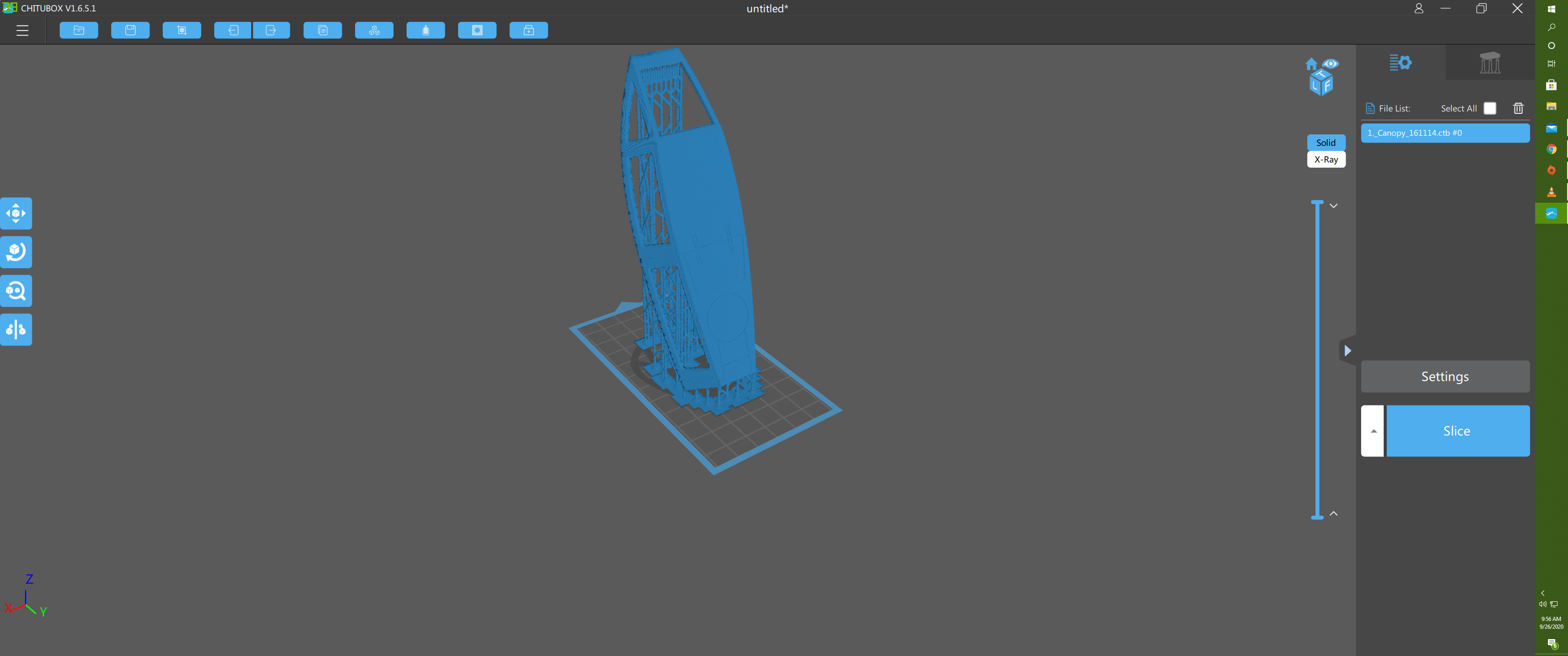

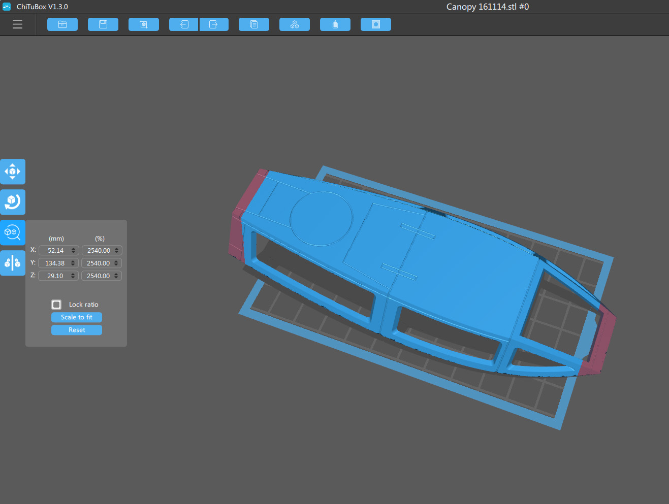

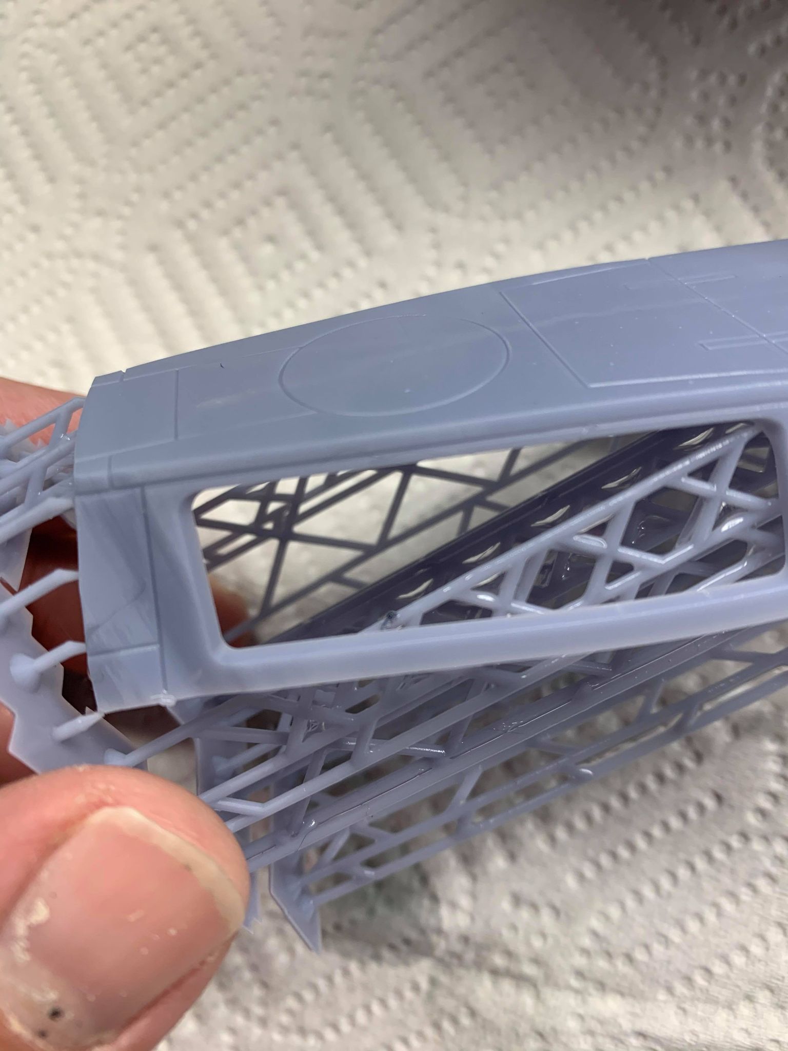

I am trying to do a test print of the canopy on my mars pro. I am using chitubox. When it loads its micro size and doing auto scale to fit fills the build plate. That being said I can scale it up and down but legit have no idea what size in mm it is supposed to be.

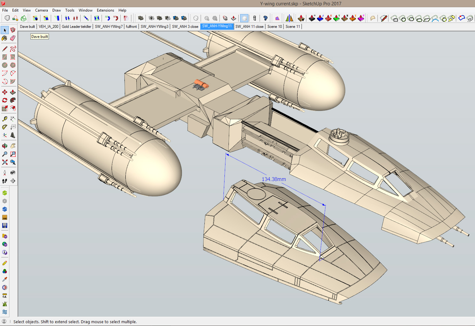

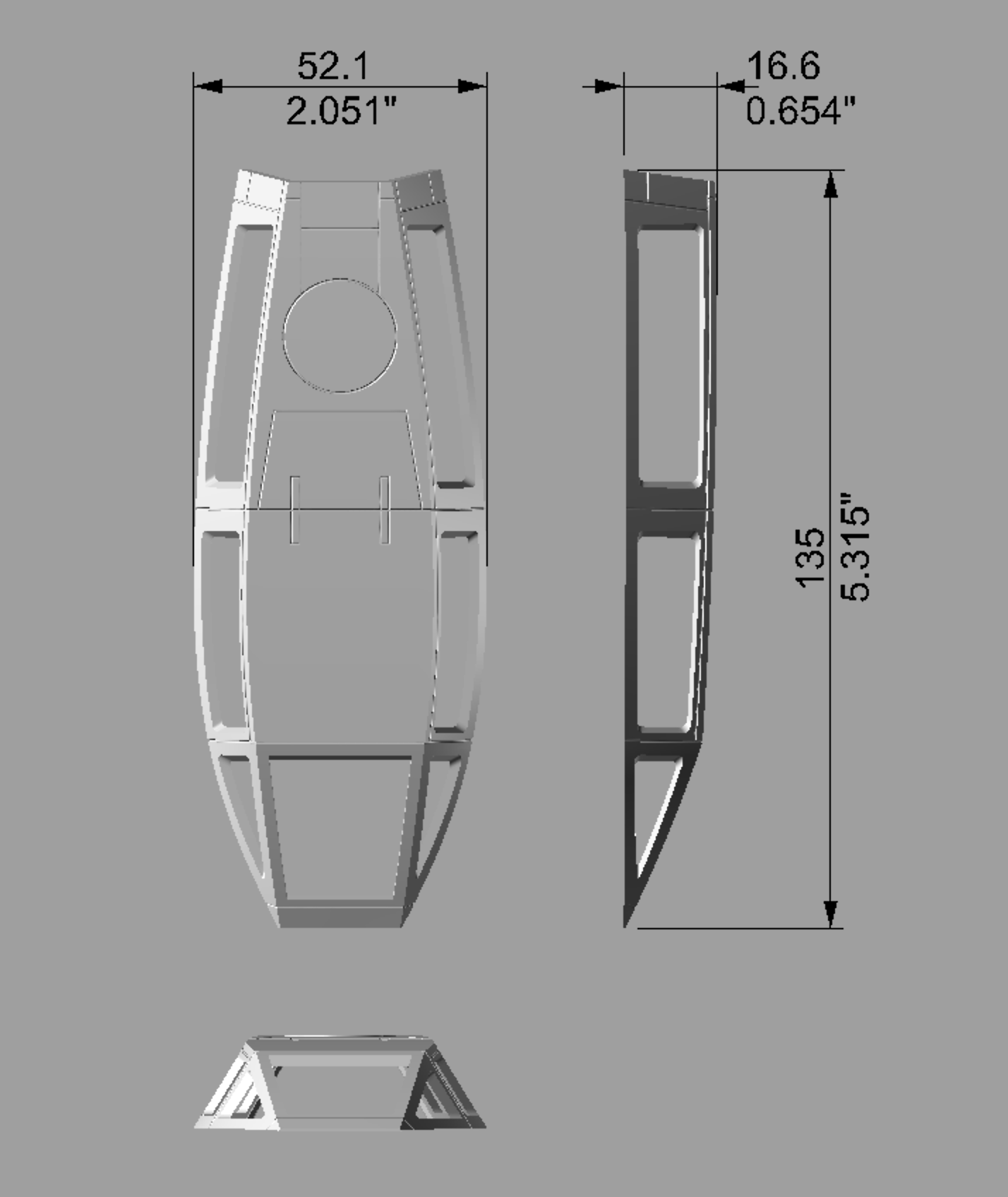

I modeled everything in inches (I know, but when I was a child they said that by the time I was an adult we'd all be on the metric system, and have flying cars. Until I get my flying BMW, I'm sticking with inches!). Scale up by 25.4 and it should be correct. Also you should angle the canopy as steep as possible (front end up) to both lessen the density of supports and effectively increase the resolution. Even though this will greatly lengthen the print time, you'll get a much nicer surface.
It will do that if the file was built in anything other than metric and I believe mm. You can either upscale like Dave suggested or open the file in a modeling program and change the units to "mm" it will then import in fine.
yeah sorry if I seem stupid here. I am new to printing just got it. I have printed some other minor stuff and all of this is very confusing. I just wanted to print this to see how it would turn out. I think scaling this correctly might be out of my reach.
No stupid at all! 3D printing can be intimidating at first, especially what to do with settings when something doesn’t look right. The default with all printers is millimeters. There are 25.4 millimeters to an inch. Scale the parts by 25.4 times and everything will be fine. Good luck!
I did do that but isnt that to big? I have built a bunch of studio Y's but its been a bit but given the scale my build plate that looks massive from what I remember

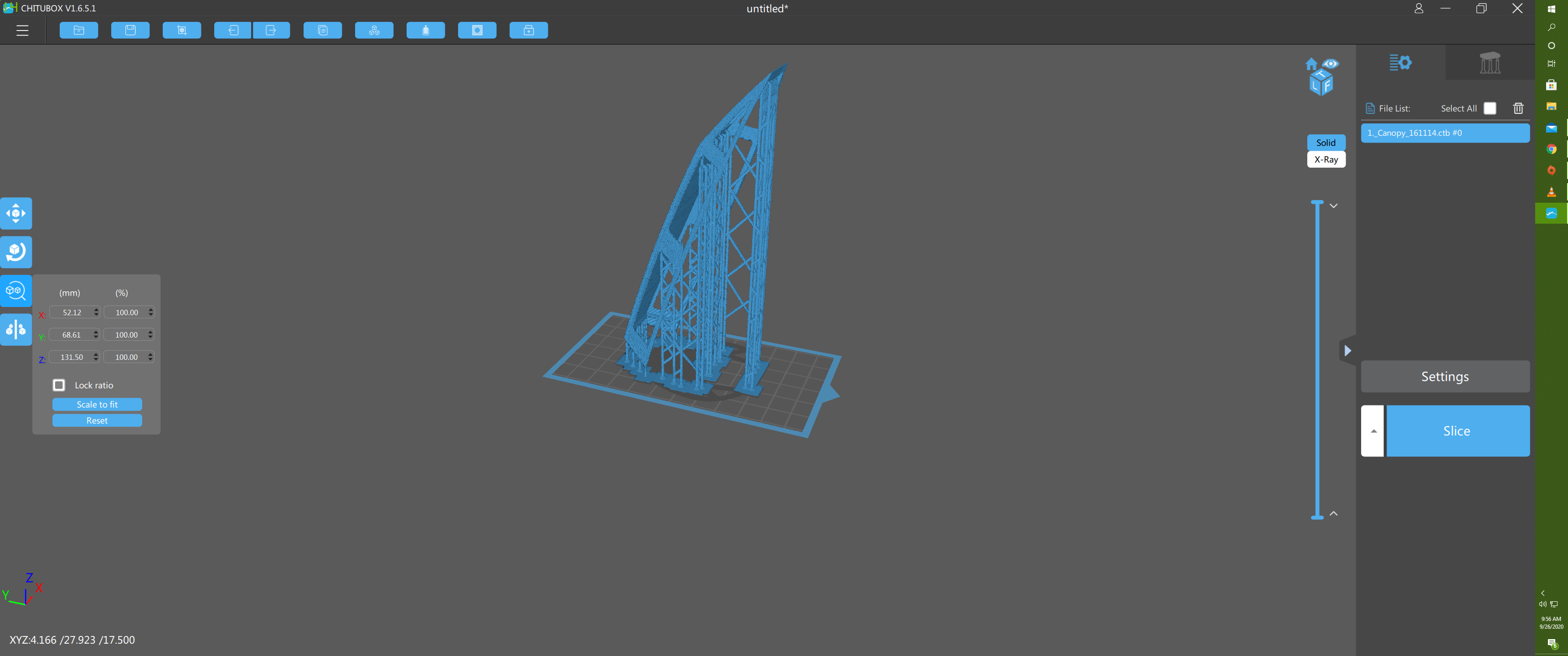

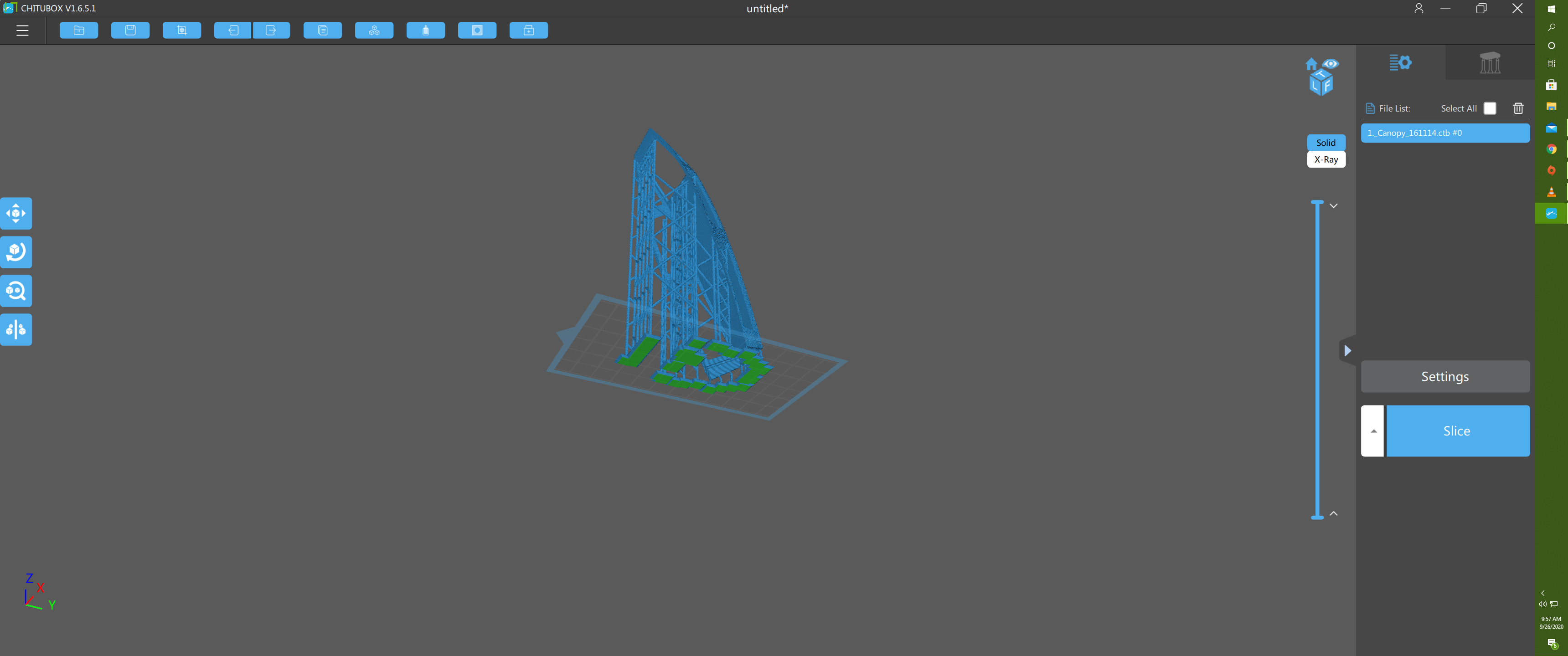

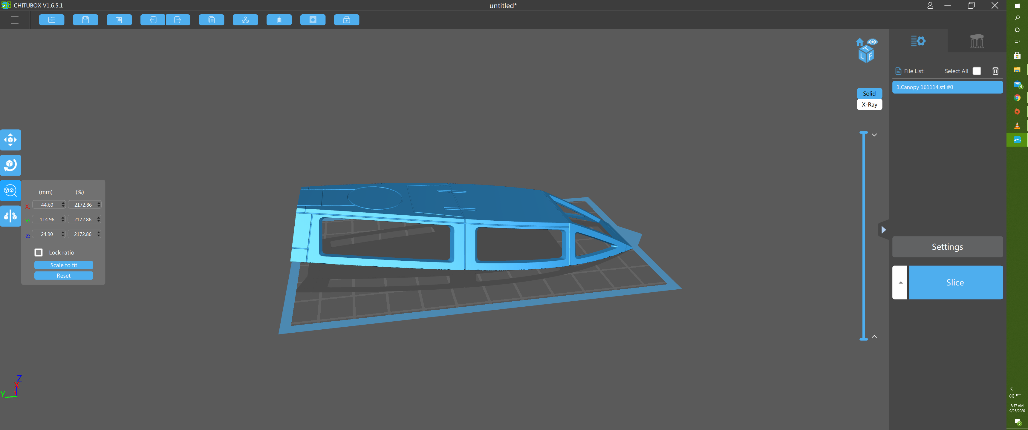

I am sorry if I came across as not believing you. I am sorry if that's what you thought. I have Aspergers. Ok so before a kind person helped me and sent me a pre-sliced file I took Firefox's advice. I did what he had said. Then places support where I thought they should be. This is my first solo piece placing supports manually.

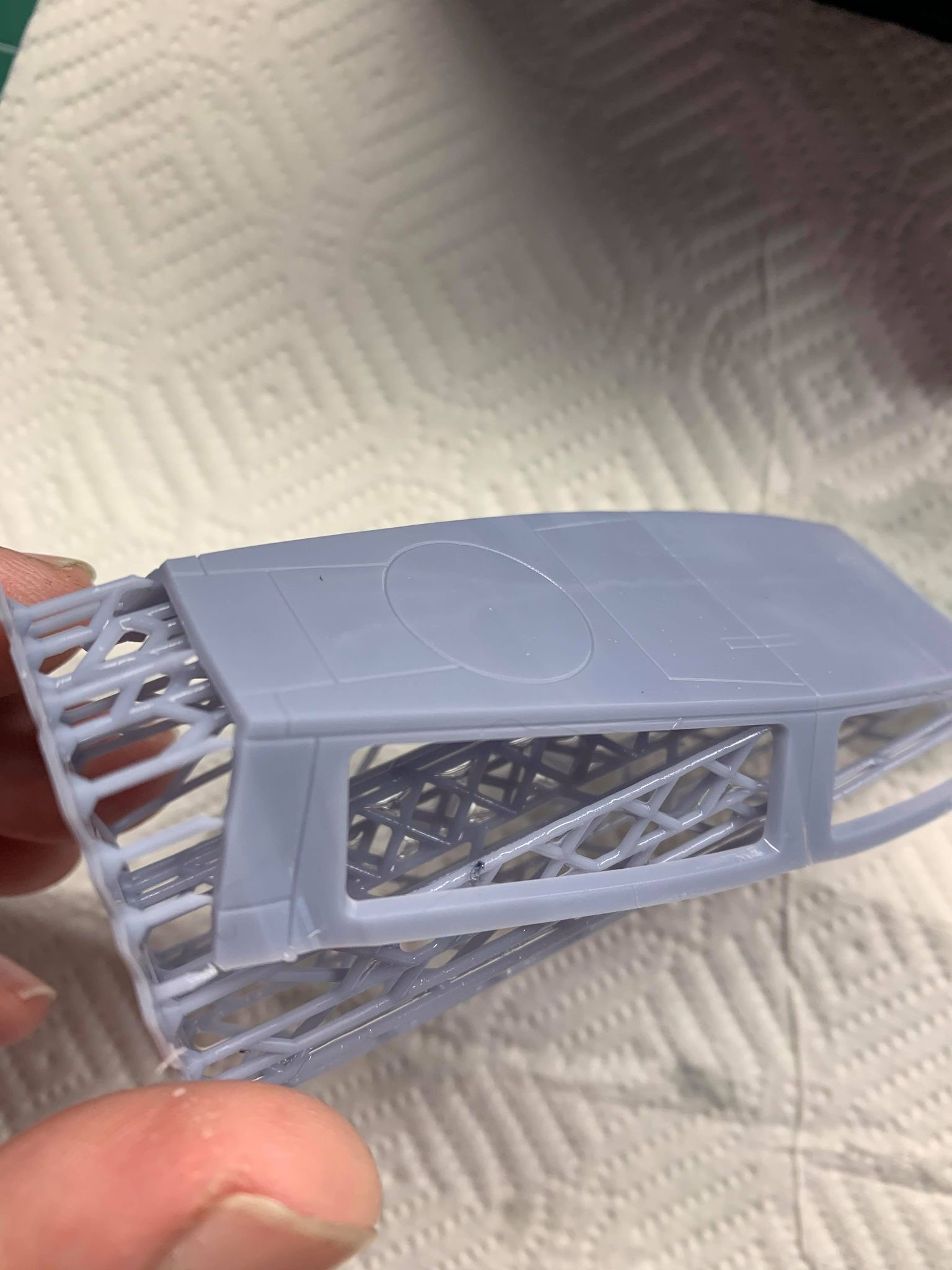

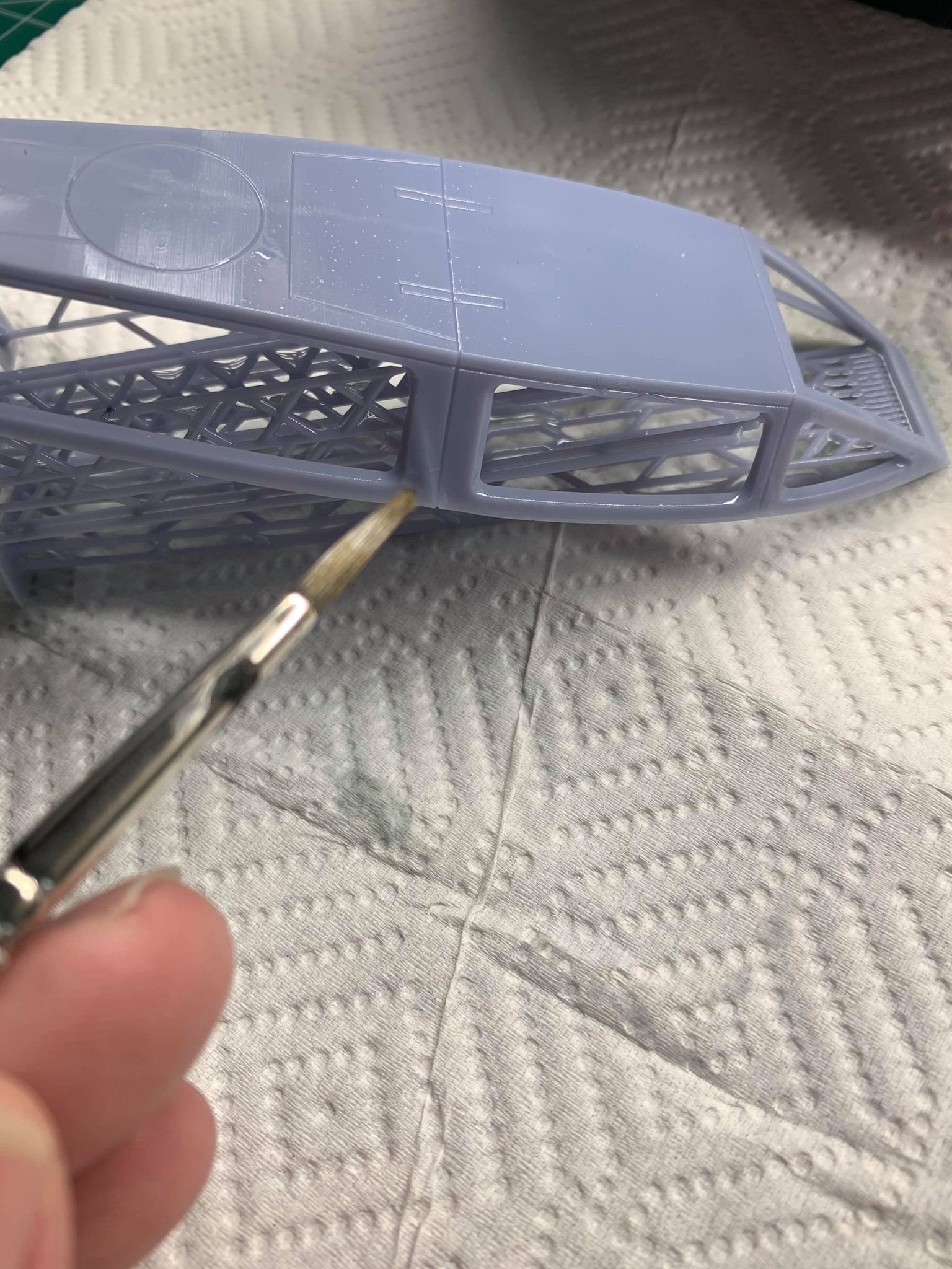

So woke up this morning and the first thing is...SUCCESS the piece printed start to finish. So that is a win as it finished and didn't snap or break with the supports I used. I will post a screengrab with what I did etc. I knew that the large the print the higher the chance you will obv see print lines. After all the bigger the piece no matter the screen resolution the bigger the pixel will be. Learned that when I was rocking my Neo-Geo back in the 90s and Dad bought a larger tv. I digress. So maybe I can increase or I guess decrease the layer size. I have no idea if it can go smaller.
I have noticed some bulges in a few spots near frames on the canopy. Again can't remember if they should be there or if it's because of some sort of mishap on my behalf with the supports or another issue. It has been a bit since I did Red Jammer and dont remember if it should be there.
