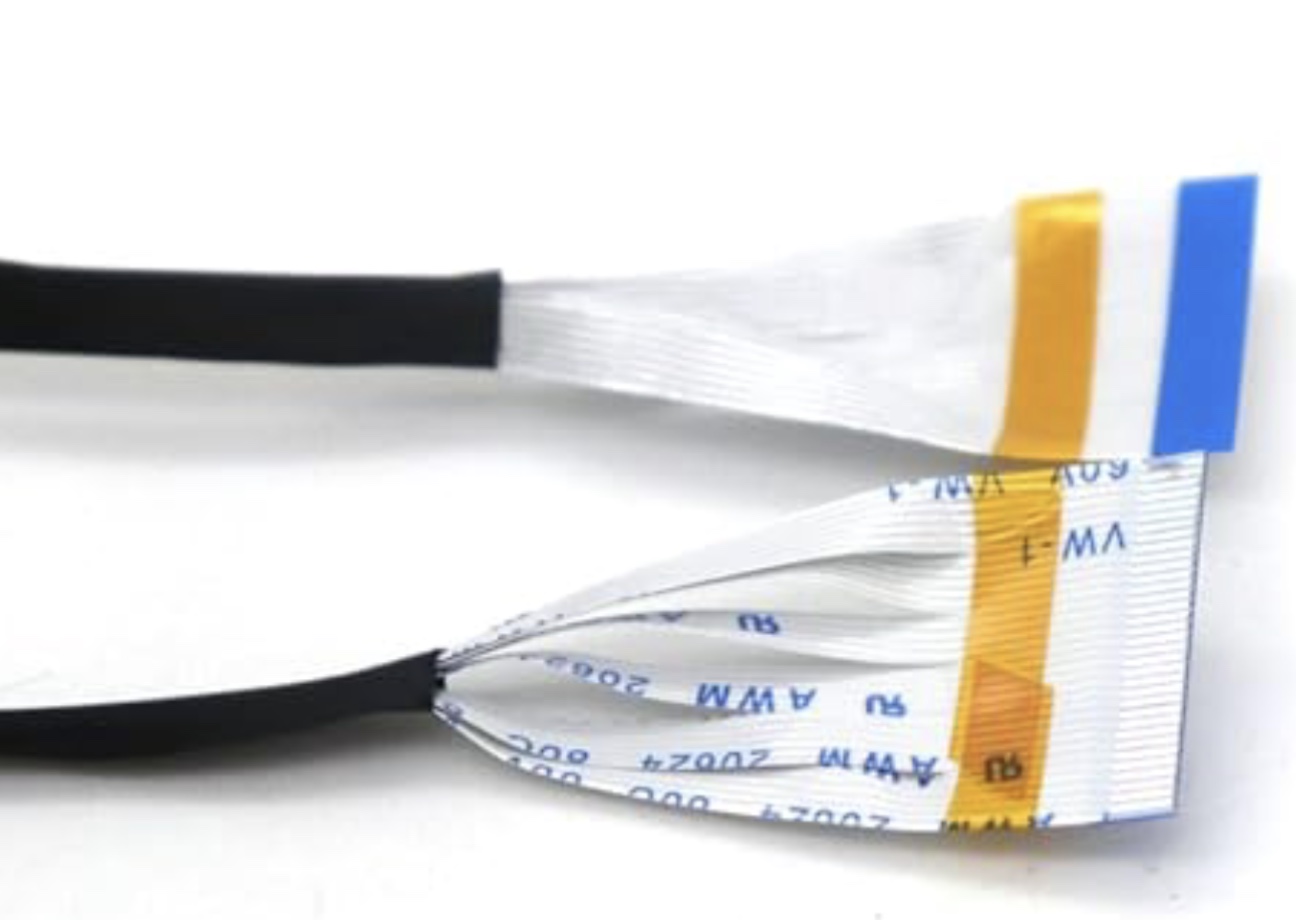

Btw….here’s how to deal with getting Flat Ribbon Cable through round holes……..once split into groups (not all the way to the ends) and heat shrink, then temporarily roll/curl the ends to pass through the round holes, then re flatten the ends.
When heat shrinking …never stay long in 1 spot, move along the length evenly with the heat gun…. otherwise the heat may melt the insulation of the Flat Ribbon if it is to HOT which might cause shorts or intermittent problems……However this method is used in industry with experience.

Hey ok now that looks like it can be bundled up quite small. I was a little worried about how to get through this step, but this is giving me some hope.

IF ……you make the attempt to make this sort of cable….you’ll have to pick a count of where you’ll make your group splits. You’ll have to use an exacto blade to begin the splits.
There’s two ways to go about splitting…
One is you use the exacto and try to maintain splitting down the length of the cable without cutting into the insulation of the individual wires ….or you start a split with the exacto and hand tear down the length of the cable ….if you know what I mean.
Remember…do not split all the way to the ends…tape off at the ends where you think you should stop splitting…so know when to stop splitting. If you split through to the ends….No Bueno…you might as well make wrist bracelets with wire groups…. :lol:
