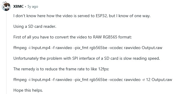

Playing raw RGB565 video

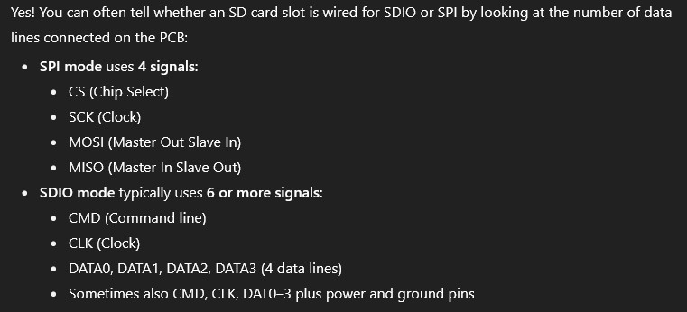

Are you talking about this:
I ran into this last night when converting my video. I had to figure out if our SD slot was SPI or SDIO.
SDIO is way faster because it uses more data lines i guess

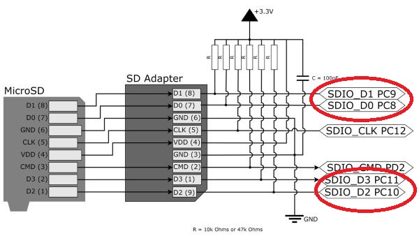

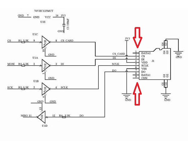

Here is (i think) an SPI card slot pin connection diagram:
See the pin on either end does nothing. now look at this one thats SDIO (i think):

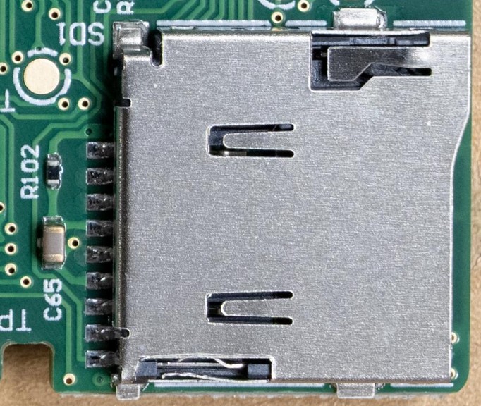

So then I looked at the pcb pic of our SD slot:
and it looks like for sure there is a circuit path to the end pin on the bottom.
So from all this I have concluded its wired for the faster SDIO and therefor can play rgb565 faster than 12FPS
Do i know what im talking about? I FOR SURE DONT. Im dancing on the head of a pin here... :lol:
