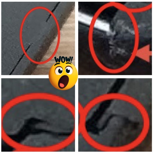

I noticed mine won't fall all the way perpendicular to the housing but I can easily nudge it to 90 degrees so it's not like it's going to break. I honestly wouldn't have even thought about it unless it was brought up. It hasn't bothered me and I didn't consider it a flaw.
Mine opens to the point about where yours does before you push it down. If I push mine down from that point, there's tension and it springs way back up. I estimated with my phone's level that it's about 20 degrees. It's enough to block the middle section when I have it on display.
I've managed to get my door holding securely at 90 degrees. I remembered it held better before I sanded the plastic lightly near the pivot to remove some flash. The flash seemed to act as a bit of friction which held it in place.
I decided to try and use a bit of black super glue to build it up slightly so as to act as a grip. It worked and now the door hold in place when open.
I'm glad this worked out for you. Assumably these were impacting the pin itself and preventing it from dropping the full 90 degrees?

I used a set of digital calipers on the rod for the door and got a measurement of 1.50mm.
From what I can tell the section within the door is held in place by friction and doesn't rotate. The actual rotation is done where the aluminium frame and rod meet. If you wanted to try and make it so that the door holds in place no matter what angle you put it at, rather than replace the rod, you could crimp one end of the rod slightly. This would cause it to be much stiffer. I'm not trying it myself though as I'm happy with the result I got.
