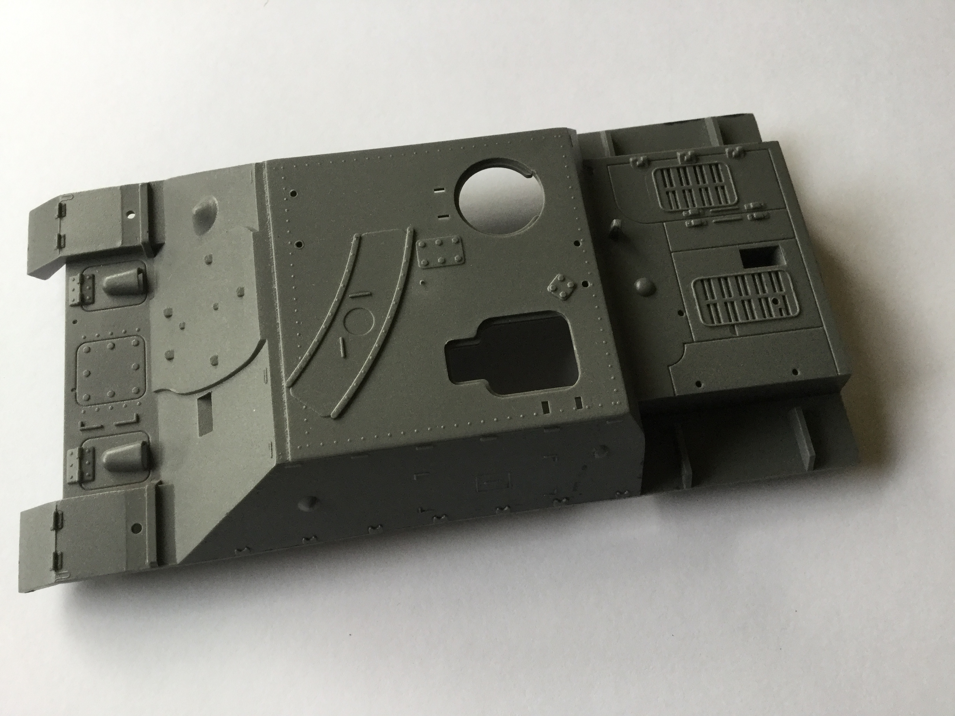

To show how effective the Dettol is , have a look at this image of part of a rare Bandai jagpanzer 1/30 I bought a while ago and was completely covered in black paint. Dettol stripped the paint off no problem, no effect on the plastic. You can handle the stuff without gloves as well, though not advisable. The only downside is that of the lingering odour of a cleaned bathroom.

To show how effective the Dettol is , have a look at this image of part of a rare Bandai jagpanzer 1/30 I bought a while ago and was completely covered in black paint. Dettol stripped the paint off no problem, no effect on the plastic. You can handle the stuff without gloves as well, though not advisable. The only downside is that of the lingering odour of a cleaned bathroom.View attachment 1513958

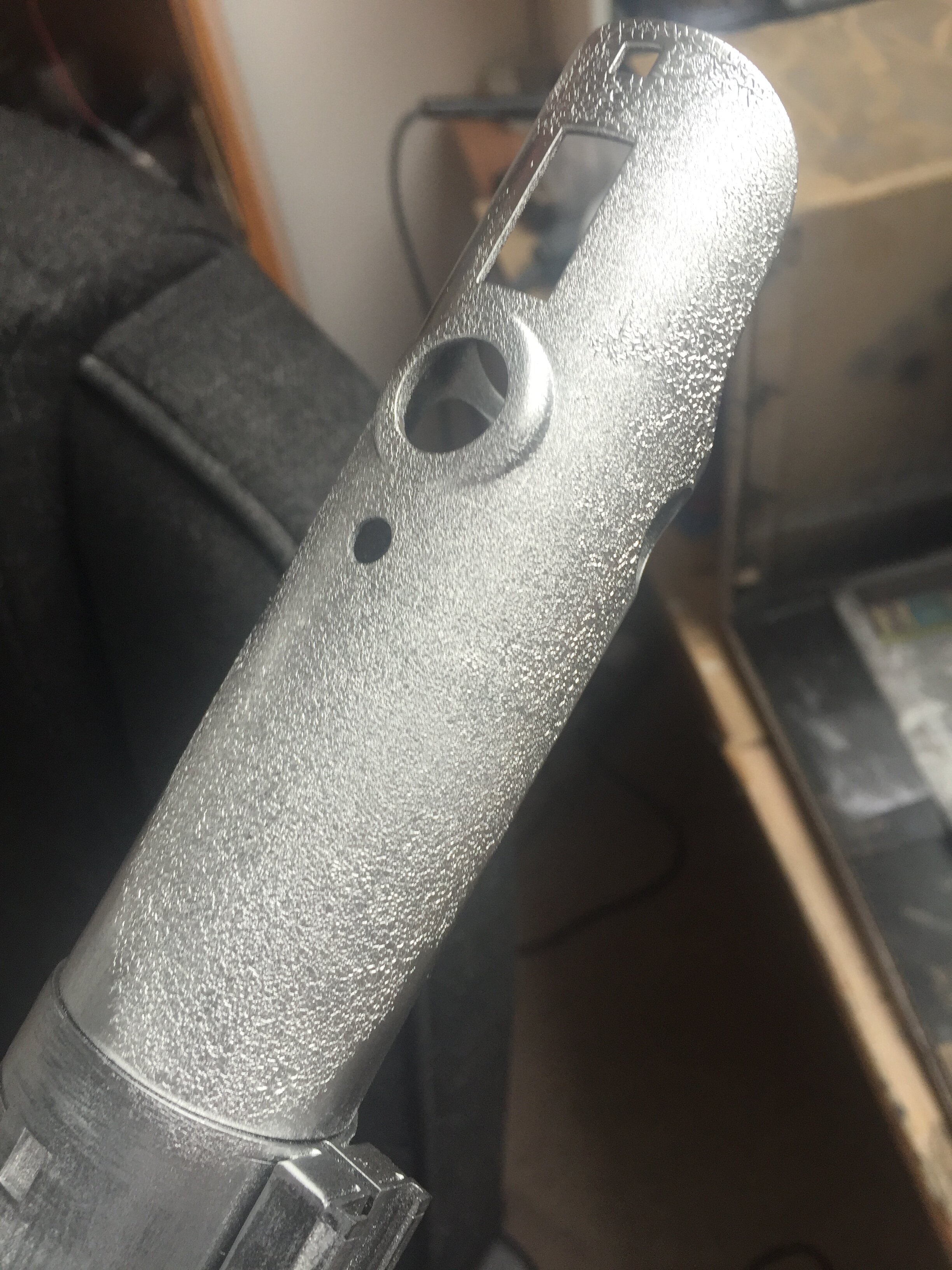

If the surface is slightly textured, that 'mottling' may be because the paint is drying in the air before it gets the the surface of the parts, so instead of a smoothly coverage it's depositing 'clumps' of partly dry paint. Or the primer may be old and a bit viscous. Or it just might be cold (did you warm the can before spraying?). And that texture will show through any paint you apply I'm afraid, unless you wet sand it smooth again. :(
Here's an example of a similar sort of thing that can happen, albeit with metallic paint (this was a temporary disaster I had when painting a lightsaber hilt a while ago - fixed by stripping, sanding and re-priming/painting). Your mottling is a bit different though, and not something I've seen exactly before.
If, however, the surface is smooth to the touch, and the mottling is only cosmetic, you may still be OK as the actual paint layer(s) will hide it when they go on (the primer is really only there to provide a nice, stable base layer for the actual paint). But even if it does feel smooth to the touch, I'd still be tempted to give it a very light wet sand with a fine sanding pad, or a rub with a scotchbrite pad.
Fingers crossed the mottling effect is only visual and you've got a nice smooth surface, and you can carry on! Good luck!
