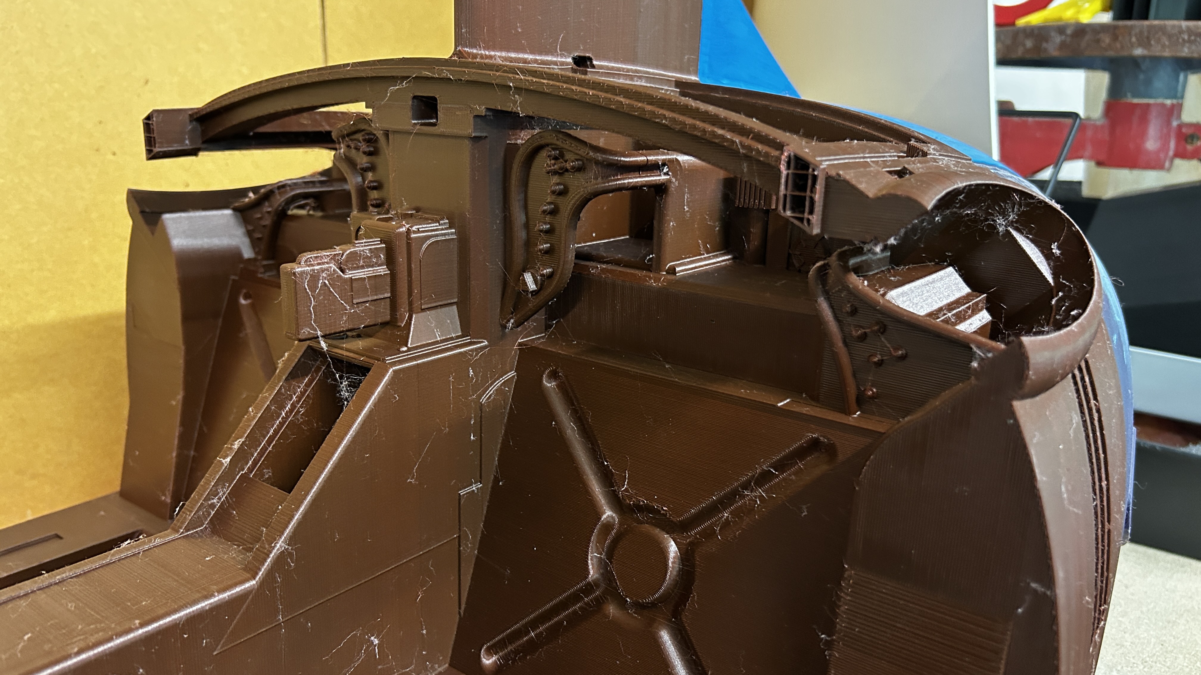

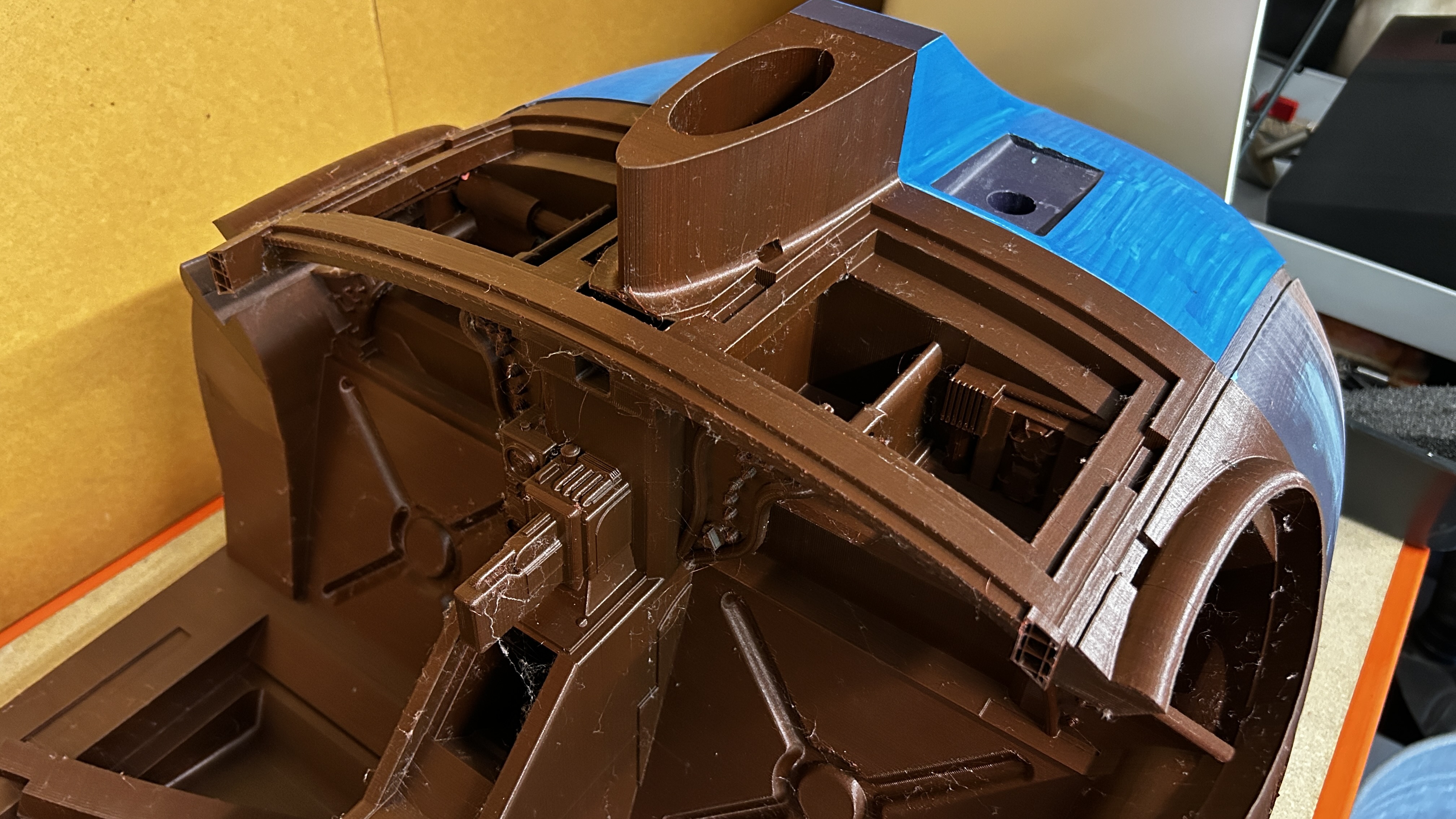

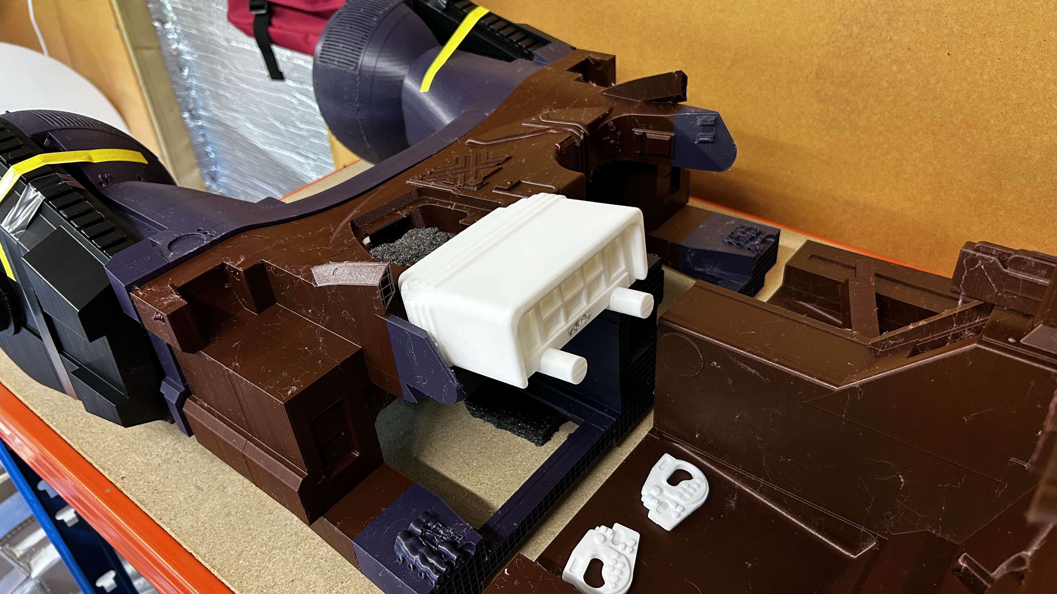

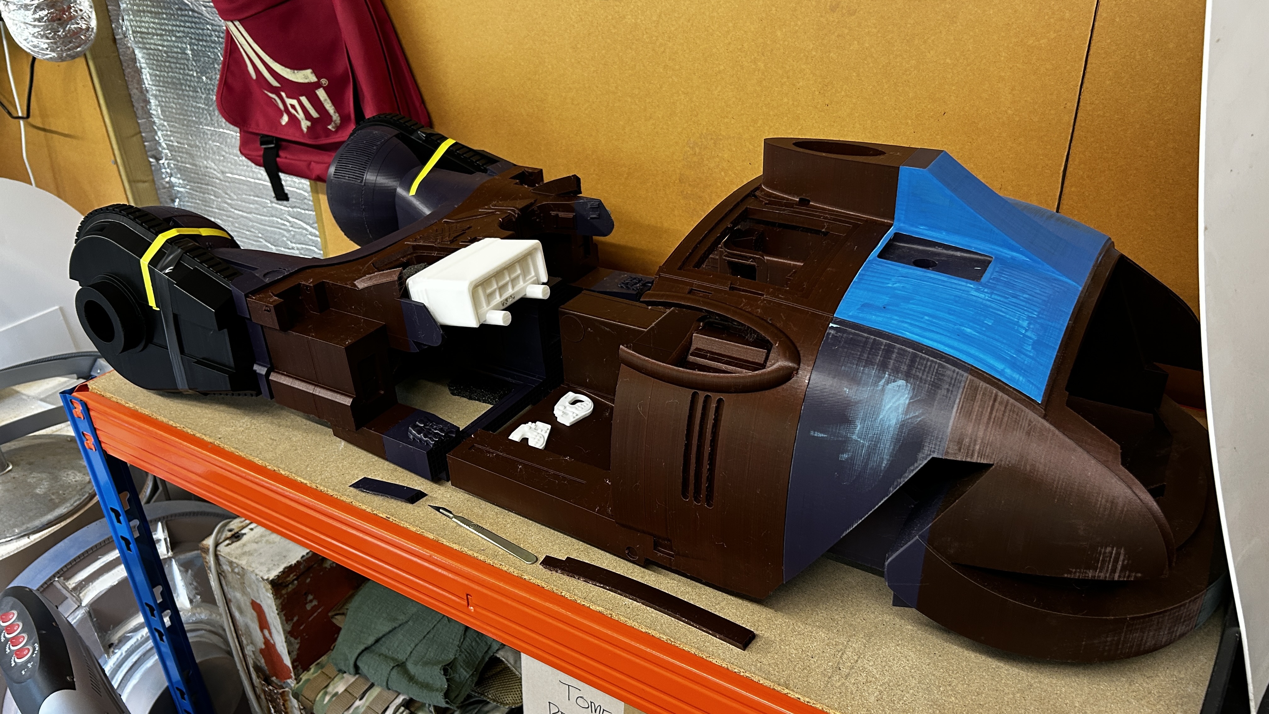

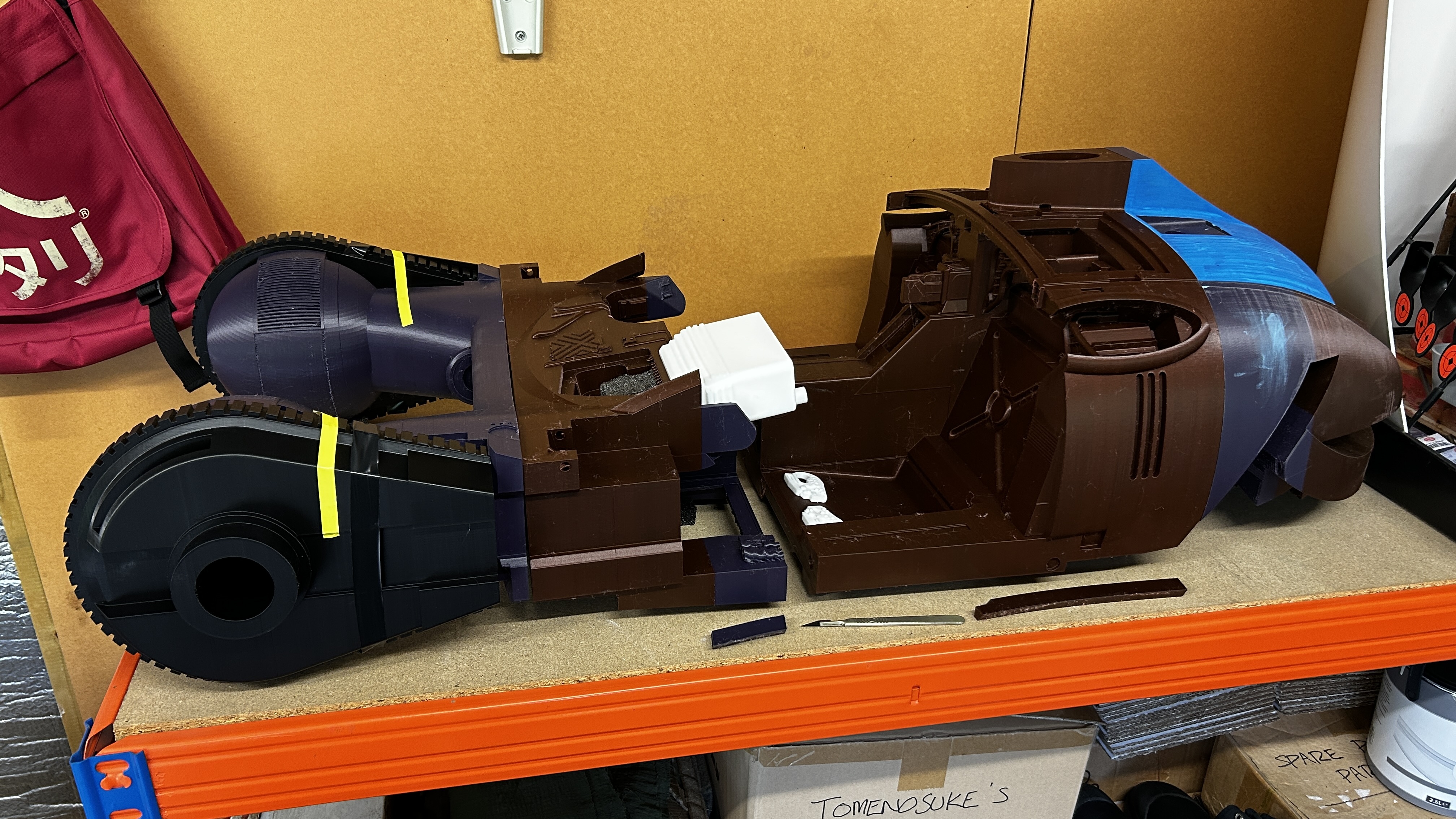

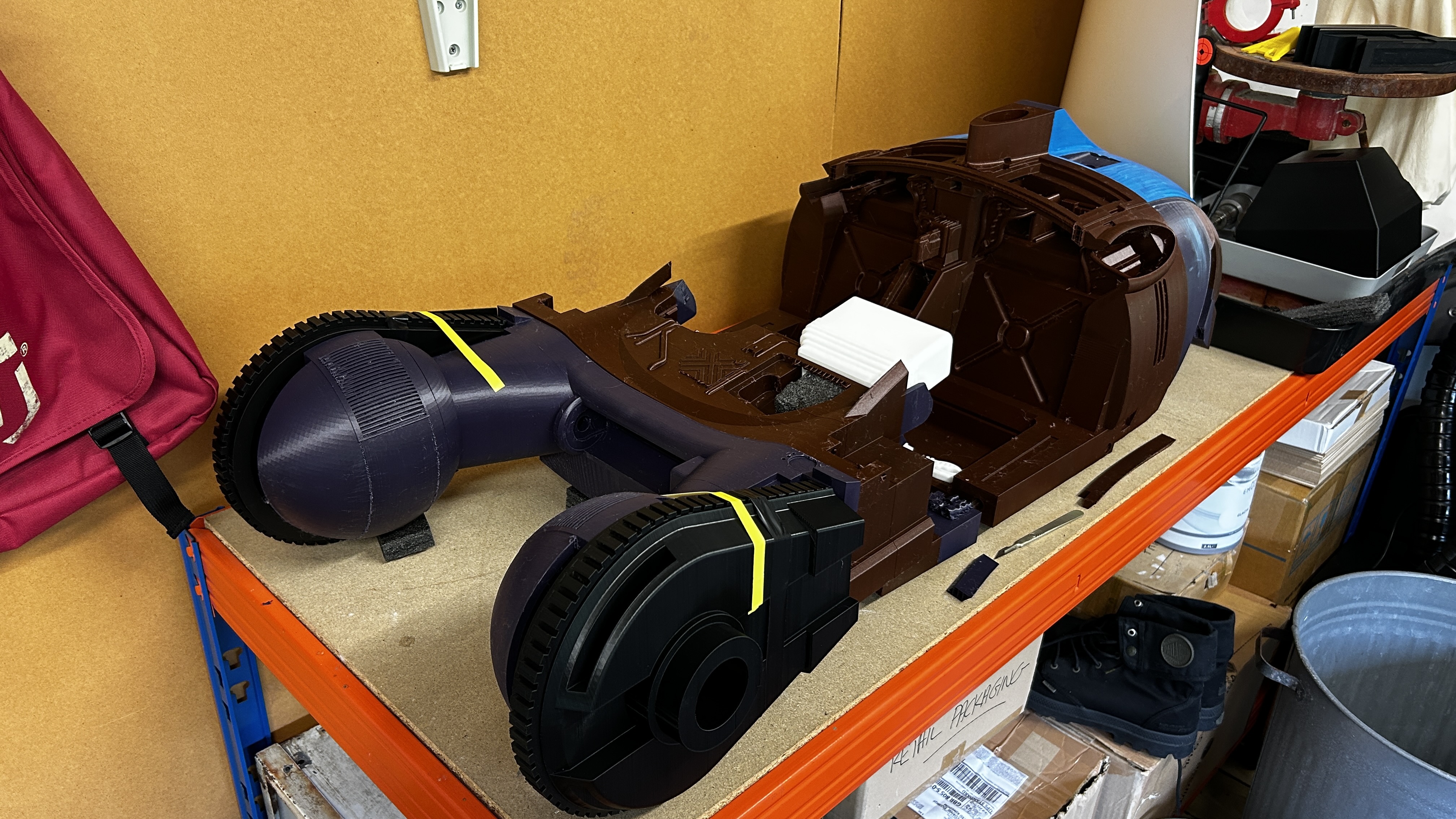

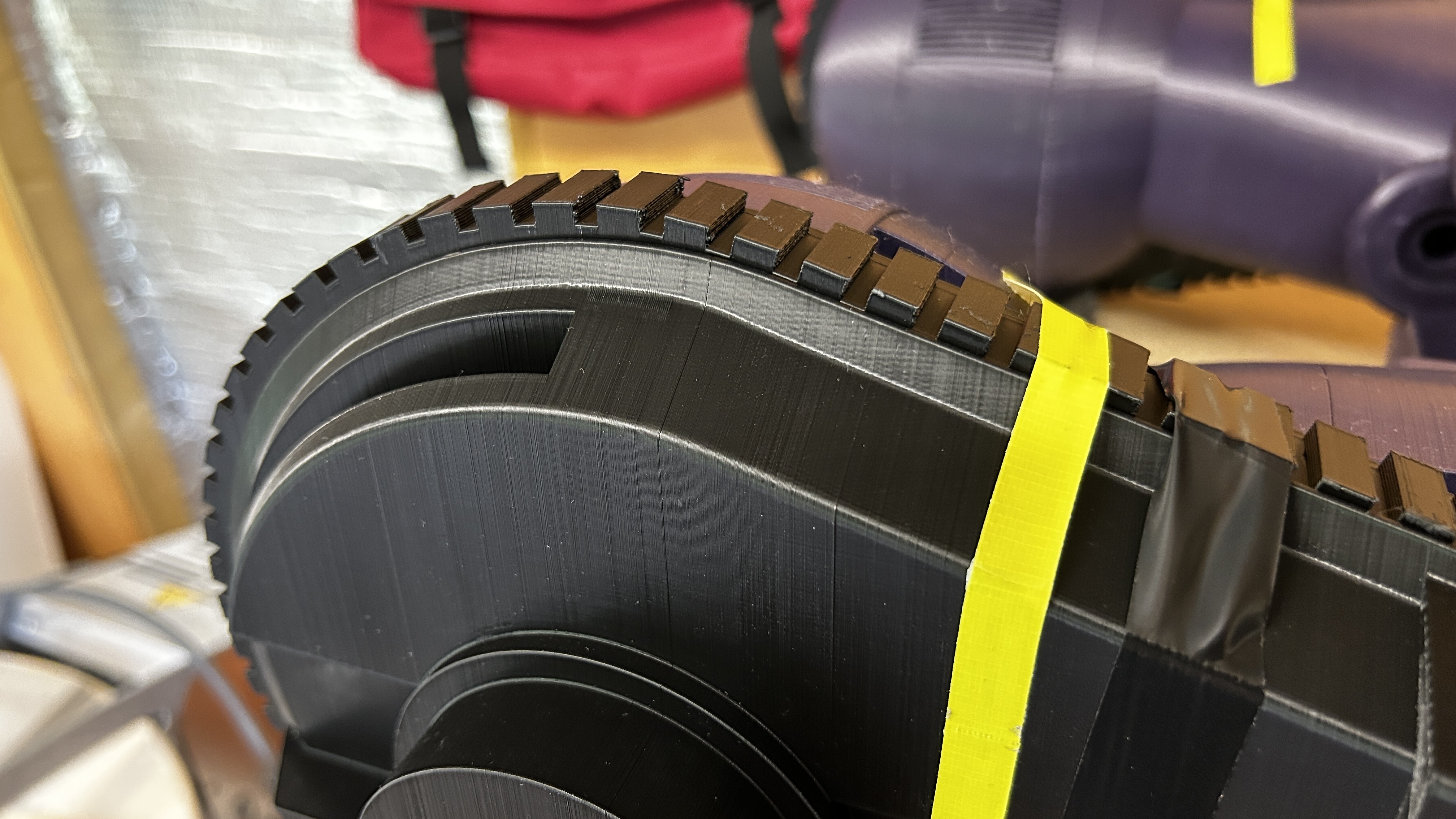

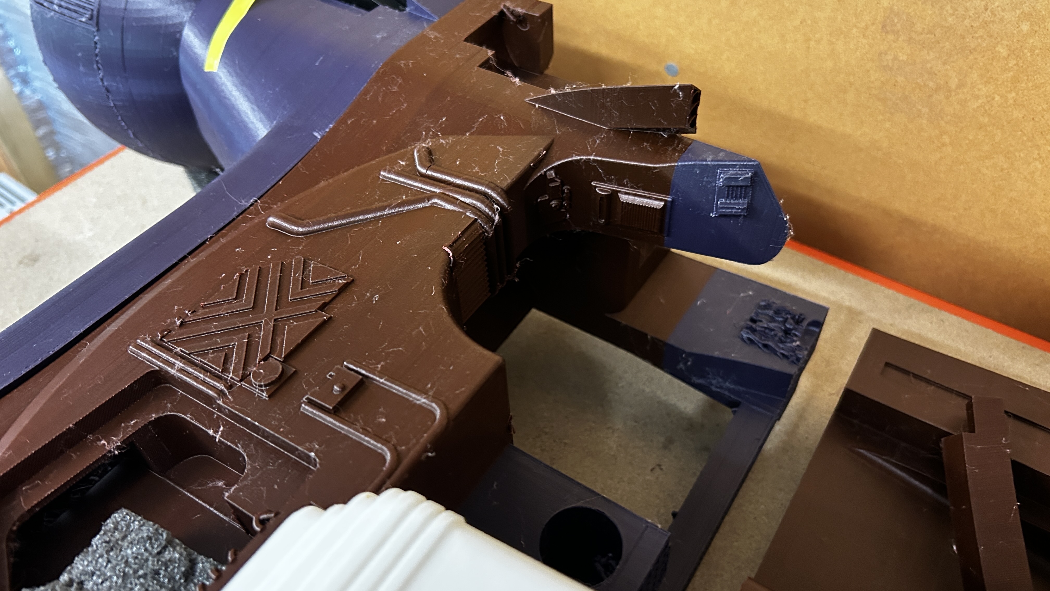

I haven’t had much time to be online recently (gradually deleting my online existence completely but still here for now) but here’s an update on the big Spinner. I purchased a bulk 10kg deal on PLA-CF filament and the printer has been quietly churning out parts for the last couple of months. I’m running the machine with a fine layer height and at a fairly slow speed to keep the finished parts as smooth as possible and requiring the minimum of post processing. There have been one or two small hiccups such as the part which includes the dashboard and floor fronts which decided to stop printing with about 30mm still to print. Luckily that part, the missing 30mm of the floorpan anyway, is all straight lines so I can infill the missing section with traditional modelling techniques using styrene sheet and resin fillers. Everything else has been progressing nicely and I should have all the big main body components completed by the end of next week. I can then start making all the smaller components which make the final model stand out such as wheels, seats, lights etc. Here’s a few pictures I snapped recently for reference. None of the parts have yet been sanded or trimmed fully;
