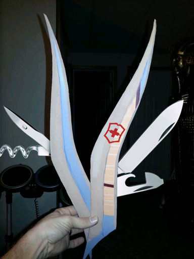

Well...back at it. Started with the arm blades. I put a wire hanger in the middle for support. Glued them together, rotary tooled for the edges, and made the base. I'm going to detail the base and it will be blue. The blades will be black. I decided to make them large....go big or go home....
I have to thank daninboo for his freehand tutorial that is right here. I am a lot more confident in just making templates instead of relying on pepakura...I love the arm blades...

I can see why you have been geeking over them! Those look incredible! Nicely done sir!
-Cubone
Re: Guyver *WIP*
It's a Guyver after all, it makes me think about an upgrade into something more... TV accurate :D
Re: Guyver *WIP*
-Cubone
Thanks, can't wait to see it all together with these bad boys!
Those blades are scary cool!
Thanks Alpha!
It wasn't in your templates!!! I'll have to make a version 2..... I can't believe you shopped that.... :lol
