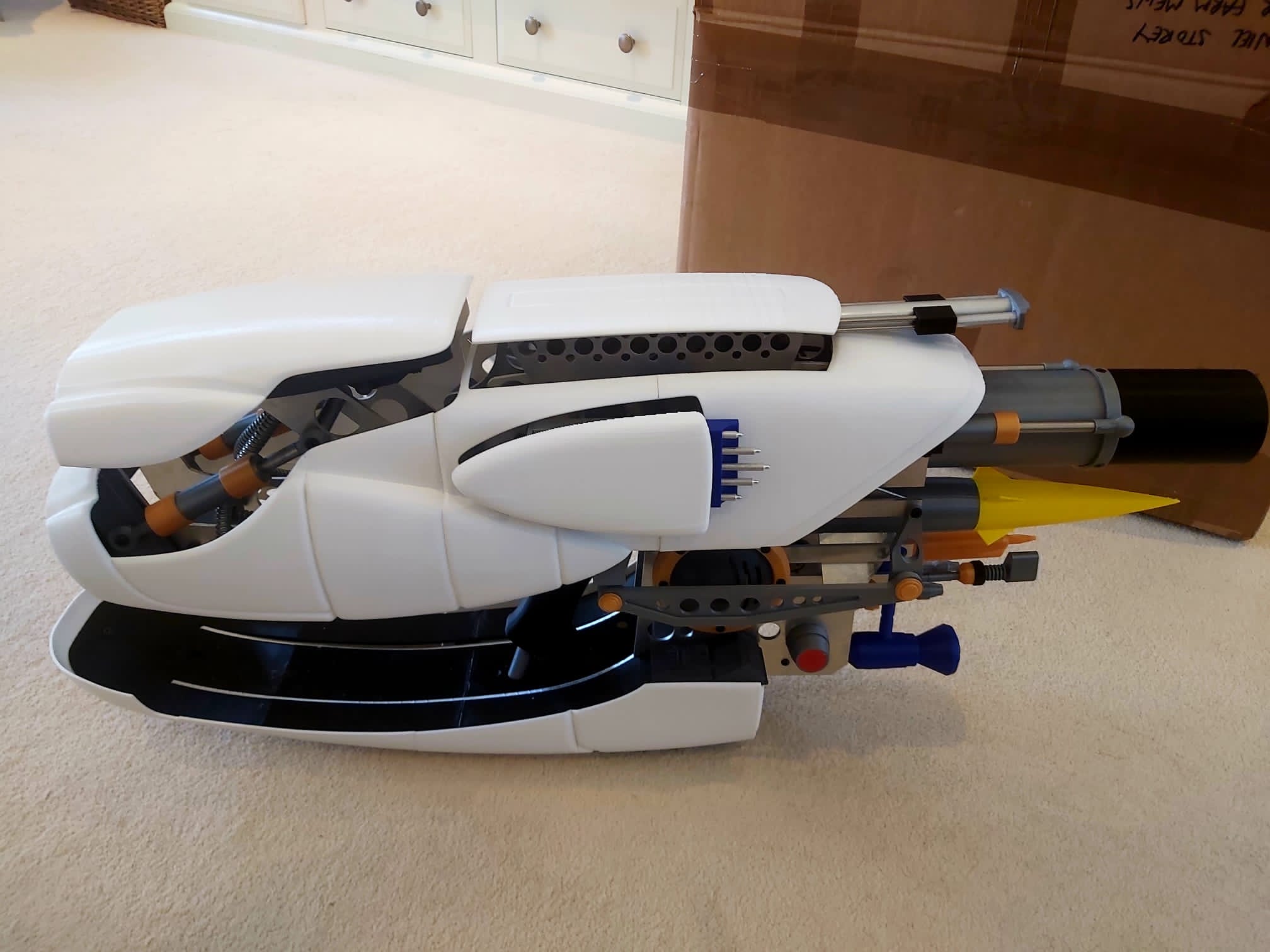

hey there, I'm taking advantage of the fact that I just installed a few parts on my ZF-1 and took a more overall photo to share here again what an awesome kit this is and how easily it can be upgraded to get a super accurate, super realistic, animated and lighted ZF-1!
thank you so much again Jake for your crazy smart brains and for doing this for us!

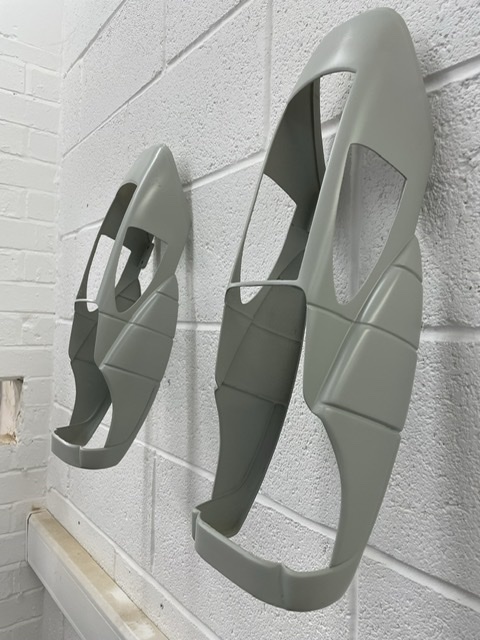

Those buyers in the first batch waiting on their assembled DX ZF1's will be glad to know I have started painting and prepping the shells of each of their ZF1's.
First layer of 2k filler primer...
Quick sand of the second layer of filler primer...getting there!
For those building your own, it is worth buying some cans of high build filler primer or car body filler or something similar. It doesn't take long to get it to a point that you can start spraying the final base coat but it does require some work.
I would recommend putting big slugs of superglue behind the joins of the shell segments, in order to add strength, and using CA activator. Use the body filler to fill any of the bigger gaps but use multiple heavy layers of the filler primer/ high build primer to deal with the print layers.
All this will be included in my next guide video on 'How to paint your ZF1 kit'.
Thanks everyone!

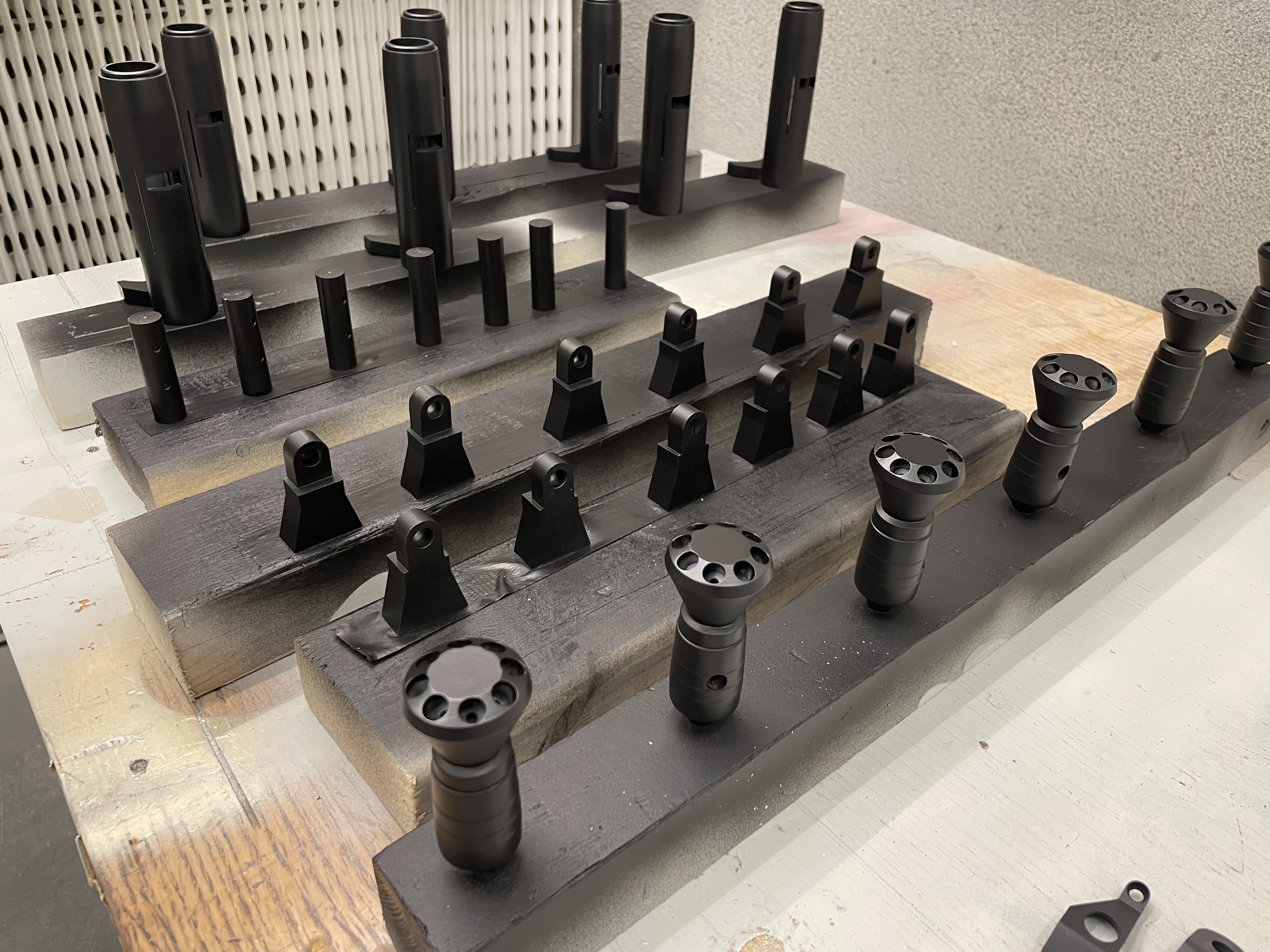

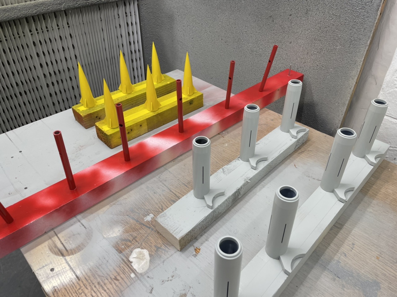

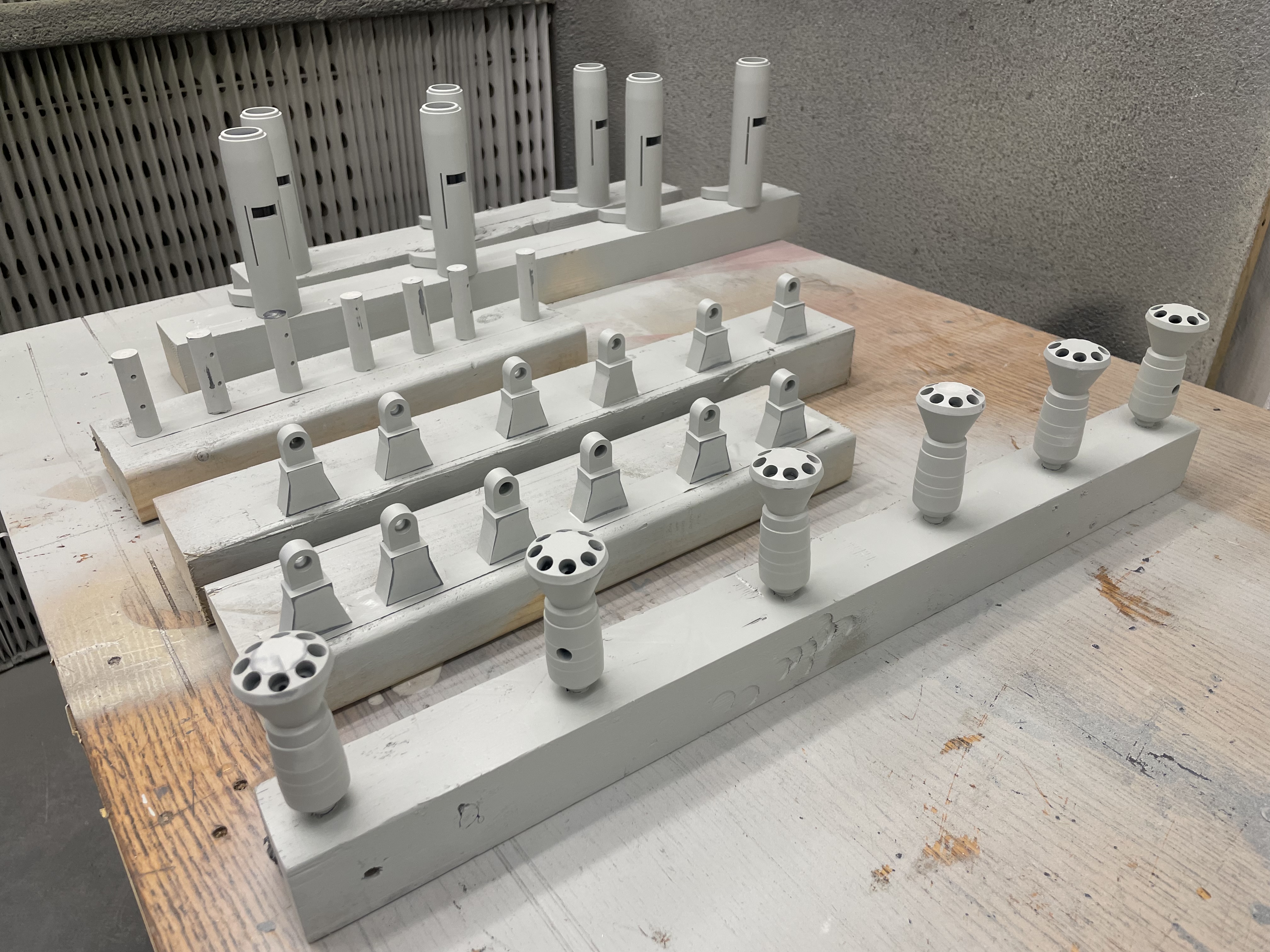

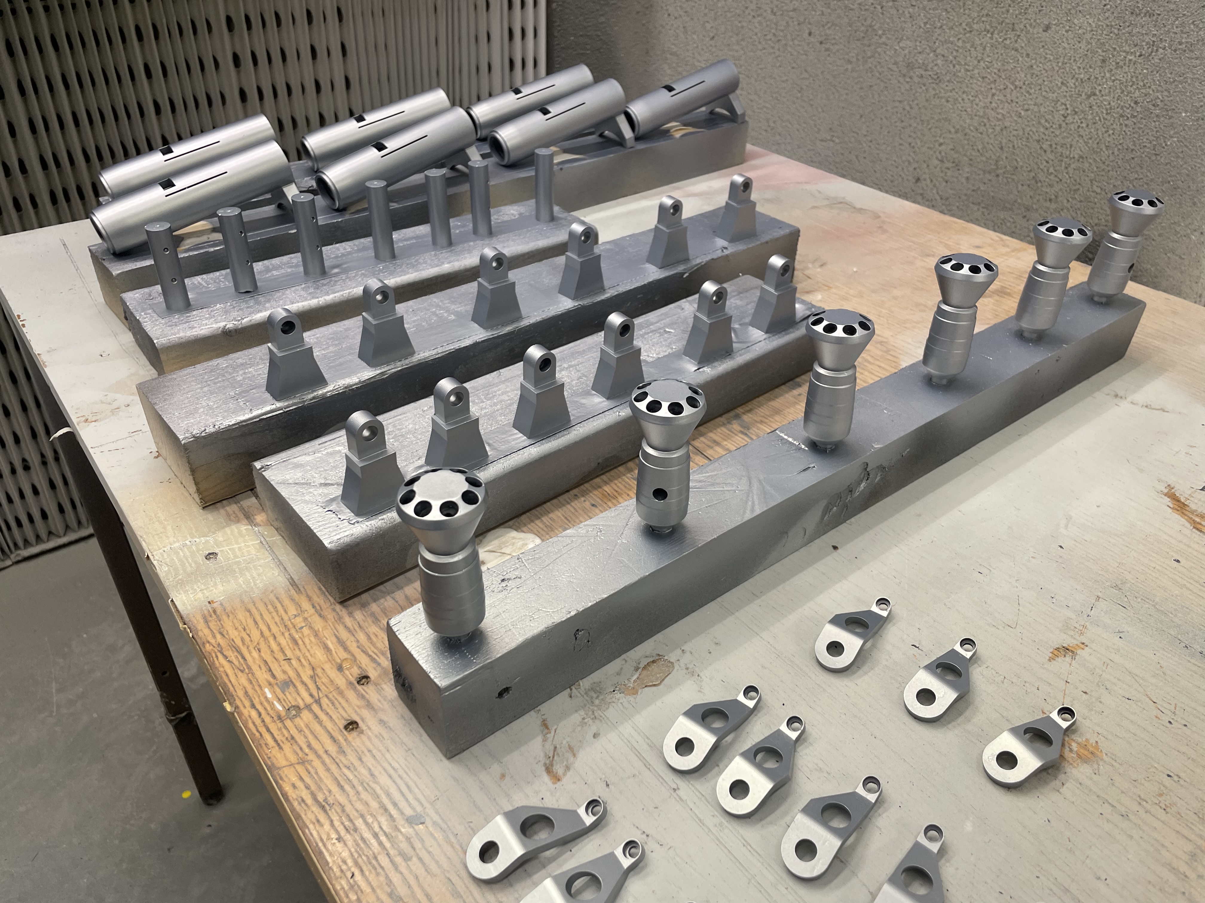

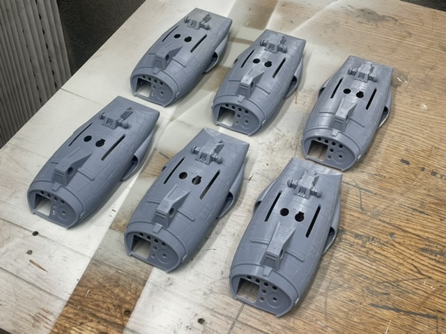

More pictures of painting progress.
Each part is sprayed with 2k filler primer and all surface imperfections are sanded or filled.
Sprayed black (pointless casting these in black in hindsight!)
Finished with the closest matching aluminium paint.
The first 6 shells are almost ready for their initial tan base coat (sixth not pictured)
Hopefully the next post will involve weathering the aluminium frames and initial assembly.
Thanks for looking everyone!

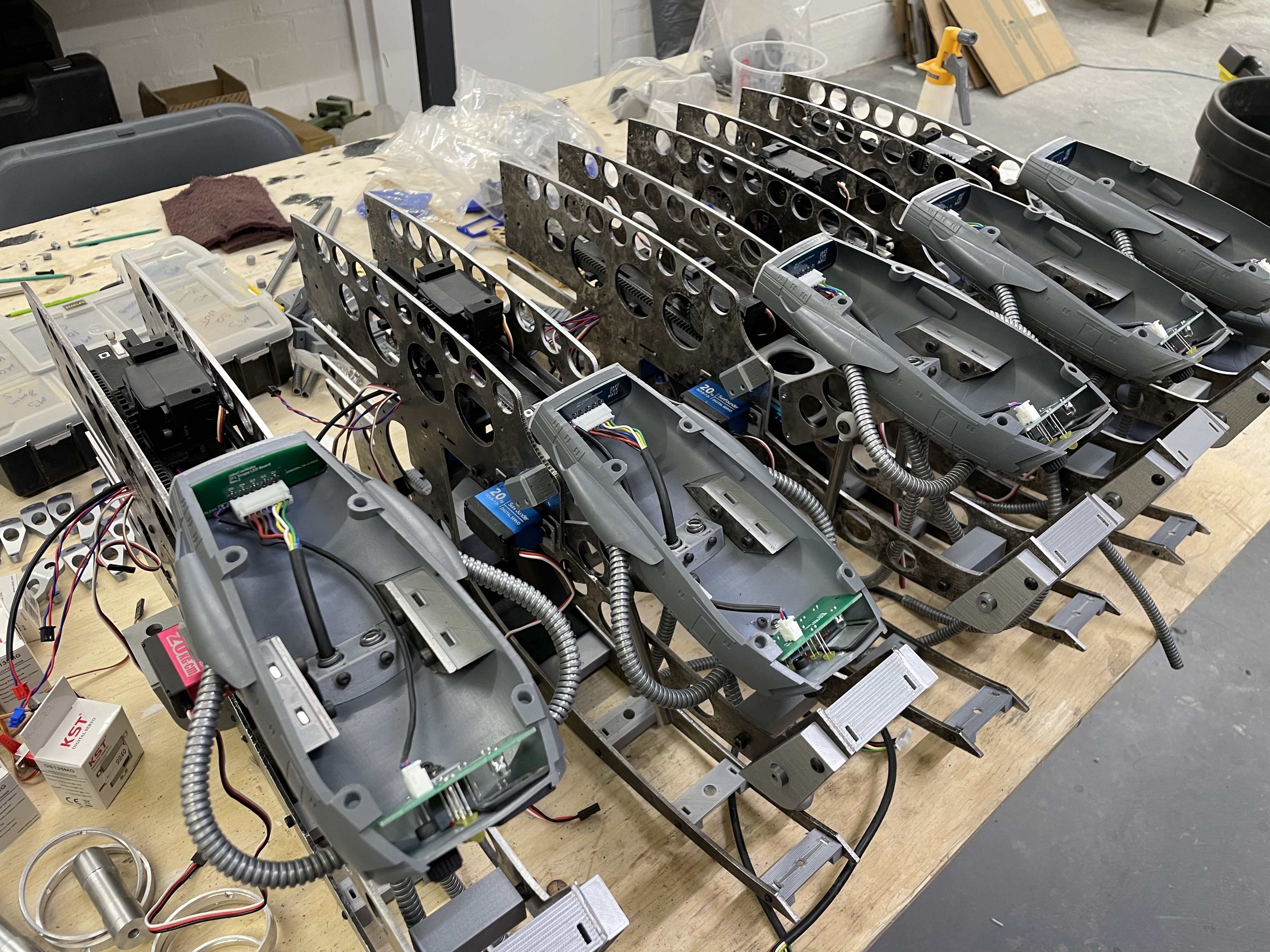

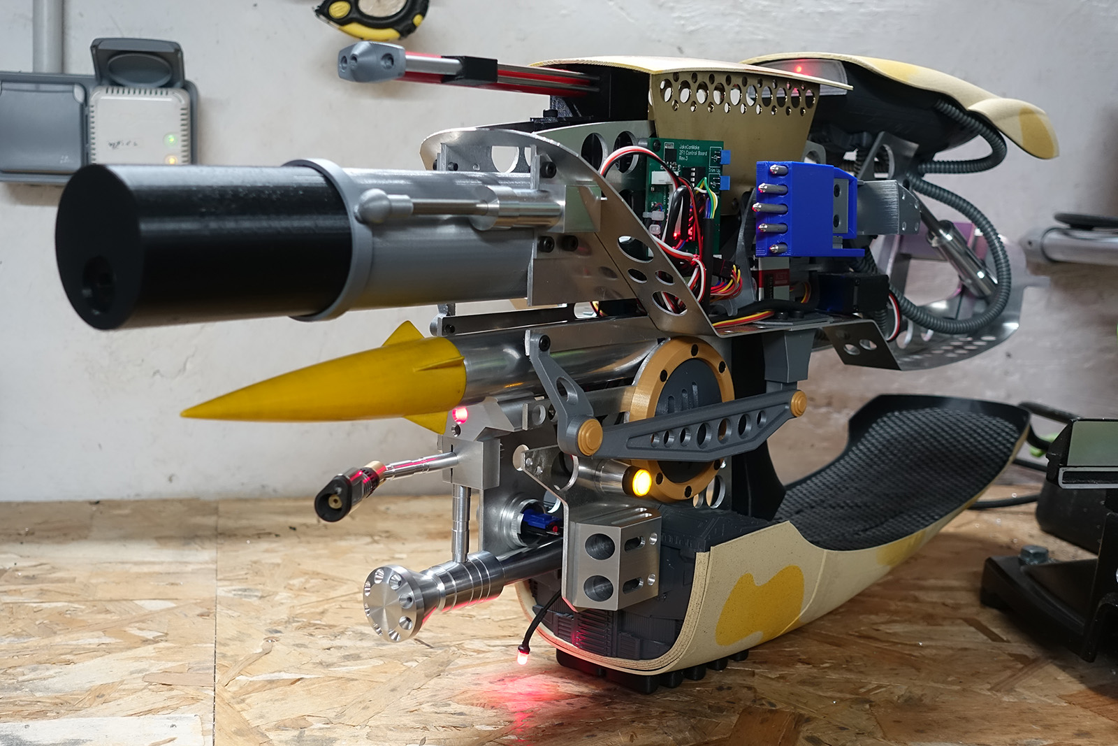

Scope, trigger and lifting mechanisms have been installed on each ZF1. I have also installed the horizontal frames, gold frames and main control boards.
I also received my first picture of a customer-built ZF1!
This is a standard kit ZF1 built by someone with no previous knowledge of electronics or prop building, built using my YouTube guide videos. It moves, lights up and works perfectly. All he has to do is paint it!
I’m really proud of this as the kits do not work if they cannot be built so this really encourages me and hopefully all you kit builders out there.
Lots more videos still to come on various aspects of the prop but this is a fantastic start.
More pictures soon!
Absolutely phenomenal Jake! Looks like a Zorg Industries assembly line there, haha. SO great to hear how easy the user got along with assembly. Love it!

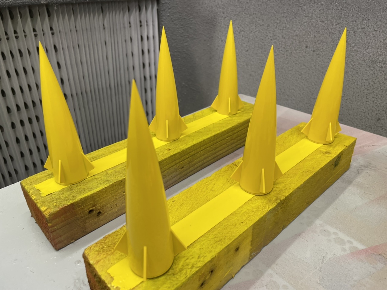

Hey Jake, by the way, I used Tamiya TS-16 for the yellow rocket paint and I like the result, yours look awesome as well, can I ask what paint you used for them so people can have a bit of choice if they need help for that :)
really impressed with the black look on the aluminium frame too! guys, I'm actually so jealous of those of you that get the assembled DX painted ZF-1, it will look awesome, I don't know if I'll ever have the time to paint my frame or re paint the shells!
