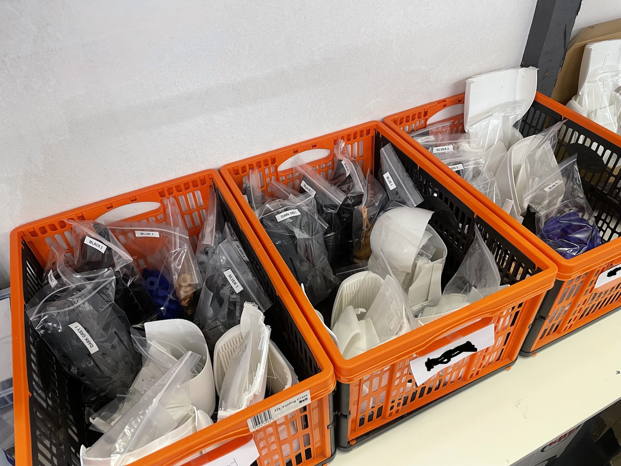

Thanks for being patient with me on this one guys! The standard kits are close to being shipped, and I will be starting work on the DX component casting in the next couple of days. My 4 printers are running 24/7, with parts coming straight off the beds and being bagged up, labelled and boxed ready for shipping.

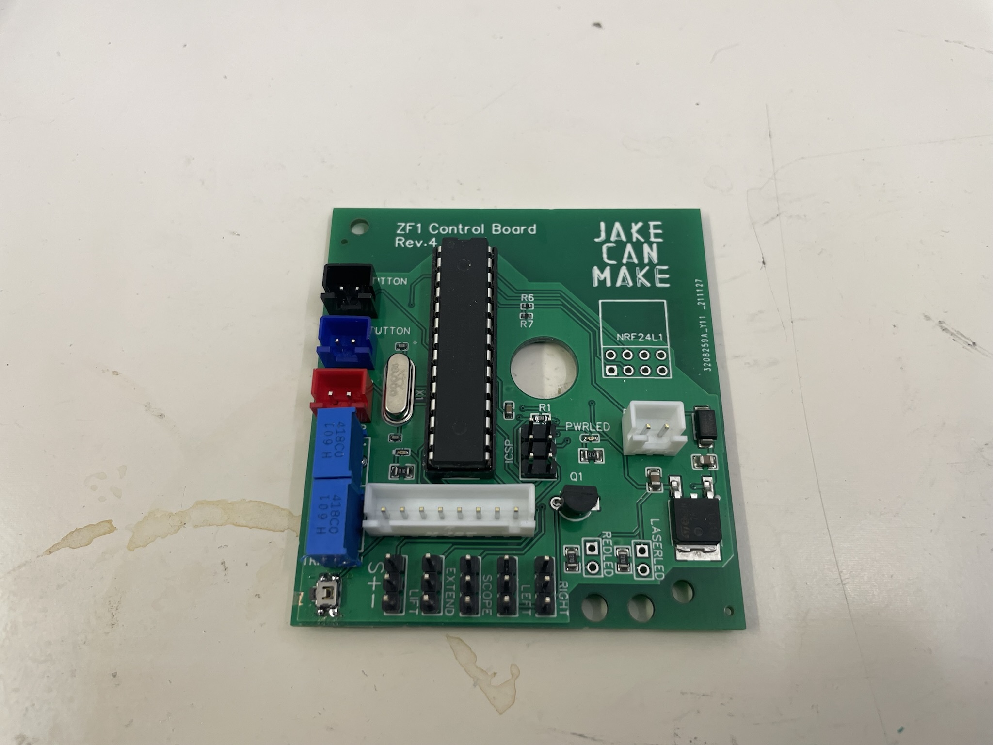

I have also received the first of the latest (and probably last) revision Main Control Board.
This solves a few issues, and adds a couple of new features, including low voltage indication (the prop will flash when battery voltage falls below 5.8V), colour coded plugs for easier assembly, a dedicated 'servo trim mode' button on the board for tuning of servo positions and easier to access servo trim potentiometers. These will be packed as standard on all kits and I will be providing a comprehensive user guide as part of the assembly instruction videos.

The main production bottleneck are my 3D printers but everyone should rest assured their kits are well into production. Now the bulk of the assembly guides are finished, I will be creating moulds for each of DX components and casting them out in resin.

Today I have been shooting some 'live action' of the initial electronics set up and a guide for how to operate the Main Control Board, setting each servos start and stop point etc etc. I am editing it all together now and will post it up when it has uploaded to YouTube. This will be followed by the aluminium frame bending, lower fabric cover installation and painting guide videos at a later date.
The Main Control Board is also protected by a polarity diode
