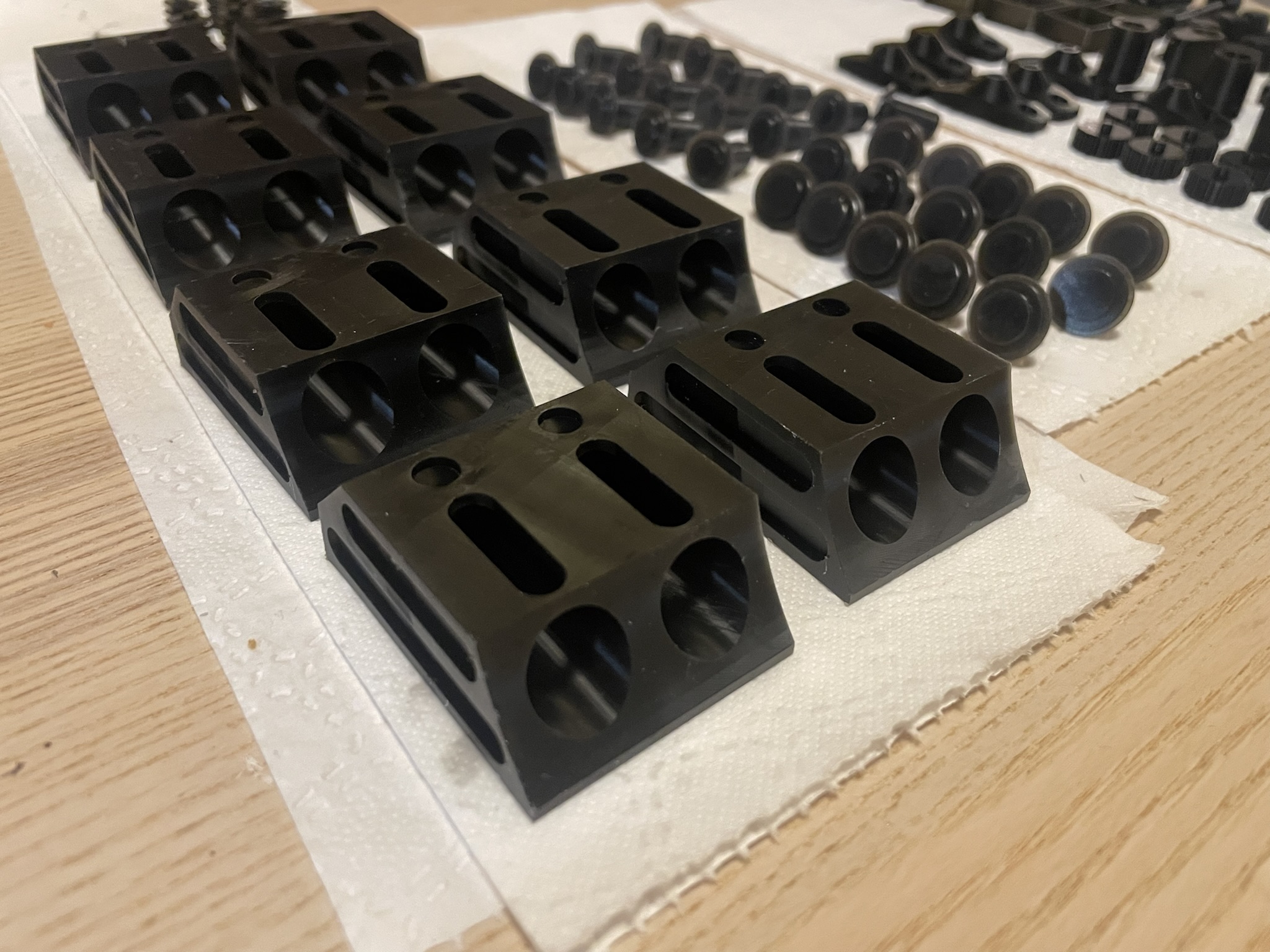

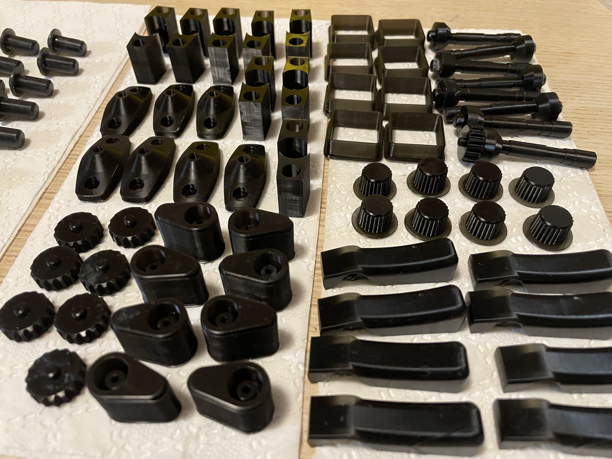

Here are some pictures of the SLA parts (printed in black because they are either finished in black, or aluminium so look best with a black undercoat)
These are the torch holders. It is a fairly complicated part to cast so I have decided to print them on my SLA resin printer and use them as production parts.
Pictured components include trigger bodies, knobs, nozzles and screen surrounds. They are all absolutely gorgeous to look at and the detailing is remarkable. I'm very happy and I know you will be too. There are enough parts here for 8 kits so more to print still.

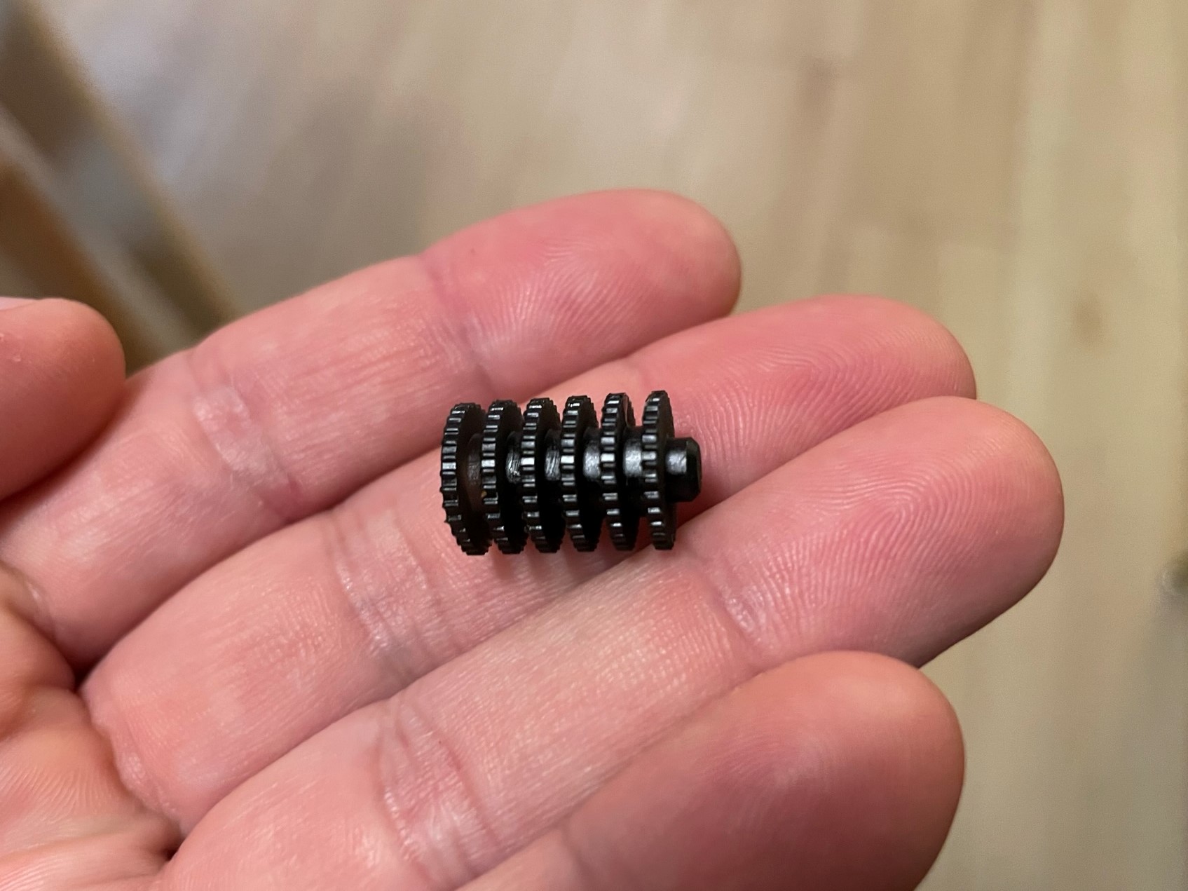

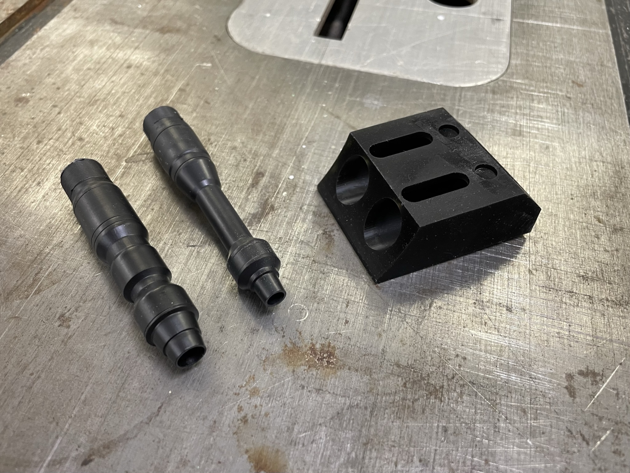

This is a part of the flame igniter component, modelled directly from a Butane Micro Torch I used on my original ZF1. These parts all slot together to make up the igniter component.

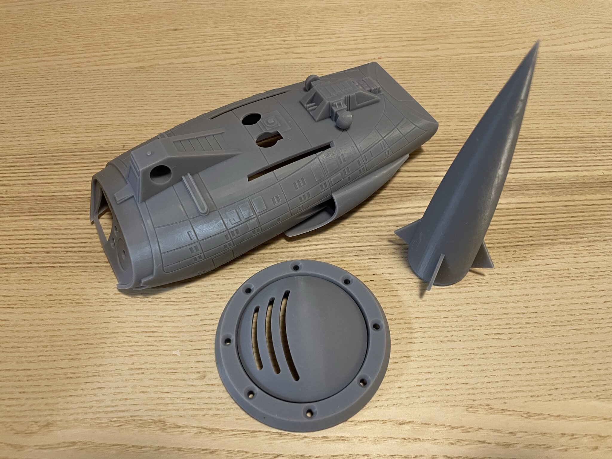

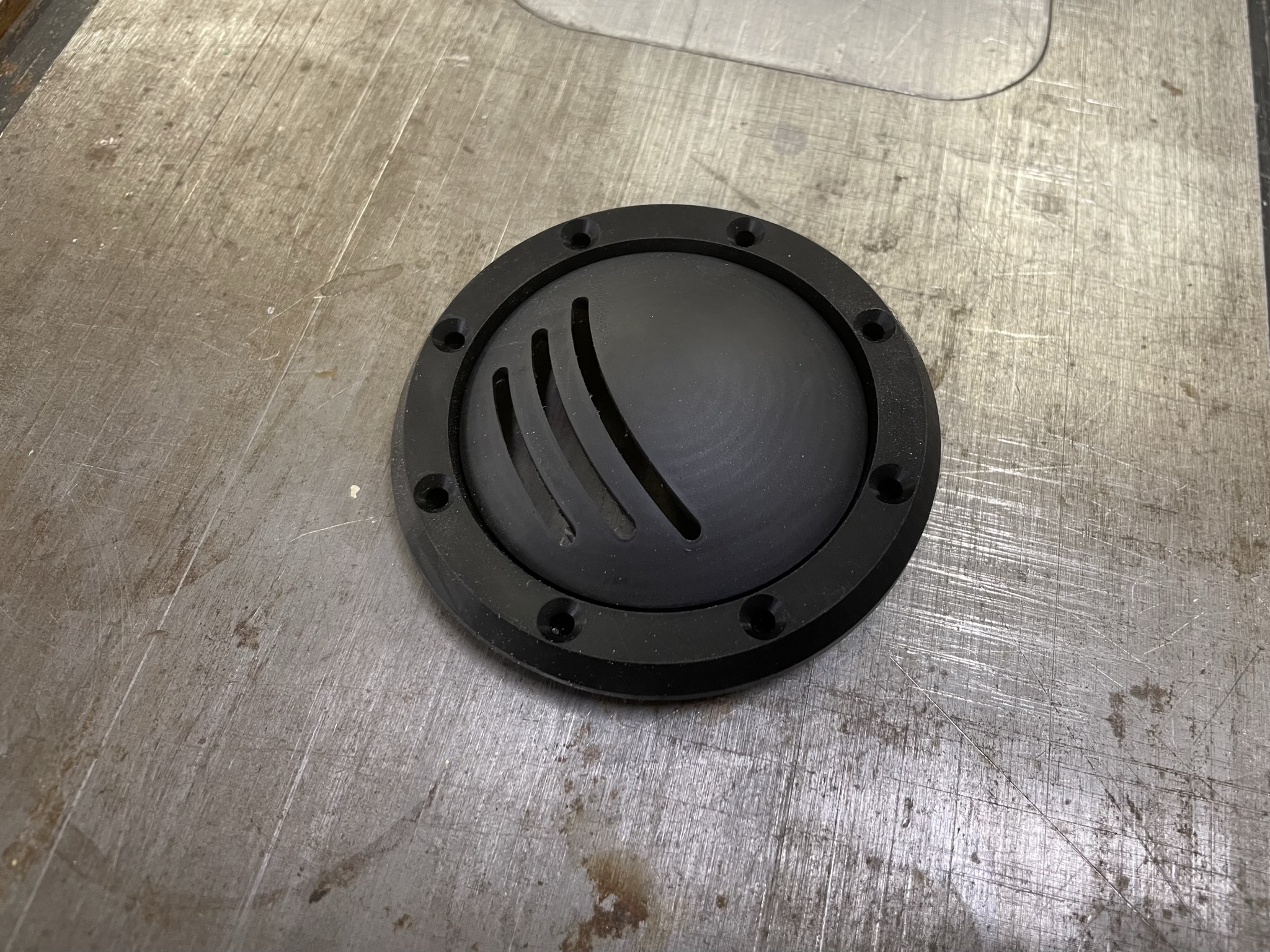

Finally I have a picture of the more iconic parts of this prop; the Voyager hull, Estes rocket tip and slotted rocket vent and ring. These parts are going to be mould and cast. I have designed and printed the mould jackets and will be pouring silicone this weekend. If all goes to plan I hope to be shipping the first DX kits out by the 31st January.

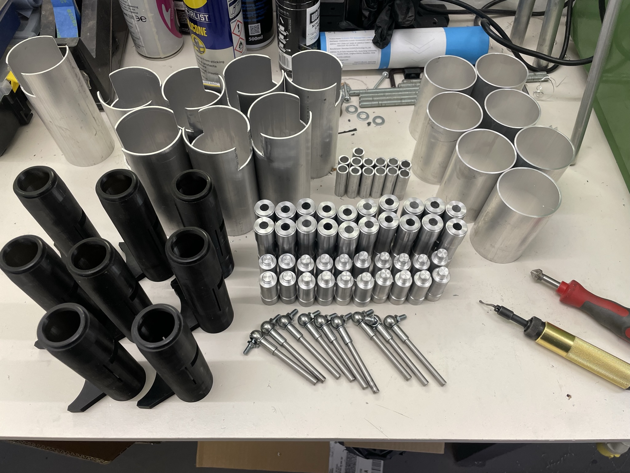

I will have more pictures of complete kits up soon as I finish casting them but for the time being here are some pictures of some of the metal turned components and metal barrel pistons complete with proper rod-ends.

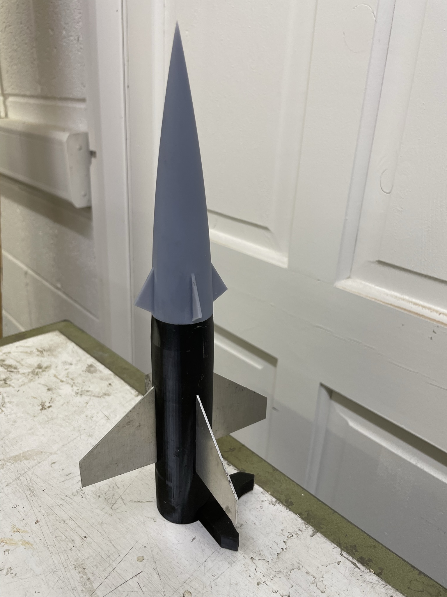

There are a number of parts that are easier to SLA print then mould and cast. The rocket bodies (black objects to the left of this picture) and the scope 'voyager hull' bodies are good examples.

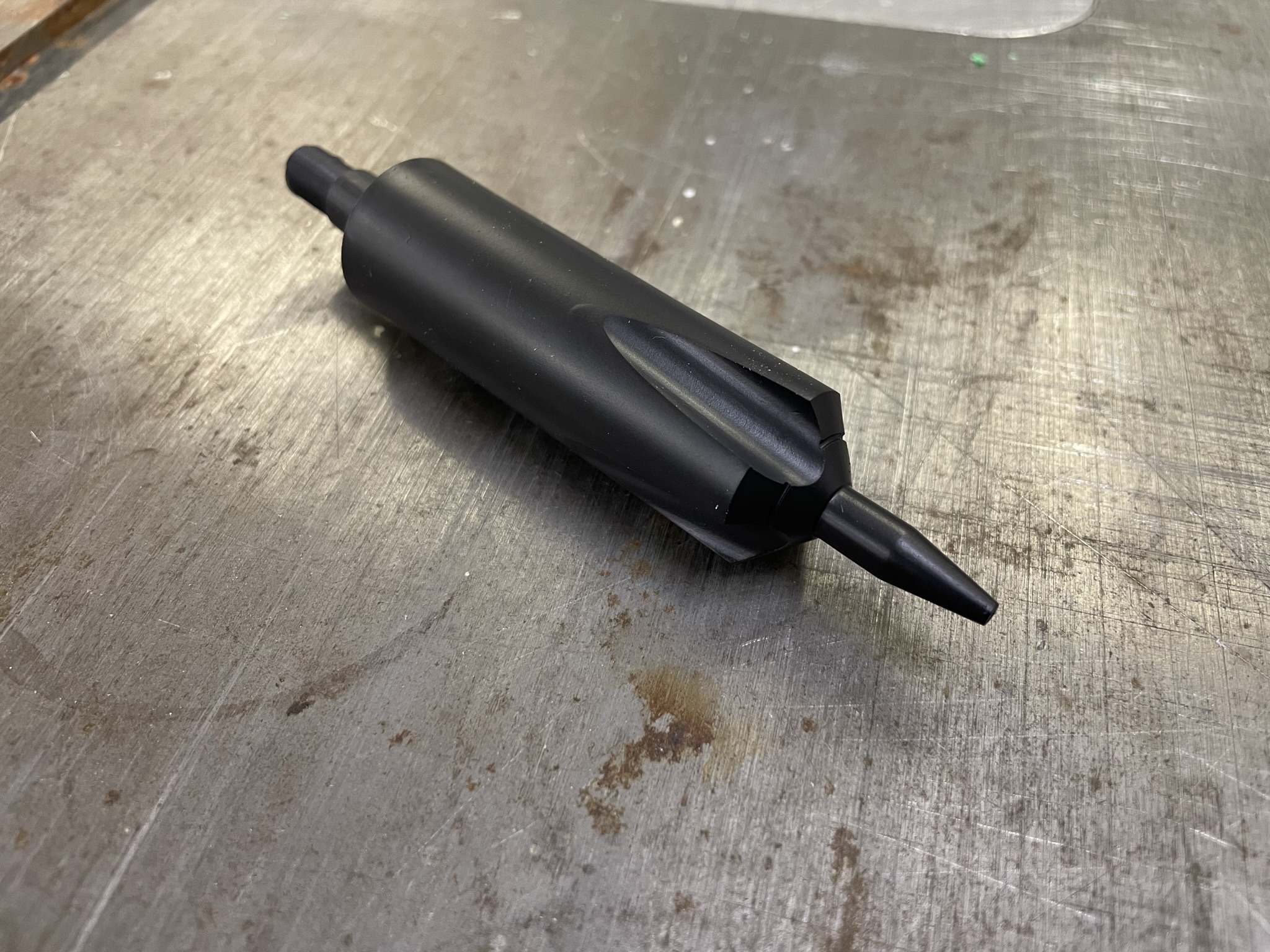

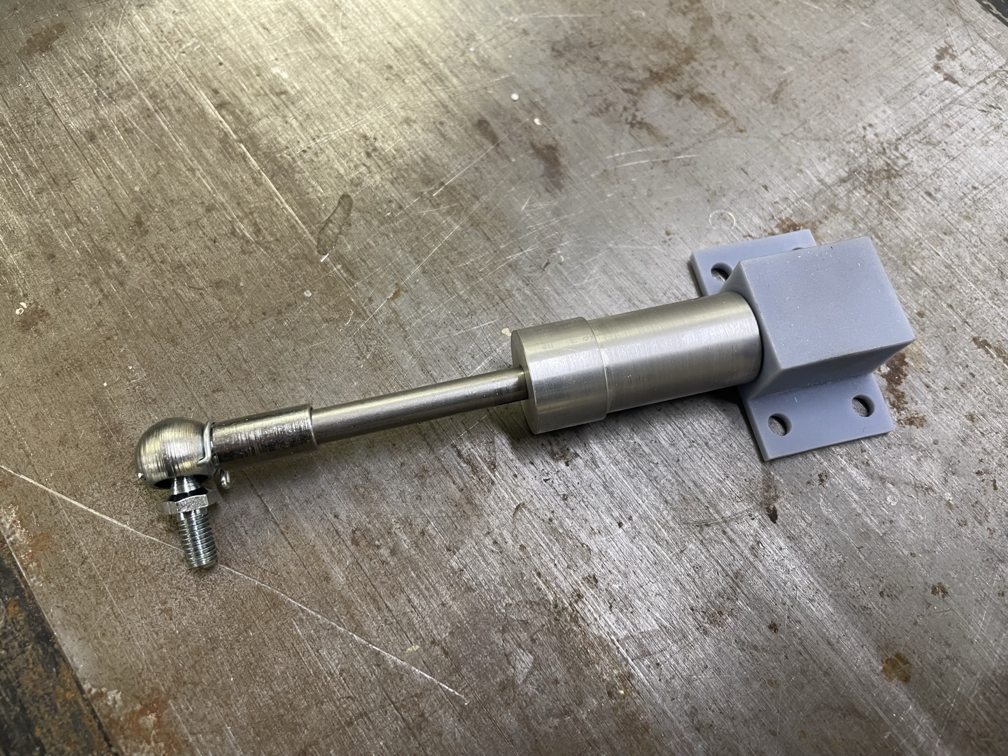

This is one of the barrel pistons. I have included the rod ends in the DX kit as an extra bonus for you guys as I think they elevate the whole thing just that bit more.

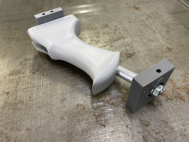

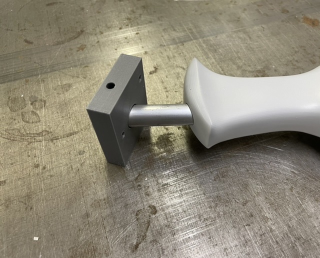

They are covers for the threaded steel rod that runs through the grip. This is a new addition added for the latest ZF1 variants.
this is actually something I would love to do on mine. would it be easy to remove the bottom part of the ZF-1? I guess the lining has to be unglued though
To demonstrate (Grip is white as it has been primered ready for casting) The aluminium cover hides the threaded steel rod that runs through the grip and helps provide added structure to the prop.
I deemed this necessary due to the added weight from the extra metal and resin components, although ALL ZF1 kits and assembled ZF1s will have this addition.

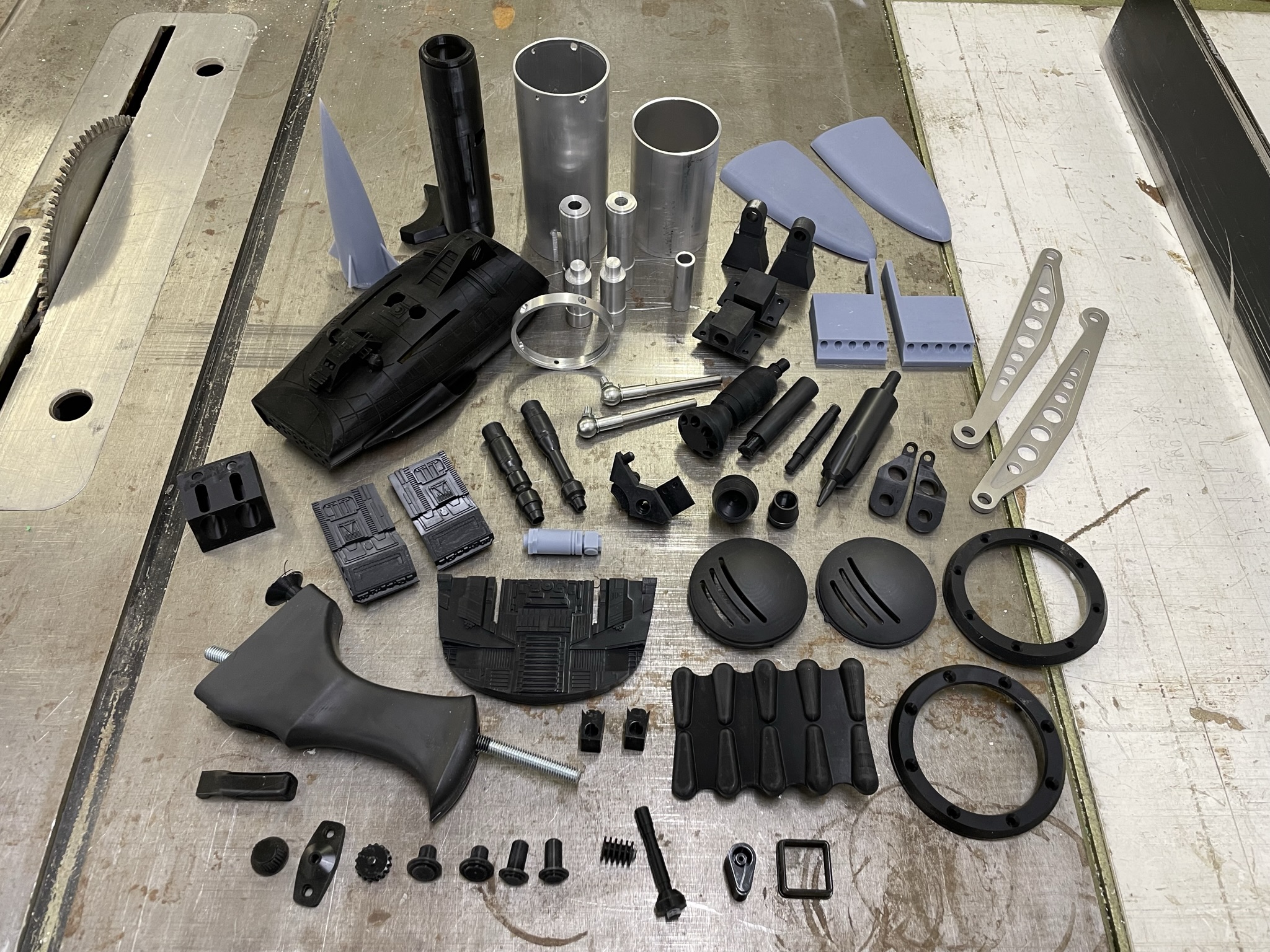

Hello everyone,
I finally managed to take a group photo of the Deluxe kit upgrade components.
As you can see there is a mixture of metal and resin components, with half the smaller resin parts being SLA printed.
Since most parts are finished either black or aluminium, I have opted to use pigmented black resin where ever possible.
Below are some pictures of single parts..

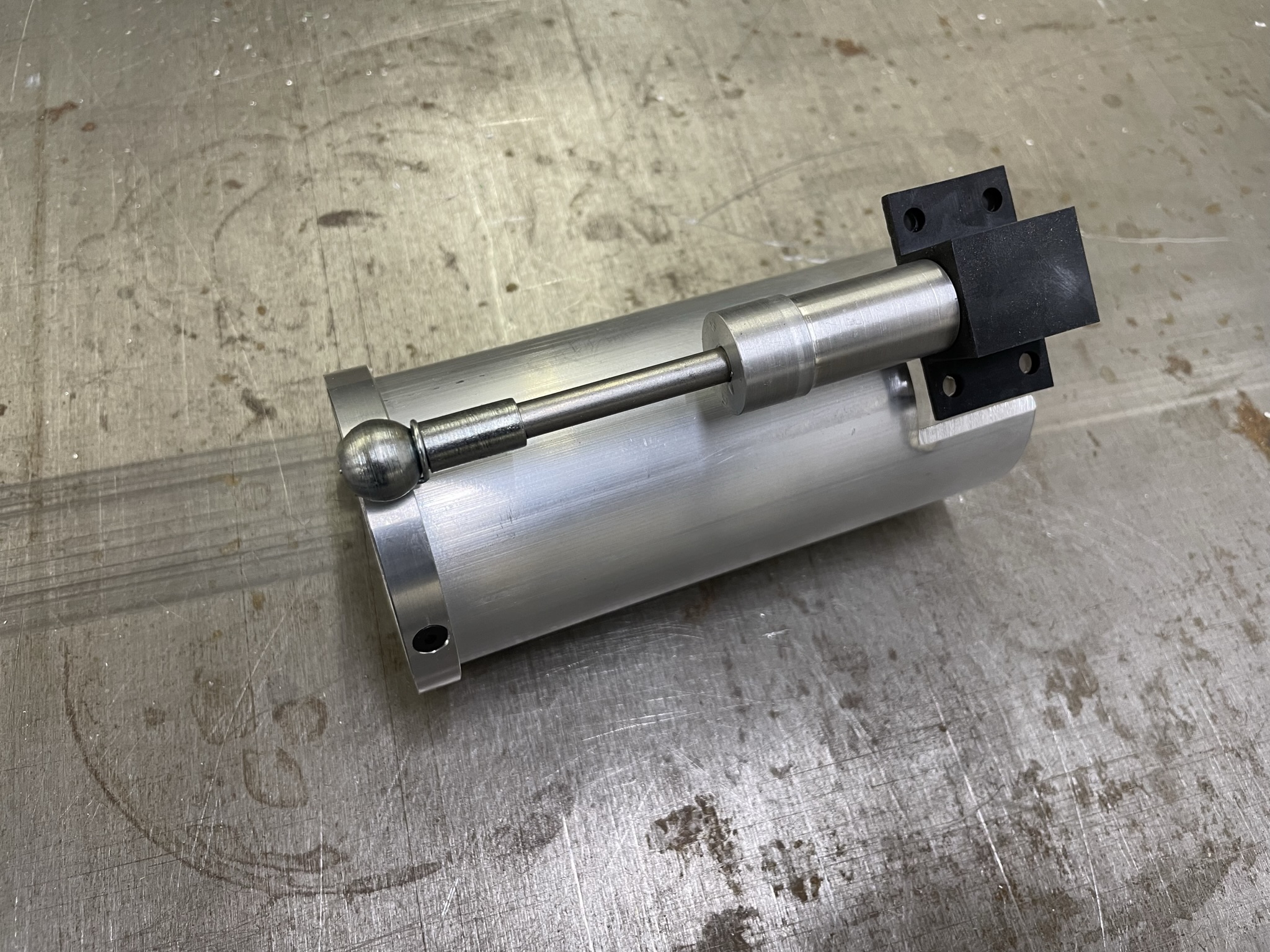

This is the upgraded main barrel (or the rear half of it at least) with the upgraded barrel piston and piston base.

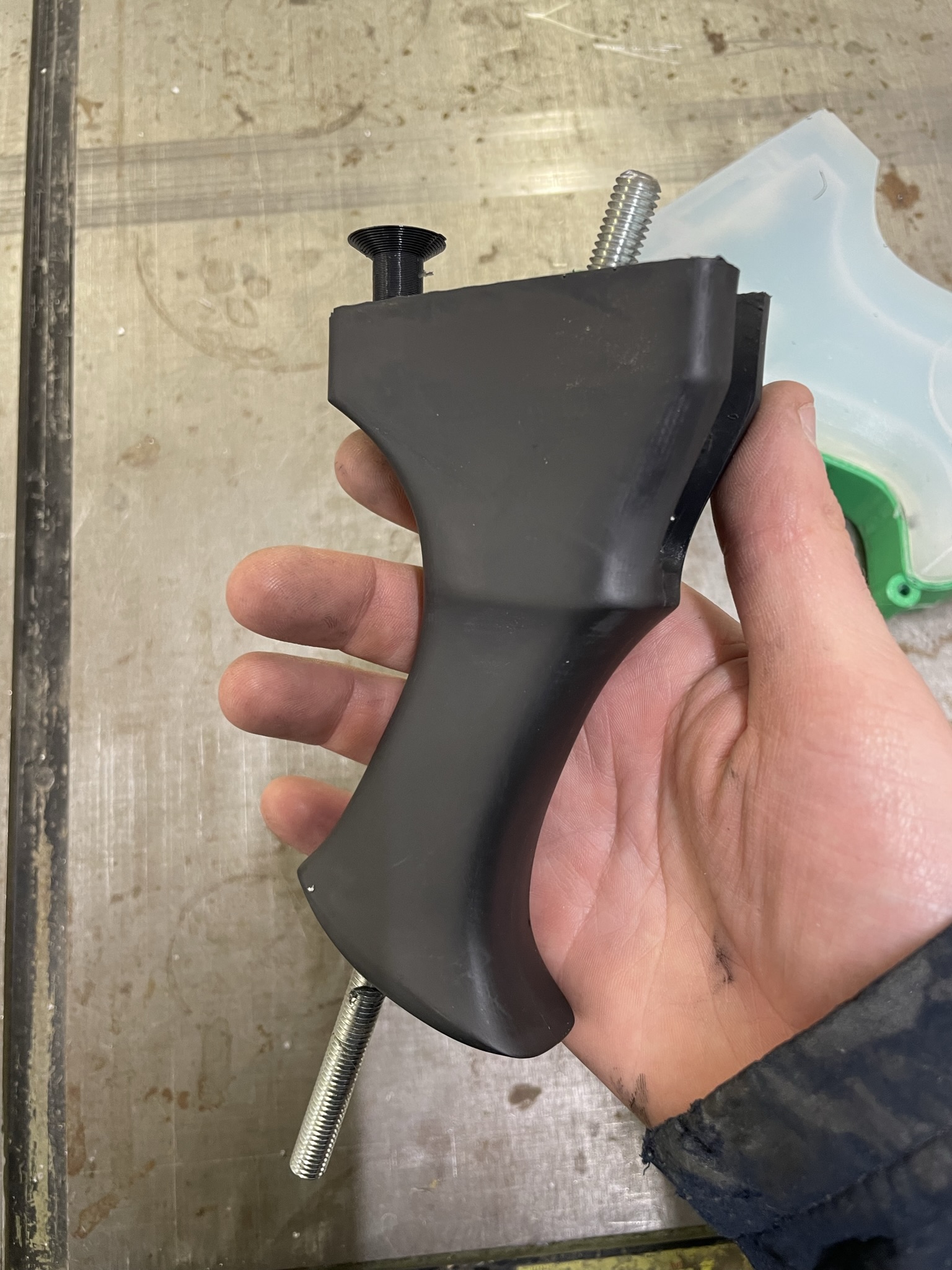

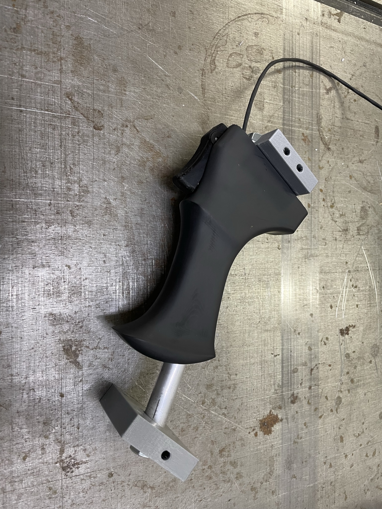

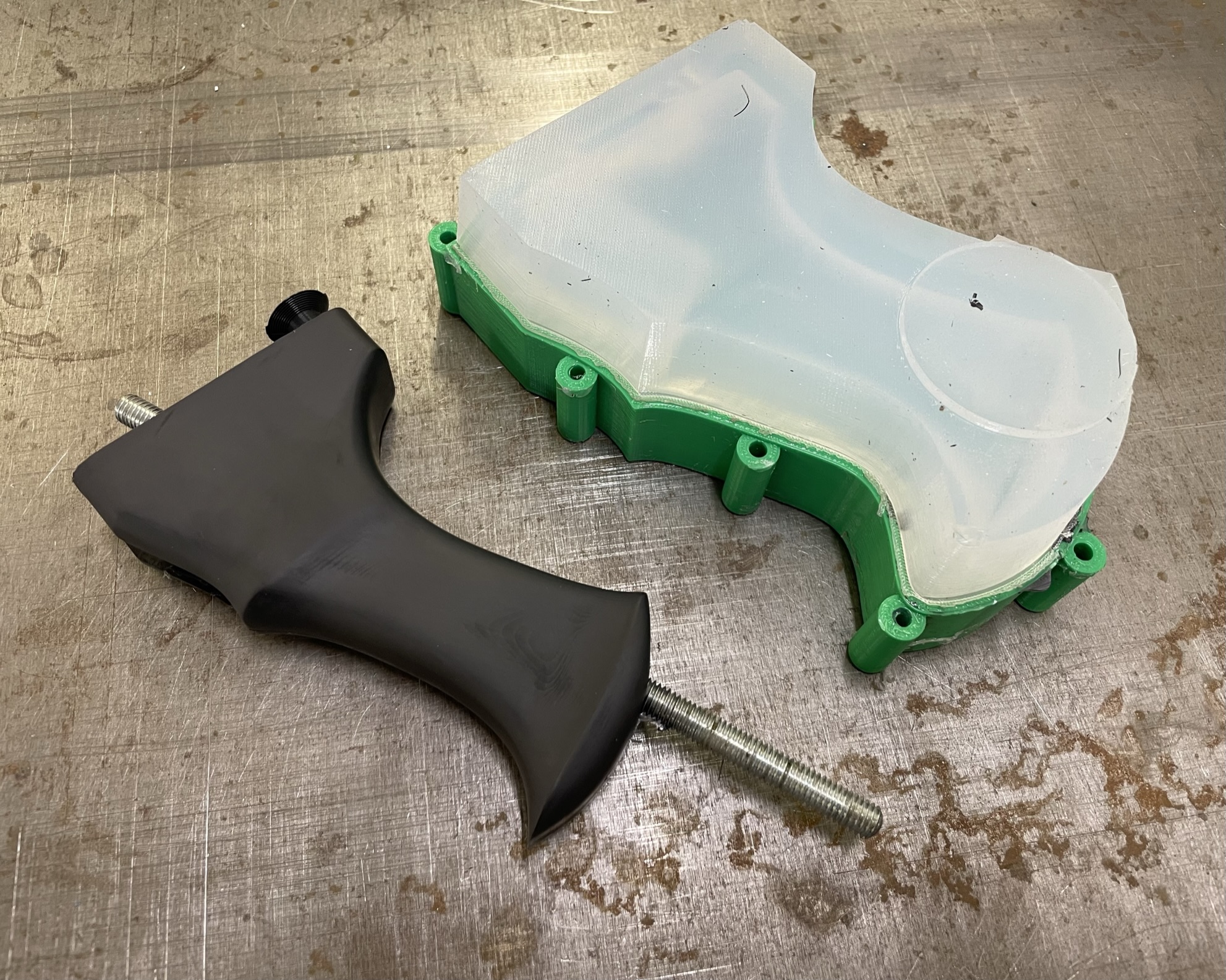

Below is the mould for the gun grip and a fresh casting..
I have opted to cast the threaded rod into the resin, as per my original ZF1. This provides a massive strength increase to the prop to help support the extra weight..
...In conjunction with the resin trigger and rod cover it really looks (and feels) very good.

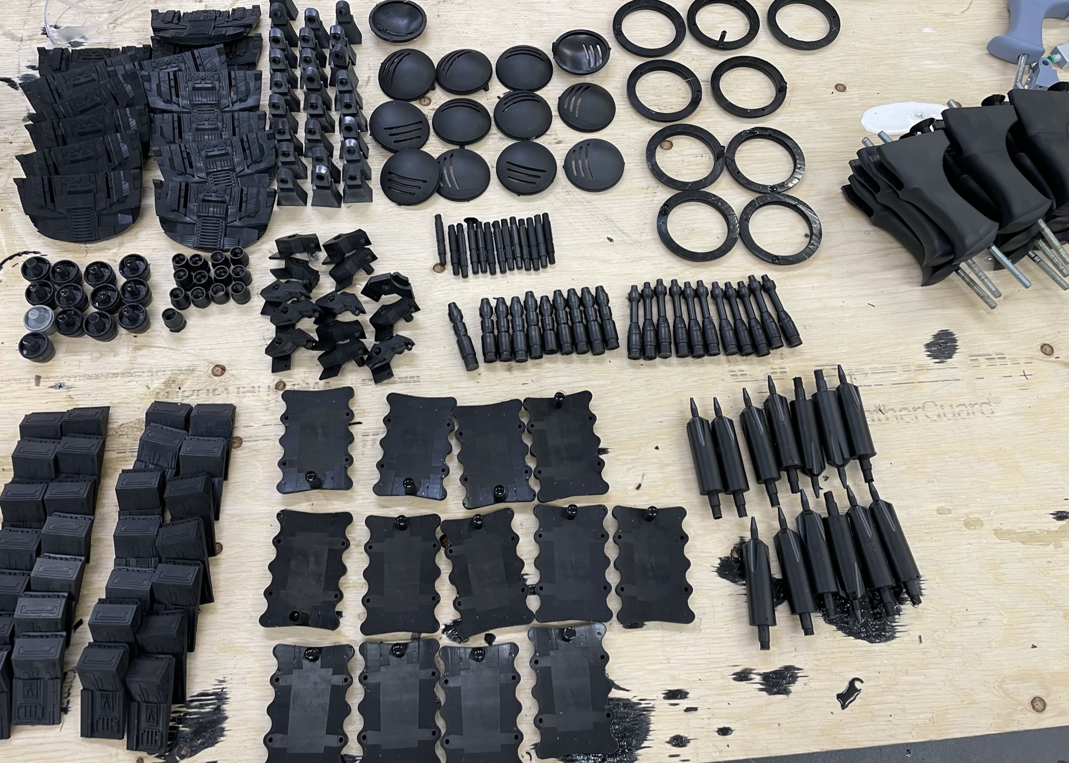

Below is a picture to demonstrate the amount of parts I have been casting out over the last 4 days. I am still not quite finished!
To all buyers of the DX kits and assembled ZF1's, I just want to say I really appreciate your patience. As you can see there are a lot of parts to make and I am getting through them as quickly as I can. I'm looking to have the packages ready for shipping within the next 2 weeks, but the main thing is making sure everything is together and to the high quality you all expect. I'm sure you will not be disappointed!

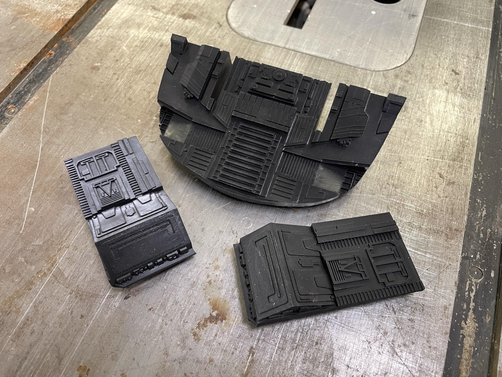

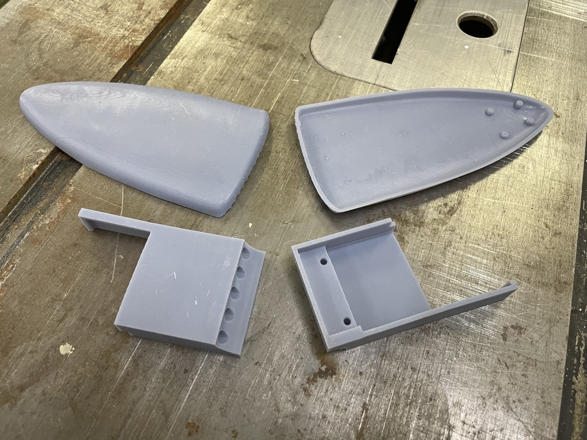

Parts are modelled using bought voyager kit parts off my original fibreglass/metal ZF1.
The scope is printed using an SLA resin printer, as this also allows fixing points and grooves for the frame to be included within the body of the scope. Moulding and casting in resin the traditional way was considered, and I spent 2-3 days working out how to create a 5 part mould for this purpose, however I decided it was just too complicated for a result I wasn't guaranteed to get so went down the SLA print path.
The lower detail parts are again accurately modelled from Voyager kit parts, and SLA printed with fixing points, however these have been mould and cast in black pigmented resin as the cost of SLA resin and time it would take outweighed cost of silicone/resin and mould making labour.
