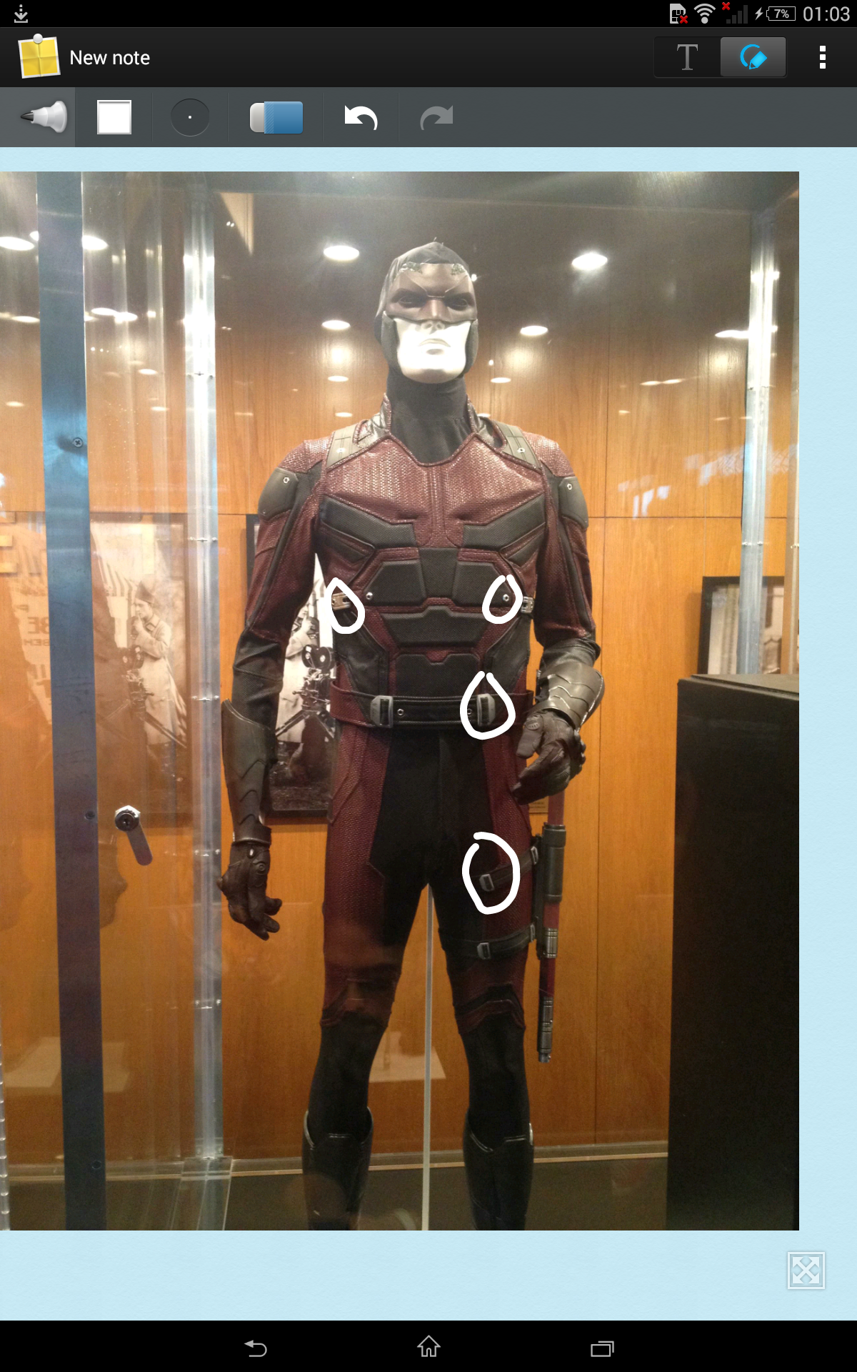

can anyone tell me what the names are for all the metal hardware on the suit such as what rivets or poppers I need what the D ring looking parts are called (can't find a d ring even slightly similar) and the world folded metal on his ribs Screenshot_2015-05-28-01-03-57.png

can anyone tell me what the names are for all the metal hardware on the suit such as what rivets or poppers I need what the D ring looking parts are called (can't find a d ring even slightly similar) and the world folded metal on his ribs View attachment 482352
The metal hardware on his helmet, shoulders, and arms are hex nuts. There are also hex nut embedded in his belt. The ones on his abs are "button head" allen key bolts... the heads of them anyway, at least :D
The parts on his belt and leg straps are slide adjusters, and if about four hours of Google variations of tribar slide/tabular strap adjuster/blah blah blah told me anything, it's that they were likely custom made. Same would go for the flat hooks on his sides.

So for the slide bar and rib pieces looks like we need someone to 3d design and sell some stl files hint hint ��
With regards to the hex nuts I can't I cant find anything thin enough to use on by suit. Been looking at hex eyelets as I dont actually need them
I thought the cowl was rivets ?
With that whole hex nut/rivet thing, the designers mentioned in that interview that the suit is covered in rivets, but hex nuts are clearly being used for the majority of the pieces. There are a couple of shots of the cowl clear enough to make out a small hole in the center of the "rivets"
While that doesn't automatically mean they're not rivets (pop rivets often have holes in the center) I can see six sides on this:
For the cowl, you'd want to use jeweler's hex nuts, which are available in some very small sizes :)
I've been working on them :D
