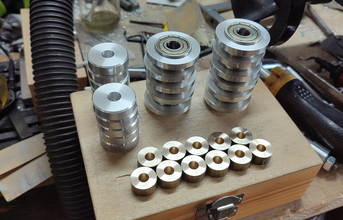

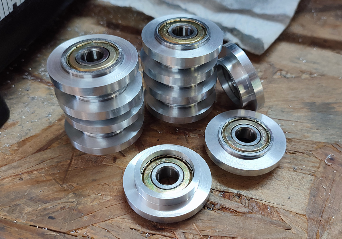

Hey there,
I got started on a few parts today:
those are pretty cool, with the integrated ball bearing. I don't see any screws on the refs, so I did large passes with the lathe so the part would heat up nicelly, then pushed the ball bearing with my mill vice. that way, they are heat pressure fit and hold by themselves
this is the top ball bearing by the way, it's not really visible in the refs. The bottom one will be flush like the refs, no worries ;-)
cheers
