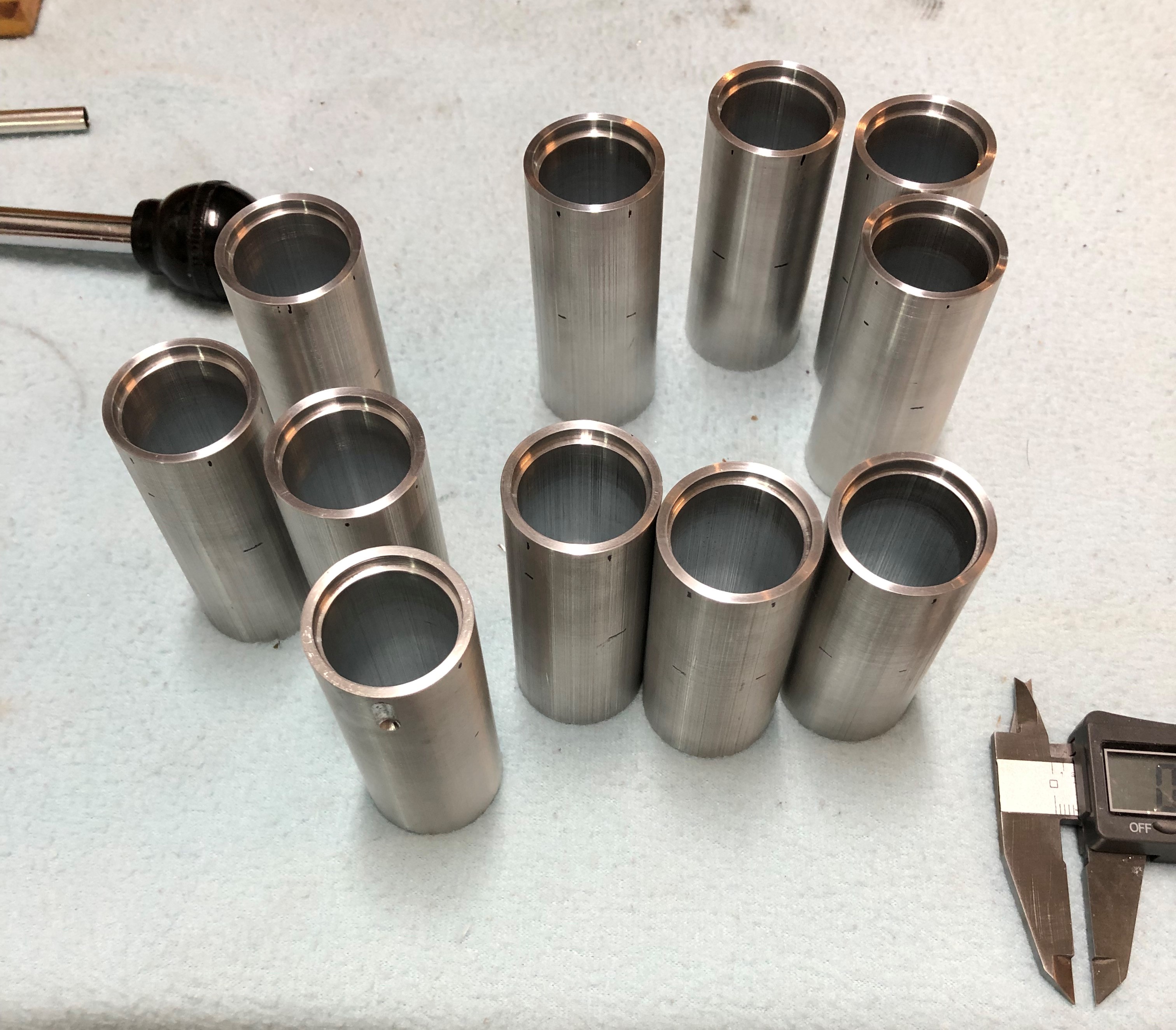

The tubes are cleaned up and ready to be milled. I've already started milling some of the smaller lines:
If everything goes well, I should have these done by the end of the week. At that point, I'll start assembling them and shipping out kits. :)

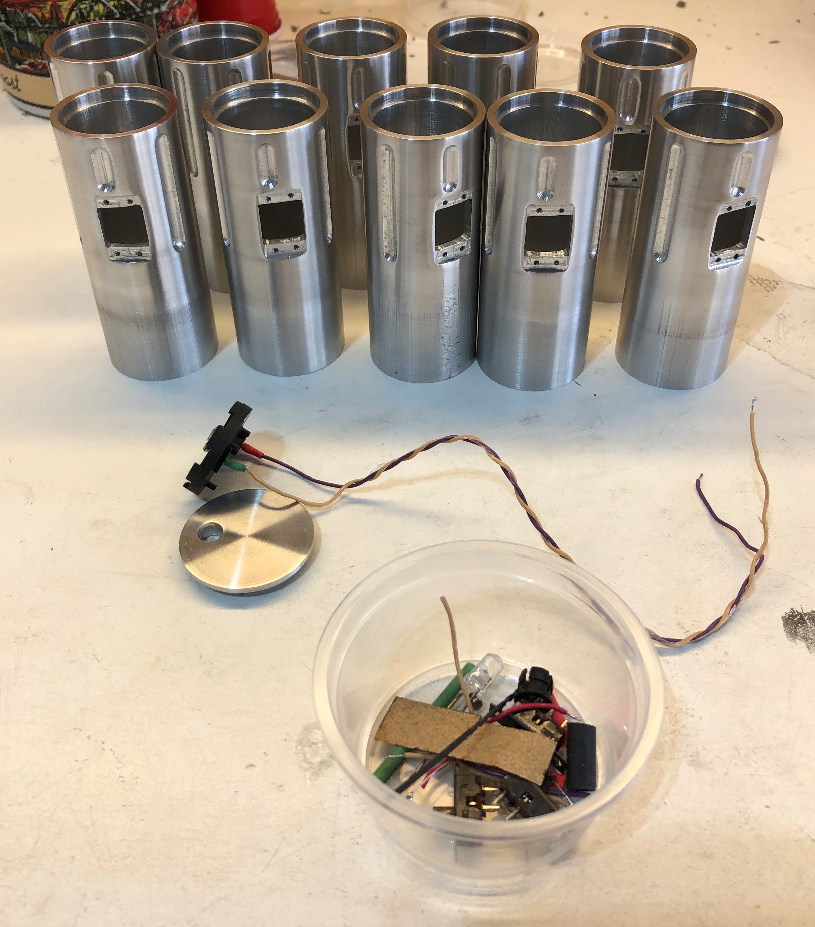

I will be shipping out another wave of scanners tomorrow and
will also be finishing up the initial run of 10 units.
